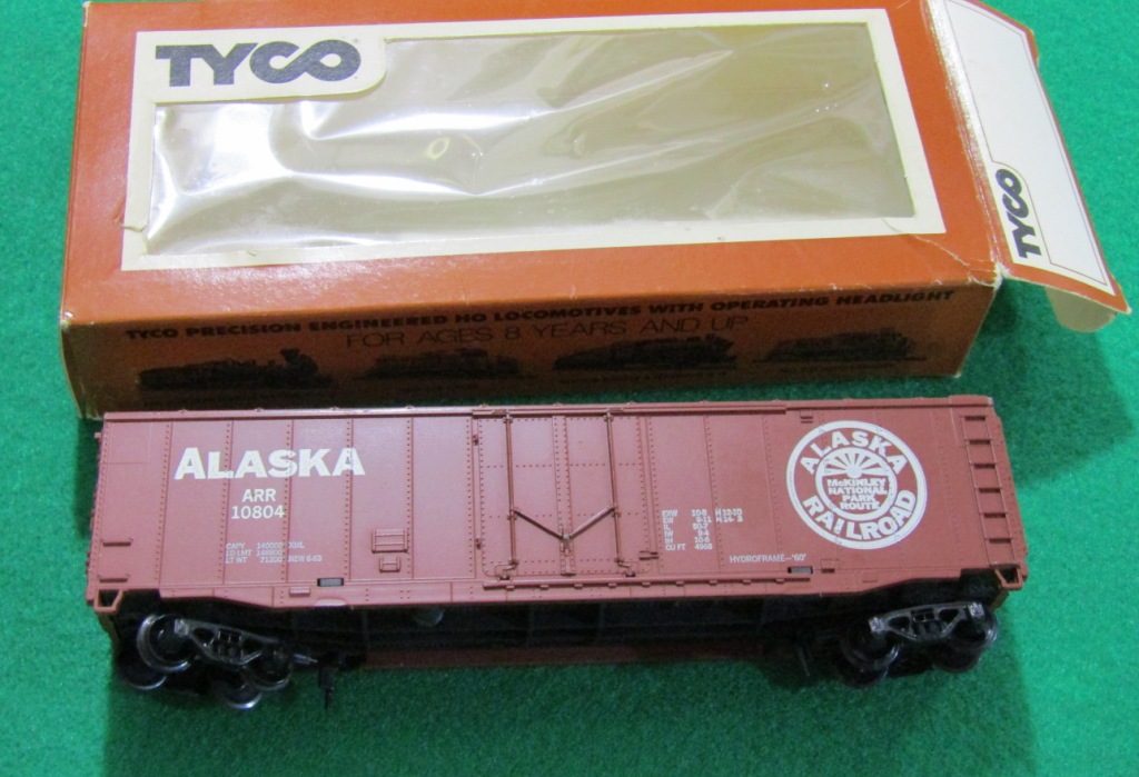

Here's my COTW offering:
The scarce Tyco Alaska 50' box car....won it on Ebay a month or so ago for under $10.

Darn straight that's rare, once again, another Tyco
piece I never knew existed!

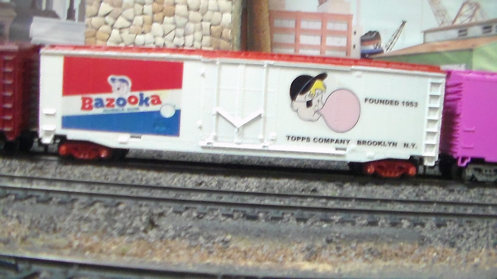

Well, I got the Bazooka car- this has been on my hit list for many years, however
I thought with the red trucks and silver chassis it would be Life Like, or something.
To my surprise, bold as life stamped on the bottom is "Tyco." What is also odd is that
it has body mounted coupler plates in the style of Athearn. The trucks appear to be
factory painted. The bolsters fit a Tyco coupler mounted truck. The shell is a typical Tyco
50 footer. I am a baffled, but it is a good runner and tracked well.

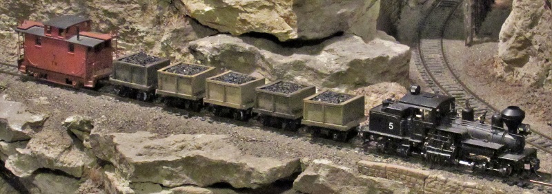

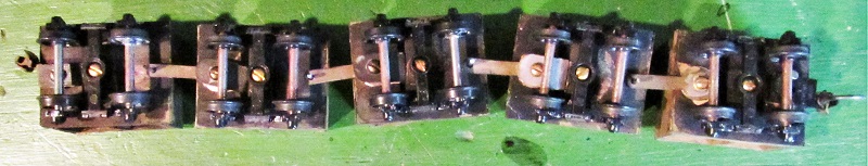

My COTW is a cut of coal jimmies. Some years ago, I came upon an article by the late great E.L. Moore (Six-Ton Jimmy, Model Railroader, May 1967). Long ago, there were small boxes on wheels for hauling coal from the mines to the markets. They were more like 2-axle ore carts. Moore's jimmies were built using wood from a yard stick for the main chassis. One freight car truck served for the under carriage.
Since yard sticks are no longer (to my knowledge) lumber yard giveaways, I used some 1/8" thick wood that I had. I modified some archbar trucks to make them less obviously trucks. The cut of jimmies has a coupler at each end for compatibility with the rest of my rolling stock. Drawbars connect them, otherwise. I think the prototypes used link and pin couplers. Moore's model appeard to use a kind of hook and eye arrangement.
The box portion is file folder cardboard, scribed to look like planks. The coal load is actually a few taconite pellets for weight, surrounded by sand, covered with coal and glued in place with diluted carpenter's glue.
Here's the whole string, in a train:

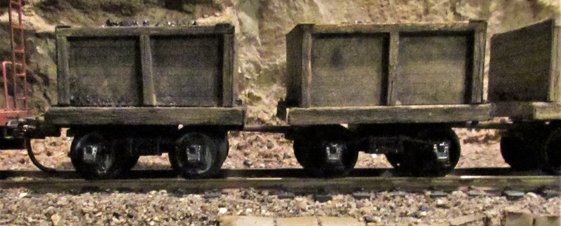

A closer view of just a couple of jimmies:

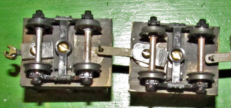

A view of the underside shows the drawbar arrangement between jimmies and the couplers at each end. One of the couplers is an old Accurail dummy. I really don't use these in operation with switching and uncoupling, so an operating coupler is not necessary.
A closer in view gives a better idea of how the drawbars are mounted:
These are not important to normal operation on the layout, but I was intrigued by the project in Moore's article and had fun building them.

Nice piece, chops... I have never in my life knew of the Bazooka by Tyco...

Those are nice little Jimmies, perfect cars to pull behind a small Shay,
Climax, or Heisler locomotive!

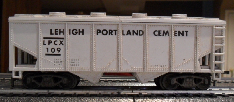

Mike, is the cement car a Marx product?
