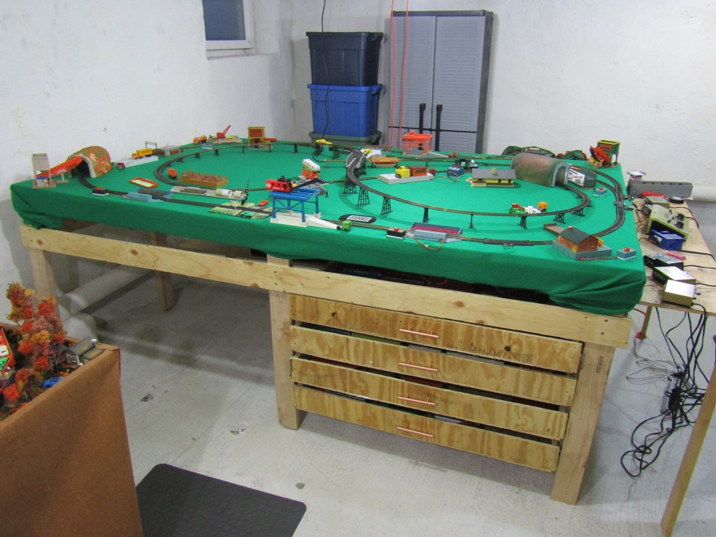

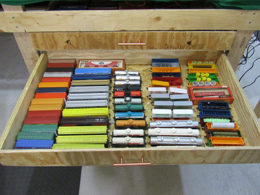

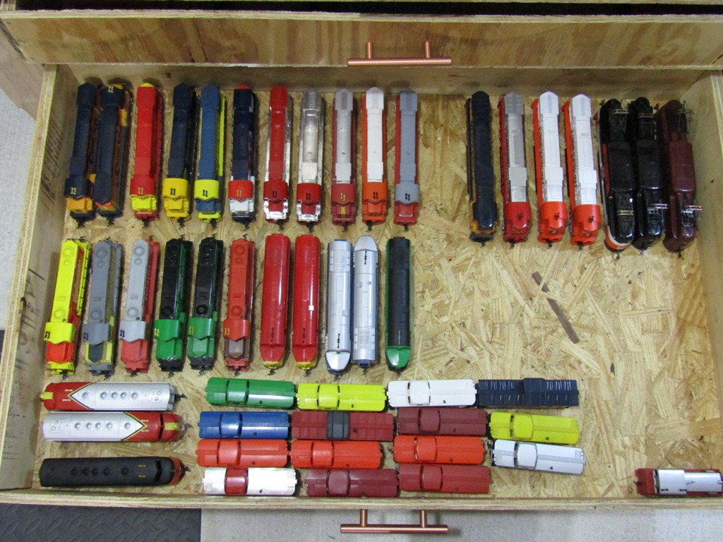

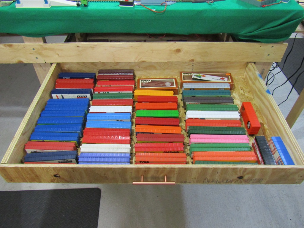

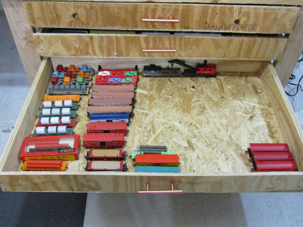

Last night I spent time organizing 95% of my Tyco collection into the RETRO TYCO II drawers....and everything fit, with additional space in the 3rd drawer for possibly passenger coaches that I will begin collecting in the future. The bottom drawer is only for Tyco locomotives, and cabooses.
RETRO TYCO II - an overview.
Bamos
RRCrossingAvatar
 Posted - September 26 2019 :  1:18:02 PM Link directly to this reply  Show Profile  Add Bamos to Buddylist
Looks good RP , I did the same thing underneath the yard at Clover Valley.
Bill
 Posted - September 26 2019 :  2:07:31 PM Link directly to this reply  Show Profile  Add walt to Buddylist
I am thinking about adding more drawers under my layout. I have three sets of drawers that I could use but I’m not sure I have room anywhere under the table that doesn’t have wires to my lights there without being disturbed.
 Posted - September 26 2019 :  7:05:25 PM Link directly to this reply  Show Profile  Add RP model railroads to Buddylist
Thanks guys!! Yes, I am overly pleased at how much of a success these drawers are...so easy to pick out a Tyco locomotive and train cars to run on the layout, and then neatly put back.
I am thinking that once I run out of room (a.k.a fill up these drawers) I might build another set of 4 drawers on the opposite side of the table leg on the same side of the platform, which would give me a ton more storage.

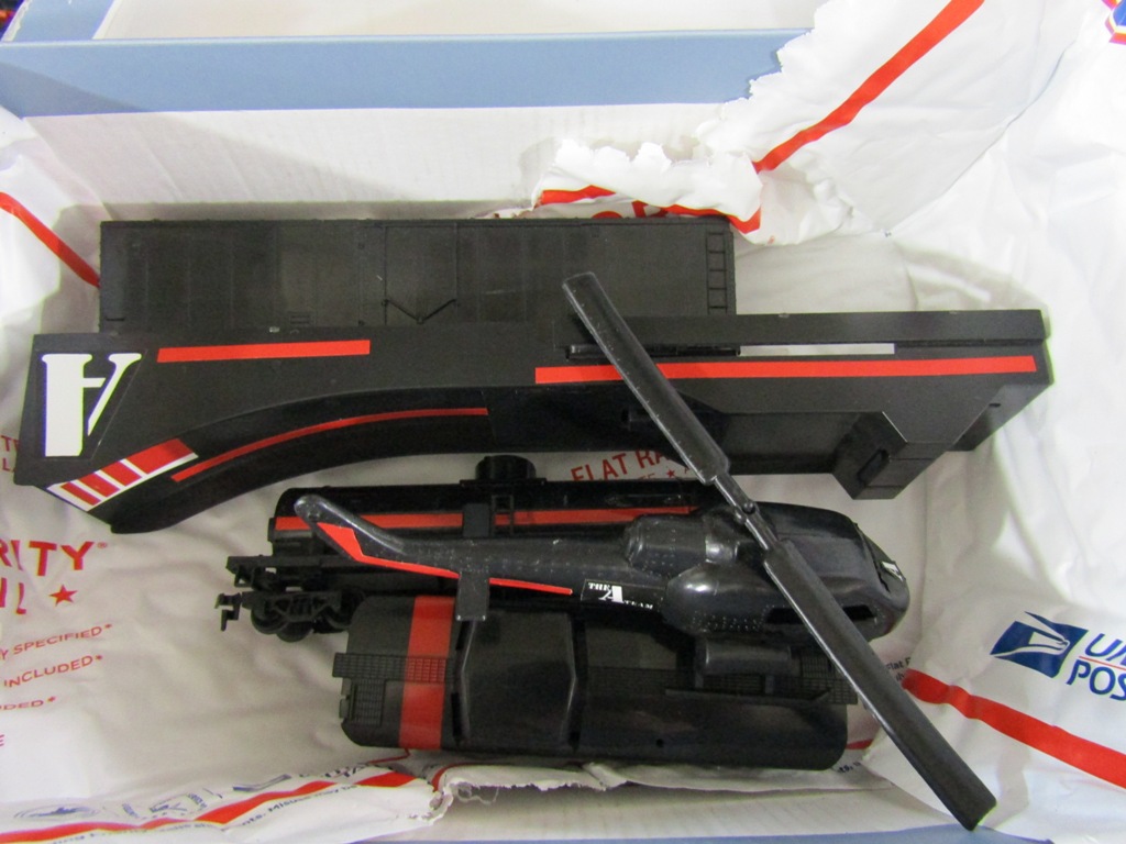

I am pleased to announce that thanks to the generosity of kristofer4301, I finally obtained the Tyco Great Northern F9A #4015, from the "Red Box Era!" kristofer4301 gifted me with this awesome piece, that I have since brought back to freight service on RETRO TYCO II. Granted, it is missing 2 stepladders and a few exhaust "stacks" on the roof, but just owning one of this rare Tyco locomotives in running order is awesome.
Here's a video of it hauling some of the rarest Tyco train cars in my collection. Please enjoy, and hit the "Like" if you will - it is appreciated.

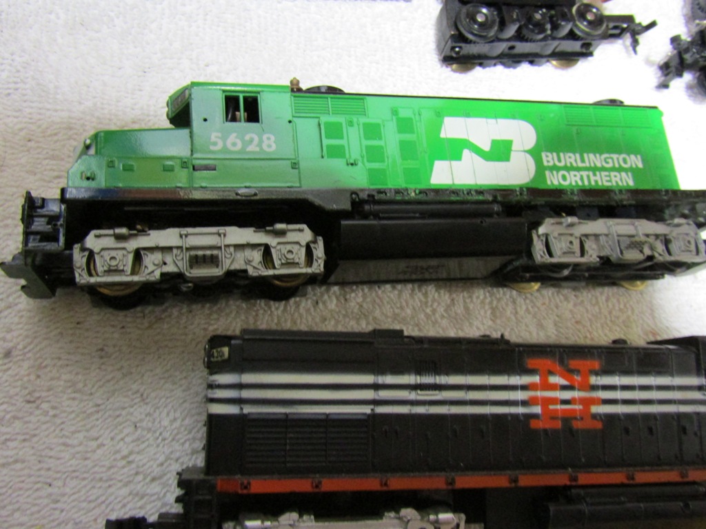

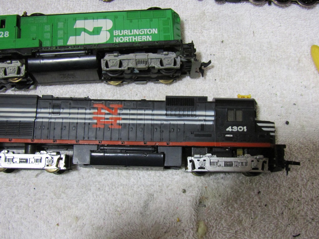

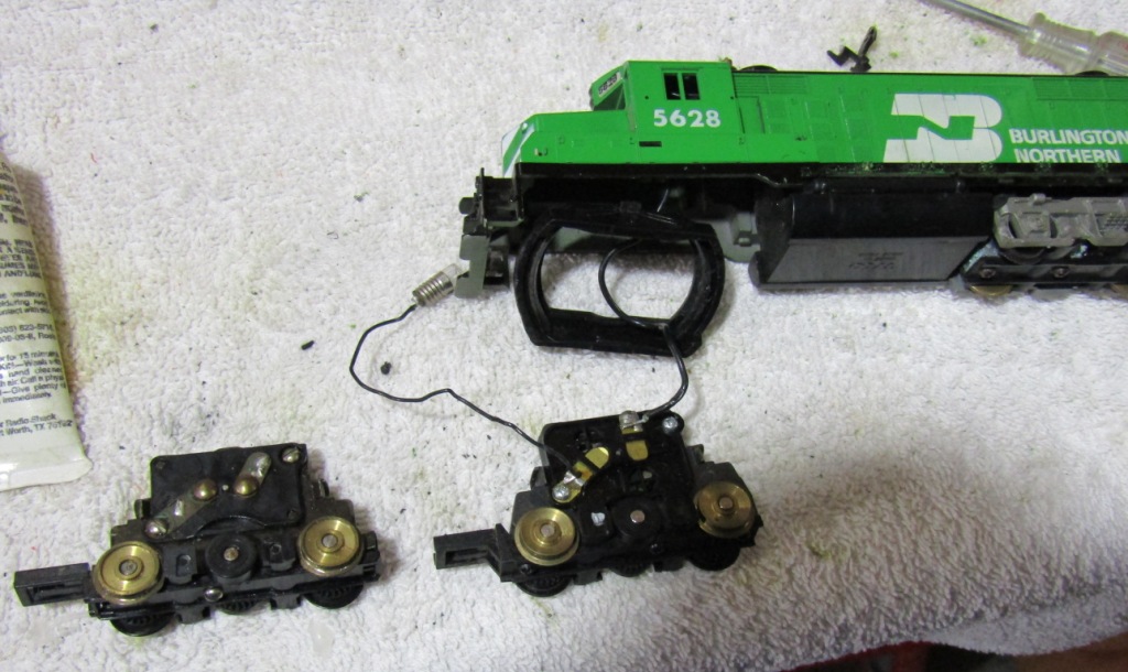

Yesterday I investigated possibilities of revitalizing my 3rd Burlington Northern GP20, which had a burned-out PT motor. Looking through my parts cart, I found another PT truck in good condition, and decided to simply swap-out the bad motor truck.
I then proceeded to fire up the soldering iron, and removed the wiring from the bad truck and simply soldered them on the "new" PT truck. Sure enough, upon tracking testing, my wiring work was a success. There was just one problem, the "new" PT truck popped its pinion gear off. So now I'm trying to superglue/liquid cement it back on....let's see how this works...
In the photo below, the "new" truck is on the left, while the "old" burned-out one is still seen connected to the GP20.

 Posted - October 05 2019 :  8:09:13 PM Link directly to this reply  Show Profile  Add Chops124 to Buddylist
Let us know if that pinion gear fix works. Those are the deuce. I imagine you have already thought of
taking the good pinion off the previous motor.
Tidy and well organized, but I have a feeling that storage drawer is likely to
fill up, over the years, with more mint Tyco specimens.

Welp, unfortunately, the pinion gear popped back off again. Back to the drawing board....

 Posted - October 06 2019 :  10:50:57 PM Link directly to this reply  Show Profile  Add Chops124 to Buddylist
Yep, Tyco pinion gears, Bachmann, too. Bane of my existence,
you don't have a spare one on one of the BN's u got, I take it.

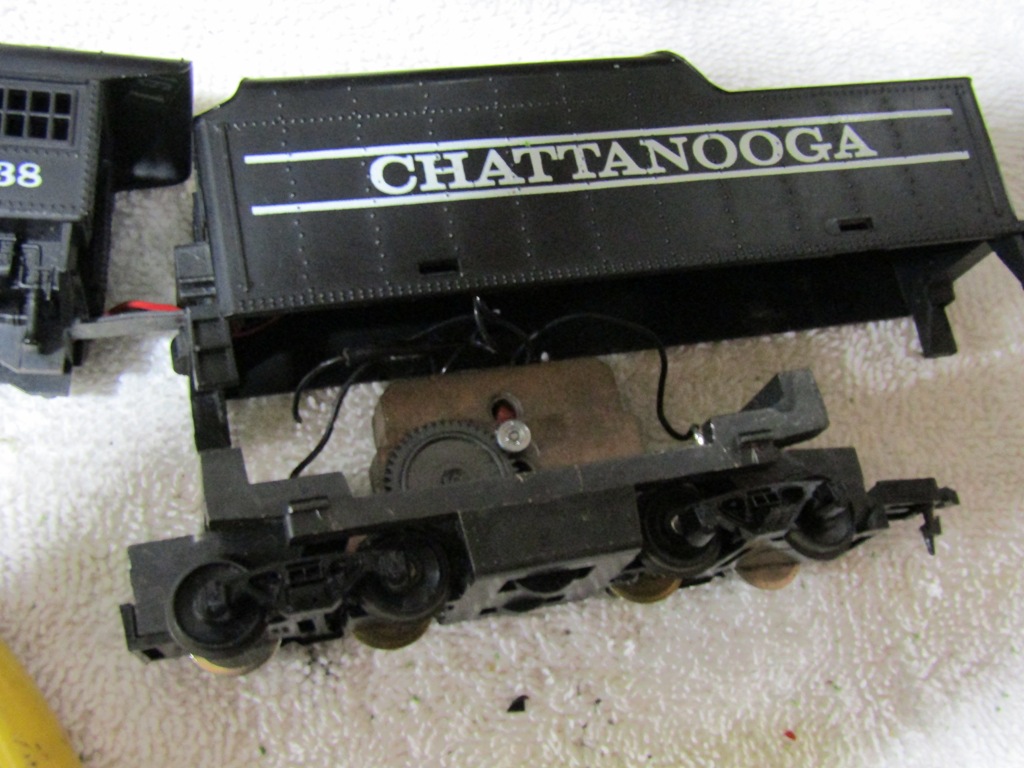

Today, I tried using the drill with a tiny metal-boring drill bit, to "rough up" the surface of the drive axle...and then re-affixed the pinion gear to the drive axle with liquid cement. We shall see tomorrow.
Ultimately, I hope to find a solution or at least a strong enough glue, to fix all loose pinion gears.....that way I can hopefully fix up the rest of my Tyco PT locomotives....

Well, after letting the glue thoroughly dry for over a day, I tested out the BN GP20 tonight, and after a little bit of coaxing, the PT motor took off and the GP20 is running great (so far.) I ran it for about 5 minutes, and the pinion gear didn't pop off. Tomorrow I will attempt to take a video of it pulling 5-10 cars for about 10-15 mins, as that will be the ultimate test. I really hope this has worked permanently, because I then can use the same strategy on my Chattanooga steamer...and make a how-to video...

Then, I moved to my Chattanooga steamer, and using the same process as repairing my BN GP20, I "roughed up" the surface of the PT drive axle with a drill bit, and re-glued a new pinion gear on the drive axle. I will return tomorrow once the glue has fully dried, to test out everything - I really hope this PT fix works for my Chattanooga steamer.

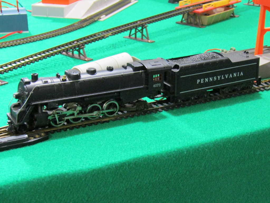

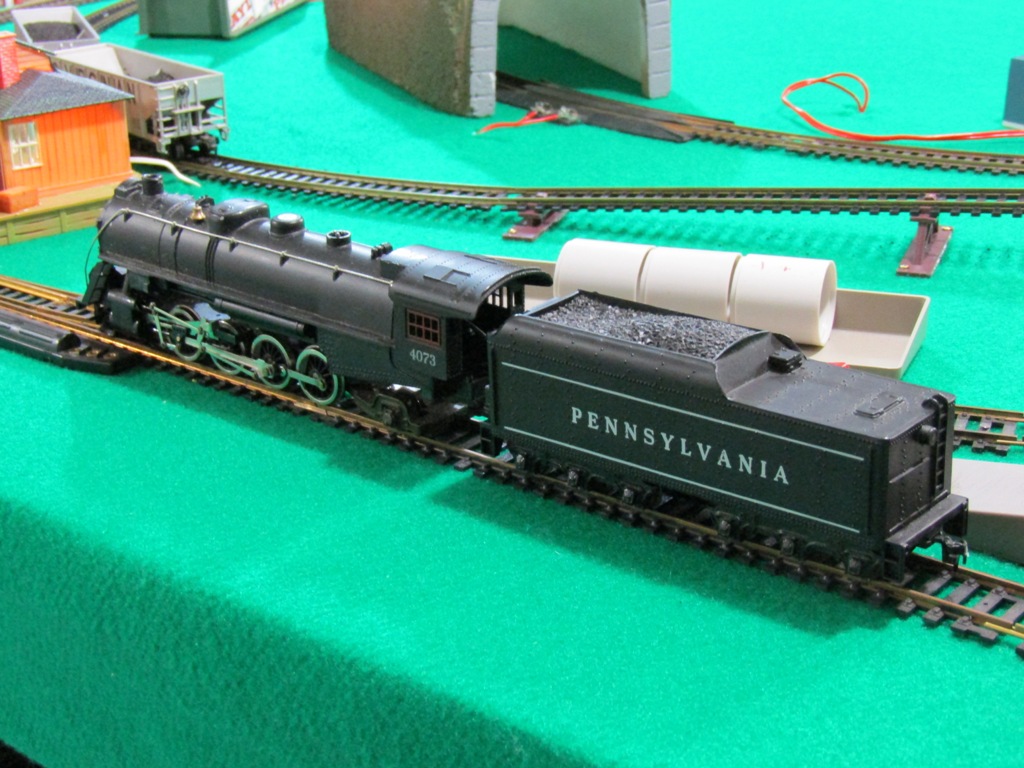

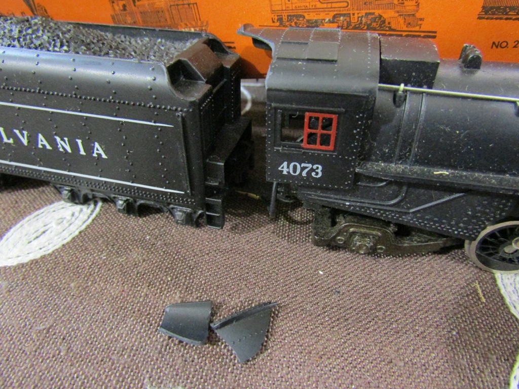

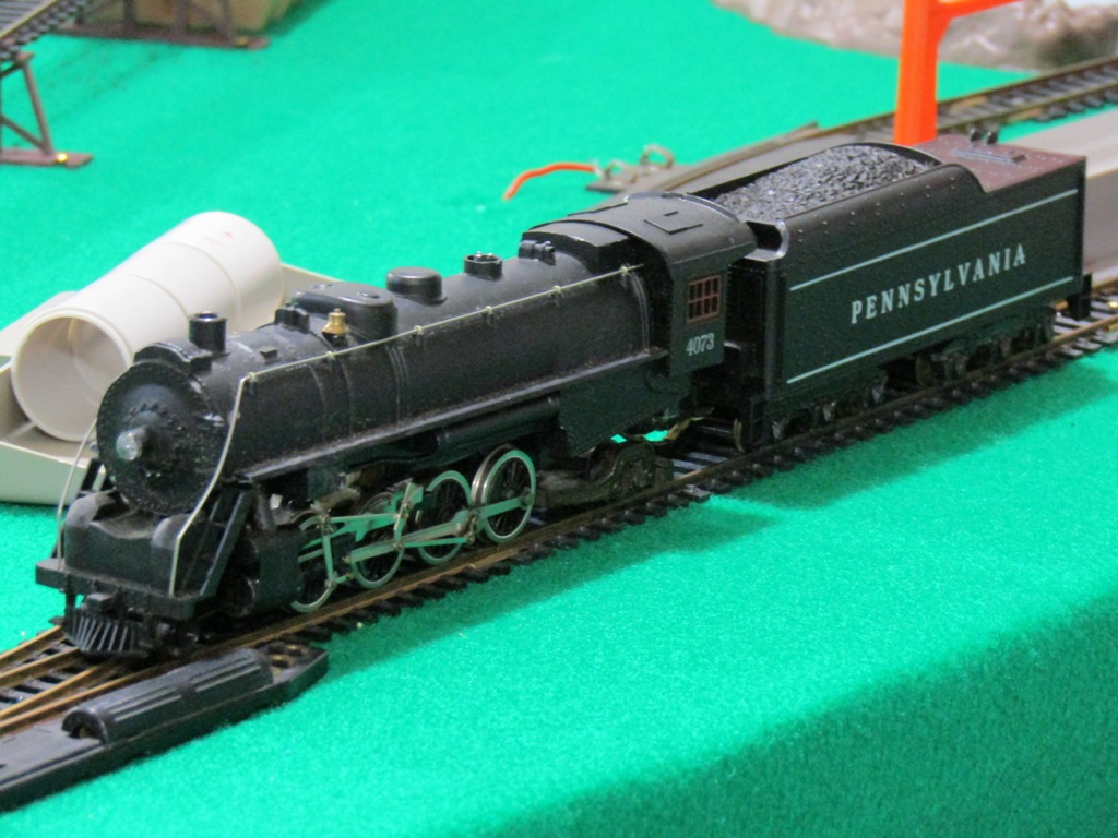

Here's some photos of my recently acquired Tyco PRR 2-8-2 "Mikado" -- which I am currently working on revitalizing to superb operating condition. Unbelievably, the USPS damaged the roof in shipping (as seen in the last photo, but luckily I was able to piece it back together with the help of liquid cement. I now realize that I most likely can buy a brand new cab, which I will do once I can get the Mikado working great again.
 Posted - October 15 2019 :  02:06:11 AM Link directly to this reply  Show Profile  Add Chops124 to Buddylist
Ouch, I hate when that happens. Really hope that Mike
quits fooling around and works right, that's a really
nice piece. I have a Mantua Pacific, which I rave on,
but never knew, again, that there was a Mike out
there. Another first, for me.

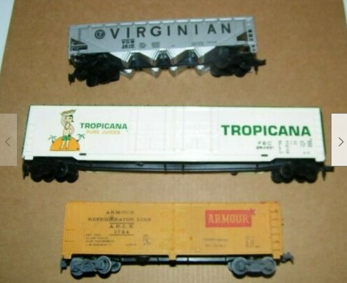

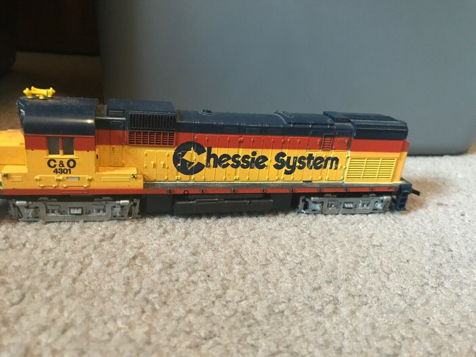

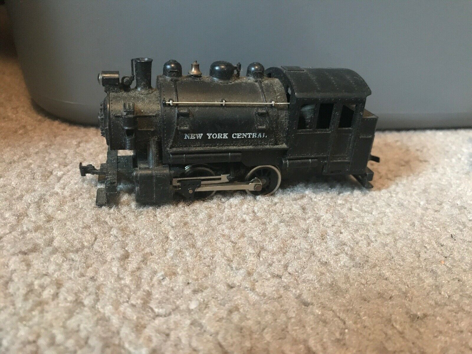

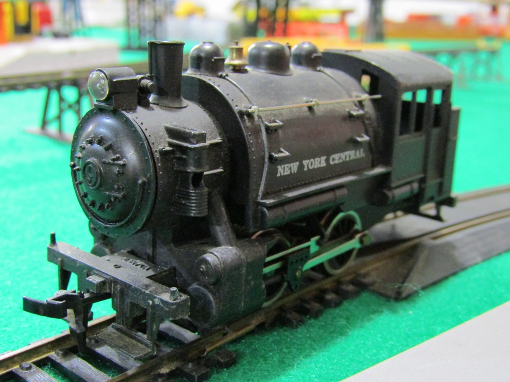

Oh Ebay, how I love thee........
Seriously, 95% of my best train deals have come from Ebay. Below is another such example:
I found both of these locomotives available from the same seller (first 2 photos credit to seller), both listed as "Tested - Not Working" and each for $9.99, free shipping.
Upon closer inspection, I quickly realized that both locomotives were intact and featured MU-2 style motors, which never die. I then came to the conclusion that either A) A wire was disconnected or B) the seller didn't properly "tune" or clean either locomotive. So I took the risk.
In the end, with a little bit of patience, both the Chessie System C430 and the NYC 0-4-0 run awesome! Both needed new front couplers, and while I have yet to fully tune the Chessie C430, the 0-4-0 "Booster" was cleaned, lubed, and tested for a good 15 minutes. Success!!

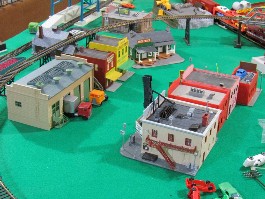

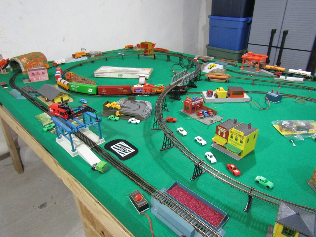

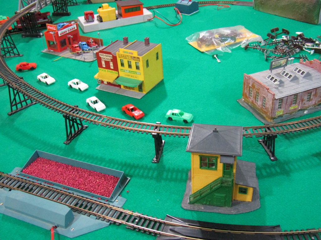

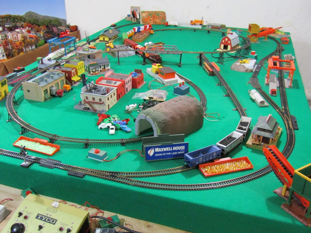

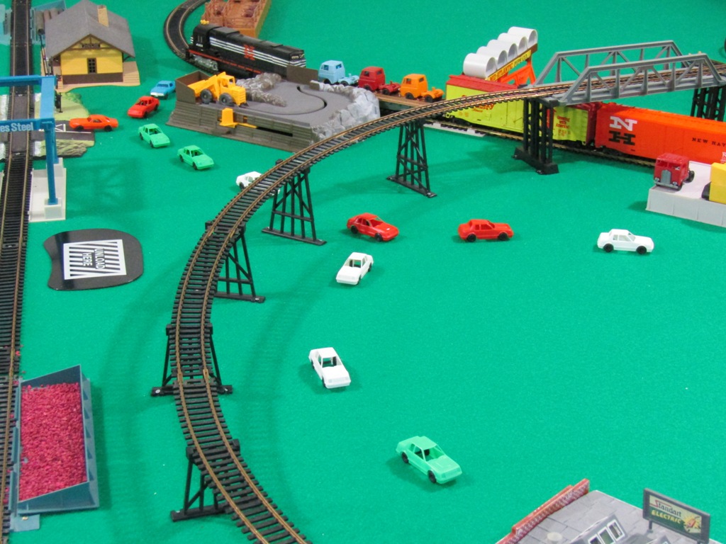

I've begun plotting where to place my Tyco cars on RETRO TYCO II.....
I truly want to imitate Tyco's Expander Layout, by recreating the dark-brown streets. Does anyone have some recommendations of what material I should use for roads? Maybe a brown cloth (but that would a pain to cut) or perhaps very thin cork board?
Obviously, I won't install roads until I get as many buildings as I feel are necessary to begin mapping out "Tyco Town." But, it doesn't hurt to plan.
Photo credit to Original Photographer

After re-soldering 1 wire back on in the tender of my Chattanooga 2-8-0 steamer, I put it back on the rails and it is running great!! Which means my process of using liquid cement to re-secure the pinion gear works!! This is the 2nd success I've had so far, and I'm the most ecstatic about my Chattanooga 2-8-0 steam locomotive for once again, running as it should.

What type of glue is the liquid cement?

It is Model Master Liquid Cement for Plastic Models.
Amazingly, it worked for 1 of my BN GP20's, and now on my Chattanooga 2-8-0 steam locomotive! Please enjoy this video of it in action on RETRO TYCO II this afternoon.
Ultimately, my plan is to repair another Tyco PowerTorque locomotive using this fix, and create a how-to video while doing so.

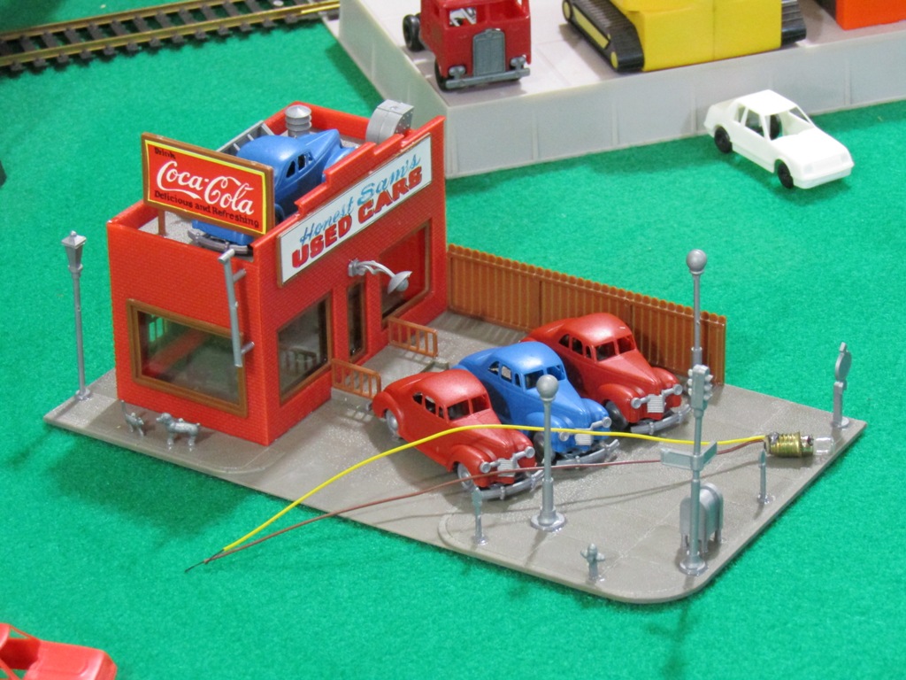

This afternoon I glued together the Honest Sam's Used Car Lot TycoKit, and it came out pretty good! I also drilled-out a hole in the "pavement" base to eventually wire-in the included light bulb.
FYI: the blue car on the roof is only serving to hold up the Coke sign as the glue dries. It will come down.
This, among a bunch of other train items, was obtained from a nearby neighbor who I also purchased my new N-Scale layout from -- "Alpenbahn."

Today I installed a new cloth on the bottom of my HO track cleaning caboose, spread some Labelle 105 on it, and ran it around the outer line of RETRO TYCO II. The results:
I then proceeded to run my Chattanooga GP20 around, and immediately noticed that although it no longer was experiencing numerous "loss of contact" spots, it was struggling around some curves/inclines on the layout. I then grabbed a dry microfiber cloth and gently wiped all the rails off.
Success! Here's the first video I've taken of train action on RETRO TYCO II in 2 weeks, and after track cleaning. The train still zips around, but amazingly only on 30mph on my Tyco powerpack! Before cleaning the track, I had to run my trains on 50mph or above in order for them to avoid stopping dead on the track in several places.

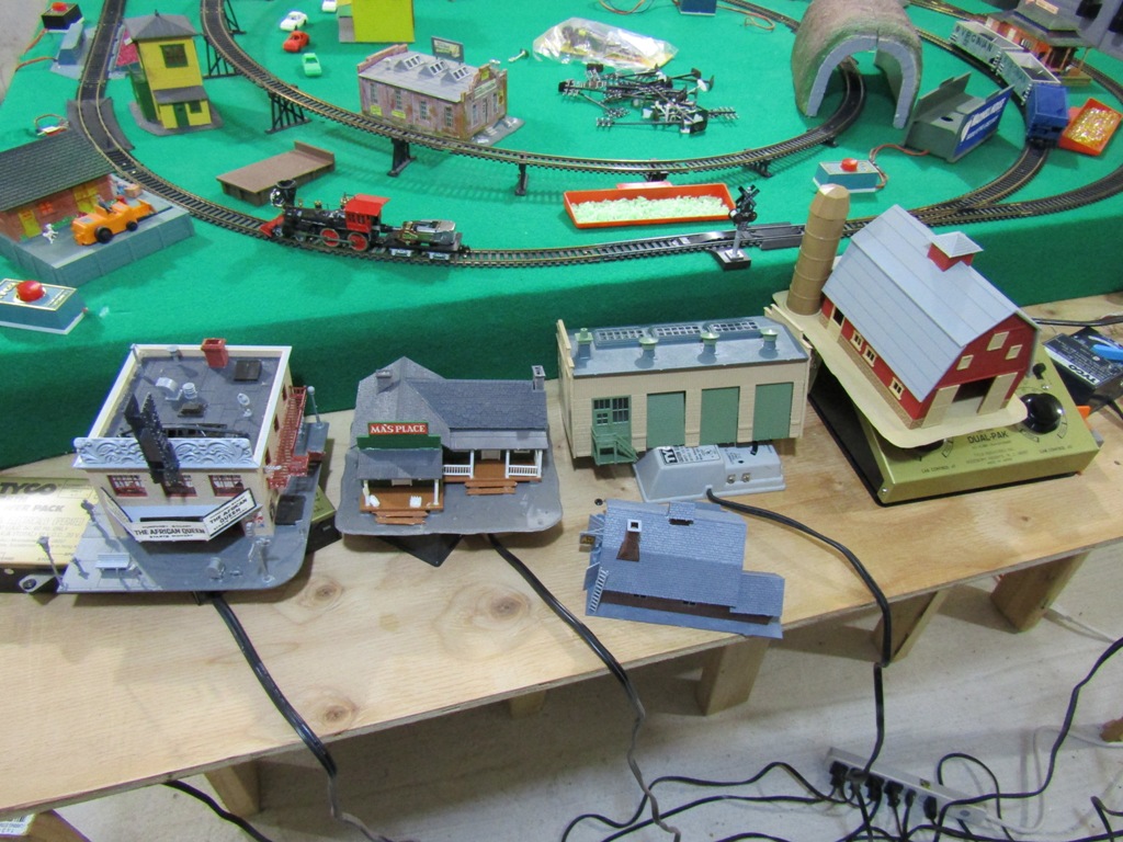

Even more TYCO buildings arrived in the mail yesterday. I assembled 2 of the NIB ones this morning.....
From left to right: Lowe's Theatre, MA's Place, Truck Terminal, Blacksmith Shop, & Barn w. Silo
Continuing to fill-up Tyco Town - Centre Street is looking good.
