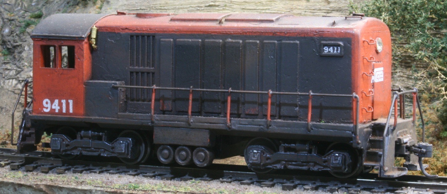

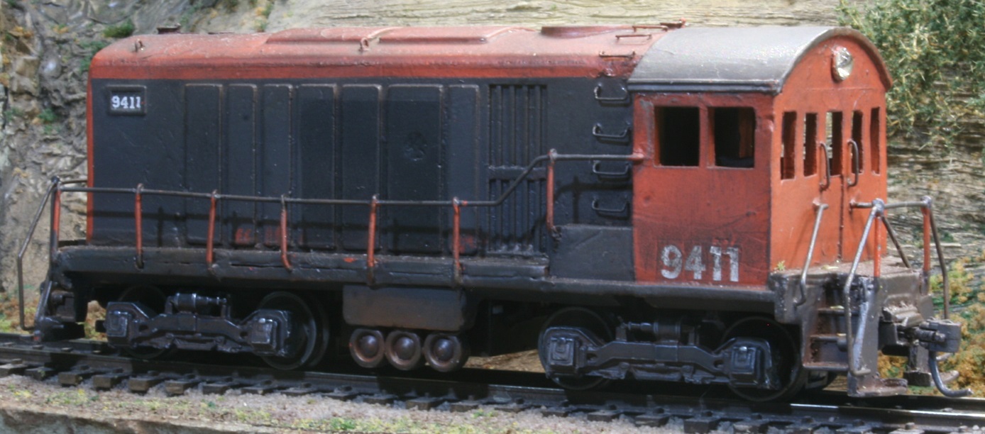

Those of you who subscribe to HO Collector magazine may recognize this model from the 3rd Quarter 2019 issue. In the article titled "Alco Diesel Timeline" author Tony Cook describes the shell of this model as possibly the first HO scale diesel ever offered to the mass market. Originally introduced in 1938, Walthers first offered the basic die-cast metal shell without a drive mechanism, it was up to the modeler to figure out how to power it. Eventually Walthers did produce a self contained power truck that could be purchased separately to make this model a fully functional locomotive.
Although crude by today's standards, it does capture the general look of an Alco HH600 switch engine. This locomotive started as an unassembled shell which I found on Ebay. To power it, I modified an Athearn SW switcher chassis and mechanism fit the shell. The original Athearn mechanism was also upgraded with "Blunt Truck" side frames and an Ernst slow motion gearing package.
For a prototype, I chose to model Penn Central locomotive 9411, the only HH600 that PC rostered. The real locomotive came to the PC when it acquired the New Haven and was never truely repainted by PC, receiving only a patch job to obscure the NH lettering. The only indication that this is a PC engine is a single mating worm emblem on the front of the hood and a PC locomotive number.
While the detailing of this model is not up to modern standards, this locomotive can still hold its own on a modern layout.

 Posted - July 28 2019 :  7:08:59 PM Link directly to this reply  Show Profile  Add Chops124 to Buddylist
One of the more interesting pieces of late. A true
piece of the early HO, and so beautifully rendered.
The paint scheme has a most interesting history.
Srenchin
CNRedAvatar
 Posted - July 28 2019 :  7:29:30 PM Link directly to this reply  Show Profile  Add Srenchin to Buddylist
Originally posted by Chops124 - July 28 2019 :  7:08:59 PM
Well you can thank Penn Central for being to cheap (or broke) to give the 9411 a proper dip job repainting.

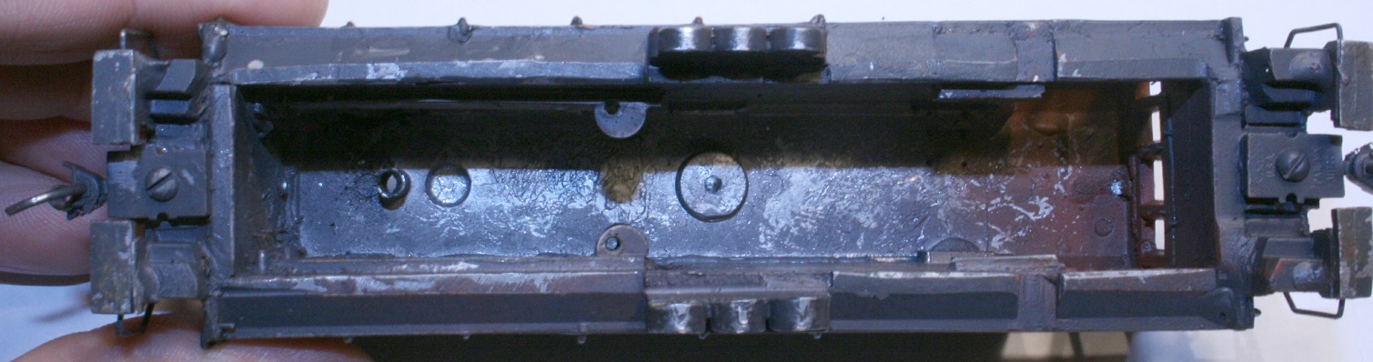

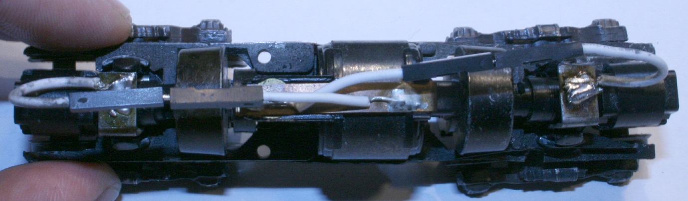

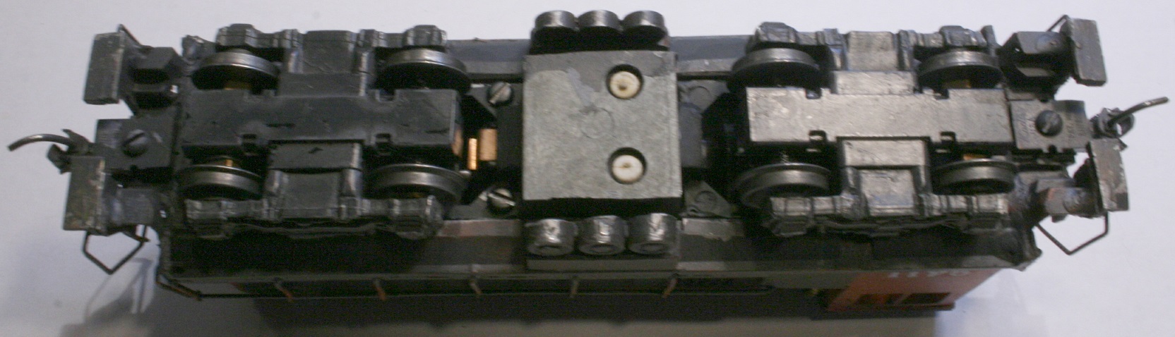

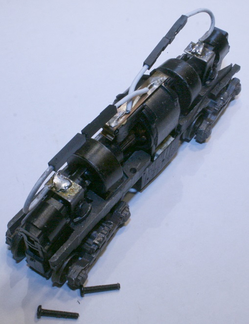

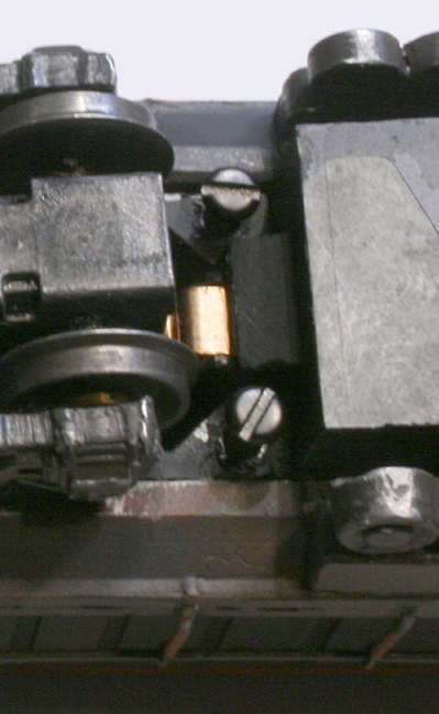

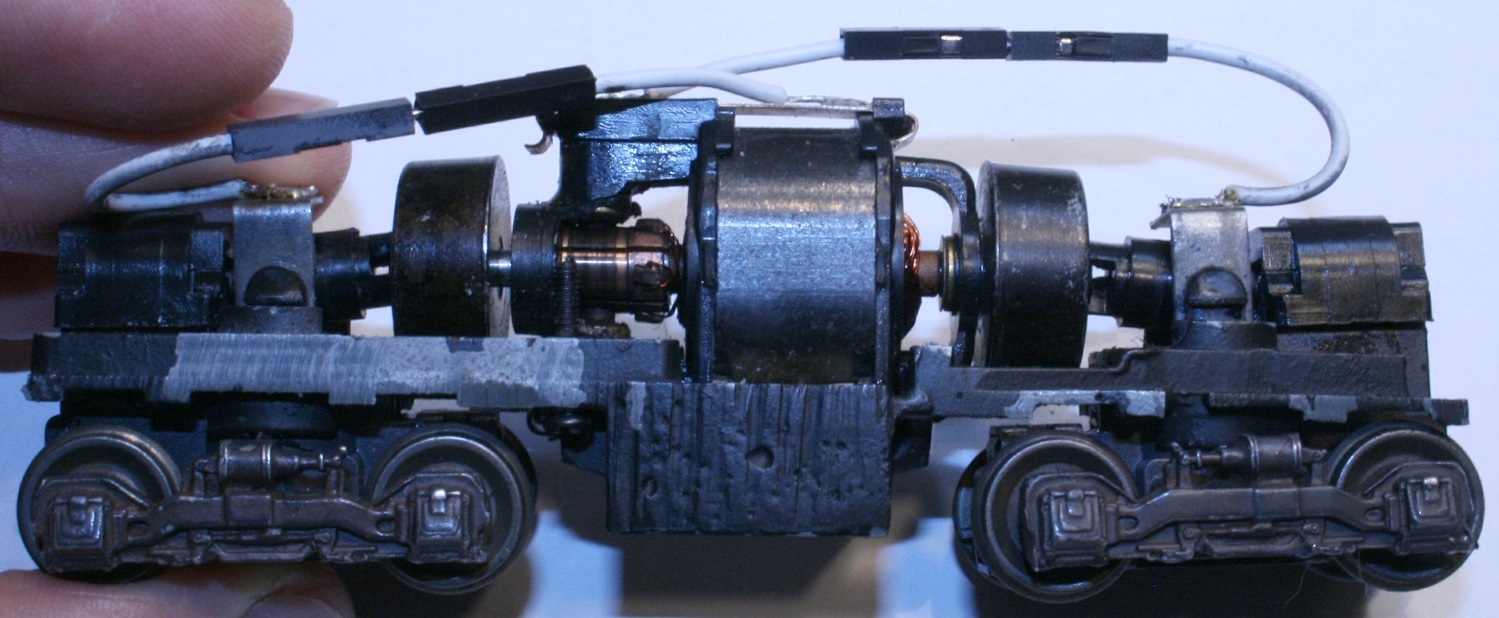

For those of you who are interested in how I modified an Athearn drive for this shell, check out the following photos...
In this photo you can see the two screws that attach the shell to the chassis...
Here is a close up of the screws...
In this photo you can see how I had to cut off the ends of the Athearn frame...
In this photo you can see where the screw holes are located flanking the motor commutator....
In this photo you can see how I trimmed the sides of the Athearn fuel tank to fit on the Walthers shell...
In this photo you can see how I adapted the shell to the athearn frame, I used styrene plastic strips to provide a lip for the Ahearn frame to rest on. The half round pieces provide a location for the chassis screws to screw into to hold the two components together. I used CA super glue to hold all the parts of the shell together.
