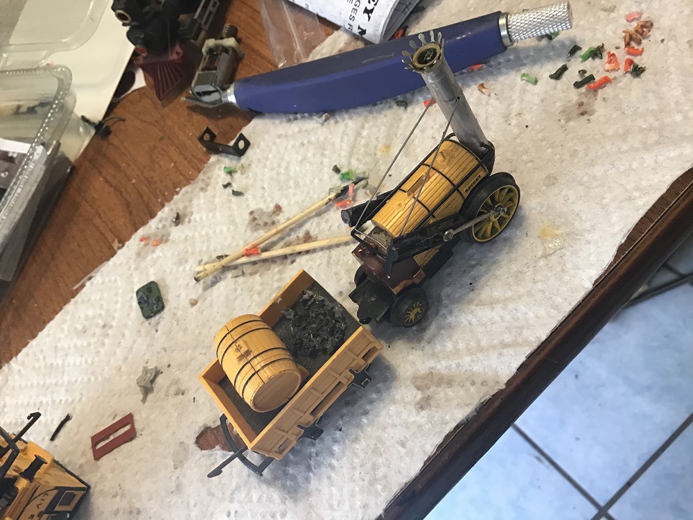

The original motor in these old Triang pieces, later Hornby, were,
regrettably, garbage. Basura. Kaka. No good. Oddly, even though
eBay demand is high, and they sell quickly North of $100, they
don't make them anymore.
So, having pretty much thinking my motor is kaput, I am
endeavoring to install a motor into a trailing coach to
act as a pusher.
To my pleasant surprise the gear doesn't really care what kind of worm it
is up against, along as it lines up. So I installed a new Hornby motor
vertically into an AHM switcher chassis, sawed to fit, only to discover
that it rides about 3 or 4 mm to high. Back to the drawing board.

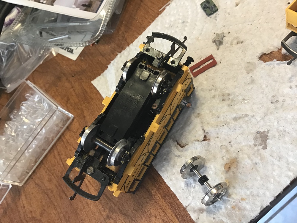

 Posted - March 16 2020 :  3:48:08 PM Link directly to this reply  Show Profile  Add Chops124 to Buddylist
After years of fiddling, and no, every AHM motor and every other one in the scrap box, was
a few millimeters too tall. Got this Tenshodo WB 31 power truck. Not a perfect fit; it was too short.
However, by removing one geared axle, and replacing it with a spare gearless OO axle to clear the
gear box, the ends fit nicely into the journal boxes after a little reaming with an Exacto blade. Now
the power unit is all tucked inside the coach body. To compensate for the loss of a powered axle,
an ounce of weight is being glued to the interior roof.
The locomotive is now a dummy that will get pushed. The axle is a little tight, will try to lube it up, if
that doesn't work, will open it up and widen the axle slot.
