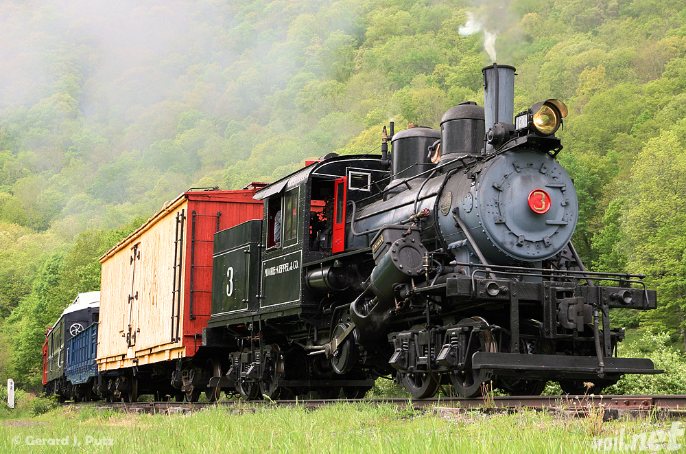

durbin west virginia

Just as an aside, the MDC Climax is a class A climax. It would have something like a marine steam engine in the cab, driving the drive shaft to the trucks. Last I knew, there was a 3 foot gauge class A in West Virginia, not on public display but owned and run by a private owner.
The one shown in Ken's post is a class B, which has two trucks and visible cylinders. A three truck version is a class C.
The only climax I have personally seen running was the class B on the Durbin and Greenbrier Valley. It's a handsome little beast and it's firebox must be very well designed. It almost always runs with a clear stack indicating very complete combustion. I've heard that it's the prototype for Bachman's HO Climax.
