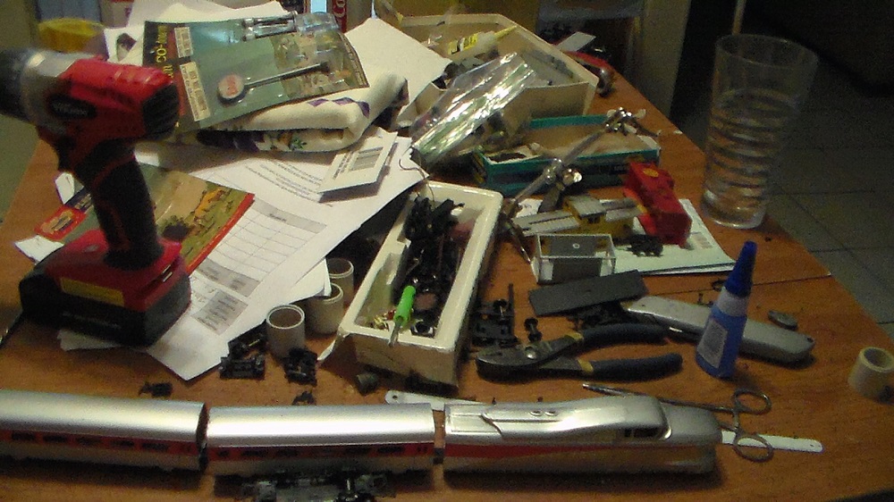

Struggling to get this nice old Varney shell powered up, it is such a nice
signature piece for the zany Armadilloville. Anyone who knows me knows
that I am pretty much a "shake-the-box" kind of modellor, but even so
this looked like a pretty easy conversion from dummy to powered.

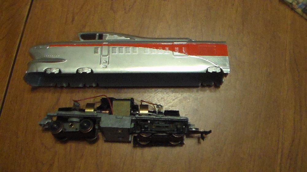

First, I got the Athearn BB SW1500 chassis slightly disassembled,
as per the advice of Frank, rather than sawing it in half, which is
what my first instinct was.
Then with a few shims of spare styrene I carefully fitted it into the shell
with careful attention to leveling the chassis so that all four drive wheels
set flat upon the rails and had adequate swing room, and that the axle ends
lined up with the cast on journal boxes. So far, so good.
Upon testing it, it immediately made a habit of derailing, as lo and behold,
the drive truck whether by torsion or malposition of a half millimeter or
so didn't quite set flat, and track has inherent ups and downs in it.
This was cured by adding a few ounces of lead weight, and then it
purred along nice as a kitten; no more derailments.

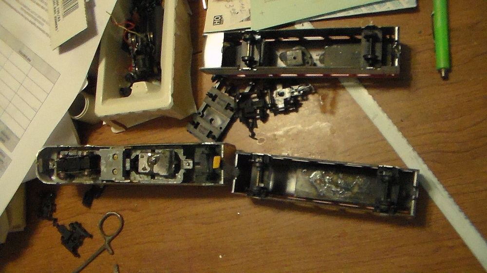

From there, I added the two coaches, which are connected by means
of a plastic draw bar. They're very light, the coaches, and so I added
an ounce of weight to each.
The second coach kept jumping of the rails, and a closer inspection
showed that there was some lateral tension, like a mini-spring board,
from the drawbar from the locomotive, which raised the front wheels
of said coach just enough off the track to make the flanges crawl over
the rails on curves. Added some more weight, and that seemed to
fix that particular wagon.
Then the third, last, coach would derail from its front axle, pulling
the entire coach off the rails. So I kept adding weight to it until it
weighed close to a full pound, and the locomotive could barely pull the
entire consist at all.
After close inspection, it appeared that the draw bar, again, levered the
front axle up just enough for the flange to jump the rail, and no reasonable
amount of weight was going to fix that.
