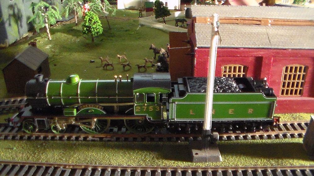

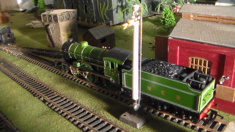

My offering this week is a Cheshire 4-4-0 I purchased on the UK Model Railway Forum. It is
NOS from 1983 Hornby, probably from one of the last production runs before everything went
to China. As in quite a few British units, it has a rather stolid tender drive. It comes with a
fireman and engineer, yet to be painted and installed, and a smoke unit. I don't dare light it
up until I lubricate it, if I can find my gear grease. Seen here, parked on my British OO layout,
"Bamburgh."

Good looking loco Chops...

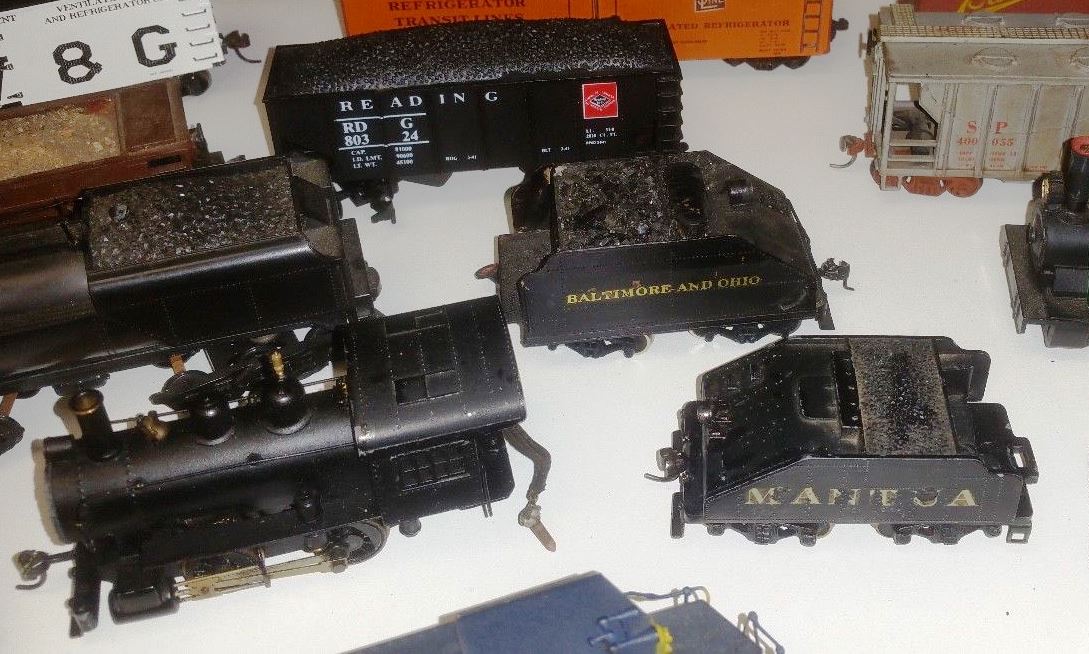

My LOTW offering this week is a Mantua 0-4-0 Mighty Mite from the later 40's, early 1950's...
 Posted - June 25 2018 :  3:03:12 PM Link directly to this reply  Show Profile  Add Barry to Buddylist
Hey Sean. That's pretty cool the tender has the MANTUA lettering.
 Posted - June 26 2018 :  4:17:32 PM Link directly to this reply  Show Profile  Add Chops124 to Buddylist
Wow~ that mighty mite is a piece from the "True Cross" of HO,
back when HO was an exotic miniature. It would be great to
see that thing restored and running with original couplers.

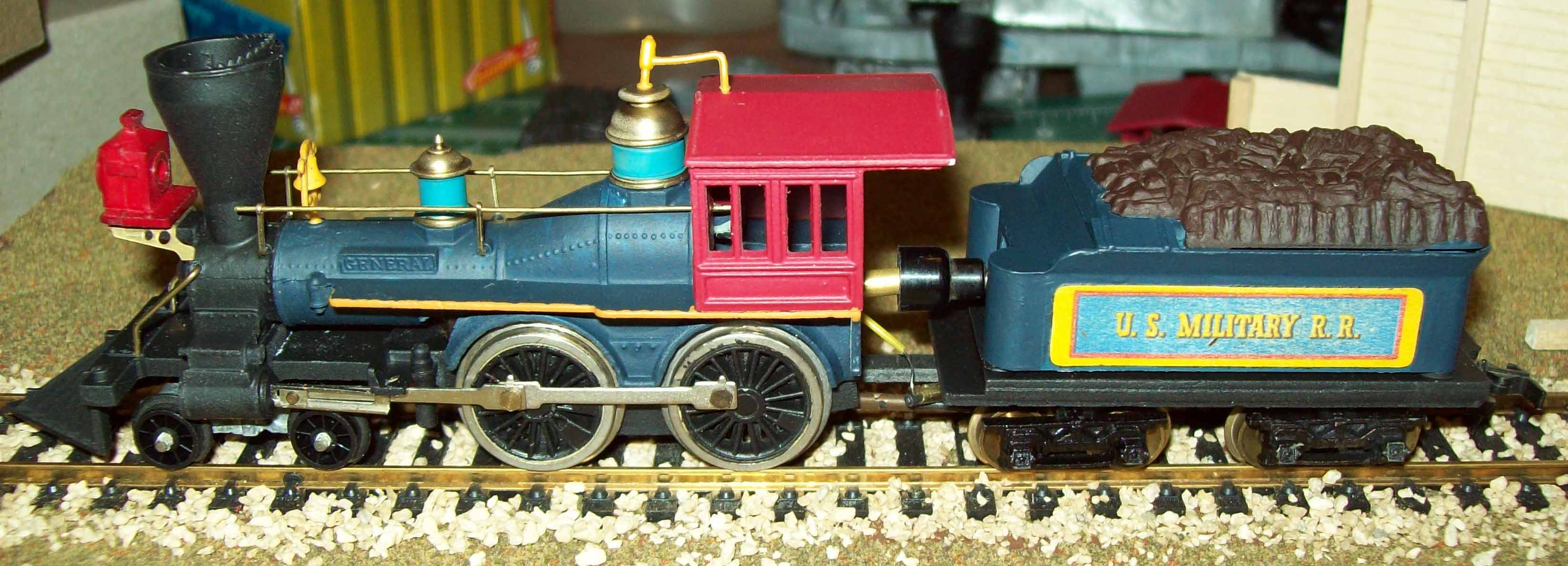

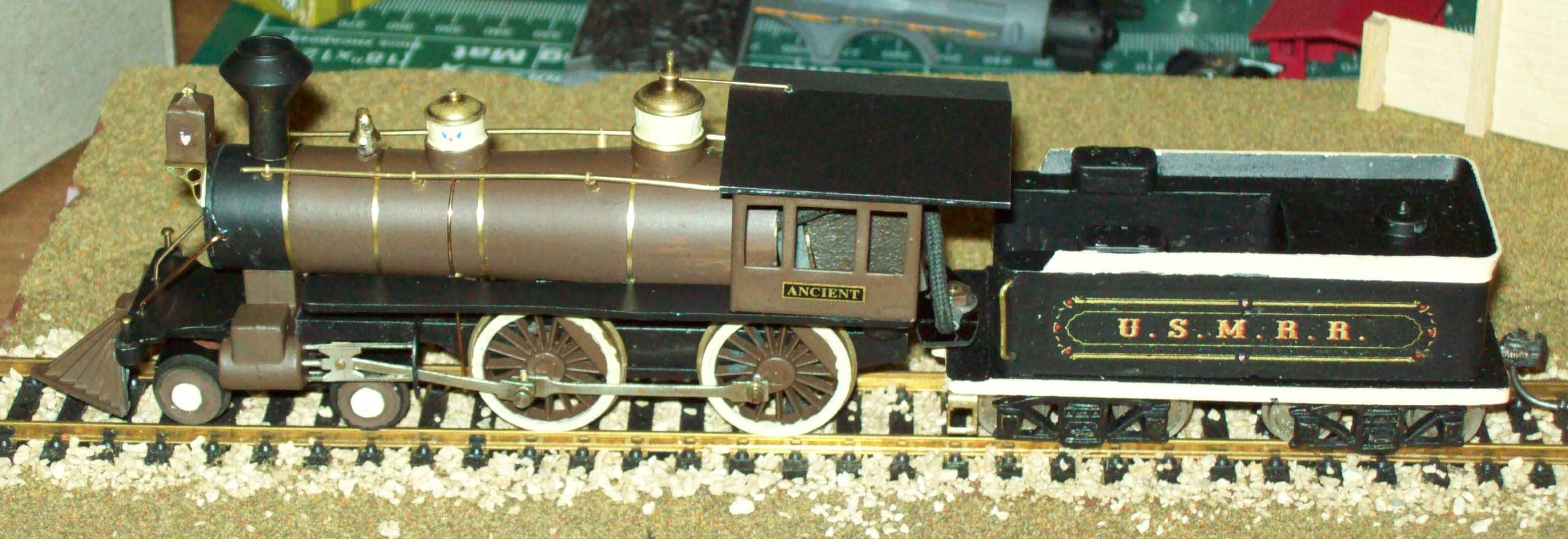

I've got 2 locos this week. First up is a restored USMRR Mantua General with smoke unit.

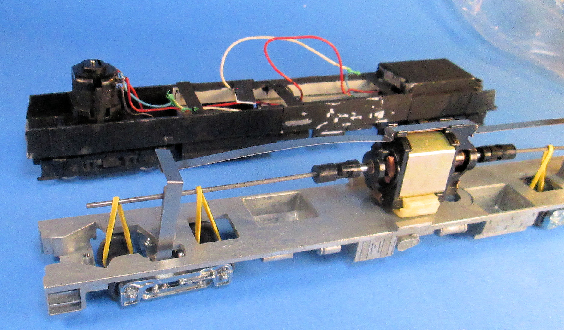

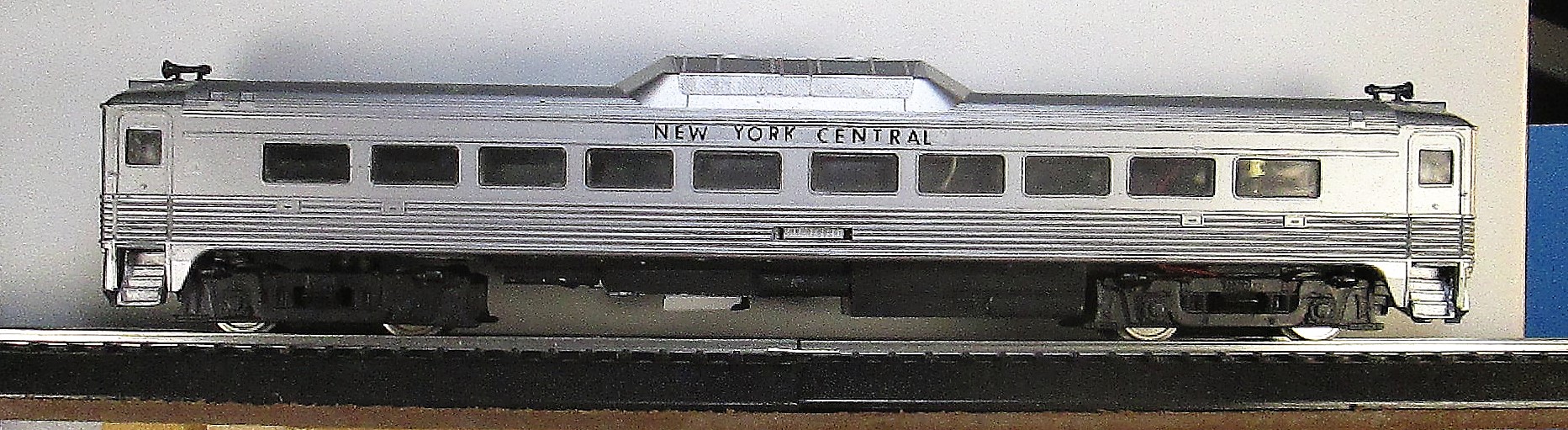

Kind of a locomotive. I alway liked the BUDD RDC, but not the Athearn rubber band drive.
I repowered this one with an old AHM F-7.
I had to lengthen the F-7 fraame to fit the RDC. While I was at it, I added pick-ups to both trucks.
The steps were part of the Athearn frame. I added steps to the F-7 frame cut from a junked passenger car.
The trucks and frame being black instead of silver hides the fact that it's not the correct frame/trucks, but I like it. It moves a lot smoother with this power and improved electrical pick-up.

Now, I've heard of repowering AHM locos with Athearn drives, but never the other way around! Interesting work, though I might've just taken the motor and trucks from an Athearn F, geep or U-boat, swapped the sideframes and motor and made some new driveshafts. But heck, if that thing works, very cool!

Very nice. How did you fasten the chassis together? What did you use
as a splice? The cut looks laser perfect, so I assume you used a jig?

Thanks,
The AHM chasis in an Athearn Body was because I'm cheap! I got a real good buy (like $5.00) on a working F-7 'cause the body was pretty messed up. I just marked out with masking tape on my workbench where the truck centers had to be. It looks neat 'cause I cut on the end of the fuel tank, using it as a guide. Then with the two ends taped in place on the bench I super glued in two lengths of 1/4" square Plastruct tubes to bridge the gap. I added some other odds and ends on the bottom for "battery cases", "air tanks", etc. to busy it up.
