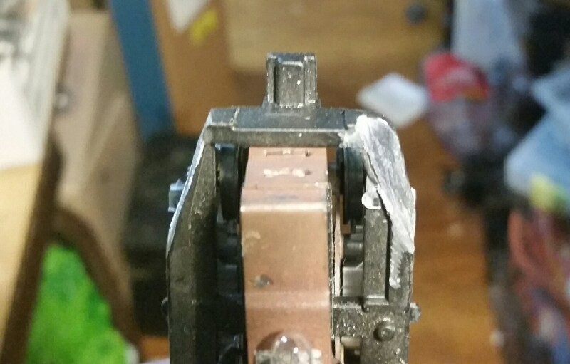

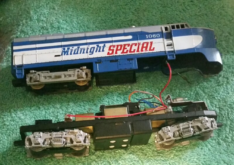

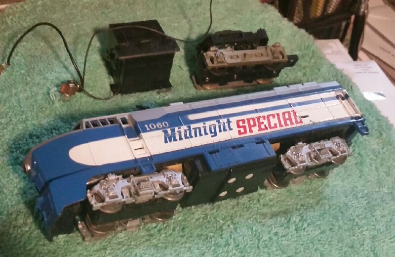

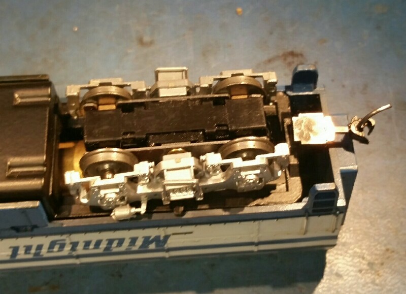

So,, brainstorming recently, I have been wanting to re-power a Tyco shark to run (reliably) at train shows. I found a nice Athearn chassis in my office at work I'd forgotten about. #42005 on the botton. Maybe an F7 unit? Anyway, I came home Tuesday night, and got out the Midnight Special I'd gotten from the train shop, it was missing the front truck. Took it all apart, the weight was extremely hard to pry out, I thought it was glued in at first, it finally popped out. Geez! Then the fun ( and mods ) began.
First, I trial-fitted the chassis inside the shell, or tried to. The front Athearn coupler mount hit the plastic coupler tower on the Shark shell, that had to go. I cut it down, got clearance. Retried the fit, the front of the frame wouldn't seat fully. Hmm, have to trim off some metal up front, too. Got out my dremel, and modified the front frame two different ways. Once done, it fit inside the shell snugly, and the bottom tabs on the athearn shell chassis rested nicely on the bottom edge of the Tyco shark shell, the side tabs fit in the slots, and it seems like it will work fine. Yay! I may need long coupler shanks to make it work, but that's OK. Happy to fit a nice Athearn chassis under a Tyco body successfully!
Here's some pictures of the work.

Nice job there. Does ti run as well as it looks now??

 Posted - June 06 2018 :  8:36:40 PM Link directly to this reply  Show Profile  Send AMC_Gremlin_GT an AOL message  Send AMC_Gremlin_GT a Yahoo! Message  Add AMC_Gremlin_GT to Buddylist
Originally posted by oldtimer52 - June 06 2018 :  11:23:09 AM
The Athearn chassis DID have a decoder installed at one time, but had been removed, I had wired it for DC, and tested it before modifying it. It runs smooth and quiet. It will get a decoder again soon. I wish there were some nice blue and white passenger cars to match it, seems like Tyco only sold it in a freight set. I think it'd look better in a passenger consist myself, but then the caboose would be out of place.

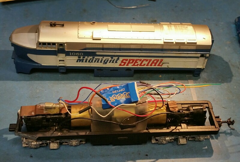

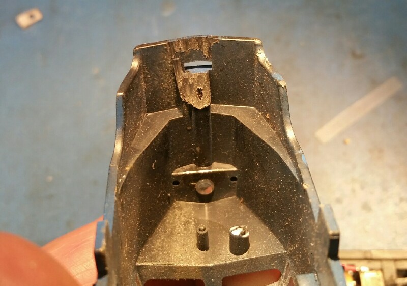

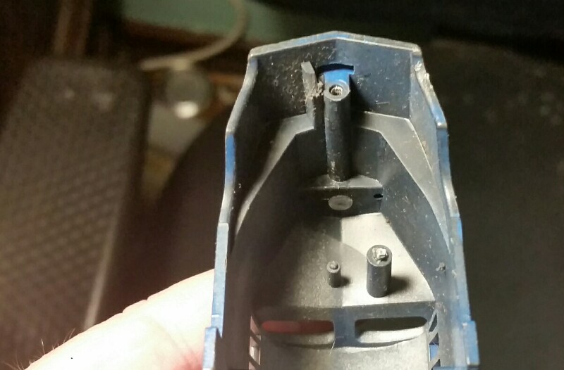

Here's some more pics of my Tyco shark upgrade. I had to trim the light bulb tower in the shell, it hit the truck tower and kept it from swiveling easily, and also skewed the chassis inside the body. One snip, and it cleared up the problem. I was able to use a long shaft kadee on the rear, but it's close, and even that long coupler ( #36 I think ) wouldn't reach in the front, so it won't get a front coupler for now. But it DOES have a new decoder, I will test it at the shop on Sunday.
Here's the new decoder installed as of Friday night. Yay!
Here's the nose mods I did - trimmed down the lightbulb tower, and cut back the original coupler mount tower.
And the rear coupler installed. It's close, should be enough clearance I hope.

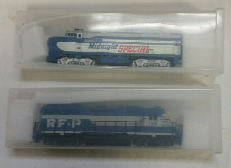

And ready to carry to shows in the Wal-mart pasta containers I love, $1.50 each, work great for engines and rolling stock.

By the way, those Walmart pasta boxes are Awesome!! Do you know if they can contain a boxed car or loco, or does it have to be loose?

 Posted - June 09 2018 :  7:13:45 PM Link directly to this reply  Show Profile  Send AMC_Gremlin_GT an AOL message  Send AMC_Gremlin_GT a Yahoo! Message  Add AMC_Gremlin_GT to Buddylist
By the way,... Do you know if they can contain a boxed car or loco, or does it have to be loose?
Originally posted by RP model railroads - June 09 2018 :  5:06:05 PM
Sorry, but most boxes will not fit. The Tyco brown box is 1/4 too "high" to fit inside. The old Tyco Blue-box kit box DOES fit, though ( from the '60s ). Athearn, Bachmann, AHM, all are a bit oversized to fit. I prefer them loose anyway, so I don't have to wear out a box taking the car/loco in and out, in and out. Plus I can see what it is instantly through the container. They'll have to be loose.
