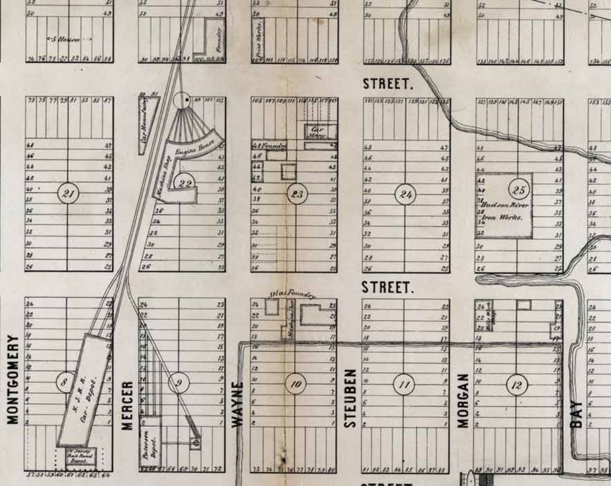

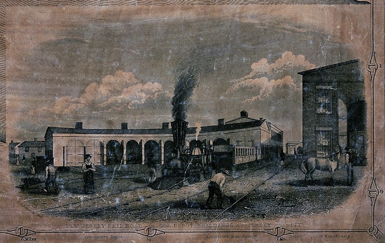

About a week ago I received from Bond 007 some Info on this depot. From this new info and other that I have found, construction can start on the NJRR depot 1841. This is a 4 day catch up as to where i am now.
Frank
The locomotive maintenance area lithograph. From a 1841 map.
Edited by - toptrain on May 22 2021 06:32:58 AM

Remarkable lithograph. A lot of historical precedents in that .
image.
Chops more to come. Allot more.

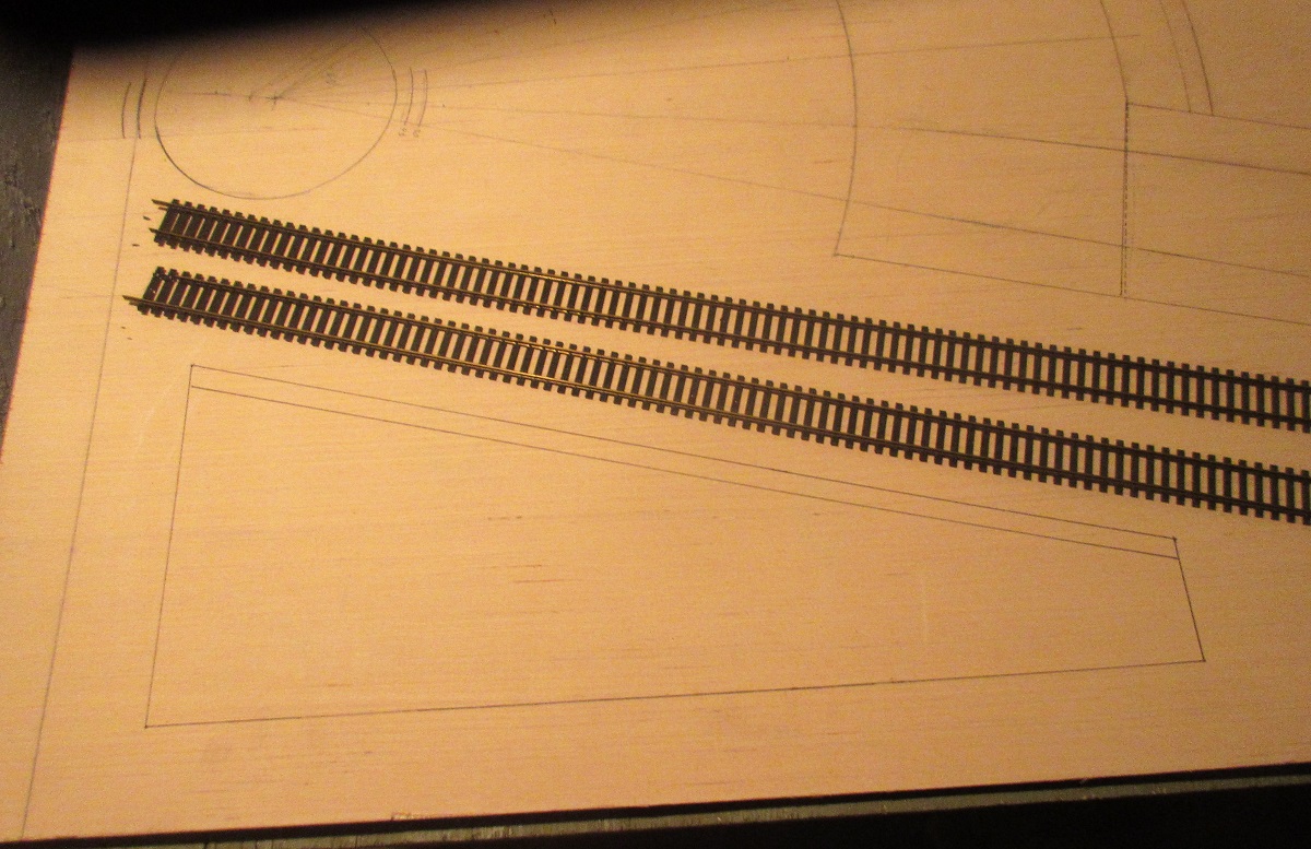

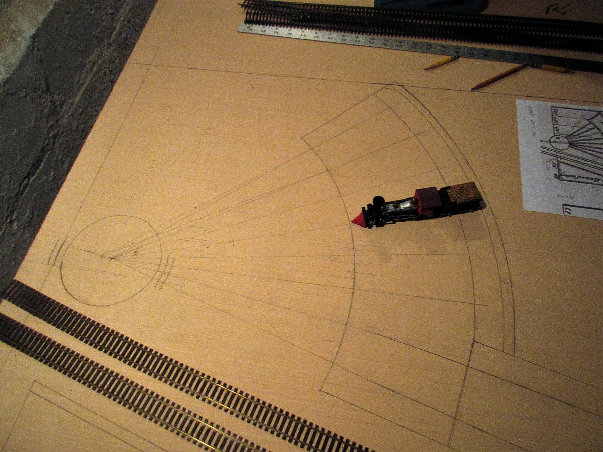

 Posted - May 23 2018 :  09:26:06 AM Link directly to this reply  Show Profile  Add toptrain to Buddylist
post 3

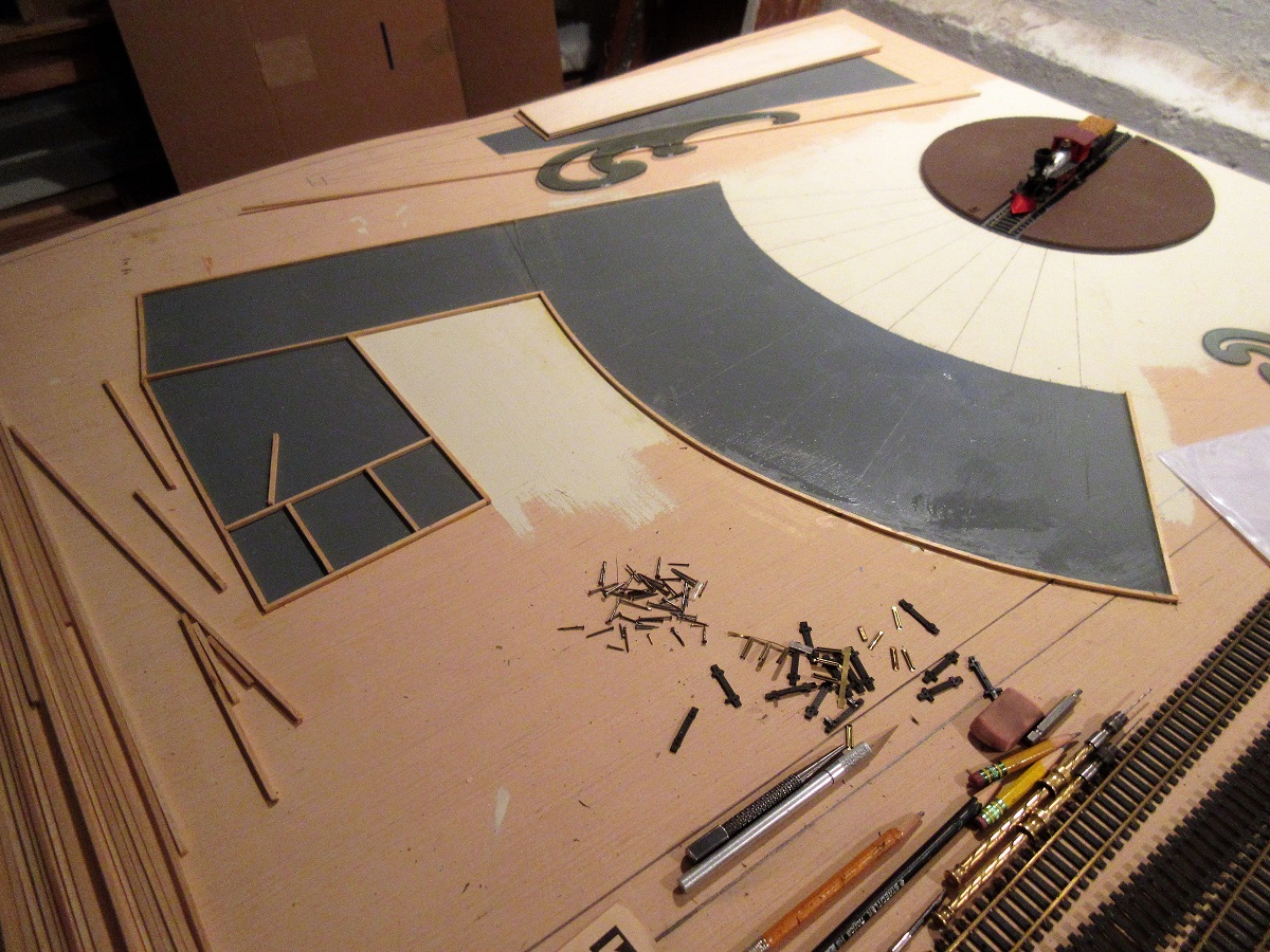

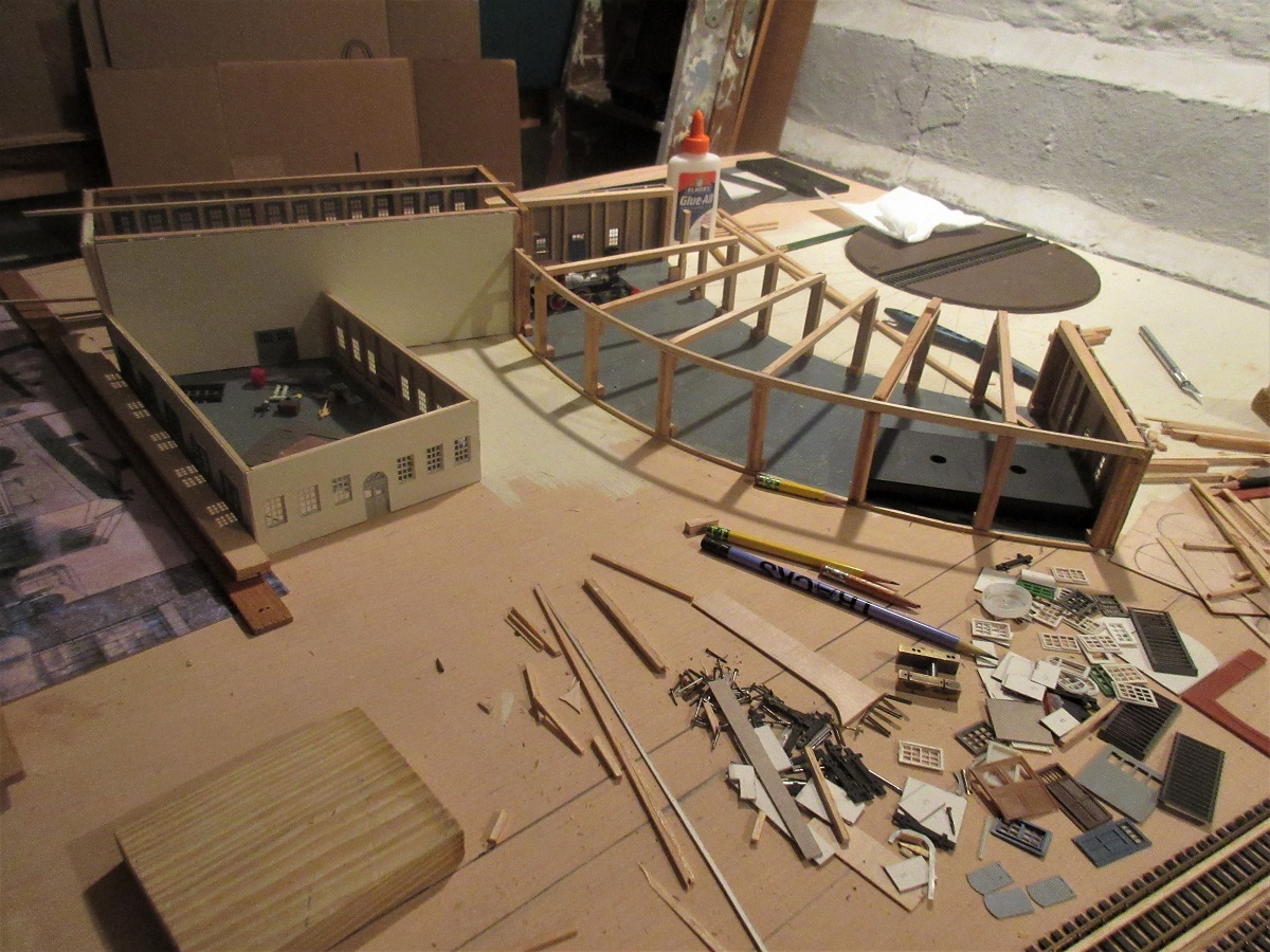

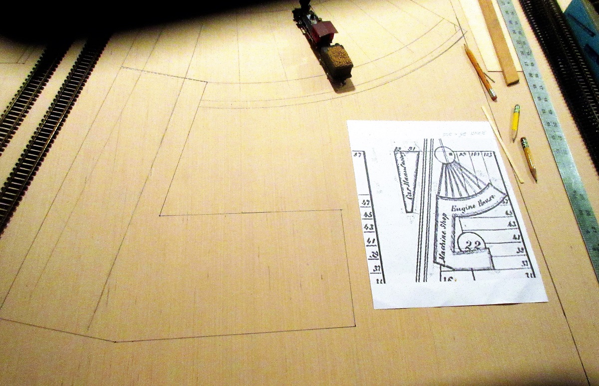

I will permanently build this on a appropriately sized piece of 1/8 inch finished plywood.
Then draw building footprints.
* Roundhouse and turntable; A problem in exact replication exists here. Both the roundhouse and turntable are shown in the print to be small. The turntable is less than 40 feet in diameter, and the roundhouse stalls only 50 feet deep. Now the locomotives being produced at this time easily fit into these dimensions. In 1838 when this railroad was in complete operation, running steam powered trains the entire length of the railroad using these new small locomotives of the time, I can see no need for wider turntables or deeper roundhouse stalls. As a historian I do know that before 10 years of operating, locomotives will be arriving that are too large to fit on or in either structure. Never mind what size locomotives will be arriving during and after the civil war. I have made my turntable larger to turn the older 4-4-0 type engines. A Tyco 4-4-0 just barely fits into the roundhouse. I have 5 or 6 of them i can use.
* With the turntable here in the north east having a open pit type just doesn't work well. They cause way to much work clearing snow out of the pit in the winter. Completely covered turntable pits are used. My covered turntable is one I had already, making it my choice.
* Back to the turntable. On post three you see the original footprint I drew of the buildings and turntable. The turntable is a 40 foot one and the first back wall a 50 ' deep roundhouse stall. If I had 6 or 7 HO scale period locomotives It would have been practical to use this small round house. I only have 1 complete one. A DeWitt Clinton. I do have just the locomotive for the John Bull. I do have 6 or 7 Tyco Generals. I can rework a couple of these into early and late Morris, Rogers, or Baldwin 4-2-0 types. Now when you look at post three's drawing and see the tyco general sitting inside the footprint of a expanded back wall stall you should know why I chose a 65' deep roundhouse. I chose the larger turntable because i am not able to make the track work necessary to connect 9 tracks to so small a turntable. Of 18 separate rails going to the table 16 must cross others just before connecting at the turntable.
Machine shop;
Car Manufactory building, for building and maintenance of rolling stock.
Edited by - toptrain on June 25 2018 06:56:45 AM

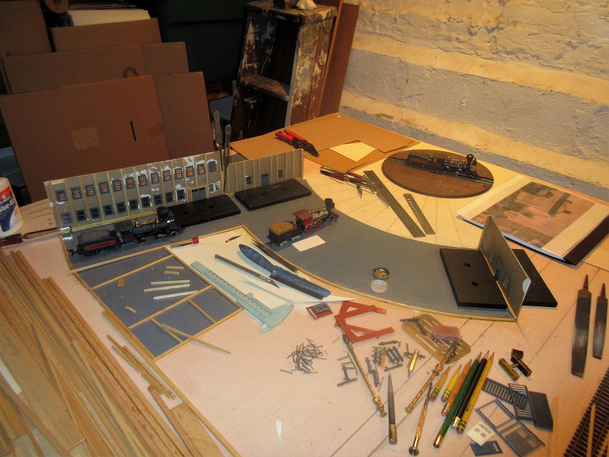

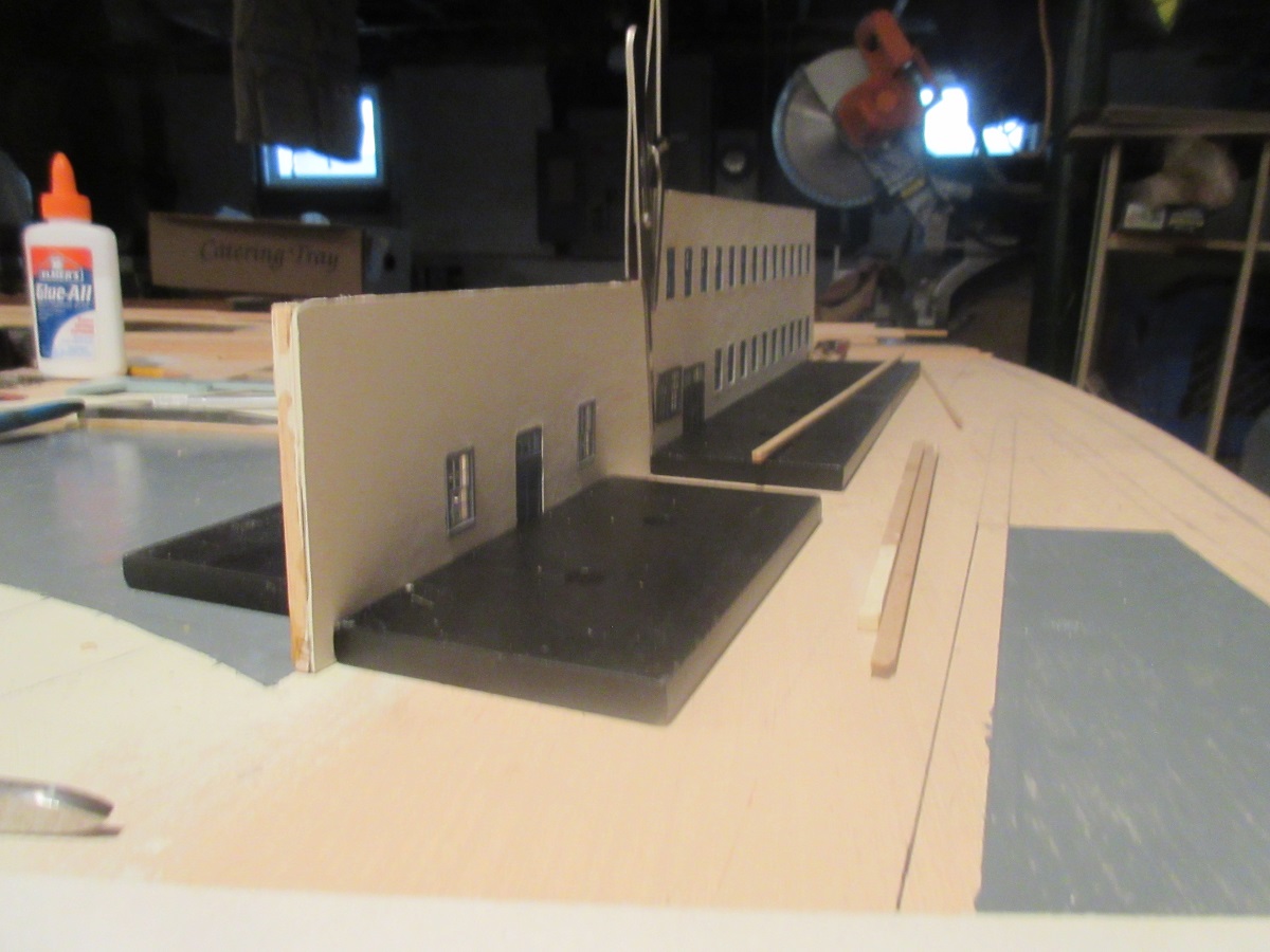

 Posted - May 23 2018 :  09:32:27 AM Link directly to this reply  Show Profile  Add toptrain to Buddylist
post 4

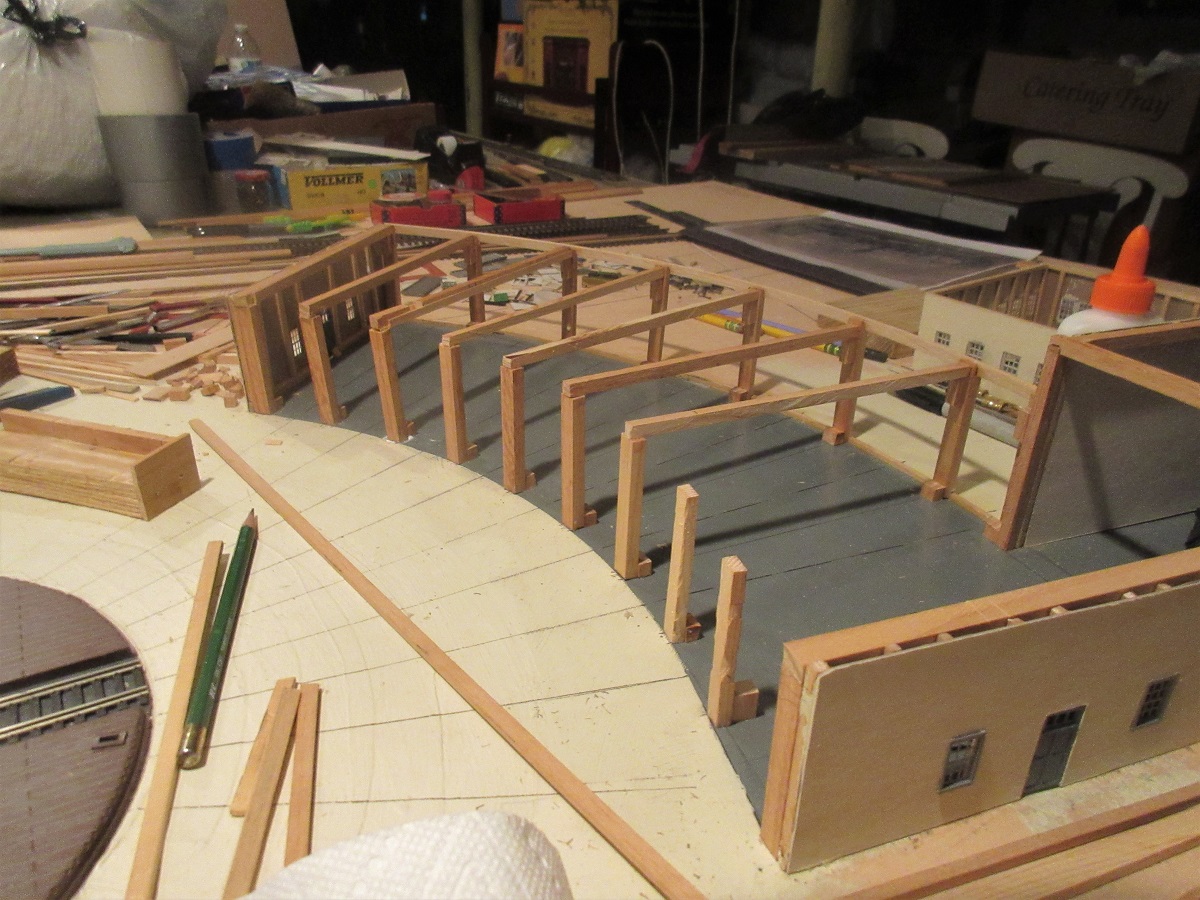

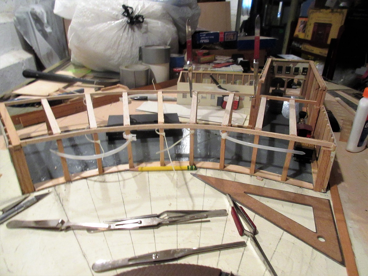

This is the combined roundhouse, machine shop, locomotive erecting and repairing building, in a nice clean and clear photo.
When i trimmed down and fastened about 1/8' scrap wood to make foundation. Making the curve took extra work and time. It took 2 strings on track nails, one inside and the other outside the curbing to hold it in place till the glue dried. I didn't take chances and let it dry overnight.
Edited by - toptrain on June 25 2018 07:16:28 AM

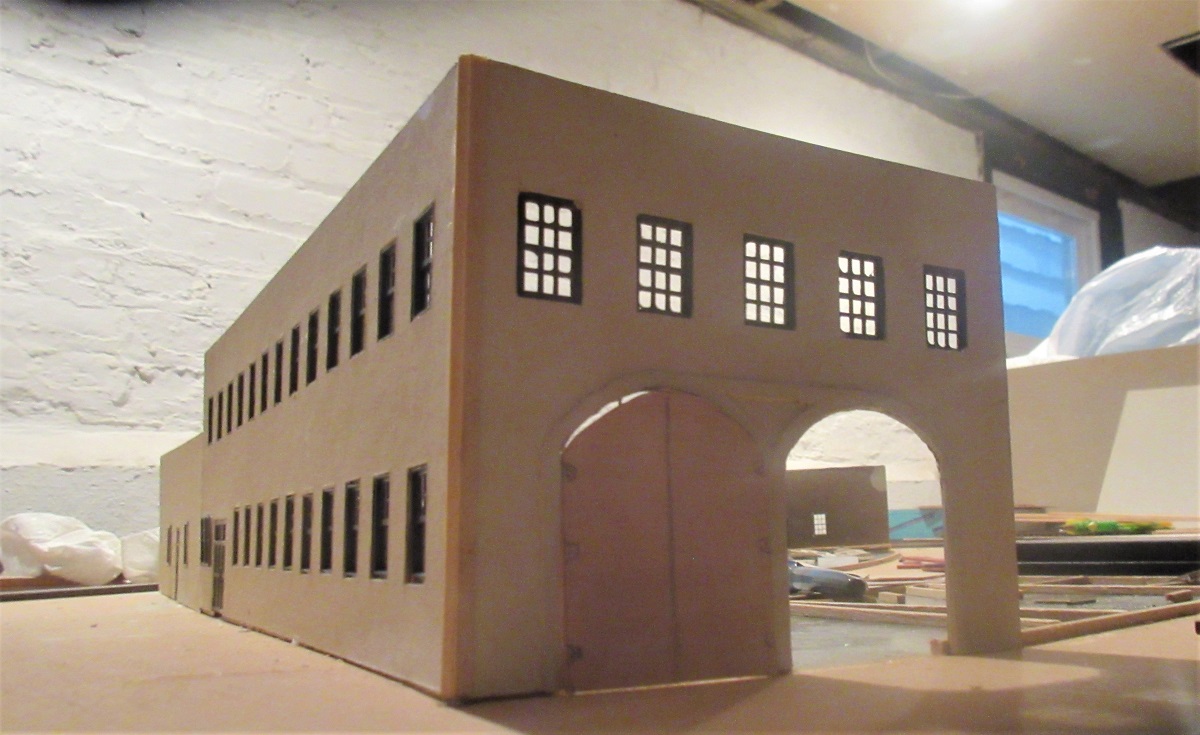

 Posted - May 24 2018 :  4:13:19 PM Link directly to this reply  Show Profile  Add toptrain to Buddylist
post 9

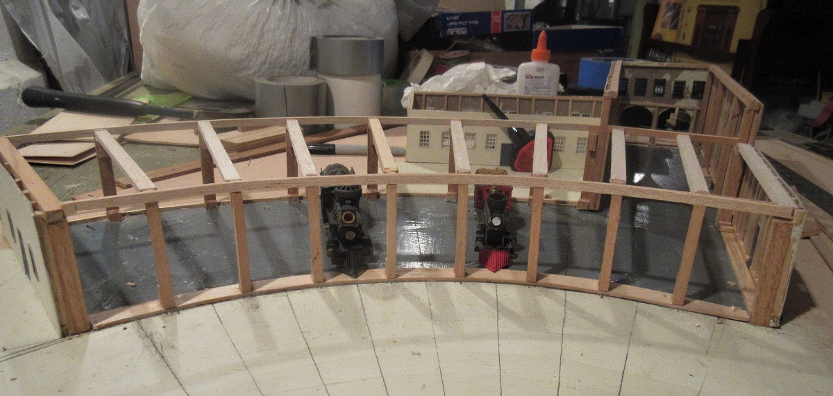

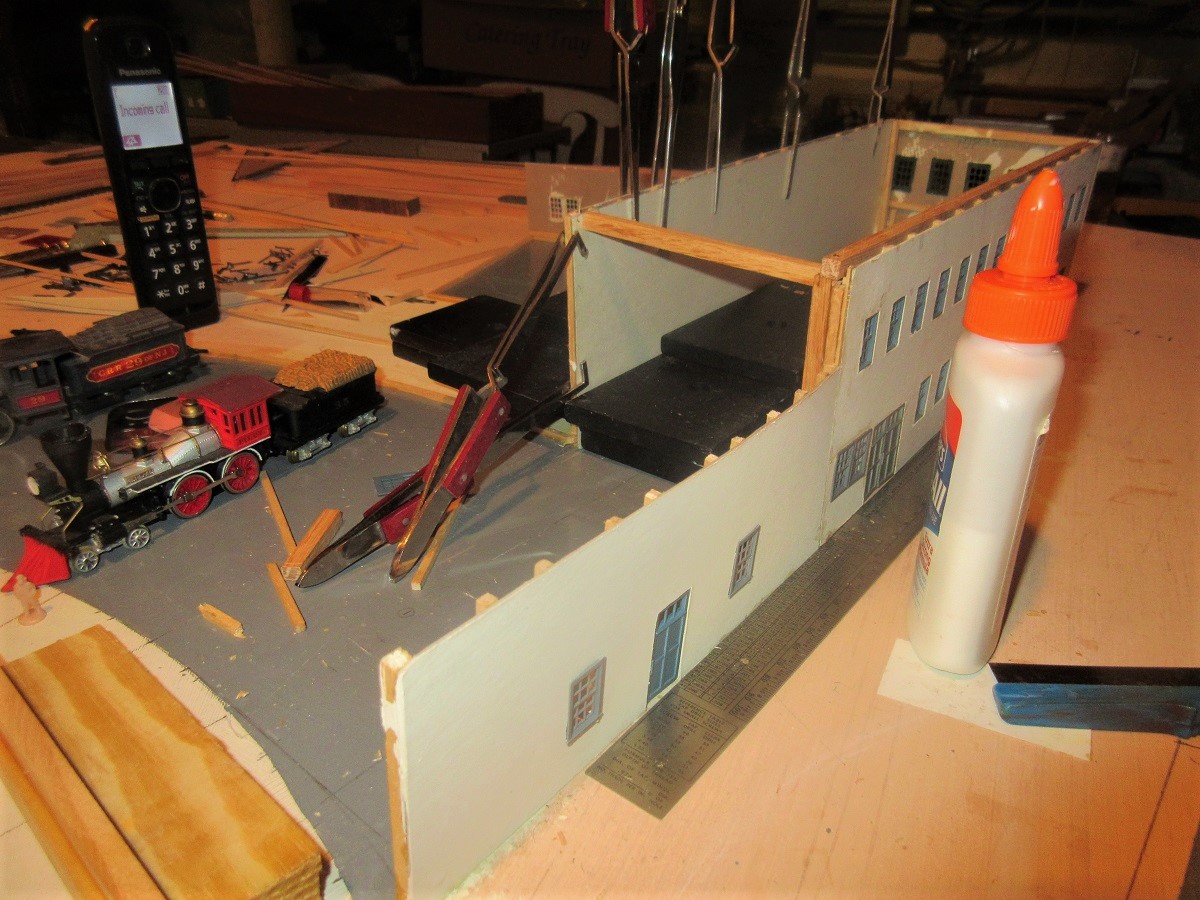

The next thing I've done is to make the Roundhouse entrance doors and surrounding walls which make the front of the building.
Edited by - toptrain on June 25 2018 07:17:24 AM

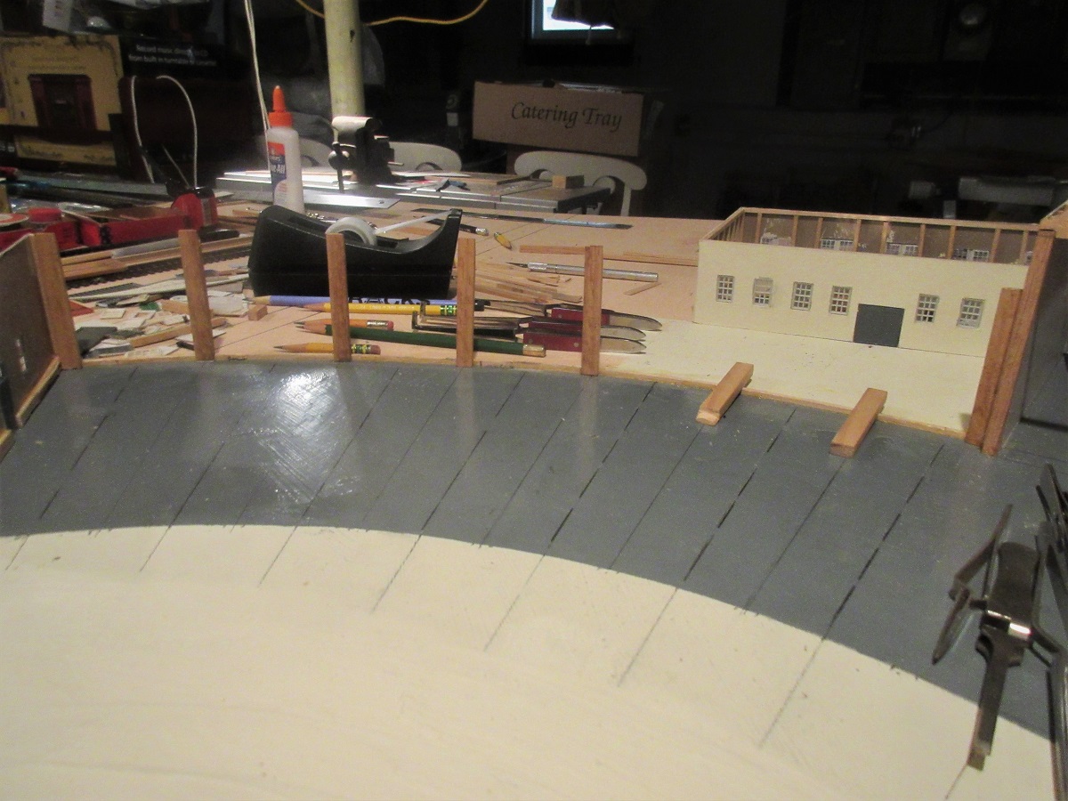

 Posted - May 29 2018 :  6:06:18 PM Link directly to this reply  Show Profile  Add toptrain to Buddylist
post 10
* Well a few walls are appearing now. Lots of windows used already. I am using a light tan just like what I think I am seen on the lithograph. This isn"t a shake the box and squirt some glue kit every part with exception on the personnel doors and windows. All the big pairs of doors need to be handmade along with their frames. I have shaped cut out the 9 pairs of roundhouse doors already. I still need to make 6 more walls. Find more windows. The curved roundhouse peaked roof will be hard to do! It will get done, definitely not in a short time.
just me, frank
Edited by - toptrain on June 25 2018 07:17:54 AM

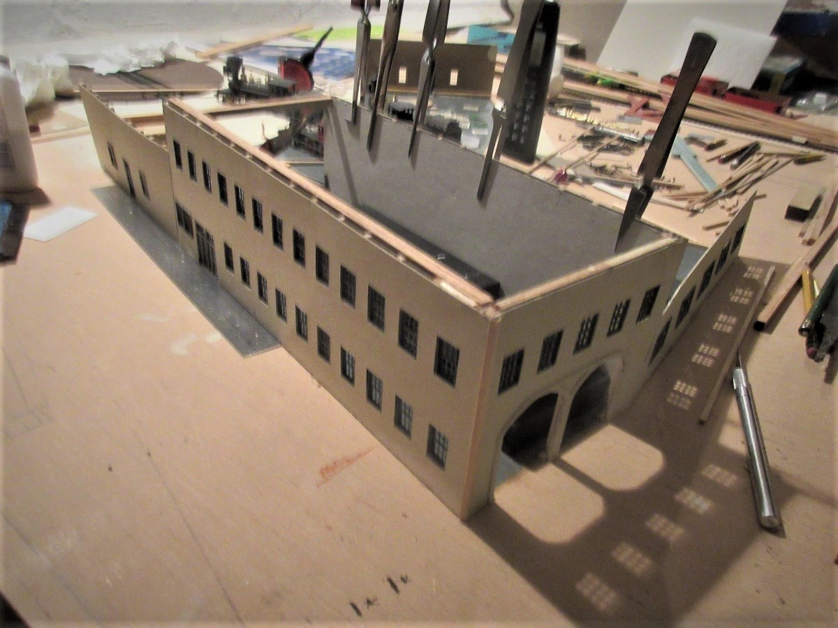

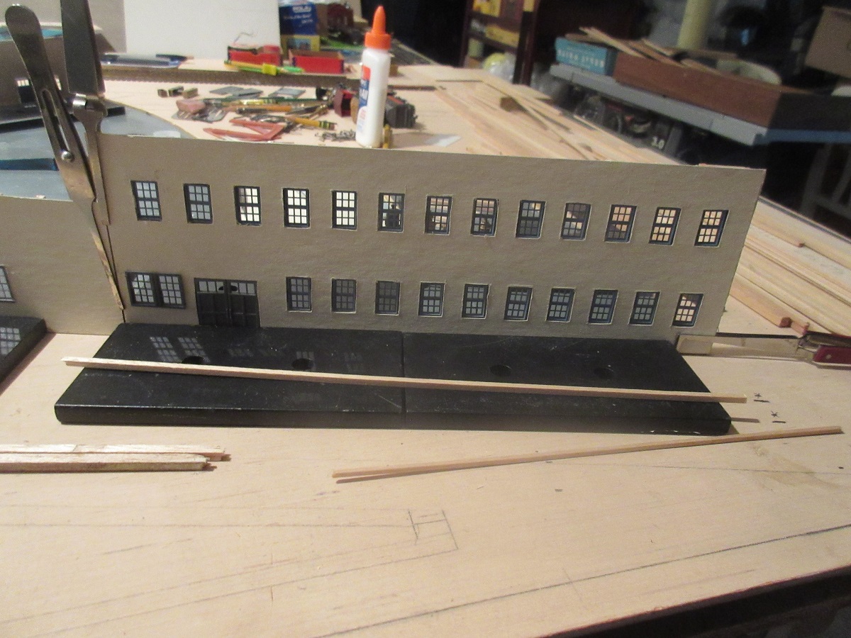

 Posted - June 06 2018 :  8:50:20 PM Link directly to this reply  Show Profile  Add toptrain to Buddylist
post 22

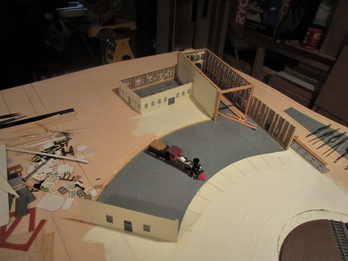

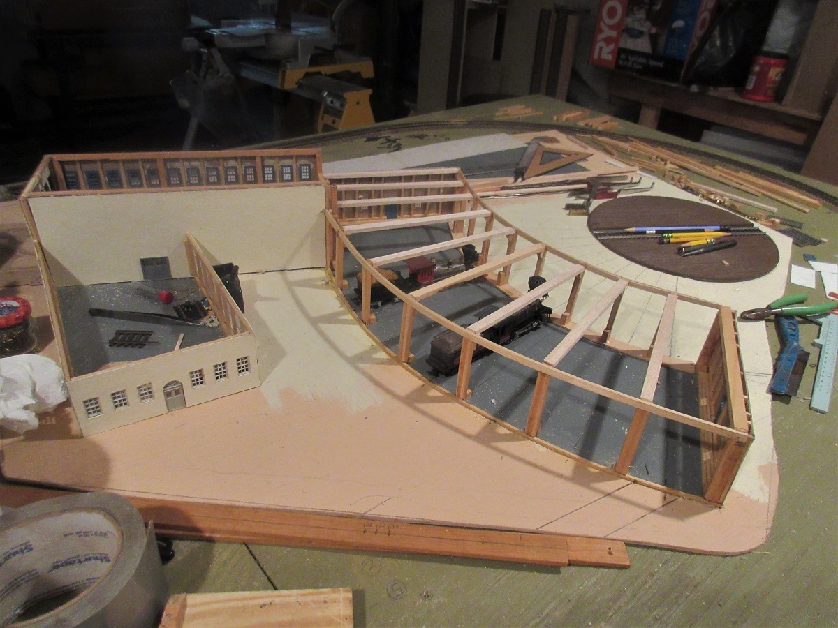

Here is an updated photo showing the other 2 machine shop walls added Locomotive manufactory building.
Edited by - toptrain on June 25 2018 07:46:23 AM
 Posted - June 07 2018 :  12:48:41 AM Link directly to this reply  Show Profile  Add Chops124 to Buddylist
That's a really interesting addition. One forgets that these guys had
to pretty much make every single extra piece from scratch, short
of having an iron foundry.

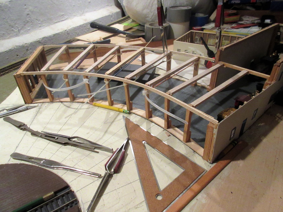

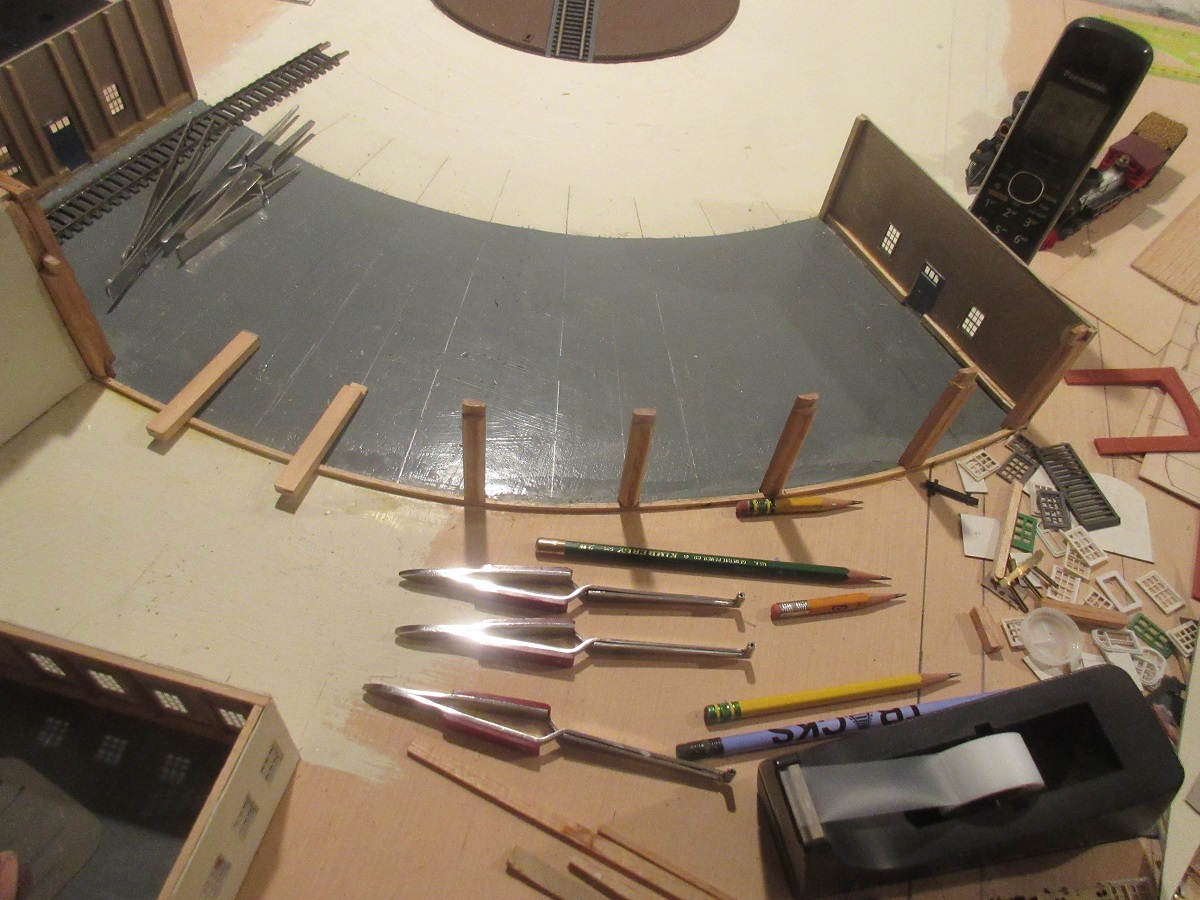

 Posted - June 08 2018 :  8:44:53 PM Link directly to this reply  Show Profile  Add toptrain to Buddylist
post 31

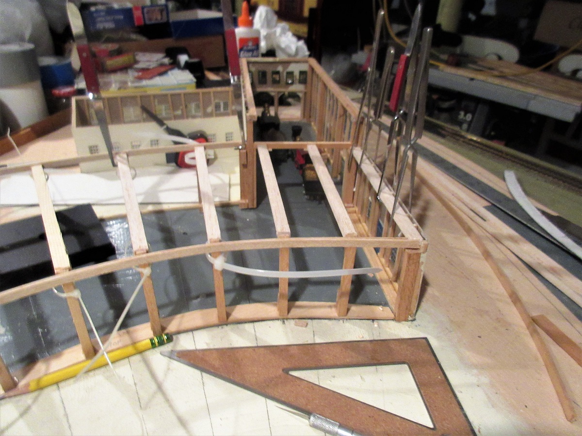

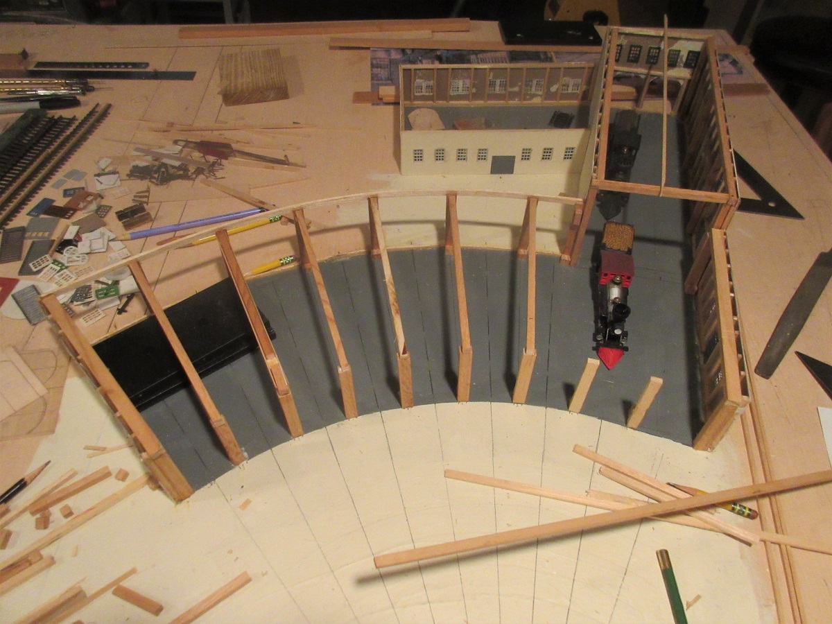

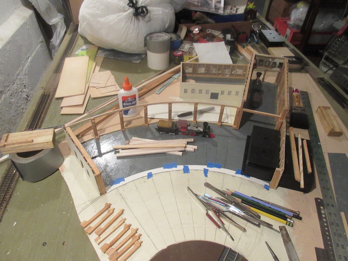

* My first try at making a roundhouse with a circular wall. This will be the rear wall. Front walls that face the turntable can't be curved. I will make no attempt to make the front wall curved. Here is a photo of where i am right now. I am done for the day.
Edited by - toptrain on June 25 2018 07:47:58 AM

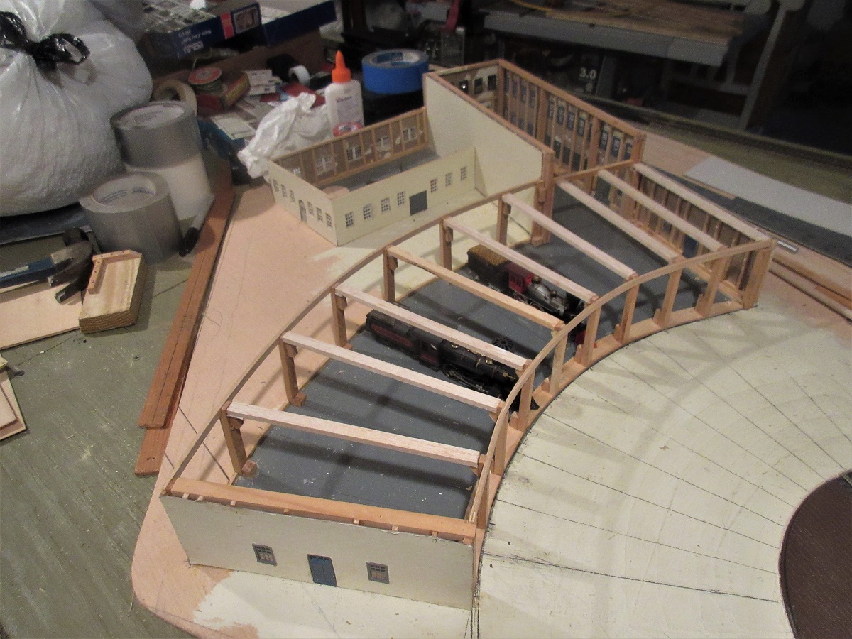

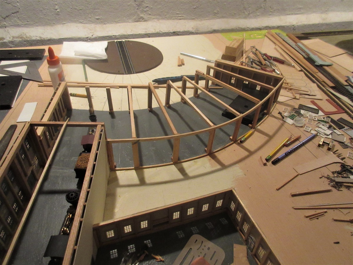

 Posted - June 09 2018 :  7:47:54 PM Link directly to this reply  Show Profile  Add toptrain to Buddylist
post 34

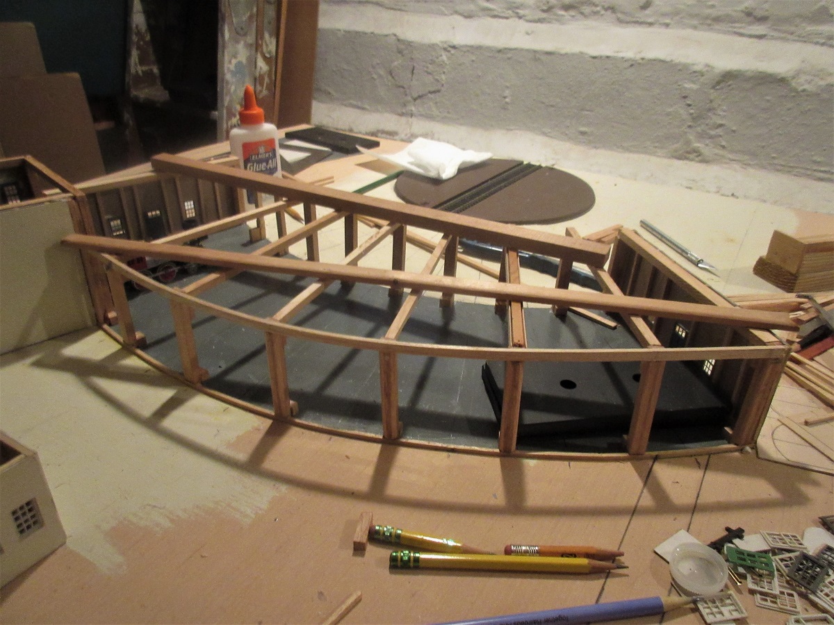

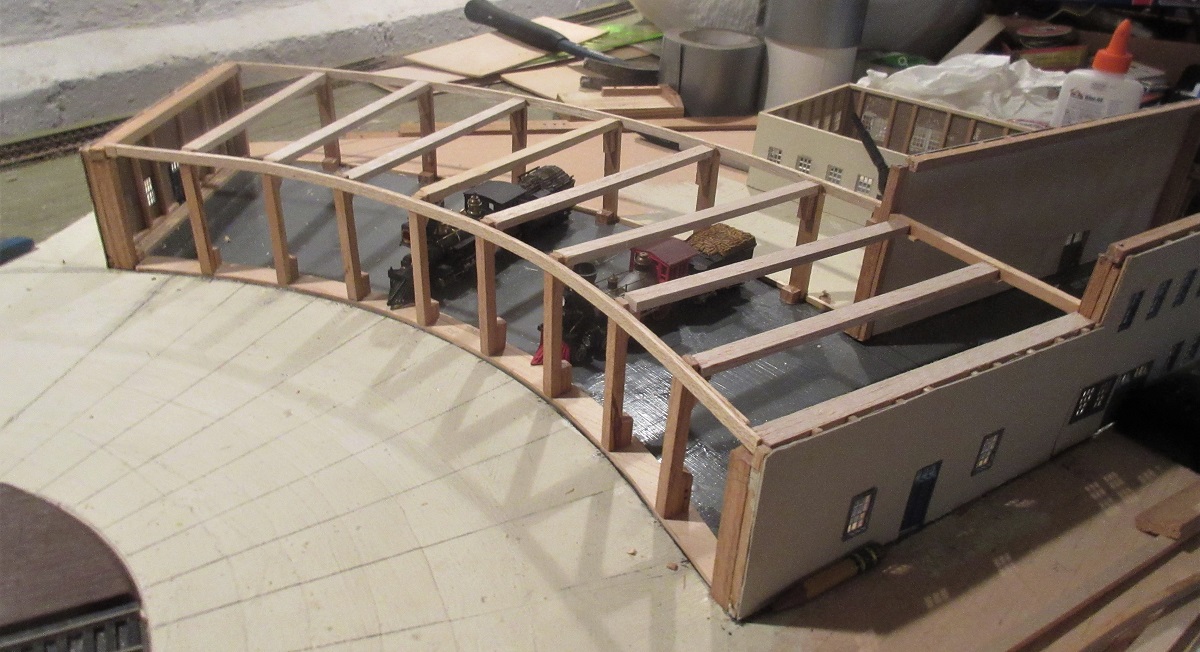

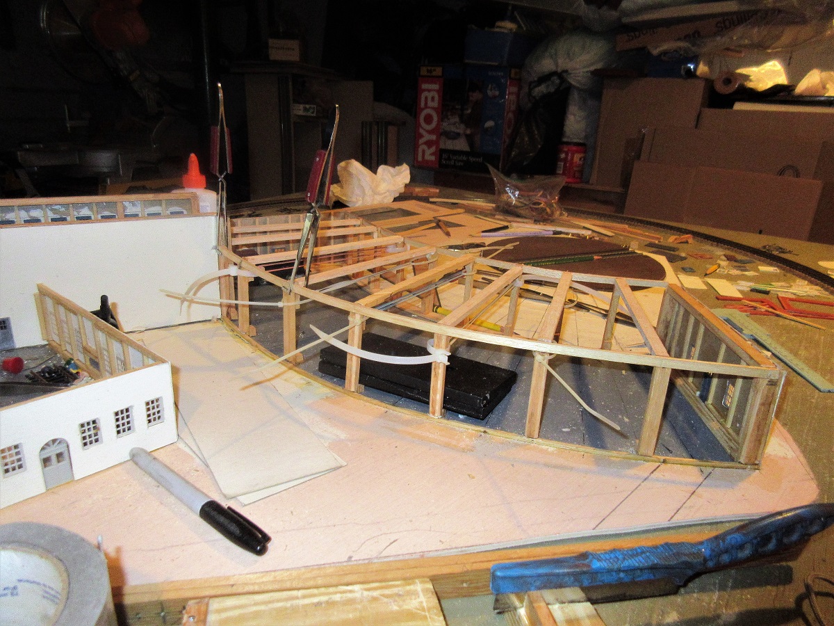

* Got some framing done but not complete. Now I have decided to change the front. Removing the front posts and rafters to replace the front posts with new ones notched like the rear ones to accept a continuous top front beam. This will better align all the tops of the front posts. Also I will use front posts a little thinner than those shown here, to enlarge the door openings.
Edited by - toptrain on June 25 2018 07:48:28 AM

 Posted - June 09 2018 :  11:35:37 PM Link directly to this reply  Show Profile  Add Brian4321 to Buddylist
Toptrain,
This looks great. Keep up the good work. I'm trying to figure out how that curved beam stays in place. Did you wet a straight piece of wood, shape and let it dry so it is curved and all you have to do is glue it in place, or did you use nails?
 Posted - June 10 2018 :  06:35:03 AM Link directly to this reply  Show Profile  Add toptrain to Buddylist
post 38
Toptrain,
Originally posted by Brian4321 - June 09 2018 :  11:35:37 PM
BRIAN I SOAKED IT IN VERY HOT WATER. I hope when it dries out that it keeps its shape. I am thinking about drilling through the board and into the beams behind across to the front on all 9 posts. Then pushing small nails in the lock every post to the curved beam.
Edited by - toptrain on June 25 2018 07:49:08 AM

 Posted - June 12 2018 :  07:52:39 AM Link directly to this reply  Show Profile  Add toptrain to Buddylist
post 40
*Guys, the curved beam acted just like a bow wanting to straighten itself out. It broke free to two side walls and everything just came apart and fell down. I am going back to my first very complicated front wall of many parts fitted together. It won't spring apart. I can after I build it, then it slide it into the front opening in one piece. That is with all the doors on. I may even make them, the doors, to swing open and shut if my patient’s doesn’t run out.
*Still Just Frank
edit added photo6-17-18 Pictured before by last repair
Edited by - toptrain on June 25 2018 07:50:06 AM
Brian4321
Gilbert HO
 Posted - June 12 2018 :  11:51:53 AM Link directly to this reply  Show Profile  Add Brian4321 to Buddylist
Ouch. It must have been painful to see the beam pop off and take the supports with it. Please don't give up as this will be a really nifty part of your layout. Another option, assuming you have enough wood, is to cut the beam to the curve specifications.
 Posted - June 19 2018 :  2:51:38 PM Link directly to this reply  Show Profile  Add toptrain to Buddylist
post 42
* And so after a few bad ideas I had a good one. I took some very thin wood and cut 2 strips the with of the destructive strip. It curved very easily. S i glued one in it set and then overlaid the first one with second to give it thickness.
a photo from 30 minuted ago; south-west corner.
Edited by - toptrain on June 25 2018 07:50:38 AM
 Posted - June 19 2018 :  2:57:51 PM Link directly to this reply  Show Profile  Add toptrain to Buddylist
* I had to realign and reglue part of the back curved wall shorting it.
north-west view;
 Posted - June 19 2018 :  3:01:32 PM Link directly to this reply  Show Profile  Add toptrain to Buddylist
post 44
* Here is the building from the west.
Edited by - toptrain on June 25 2018 07:51:09 AM
 Posted - June 19 2018 :  3:05:21 PM Link directly to this reply  Show Profile  Add toptrain to Buddylist
* I had to replace with a new beam the top of the south roundhouse wall. I now get a break while the glue dries everywhere.
* Next will be the rear curved wall. I only shave shorter pieces of cardstock left. To remove the seam I will uae paper long enough to cover the distance and glue it to my short pieces making one big piece. once dry and workable I'll curve it around the builtup framing and mark the center of all 7 sections (stalls). Then the real hard work starts making flat windows look correct in a curved wall. I have 2 ideas already
Edited by - toptrain on June 19 2018 3:29:29 PM
 Posted - June 19 2018 :  4:49:01 PM Link directly to this reply  Show Profile  Add toptrain to Buddylist
post 46
* Here are the 4 views of the Locomotive Manufactory Building. Before I start on the back and front walls of the roundhouse section.
1-This is the roundhouse front view from the west;
2-This is from the south-west
3-This is the from the north
4-This is from the North-west
Edited by - toptrain on June 25 2018 07:51:49 AM
