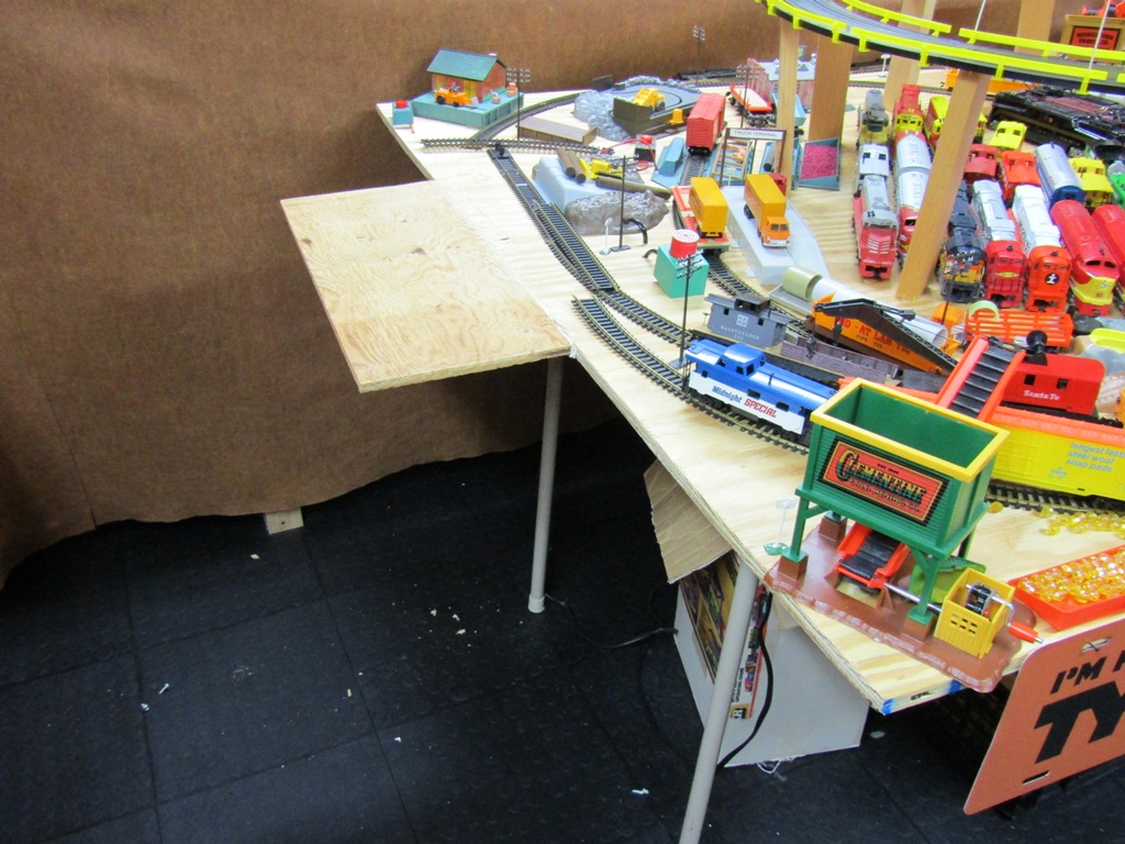

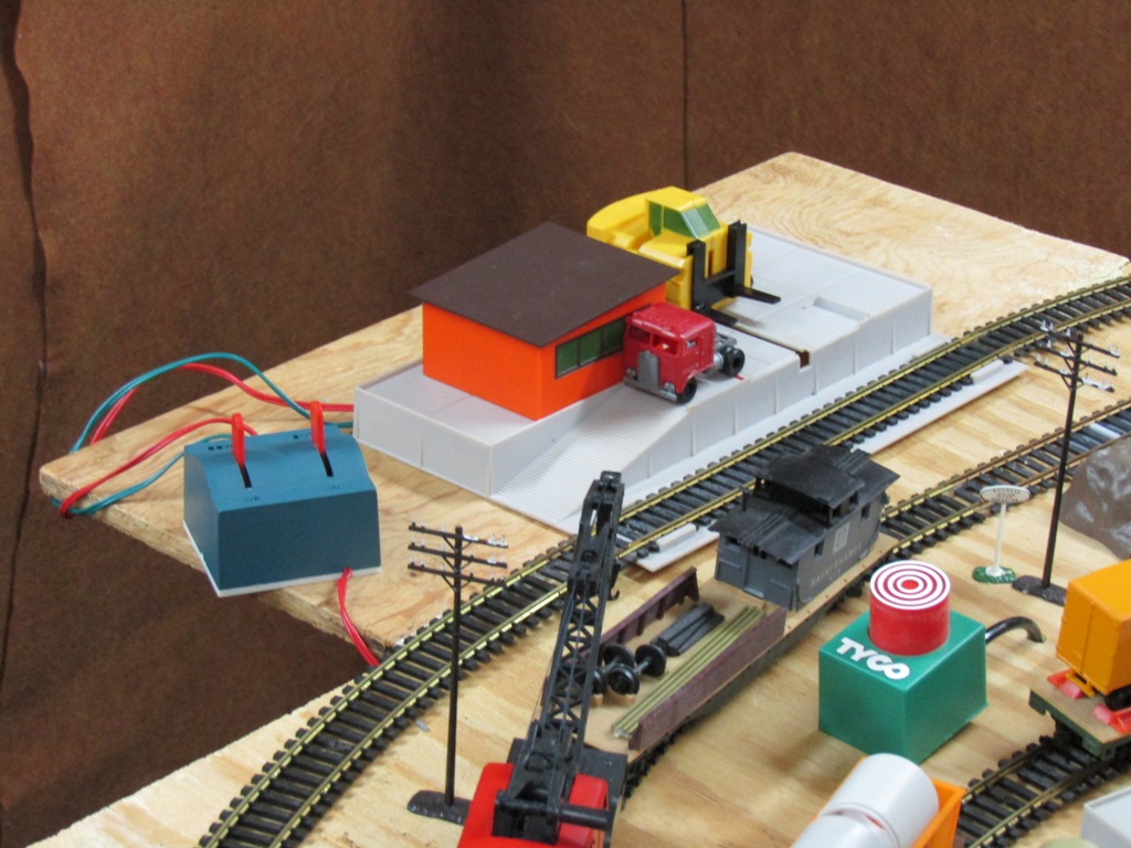

MAJOR UPDATE - The Piggyback Loader & Unloader Accessory has been installed and is working!

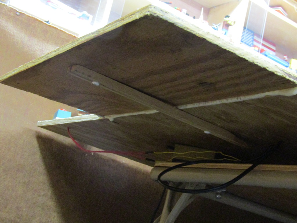

So, last week, I prepared by cutting a small piece of scrap plywood, and affixing it to the edge of RETRO TYCO with Sticky Jack Glue. I then screwed in a "support beam" underneath the makeshift shelf.
Upon receiving the Piggyback Loader and Unloader in the mail, I installed it and it fired right up. Unfortunately, the USPS broke off one of the forklift arms in transit...so I had to glue that back on with liquid cement. The Piggyback Loader & Unloader looks and works awesome! Another great Tyco product.

...and the expansion begins
Awesome work!

mmm think I'd of used TWO braces instead of one

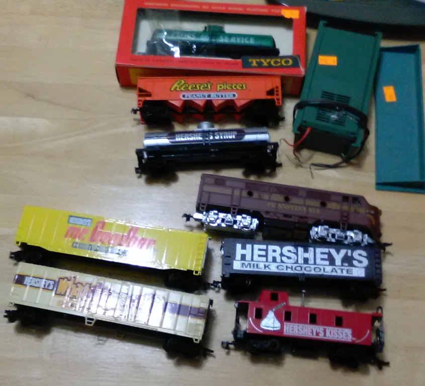

LOL...well RETRO TYCO #1 will soon be no more...

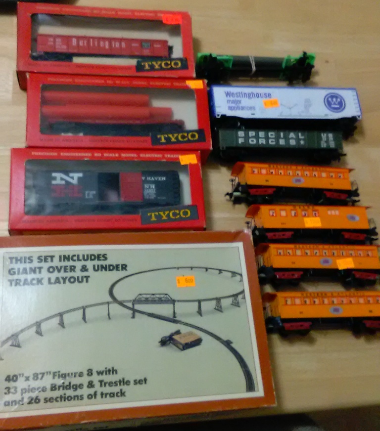

Got a lot of great deals, as usual, from the Nicholas Smith Train Store - surprisingly nothing caught my eye at the outside tent sale (it was filled with mostly larger scales.) AND it was 15% off everything used, a sale I didn't even know they had.
Without further ado, here's my loot:
Notables include:
- Model Power Pennsy F2A
- 4 Tyco "Red Box Era" Western & Atlantic coaches
- Tyco Westinghouse Appliances box car
- Tyco log car
 Posted - August 17 2019 :  5:50:34 PM Link directly to this reply  Show Profile  Add Chops124 to Buddylist
Whooa Nelly, Sunday came early, and thank you for that.
You now have a complete, more than complete consist
for the Hershey Geep.
Your expansion seems to be creeping outwards in bits and
pieces. Are you planning on adding a table, or just in chunks?
All good.
 Posted - August 17 2019 :  10:07:20 PM Link directly to this reply  Show Profile  Add RP model railroads to Buddylist
Agreed, Chops! Can't wait to do another Hershey's Train video....featuring that GP40.
Regarding RETRO TYCO - I am now calling it "RETRO TYCO I" since upon building RETRO TYCO II, I will transfer all Tyco accessories and trains to RETRO TYCO II, and then dismantle the present RETRO TYCO. So, a big expansion is underway.....
 Posted - August 18 2019 :  11:26:24 AM Link directly to this reply  Show Profile  Add microbusss to Buddylist
I think I have/had that loco that goes with those Hershey cars
Don't forget TYCO made a Hershey boxcar too!

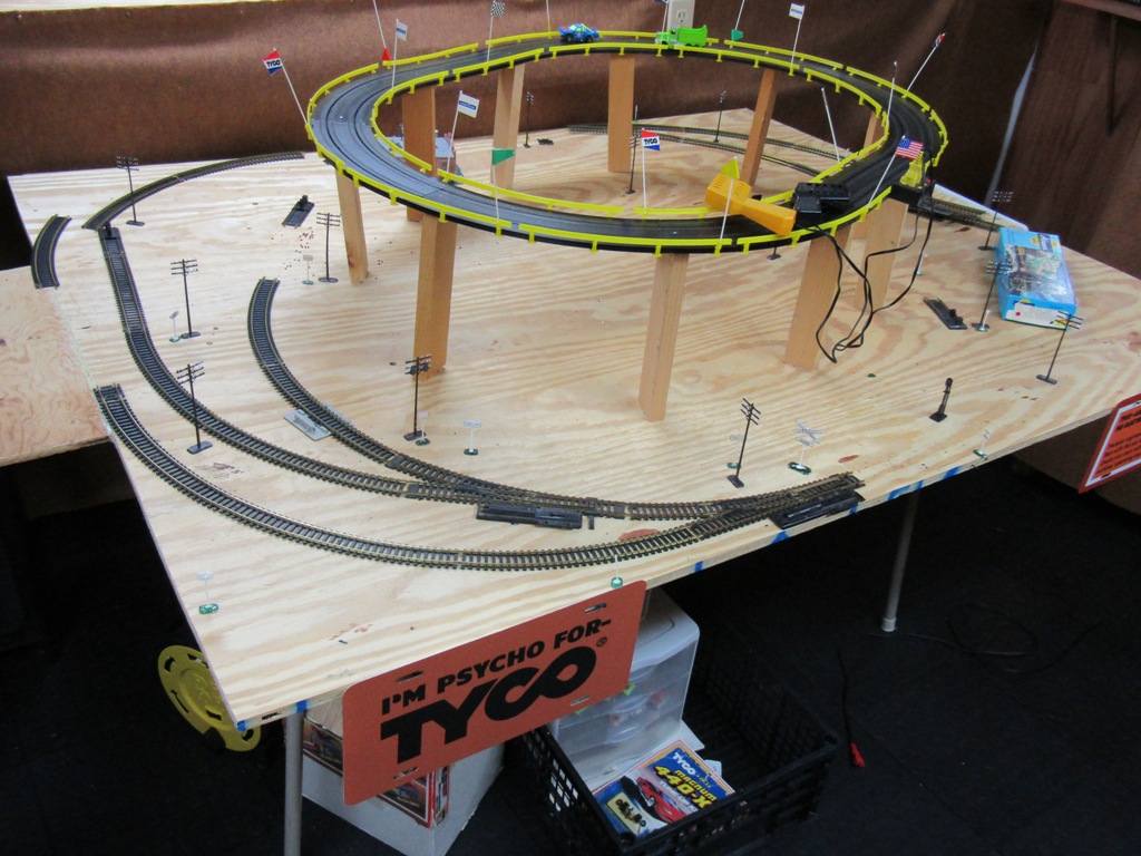

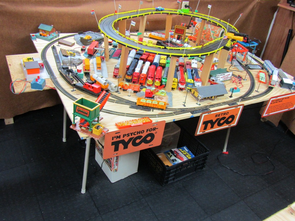

RETRO TYCO I, as it currently looks. It is due to become "Tyco Speedway" in the future.
 Posted - September 27 2019 :  9:51:51 PM Link directly to this reply  Show Profile  Add wks to Buddylist
Look forward to see your Tyco autos in action on the refurbished first retro layout.

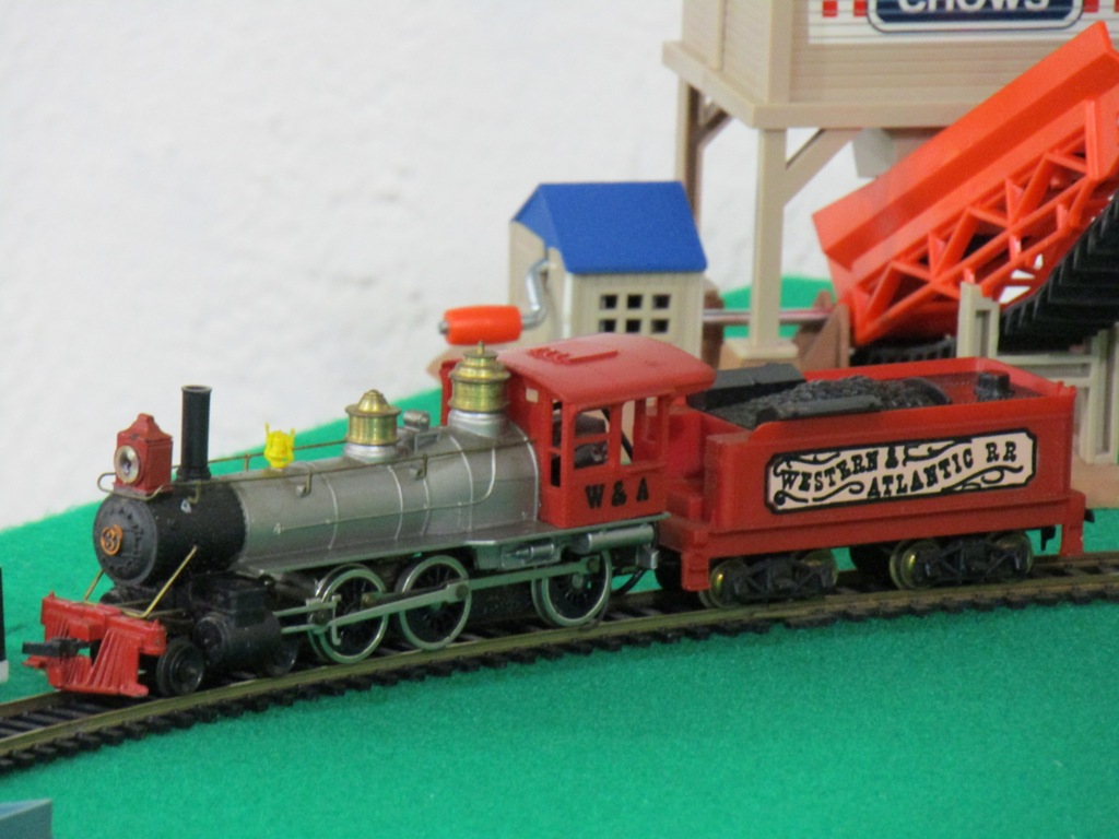

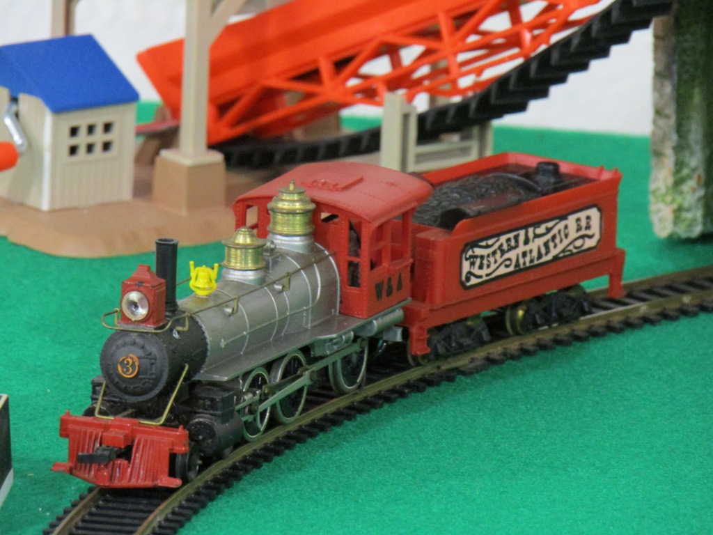

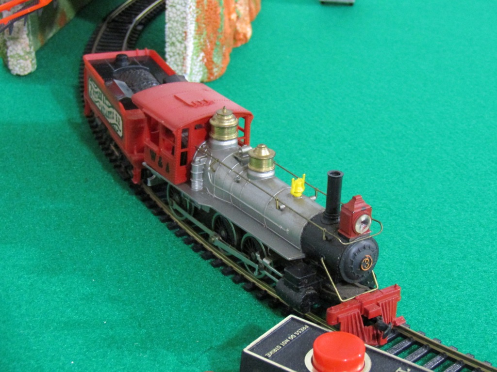

Look what arrived in the mail today....
That's right! I finally got a Tyco "Dixie Belle" Western & Atlantic 4-6-0 steamer, definitely from the "Red Box Era!!!" This is the 2nd Tyco steam locomotive in my collection, and it runs excellent (as expected, with its MU-2 style motor.)
However, the traction tire on the drive wheel was dry-rotted and has since come off upon operating the locomotive on RETRO TYCO II. My question is...how can I install a new traction tire, or 2, on the drive wheels, when there seems to be no way to remove the wheel/axle assembly from the pistons. I definitely didn't want to break anything, so I figured I would ask first, as this is my first Tyco 4-6-0. Any help would be appreciated.
 Posted - October 02 2019 :  4:35:47 PM Link directly to this reply  Show Profile  Add RP model railroads to Buddylist
So, does that mean I can't install traction tires?
 Posted - October 04 2019 :  7:18:03 PM Link directly to this reply  Show Profile  Add scsshaggy to Buddylist
All that's in the way of the traction tire is the connecting rod to the rear left driver. That's held on by the brass hex-head screw that serves as a crank pin. Be nice to that screw. It's kind of special and probably hard to replace. Mantua made a special wrench for that, punched out of thick sheet metal. Bowser used to supply a screw with a head to fit a 3/32" Allen wrench. That screw is the perfect socket wrench for those crank pins. So, if you can find a screw who's head fits a 3/32" Allen wrench, you can take off that crank pin and the wheel will be wide open for traction ring replacement.
I think the traction tire is a rubber O ring with the rubber 1 mm in diameter and the ring being a little less than the diameter of the wheel.
 Posted - October 04 2019 :  8:48:24 PM Link directly to this reply  Show Profile  Add RP model railroads to Buddylist
Originally posted by scsshaggy - October 04 2019 :  7:18:03 PM
Awesome! Thanks for the advice - will continue digging.
