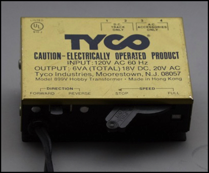

While I do have another LifeLike blue powerpack which I can use to replace the faulty pack controlling the inner line, I also have 3 Tyco "golden" powerpacks, all of which are 6 amp. So, I'd like to ask, are the Tyco "golden" powerpacks, made in Hong Kong, long lasting? Also, do 7amps really make a difference when compared to 6amps, of DC power?

I noticed that it says 6 VA, which I think is Volts x Amps (watts). At the 18v on the label, that's 1/3 amp.
Presumably, the lifelike is 7 VA. 7 amps would be huge for HO.
When working hard, some old open frame motors can draw up to 1/2 amp which would be closer to 9 VA. If you go to train shows, it might be a good idea to keep an eye open for something bigger and better than the small train set transformers.

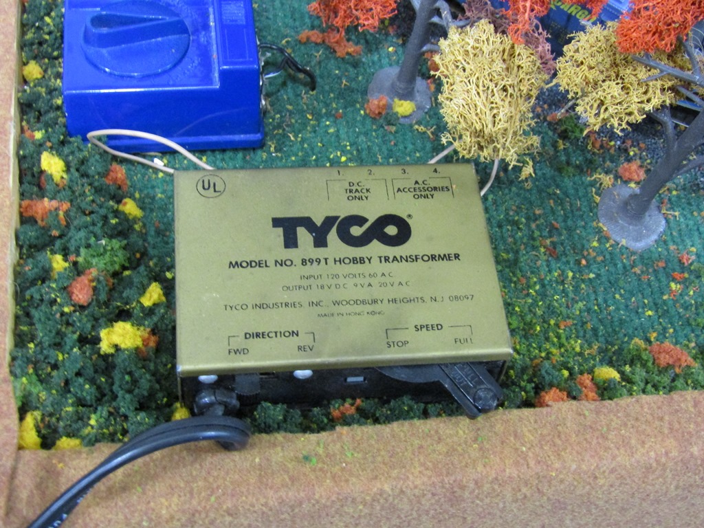

After completing my homework tonight, I amazingly had a bit of time to go down to the layout. So, I utilized that time to remove the faulty blue LL powerpack for the outer line -- I didn't remove the wooden piece on the side of the layout which conceals the wire from view, but instead, just cut the cord with wire snips (the power wasn't on of course.) Within 5 minutes, the old LL powerpack had been removed from the layout, leaving this view of the two wires powering the inner line:
I then pulled out one of my better looking golden Tyco powerpacks and cleaned it a bit (I had obtained all three by winning an Ebay estate auction last year, so each powerpack had a film of dust/dirt on it, causing all to look like they hadn't been used for decades.) Then, using the only wire left attached to the DC side of the Tyco golden powerpack, I split it in two, and then spliced it into the yellow wires from the inner line (since they were unfortunately too small to be screwed-onto the powerpack by themselves) Then, I plugged the cord into the strip, and boom, power!
Now, because the Ephrata Valley Railroad defies typical model railroad size by being what most would consider merely "train set" size, having a train set powerpack works fine for me. Interestingly enough, this Tyco golden powerpack says "Output = 9 V A", while the LL powerpack which it replaced said "Output = 7 V A." Ironically, the Tyco golden powerpack actually supplies MORE power than the LL powerpack did, to the Pennsy F9's operating on the inner line, for they are now running faster. I ran the Tyco golden powerpack on full blast for ten minutes straight, to the point where the powerpack became rather warm outside, and the Pennsy F9's hauled a 9-car freight train around the inner line without wavering!

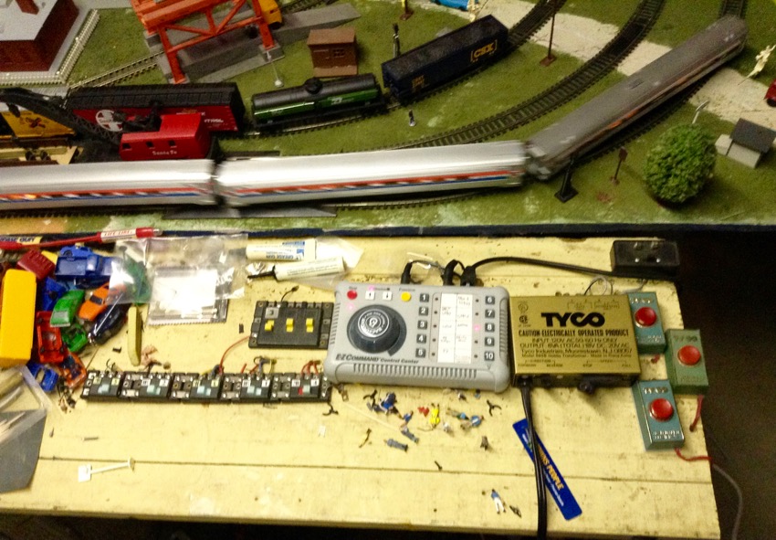

That's pretty interesting. On my previous layout, I used a gold TYCO-pak to power my turnouts and some operating accessories, with the pack placed next to my Bachmann E-Z Command unit, as that doesn't have AC accessory output. I will probably go with the same setup for the control panel on my new layout.

Neat, Wiley! I have a Tyco golden powerpack just like yours, that said "Output 6 V.A." The one that I just installed on the outer line this Monday, which by the way is continuing to work with success, says "Output 9 V.A." And, it continues to supply more power to the Tyco Pennsy F9's than the blue LL did, towards the end of its life.....
And, interestingly, when on full blast, the F9's run super well, but can still operate (more prototypically) when the throttle is 3/4 all the way up.
