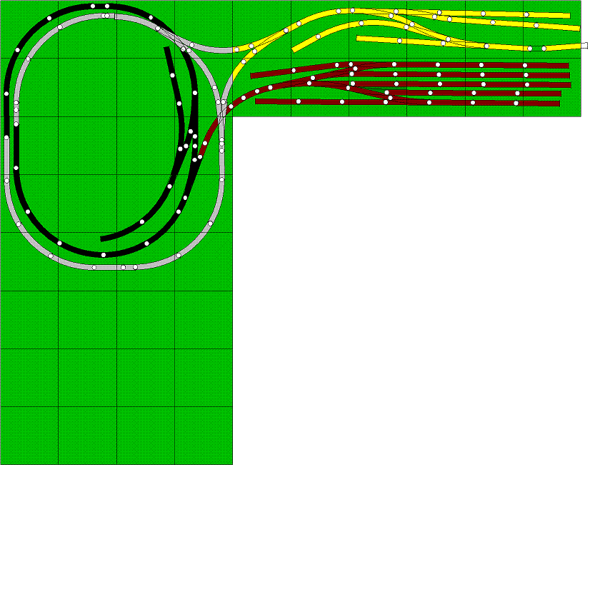

This is the layout as originally planned. It was laid out for Atlas track, but the actual track is handlaid on matchstick ties.

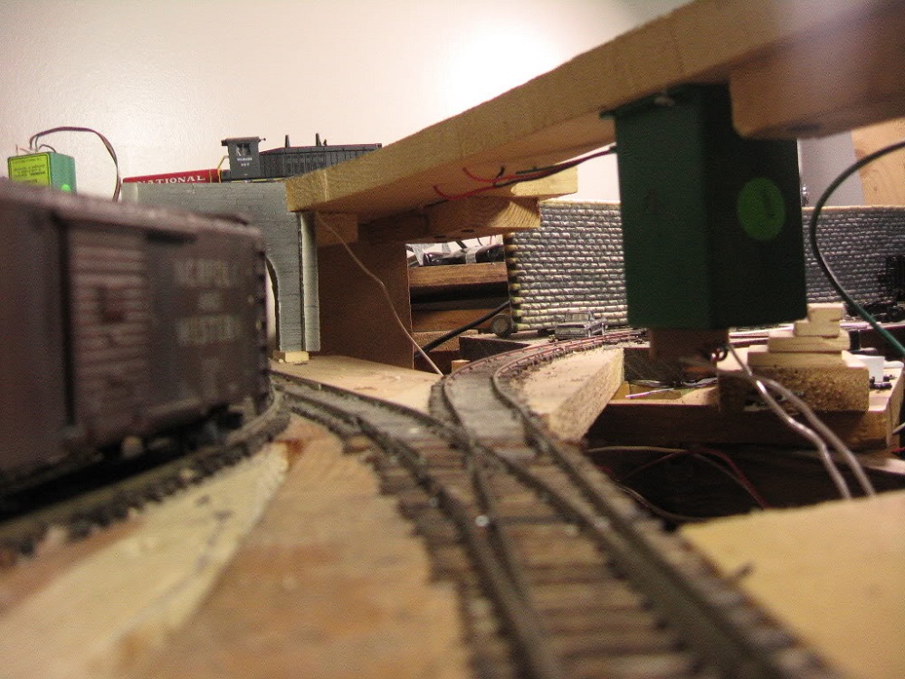

A view of the lower level beneath the wye.

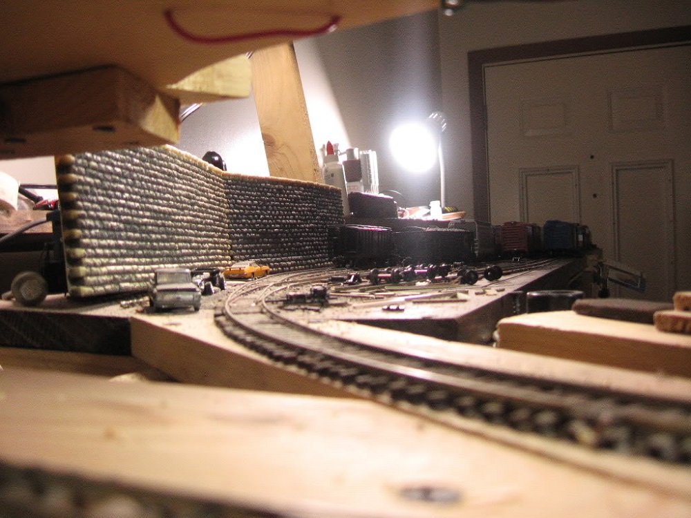

The lower level and the yard lead.

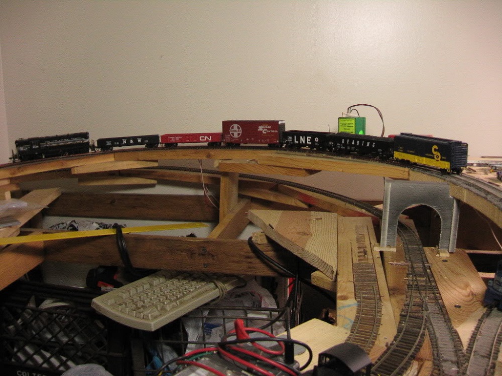

The entrance to the yard.
The tunnel portal has been cut down to just clear a high cube boxcar. The effect is similar to the tight clearance routes in the east, where excess height cars were banned.

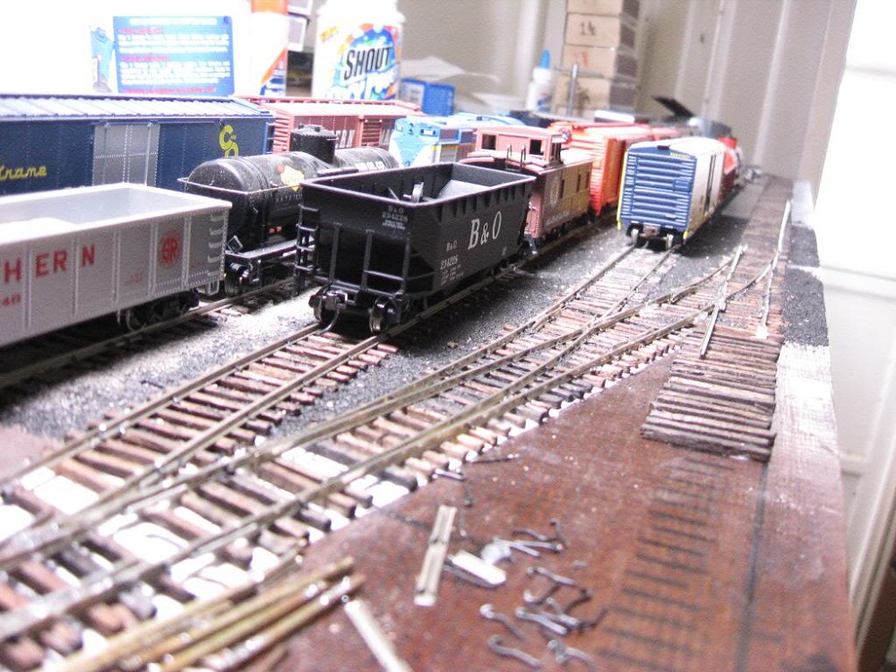

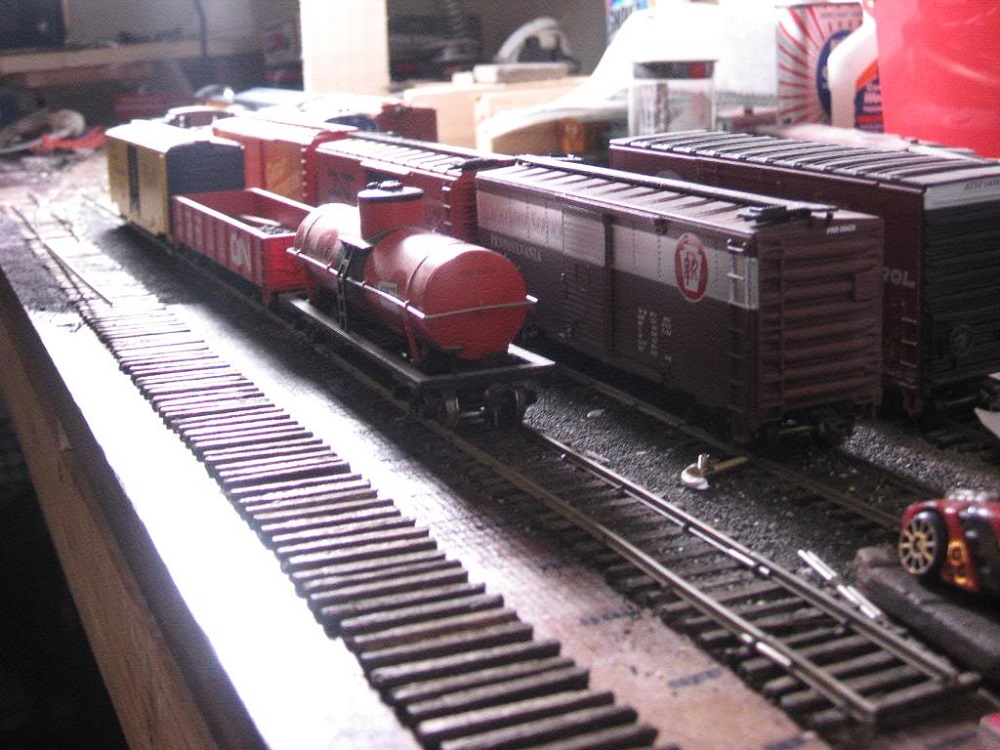

The yard under construction.

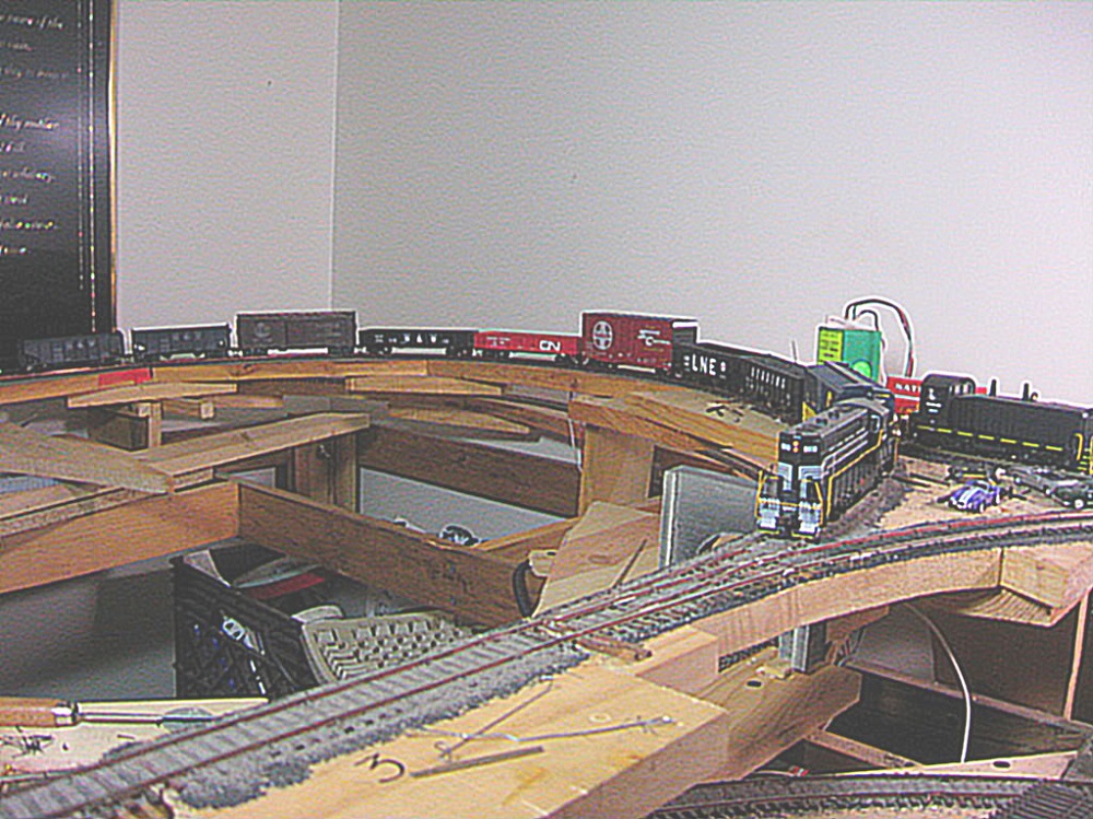

Another view of the yard.

Yes, all track is handlaid. The switches are all number 5s made in a fasttracks jig, then curved to fit the site, if necessary. The three wye switches are built using an old Atlas wye as a template. I find handlaid track allows me freedom to do things not possible with sectional track.

Nifty layout! It would be interesting to learn more about how you lay the ties and rails. Are the ties glued, or possibly every nth tie nailed down, or do you fasten the rail and ties together?
jward
 Posted - January 16 2018 :  9:38:18 PM Link directly to this reply  Show Profile  Add jward to Buddylist
The ties are matches with the heads cut off, cut to length and stained. The subroadbed is dimensional pine board, cut to fit. I glue the ties down, then lay the rail, spiking it about every 4th tie. All in all it's a VERY sturdy construction. I can actually walk on the layout without worrying about it collapsing.
Handlaid track is tedious but when you have more time than money it gives you something to do.
