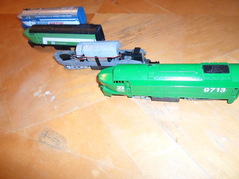

Here's one where I chisled little slots in the shell to replace a PT
motor with a Mantua MU-2 motor.
Here's one where I am swapping out a real Tyco shell on a Model Power chassis.
