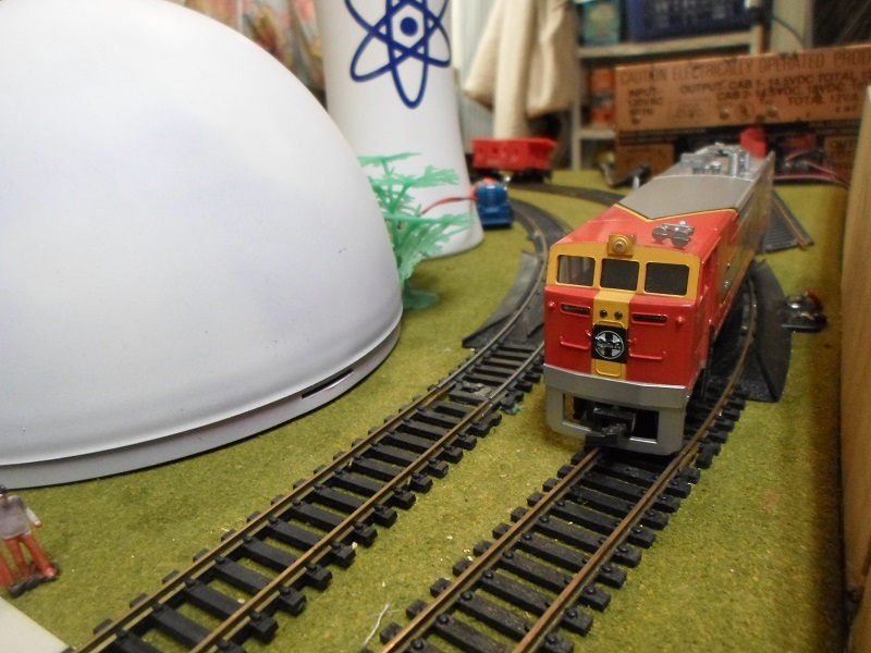

 Any thoughts on how to restore this piece?
Author Previous Topic: Bachmann''s ''Repairs'' Topic Next Topic: Bachmann Engine Gears Slipping...
 Posted - November 24 2017 :  11:58:52 AM Link directly to this topic  Show Profile  Add Chops124 to Buddylist
It runs, barely, clearly the motor looks pretty gummy, the pick ups are
grimed, and it's missing pantograph. I really want to have this run nice.
Would a good disassembly and cleaning be enough, or maybe the brushes
are toasted. Is there another Bachmann chassis that would snap in place
from another, more common, locomotive?

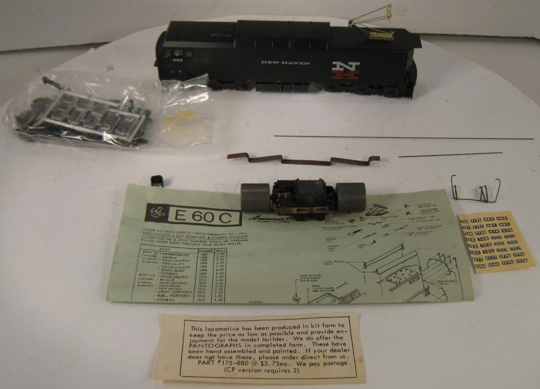

You may be able to alter an Athearn chassis and fit it under it.
They were used by American GK when they made their E60CFs and E60CPs.
Edited by - Mustangs_n_Trains on November 24 2017 12:19:00 PM

You can try an Athearn SD-9 chassis with a little bit of modification. As Sean pointed out, that's what American GK used. If you want to be more accurate, you can swap out the EMD trucks for GE style trucks.

For an Athearn repower, the SD9 frame is the correct fit, just install trucks from one of the 6-axle U-boat GE's. As for Bachmann parts, most likely Bachmann won't have anything that old readily on hand. I'll check if I have any of the right style of pantograph.

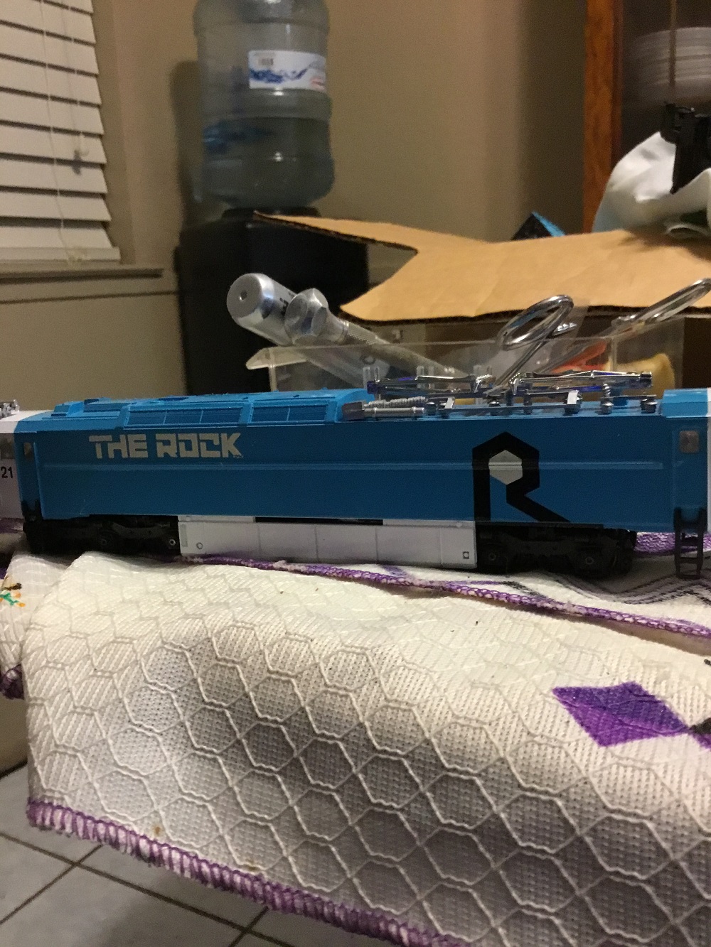

Thank you for the kind replies. As to this piece, a little cleaning and resoldering the wires to the
brush contacts did the trick:
https://youtu.be/o0lRJCYDGzY
Looking back through the post, I did not realize that Athearn made a BB e 60 type, that is a
surprise. I did get a used Athearn BB SD9 and cut up the chassis to fit the width of the
Bachmann shell, hope to get a little more done on it between now and Monday. As you
can see, the SD 9 chassis is quite a bit shorter than the Bachmann shell:
I would most certainly louse it up if I cut the shell, so will cut the chassis and glue it in
with JB weld.

Athearn never produced an E60, however American GK used Athearn chassis and parts for their drives.
The SD9 chassis fits under the Bachmann E60CF shell, which as you discovered is significantly shorter than the E60CP.
The Athearn FP45 would be a match for the E60CP.......
