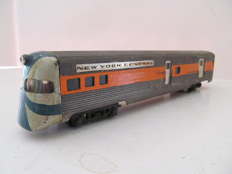

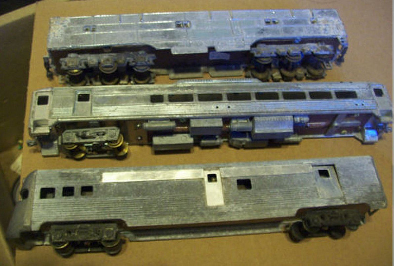

I need to get some of that stuff too. I have plans for these Sampson Rail Cars too.. I have a pair of powered Sampson Rail Cars from ~1950. They made then for two years, 1949 and 1950. One has a full windshield, one has a split. I am not sure which is which. I would like to get both so I can say I have both years. Right now, both of mine have split wind shields...
This next one was the first one I purchased shortly after learning of their existence... (Thanks to Mr. Jim Heckard)
 Posted - June 16 2017 :  10:47:48 AM Link directly to this reply  Show Profile  Add Chops124 to Buddylist
Wow, those are some great pieces from the early days of HO.
