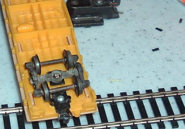

I've found that a .030" thick piece of styrene covers most cars AHM makes. This can come from a variety of sources including old credit cards. I just glue it to the underbody, lightly glue the #5 box and all to the shim then check the height gauge to make sure it's right. You may have to swipe it with a file or add one or two Kadee washers but most times it'll be right on or near enough. Drill for a small screw for strength and you're done. This is a Tyco flat that didn't need any shimming.

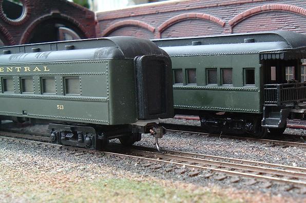

This is a Life-Like Scene Master car that needed several.
