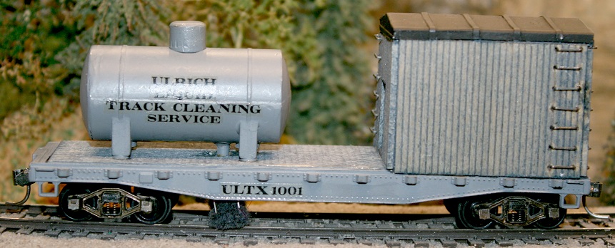

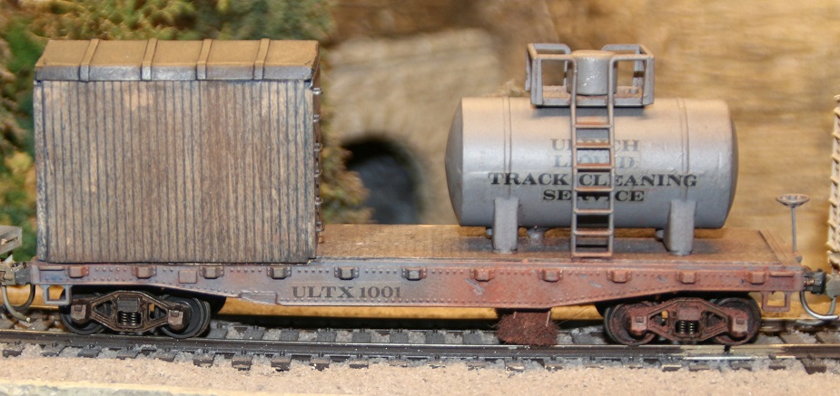

For your consideration I present this Ulrich Track Cleaning Car....
I deviated from the original kit by adding the sides and ends of a Tyco skid flatcar to improve the cars appearance. I think the car turned out well. I will add it to the thread for Tyco skid flatcar kitbashing projects.

Interesting means of modernizing it. Certainly effective! Is there anything left of the pipe trestles?

I don't know what "pipe trestles" are, do you mean "Truss Rods"? If so, this model was designed to represent a car with a steel under frame so no parts to represent truss rods were included.
This actually brings me to the point of why I added the Tyco fish belly side sills. If built as recommended by the instructions, the frame of the car would have looked like simple wood board suspended by two trucks as seen in this advertisement....
As you can see from the photo above, the kit hides the lack of frame detail with the addition of steps and solid railings but I think the addition of real side sills is an improvement. Note how the new side sills help hide the track cleaning pad and the gap in the center sill needed to accommodate it.

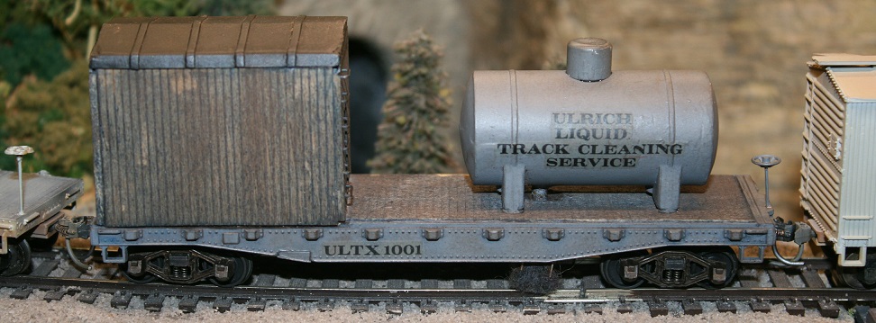

Added a brake wheel and some weathering....
Looking at the photo, I see that I should also add access to the tank dome. I'll have to find some ladder stock to fix that!

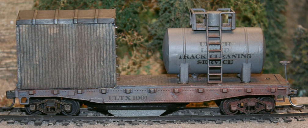

One more upgrade for this car, a ladder and platform for the tank dome and some additional rust texture on the side sills....
Edited by - Srenchin on November 19 2016 4:32:43 PM

That ladder and rails is a nice touch.

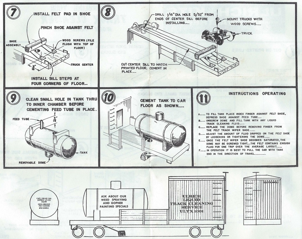

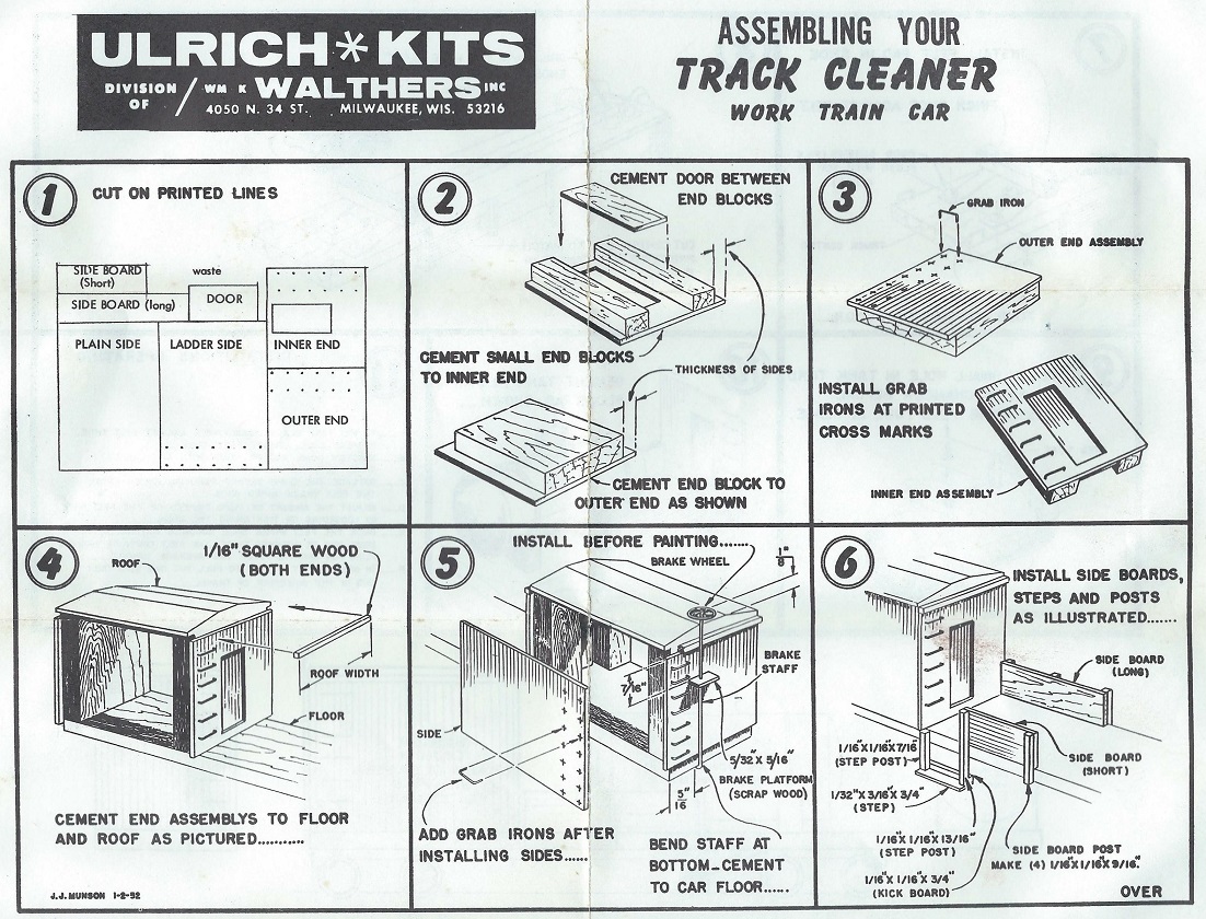

As a reference for those of you who maybe interested in this kit, here are my scans of the Walthers version of this kit....
If you choose to dress up this kit with a Tyco skid flat as I did simply cut out the original deck with a hobby knife. The Ulrich frame fits perfectly inside the ends and side sills of the Tyco Flat car.

According to the instructions for operation of this car, the flow of liquid track cleaner that is dripped onto the cleaning pad can be adjusted by loosening or tightening the dome. Well I have tried to get this thing to work as advertised with little luck, the track cleaning fluid always drains to quickly. I have since replaced to original track cleaning pad with the same abrasive pad used on Walthers current day track cleaning cars.
Just as well, I prefer dry track cleaning systems over wet systems anyway.
