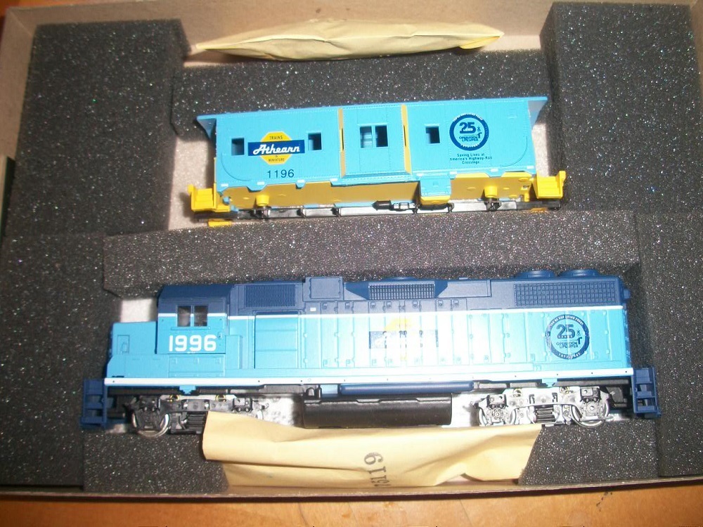

I finally got a Canadiana, from Dan Mack. I love the colors, the heritage. What I am
not wild about is the PT motor. Any thoughts on remotoring this piece? Up to, and
including, swapping out the chassis with this one:
Is there a tower motor out there that would fit the Tyco?

I repowered mine using an MU-2 set I bought off eBay. That would be the easiest route I would imagine. Everything just snaps in. I plan on eventually repowering all of my 430s with MU-2 trucks.

A Bachmann B23-7/30-7 would work also.
