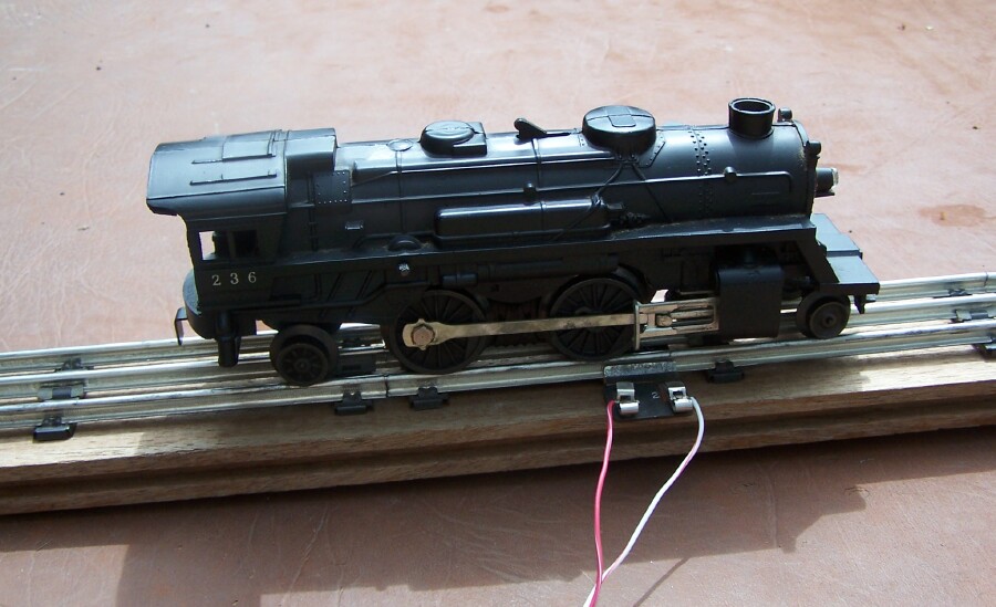

This is a special post for me today. Not due to the date, but due to the engine I'm posting. ( warning! long story! ) This one is my childhood engine, I got the set in 1962, I was almost 3 years old. While not a great set , it's got the plastic encased motor in the engine, but it DOES have some magna-traction in it, I think its actually a 1961 set when I looked it up, I ran this thing for a long time. Always took good care of it, too. But it had been put away, left in parents storage, until I took it back in the '80's, and it's been with me ever since. I finally broke it out last year, and started checking out the engine, it would hum but not move. I took it apart, cleaned it at my train shop, put it back together...and it didn't even hum anymore! I put away again, saddened. I wasn't sure what I did to it.
Fast forward to yesterday, I was working on a similar engine that JUST came into the shop, it was running, but squalling. I took it apart, cleaned it all up, oiled it, put it back together...IT STOPPED RUNNING! AUGHHHHHHHHHHHHHHHHHH! Now what?! My co-worker broke out the book, and I looked over the parts diagram closely. Nothing obvious, but then my co-worker pointed out the special E-unit gears. And then I noticed the way the two V contact springs were touching the two gears. This customer unit had two small holes in the gears, I thought they were like timing marks, line-em up. The book was a repro, and the diagram tiny, but when I looked REAL close, I could see the springs were touching a metal pad on one gear on one side, and not on the other side at the same time. I looked at what I did to the customer engine, and the contacts were touching on BOTH sides on EACH spring. WRONG! So much for obviousness!
So, I shifted one gear slightly to move the spring off the contact on one side, and put it back together. Holding my breath, I took it to the test track, and it fired up and it ran around in circles. WHEW! had me worried there! Still made a bit of noise around the track, so I got some more oil on the main axles, and it finally quit making noise. I was happy to get the customer engine running again after I'd broken it! These plastic Lionel motors have a two-gear E-unit, unlike the original Drum units of earlier models. A bit easier to work on, but they have some issues, plastic flashing on the gear teeth can prevent the gears from turning, I found two teeth like this in the customer unit, and cleaned them up. It then seemed to switch backwards and forwards now, which it didn't do easily before I got into it. A learning experience for sure!
Now, back to mine. Saturday evening, I decide to get mine out, take it apart again, and move the gears. I checked the teeth, the brushes, reinstalled the gears the way I had at the shop, and then put it aside until morning.
Sunday, I got up, and went rummaging in the basement for test track and a transformer ( and a track clip ). Found all 3, and I had some wood on the back deck, and took a piece and made a 6-section test track in 0-27. I have test tracks in other gauges, but had not made one for O gauge as of yet. Fixed THAT problem! Hooked it all up, got my cell phone on Video mode, and hit the lever on the Marx transformer - it hums, but the engine didn't move. NOW what? I looked for my voltmeter, but couldn't find it, so got a 18 volt bulb and socket, and brought that out. Nothing...Hmmm. Hey, it's got a red reset button on the side. I pressed it, and it snapped back down. OK, then! Fire up the phonecam again, hit the power, and off the engine goes finally! YAY! My childhood engine is FINALLY rolling again after nearly 30 years! Probably more. Then the smoke stack starts puffing, so even THAT is still working!
All in all, a learning experience on these far Post-war engines, not the same as the older mechanical ones. But I successfully fixed two of these in 2 days, so for that I"m very happy! I intend to take my entire train set to the shop Tuesday to run it on the 4x6 test track we have there. It'll probably be the first time in 30 years the whole set ( almost, I can't find my original tender, will have to borrow one for now, it's in the house somewhere I'm sure ) will be running together again. Pretty stoked that it's running now after all these years. I am pretty sure I had it set up to run at Xmas around 1988 or so, now that I think of it, I made a base for it and put it around a tree.
Anyway, a happy day for me, and a special LOTW post. Hopefully it'll be puffing away at the shop Tuesday in all it's glory again.

That's pretty fine Jerry.

Great to see it run Jerry! And one very nice POTUS engine Kris!

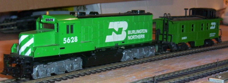

Tyco with Lionel caboose...

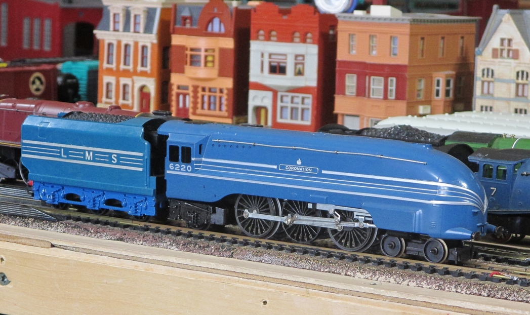

A second Hornby streamlined Pacific the Coronation.

Great stuffs! When I saw Ken's Coronation, all I could
think was: "be still, my beating heart!"

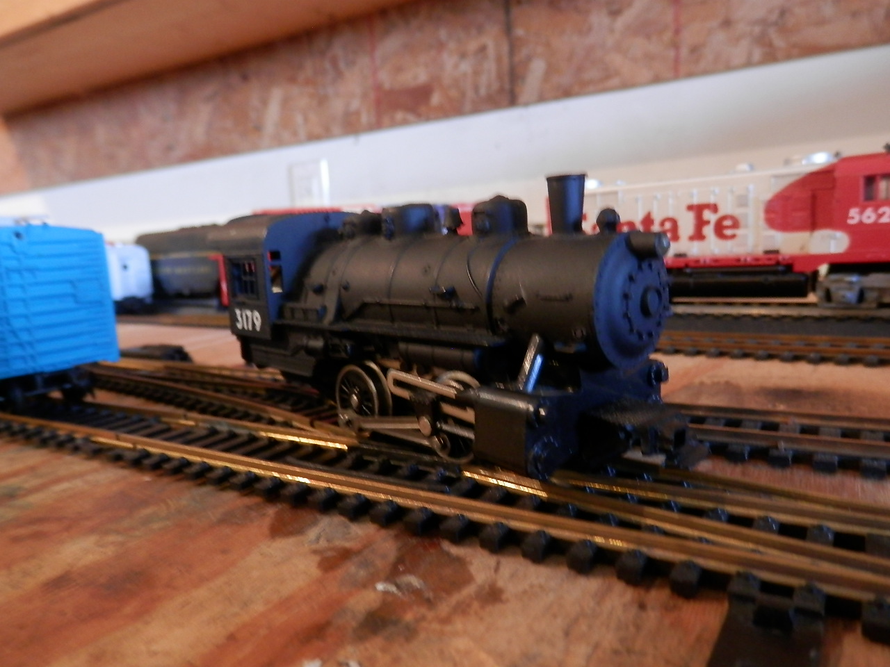

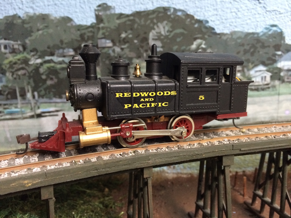

That's a wonderful story Jerry, great to hear you got it running again. Nice LOTWs all around. My loco this week is a DCCed Life Like teakettle, the version with the big can motor. Runs decent. I added a front coupler, still need to paint it.

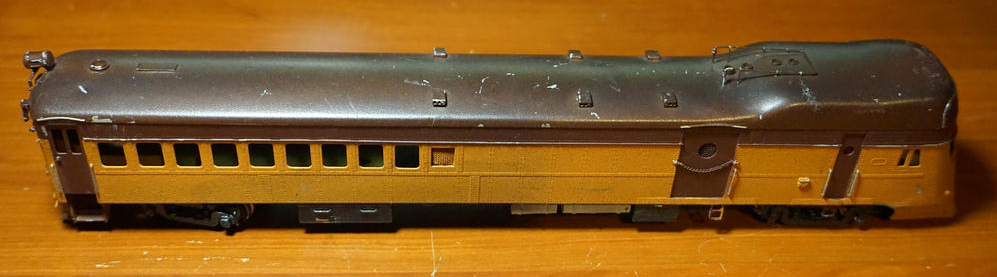

My LOTW:
A pretty rare and awesome find... HO NJCB Custom Brass #167 PRR Pennsylvania Streamlined Gas Electric passenger locomotive:
It needs to be stripped and re-painted and a couple small dings removed from the roof, but it was a pretty exciting score. The only example like it I could find sold on BrassTrains.com for $495. I picked this one up with a group of three other brass passenger cars, a Fleischmann Mikado and Rivarossi Cab Forward (Locos only for both) for just under $140.

I remember that auction! I was intrigued by the motor car.

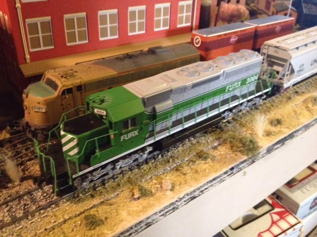

My loco for the week.

Sounds like you got a great deal!

I remember seeing FURX locos in UP colors too

Sean, you are THE shopper. This unit looks pretty fine as is.

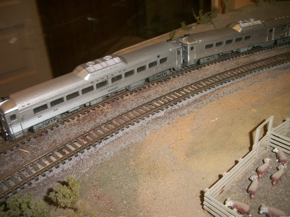

Nice score on the Pennsy. Please post the entire set, when u can. My
Athearn rubber band drive Budds.
Congrats, AMC. Always great to hear about bringing old, forgotten things
back to their use. Once upon a time your LOTW was the apple of someone's
eye, forgotten about for decades, and now she graces the rails again. Great
work!
