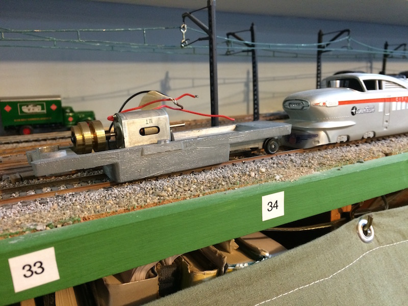

 Posted - May 16 2016 :  4:14:13 PM Link directly to this reply  Show Profile  Add Redwoods to Buddylist
Here's what that motorizing unit looks like (I also forget who made it). I used to have an Athearn SW truck in place but I needed it for another project, so my Aerotrain is still waiting in the shop for a truck.
