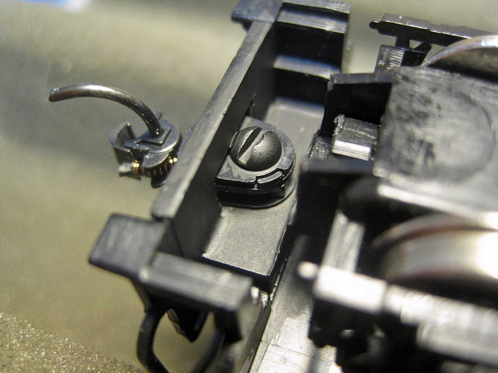

Here's some pics. First one of a Tyco GP-20 to show how much space it has. Not an Alco but I'm going to guess its similar:

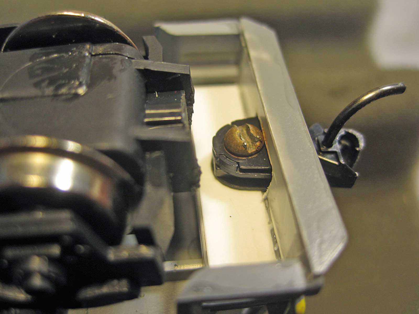

Here's a IHC SD40:

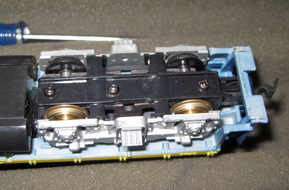

And a AHM RS3:
As you can see, there's not much room in those pilots, but just enough for what you need.
