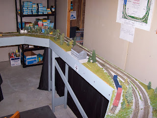

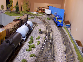

I've been looking at numerous track plans trying to decide on which would fit a spare bedroom in my house. I decided I didn't really want to go with a traditional 4x8 and wanted more of a shelf style layout. Well I think I found what I want. Apparently this track plan has proven quite popular and there is even a Yahoo group devoted to it. It takes up a perimeter of 8' X 9' which should fit nicely in my room. The trackplan is called "The Heart of Georgia" and looks to offer lots of operational possibilities. The author created a blog about it a few years ago. You can read all about it here: http://hogrr.blogspot.ca/
Here's some photo highlights from the blog:
The track plan:

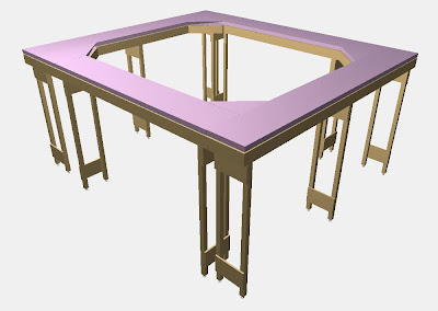

Benchwork:
With foam on top:
I like the fact I can run wider radius track and while I like scenery, I won't have to fill large areas with it. I will be able to concentrate on doing more detailed scenes in a small area. I'm excited about doing this one and spent about 3 hours creating it in Anyrail using Atlas Code 100 track. While this layout isn't for everyone I think it will suite me just fine.

on using Styrofoam base. I never had luck getting anything to
adhere to it very well, including foam specific Woodland Scenic
foam glue. If I was to do this, I'd try to find Homasote. But
that's just me.

For getting stuff to stick to foam, I've had good luck with Loc-tite Power Grab all purpose construction adhesive. It goes on white and dries clear. It stays tacky for a long, long time.
