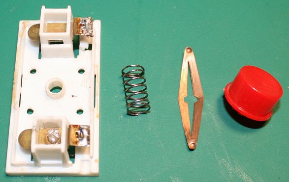

Sometimes the accessory will work, if only sporadically; other times there will be no action at all. Frustrated operators often times assume that the accessory is malfunctioning but the real problem is likely to be much closer at hand. The Prestomatic button controller is not what I would call "first rate engineering", the phosphor-bronze clip that is used to close the electrical circuit inside the box is just too flimsy to work reliably. That being said, operating a Tyco accessory without the Prestomatic would just not be the same.

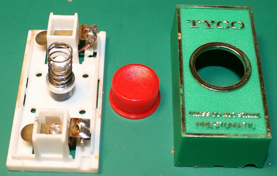

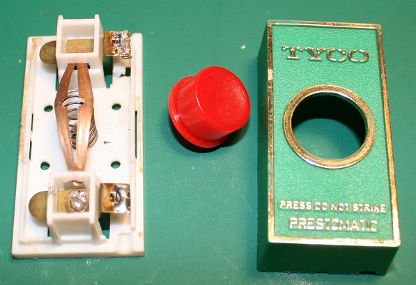

The first step is to remove the Prestomatic control box cover, I have found that the blue box covers are often times glued to the base and may need to be cut off with a razor saw. The green box covers on the other hand usually just pop right off.
Once you have the cover off, gently dismantle the Prestomatic's working parts, the only part that will be discarded is the diamond shaped phosphor-bronze clip.

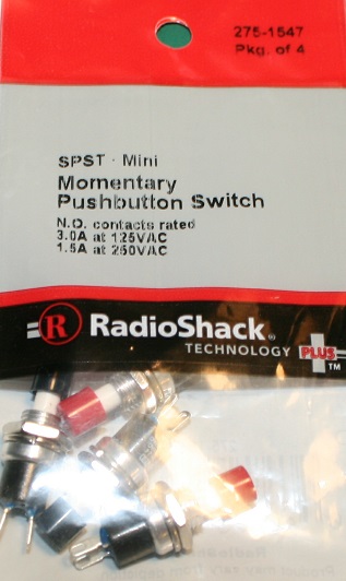

To replace the phosphor-bronze clip you will need a Radio Shack part 275-1547 Single Pole Single Throw Momentary Pushbutton Switch...

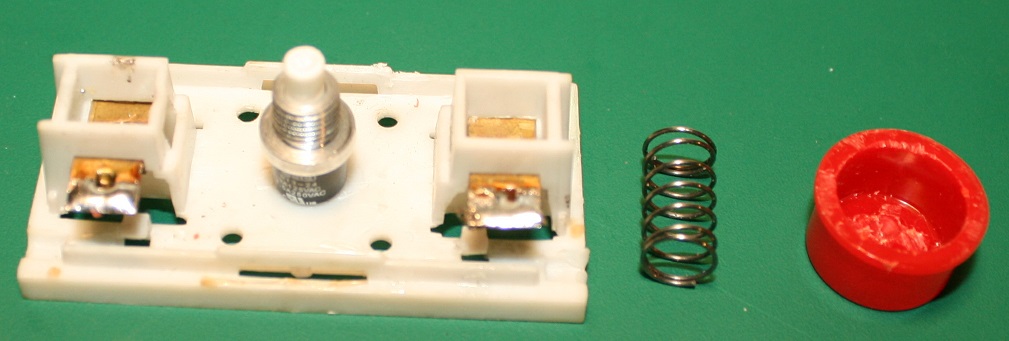

The first step, modify the buttons; remove the cap and "cap nipple" from the Radio Shack button and then hollow out the original button from the Prestomatic...

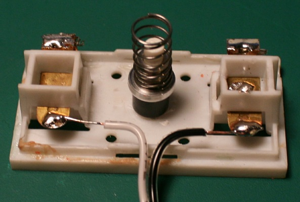

Next, install the Radio Shack Button on the Prestomatic's base, this will require removing the spring seat from the base with a razor saw.
Once the spring seat is removed the Radio Shack button will nest right into the existing hole in the base. To secure the button, simply bend back the soldering contacts and wrap them under the Prestomatic's base...

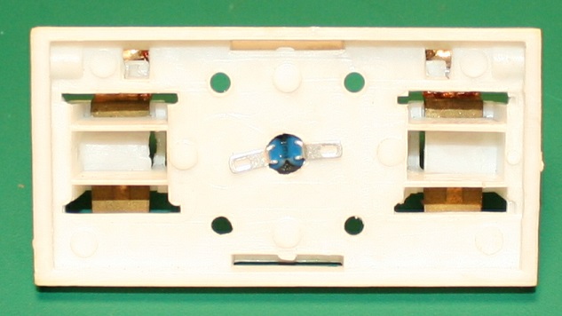

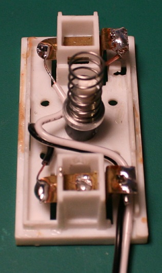

After the Radio Shack button is seated, solder jumper wires from each of the new button's soldering lugs to the existing Prestomatic's metal contacts...
After attaching the jumper wires from the Radio Shack button to the Prestomatic's metal contacts, you may then add the wires that will lead from the control box to the accessory...

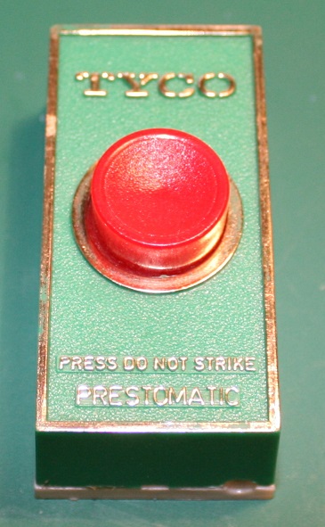

When your soldering is done, seat the original Prestomatic spring on top of the Radio Shack button and then reassemble the Prestomatic control box...
That's it, you now have a Prestomatic button that works reliably , install the rebuilt control on your layout and enjoy the improved performance.
