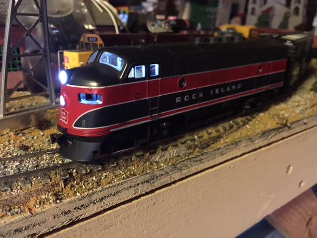

Up first is a good candidate for DCC. Its a Stewart/ Kato (Kato Drive) F3 In Rock Island. It received a NCE DEcoder and leds. Paid 30 for the loco, 11 for the decoder and 2 for the LED. (Buying in bulk helps) 3 for the replacement number boards. For nder 50, you get a great running DCC unit.

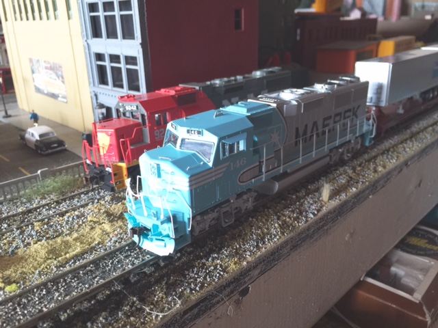

Two diffrent era Athearn RTR locos. One of them came DCC ready while the other one was closer to Blue Box Standards. Currentl RTR are simple plug and play locomotives. I didnt replace the lights and they are easy to convert to dcc. Just unscrew the coupler boxes, remove the shells and plug in your decoder.
The NdeM was a bit more work. The decoder was hardwired in and the motor was isolated. I have yet to update the lights but it will get LEDs in the near future.

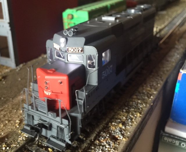

Well back on track, Here is a recent convert to DCC. This is a Blue Box from the final run right before they went strictly RTR. It had plastic handrails, dogbone drives and runds excellent. I upgraded the lighting to LED and have since added numberboards. not to hard to convert, once you isolate the motor.

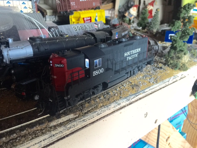

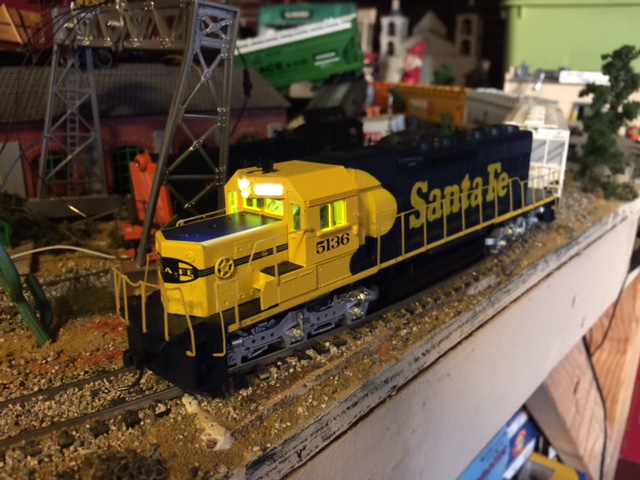

I have been totally swamped at work so I have not really done a whole lot of work on the layout or workbench. I also had some construction work at home and that required that I move alot of stuff into the train room for the time being. As things get back to normal, I will be working on the layout a bit. I will start with two recent aquisitions:
Both Geeps are Proto 2000 and both are new old stock engines. As expected, these suffered from cracked axle syndrome. I always keep extra axles at hand so fixing them was really not a big deal. Once fixed, I added DCC to these locos. 1 was DCC ready but chose to hardwire a decoder in regardless. I added LEDs and herea re the end product.
