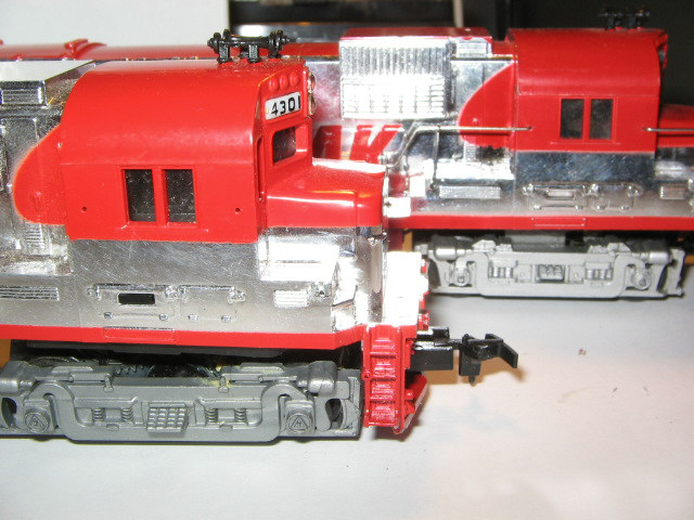

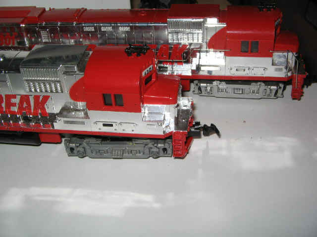

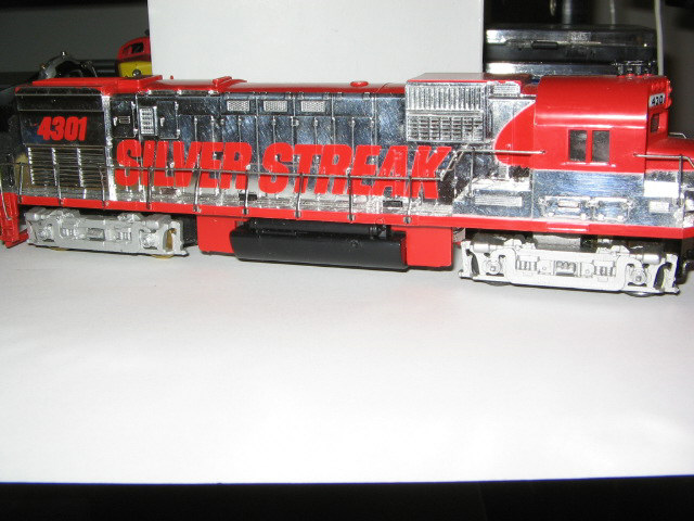

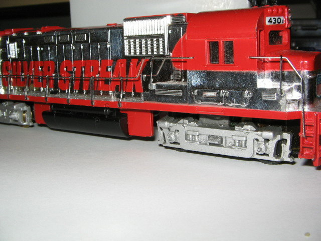

Here are pictures of what a tyco that originally had a power torque drive that has been swapped out with a mantua drive. The front Mu truck will fit into the tyco shell perfectly. On the rear-i used the mu truck also-to do this-you have to use the spring off the power torques rear drive and a flat washer(1mm thick and 11mm wide) placed on top of spring to keep it level. Total time for the complete swap=15 min or less. Well worth it. You do not have to swap rear truck but you will have different looking side frames as mantuas are more realistic and a little smaller than tyco. The side frames are not interchangable either as manutas are slightly shorter. see pictures below
first engine has original power torque-2nd is mu converted

 Posted - May 05 2007 :  9:29:44 PM Link directly to this reply  Show Profile  Add Alco Fan to Buddylist
Thanks Brian,
I'm anxious to do that kind of a swap. Hey that SS Alco looks good with handrails, why didn't Tyco think of that? [^] You never see them (SS) with handrails, not in the catalog pictures.

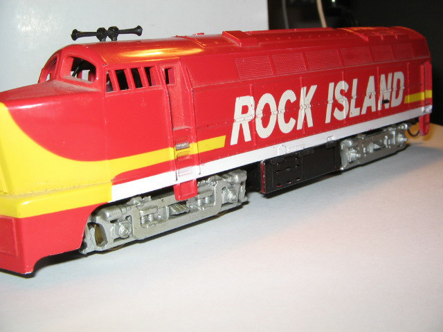

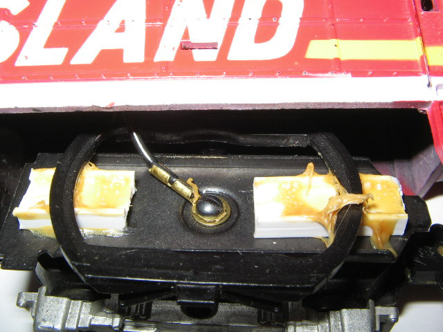

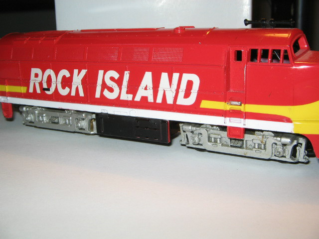

Thanks alco fan. Here is a tyco Rock Island converted to a mantua driven unit. There is some modification required to mount the rear mantua truck. tab. You will need a Plastruct beam also. You use the original tyco rear mount lug for shell only. Remove the rear power torque pick up completely. Snap the tyco trucks off shell lug. Using the plaastruct beam- cut into two pieces and glue to the metal mantua plate Then glue it to the tyco shell lug. Reconnect the power pick up wire with screw and snap back into shell. The unit should be sitting level. I used walthers goo on mine. For the front-remove coupler pocket completely and bend or cut off where coupler mounted to allow turning. no other modifications required. I used a kadee#5 on the rear. I completely removed the original coupler pocket and glued the number 5's housing onto where the mantua cover went. no front coupler installed yet-probably a #27or #28 for front.

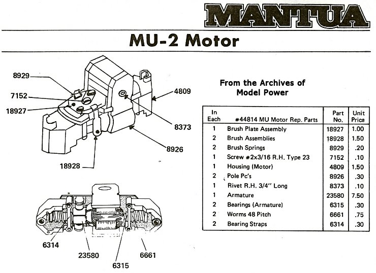

The MU-2 motor was in early Tyco Mantua diesels, and is most dependable and prefered when compared to the PT motored (Power Torque) diesels. The basic design of the MU-2 has an armature that is typical to those in most and more expensive models. The PT has a flat "pancake" design and I believe is very similar to the armature on '60s Aurora HO slot cars. They often run well and then just give up, which is disappointing. The MU2s just keep on going... and have this great slow speed growl.

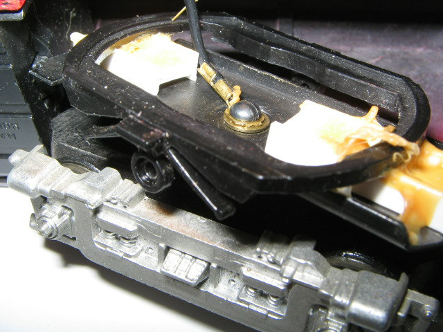

Shaygetz, the MU-2 truck used the same 5 pole armature, magnet and brushes as the PM-1 motor in the steamers. The location of the armature precluded any six-axle units.
This is an odd picture, because it has a plastic gimbal like a PT, but a steel bottom plate. MU-2's had metal gimbals, except for a cheap plastic version that was only made around 1974.
