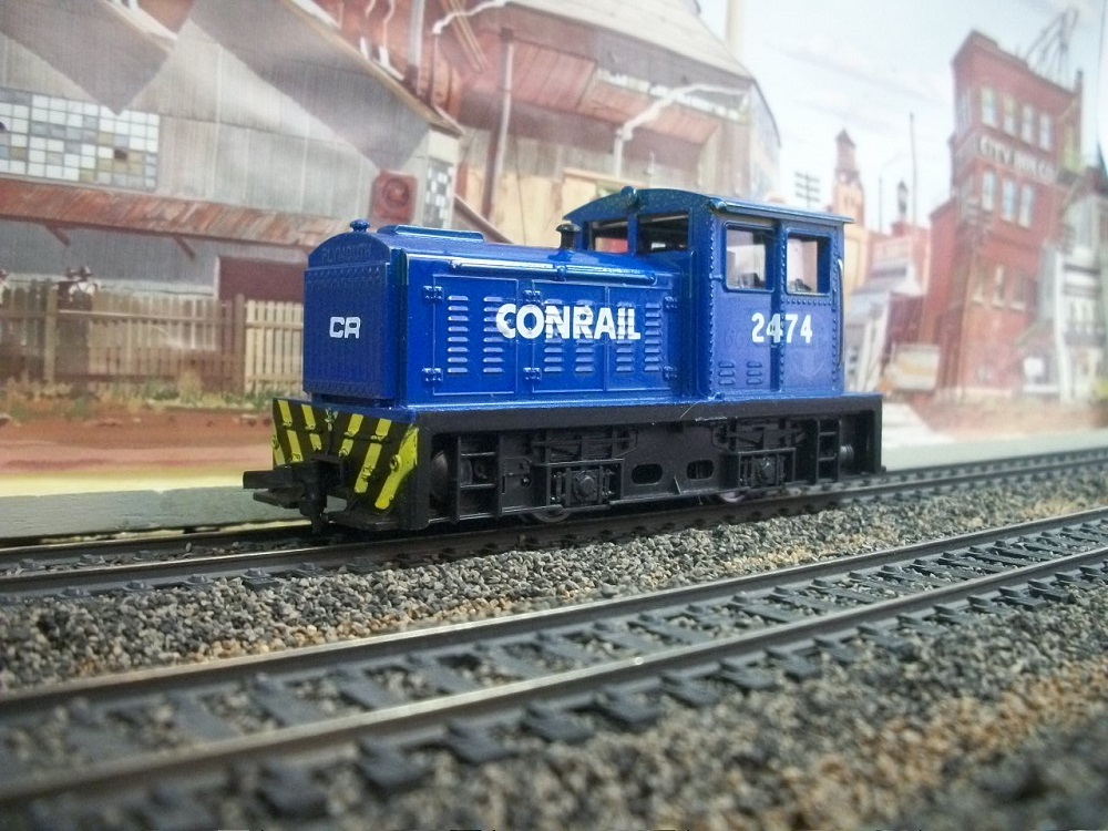

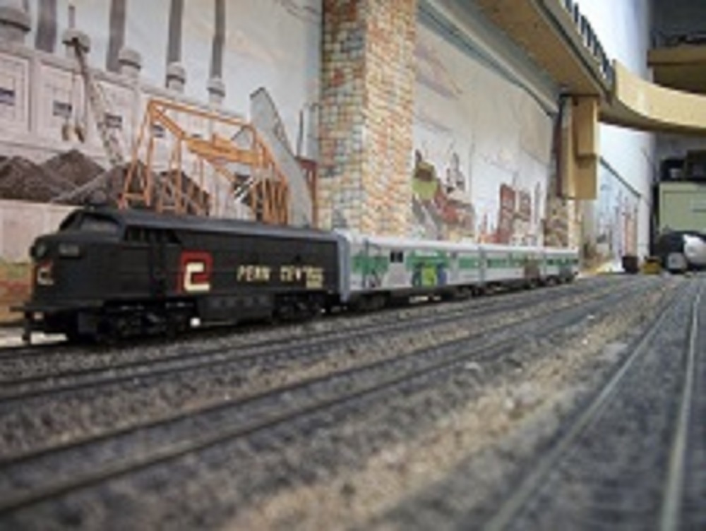

 Posted - February 16 2016 :  01:45:25 AM Link directly to this reply  Show Profile  Add Chops124 to Buddylist
Did this with a rattle can.
Did this with a paint brush.
