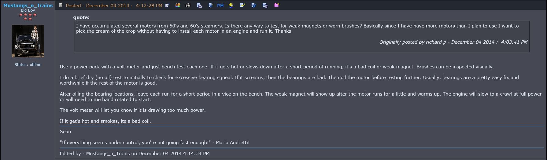

 Posted - November 19 2015 :  2:01:24 PM Link directly to this reply  Show Profile  Add toptrain to Buddylist
Some good advice from Sean, "Mustang N Trains ".
All very good info is by Sean and it is he who deserves the credit for formulating this info.
Tyco post heading.
Post; click to make larger.
Edited by - toptrain on November 19 2015 2:02:56 PM
