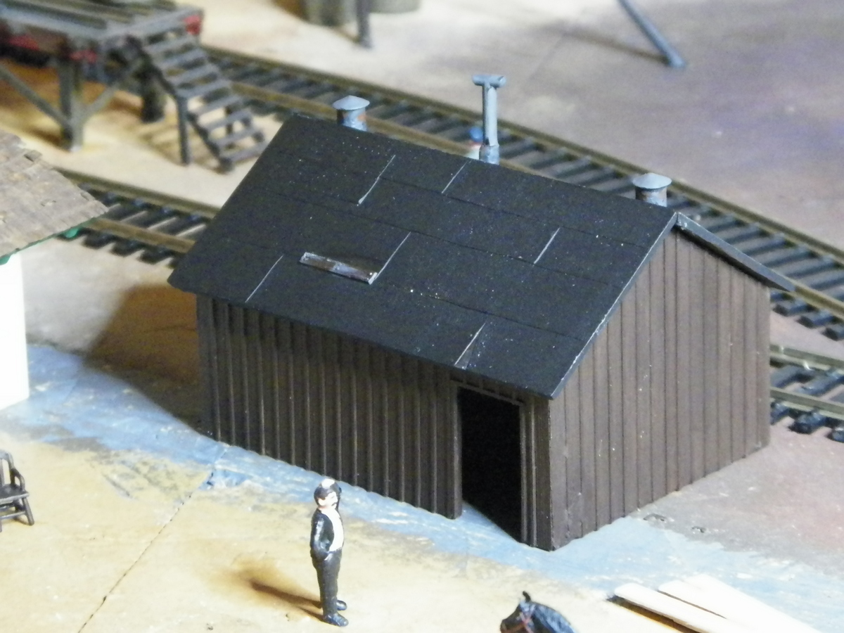

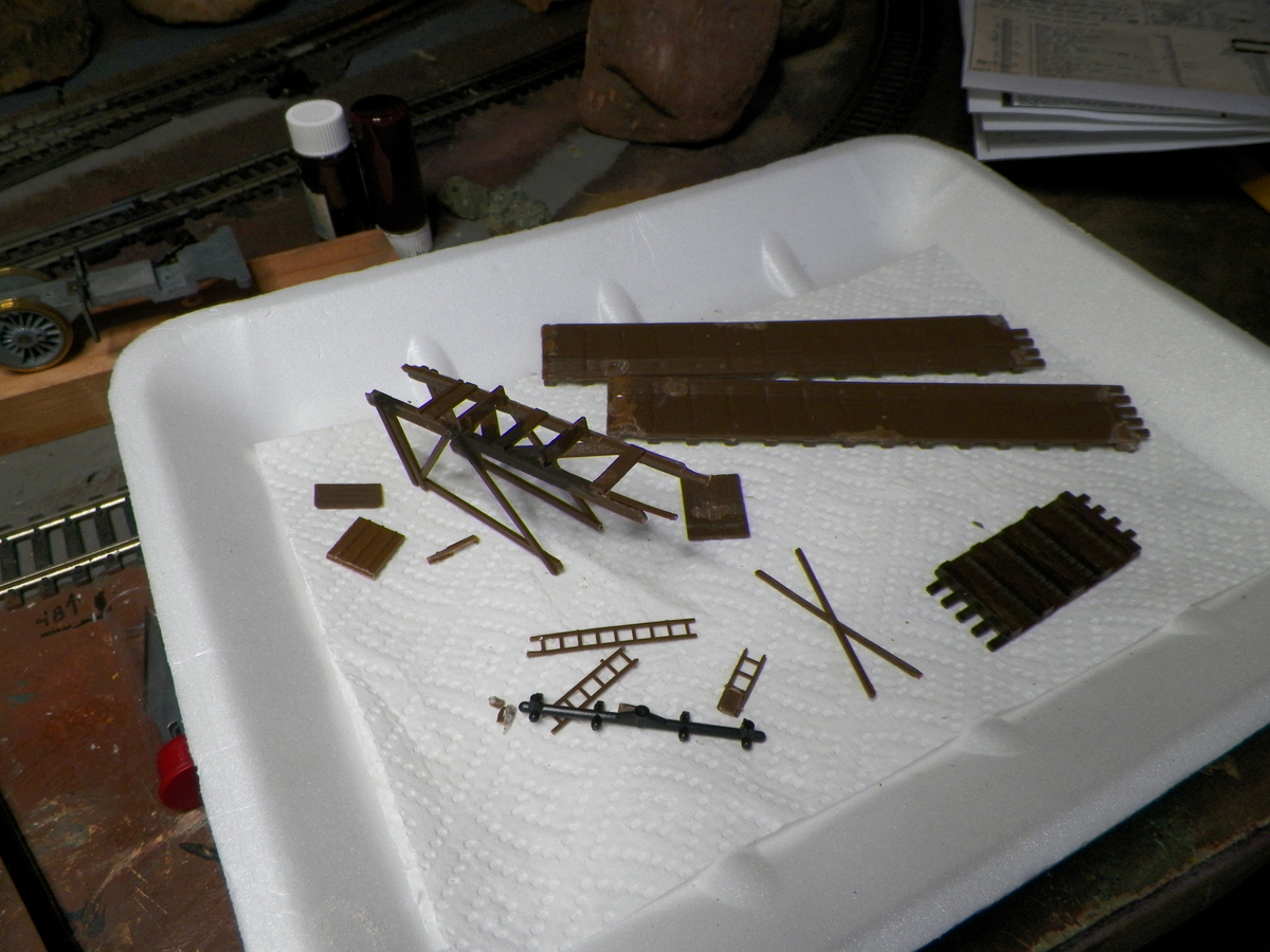

Ranking right up there with more of my worst eBay purchases is this sand house. I probably saved $5 buying this already messed up sand house instead of an untouched kit. Though, I do find that once I get started on a repair, I usually feel a bit more freedom with a pre-built . . . I mean, hey, what can you mess up? The first picture is from the eBay posting. What I got in the mail was a bit different. It arrived with the sand tower broken in a few pieces; not attached to the roof as in the posting photo and the glue mess became very readily apparent. I let it set for a few weeks; kicking myself whenever I noticed it and at the same time how much I wanted a sand house and wasn't ready to commit a few weeks or more to building one from scratch. Voila! Instead, I have opted to spend a few weeks on this plastic tragedy . . .
One thing I did to start was to put a door opening into the sand bin. My ignorance, I guess, but I can't see how they would get the sand from the bin to the furnace with no opening in either the sand bin wall or to the drying room ? ? ?

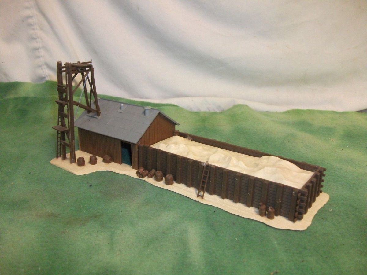

Hi, Barry. I have often found myself wanting the Tyco Sand House. However, since I don't run steamers I figure the kit would have no real place on my layout... I'm sure you will get the kit restored.
Originally posted by Barry - October 13 2015 :  1:47:58 PM
The previous owner put the end walls on wrong. The other end wall has a hole in the end that looks like a window opening. That should have been on the end toward the sand bin for shoveling sand from the bin into the building.
Under the smoke jack would be a pot-bellied stove with a funnel shaped screen around it. The wet sand is shoveled into that and then the sand dries and falls through the screen. The dry sand is blown up through a pipe into a metal bin on the tower from which it falls through a hose into the locomotive sand domes (or sand hatches in the case of a diesel).

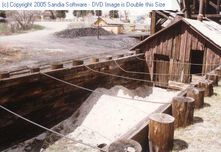

One can't help but notice the similarity between the Chama sand house and the model kit, so I bet the one inspired the other. The Chama sand bin is propped up with round posts and the model uses square ones, but I think that's just for ease of getting the parts out of the mold. For mine, I made my own bin to the dimensions I wanted and copied off of the Chama design, using round pilings.
C&TS no longer uses the sand house. They get bagged sand and dump it in the sand domes by hand, but years ago, I saw a crew member drying sand using the stove. At the time the pneumatic system for lifting the sand into the tower already didn't work.
I think the pipe leading up the tower carries sand in a jet of air, so it is both a sand pipe and an air pipe with sand being the point of the thing.

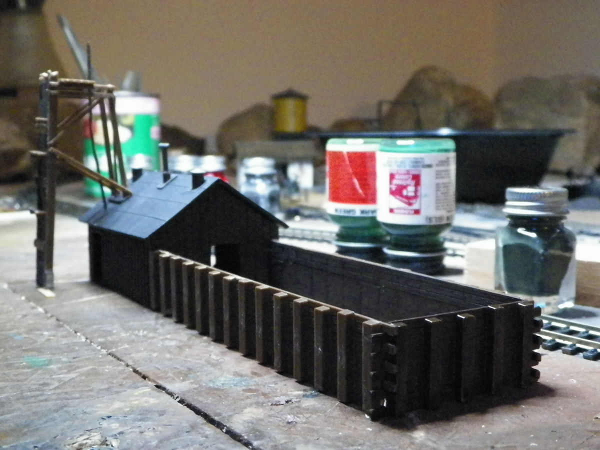

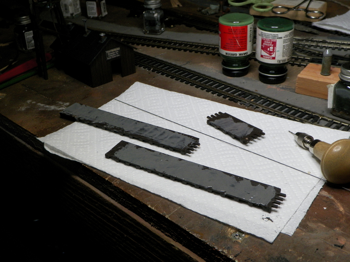

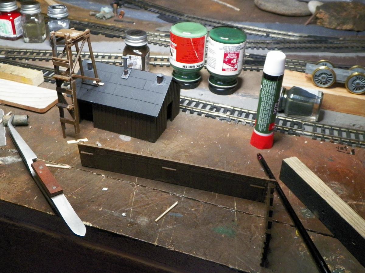

A bit more "sculpting" today (that's what it feels like smearing JB Weld around with a toothpick; trying to make it look like a piece of wood . . Ha!). Had this old shell casing that seemed about the right size for the sand tower tank; plugged the end and gobbed it up with JB Weld. "We'll see . . . "

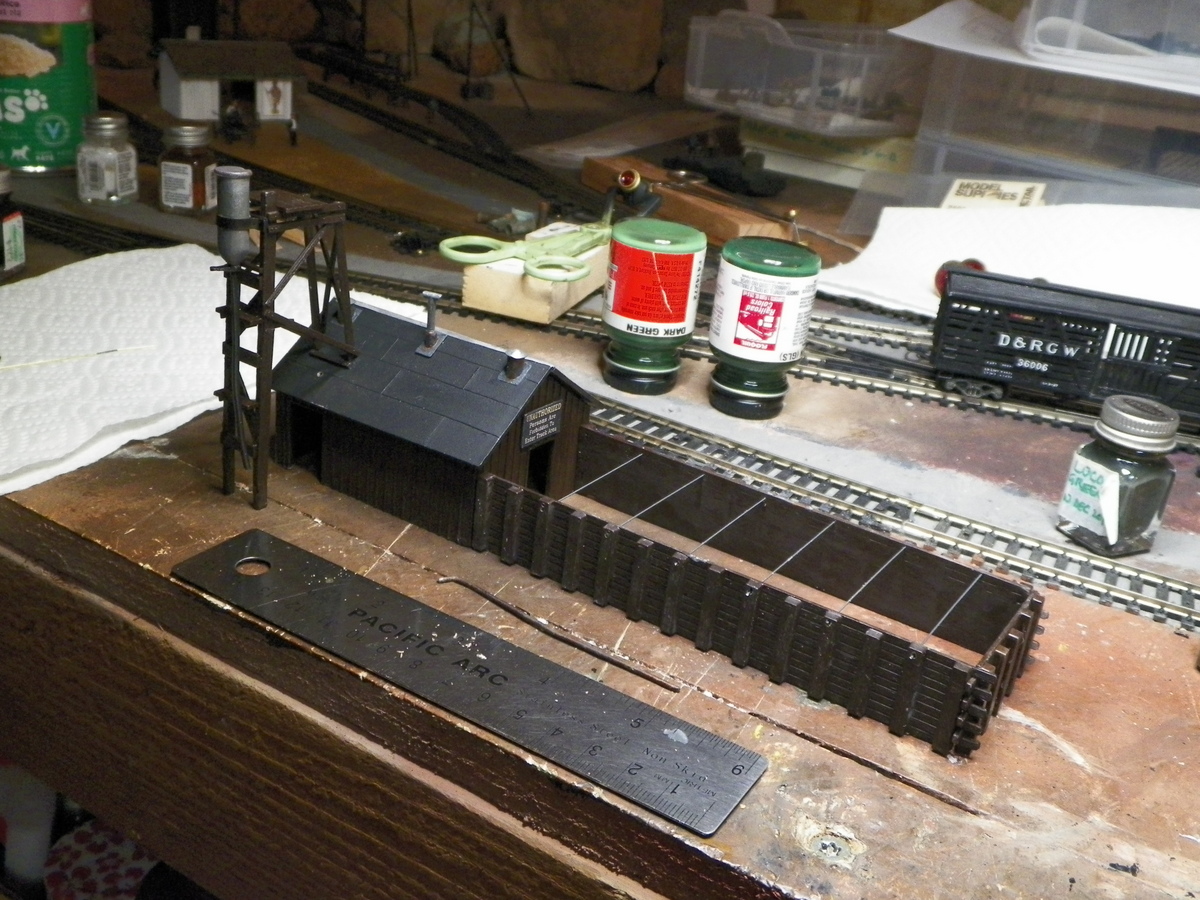

 Posted - October 16 2015 :  12:38:42 PM Link directly to this reply  Show Profile  Add Barry to Buddylist

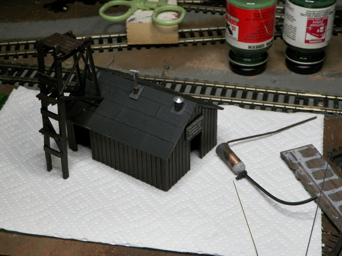

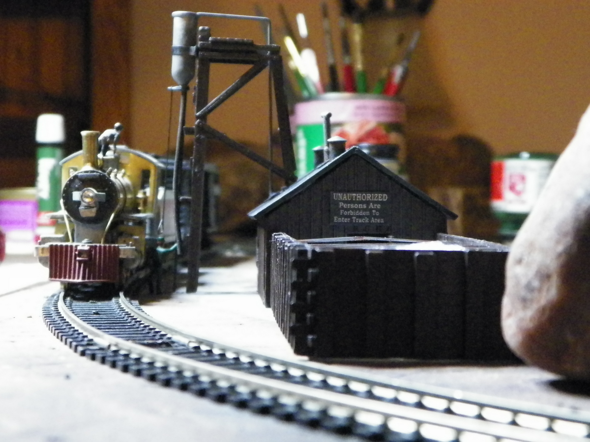

Added a sign and filled in the molding depressions on the inside of the plastic sand yard wall. I think after sanding and scratching up a bit and paint, it will look a bit less like a plastic wall. Also getting ready to place some of those rods that are stretched across the yard walls. I'm thinking they might have been used to support tarps to try and keep the sand clean and a bit more dry? Do you know Don?
 Posted - October 18 2015 :  7:59:46 PM Link directly to this reply  Show Profile  Add Barry to Buddylist

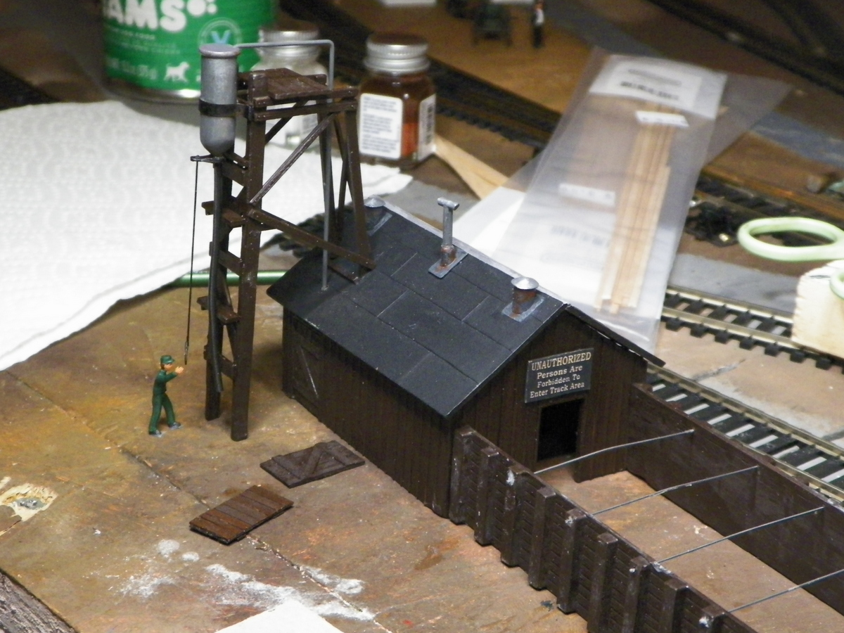

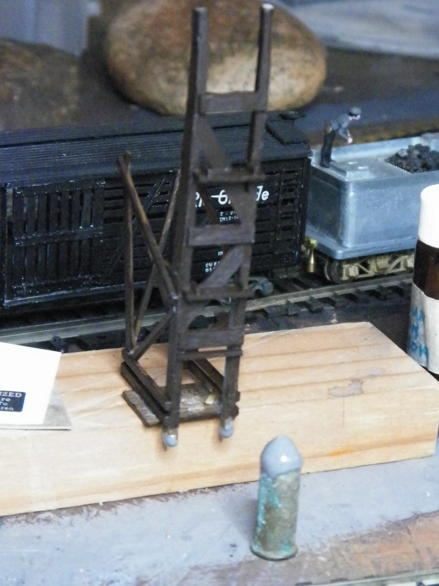

Not sure whether I'm going to like this bullet for a sand hopper or not, but I'm continuing to pursue it for the time. Got the excess JB Weld off the interior yard wall and scuffed it up with rough sand paper. The sand tower is pretty much complete; save figuring a believable mounting method for the hopper.
 Posted - October 18 2015 :  8:44:34 PM Link directly to this reply  Show Profile  Add scsshaggy to Buddylist
Originally posted by Barry - October 16 2015 : 12:38:42 PM
I think they are tie rods to keep the walls from sagging outward. With all those tons of sand pushing out on the walls, they would tip outward over the years. I doubt that they covered the wet sand, since it was going to be dried, anyway.
Originally posted by Barry - October 18 2015 :  7:59:46 PM
I think you'll know after it's painted. Some awfully cobbled up looking things can look great once the appearance is unified with a coat of paint.

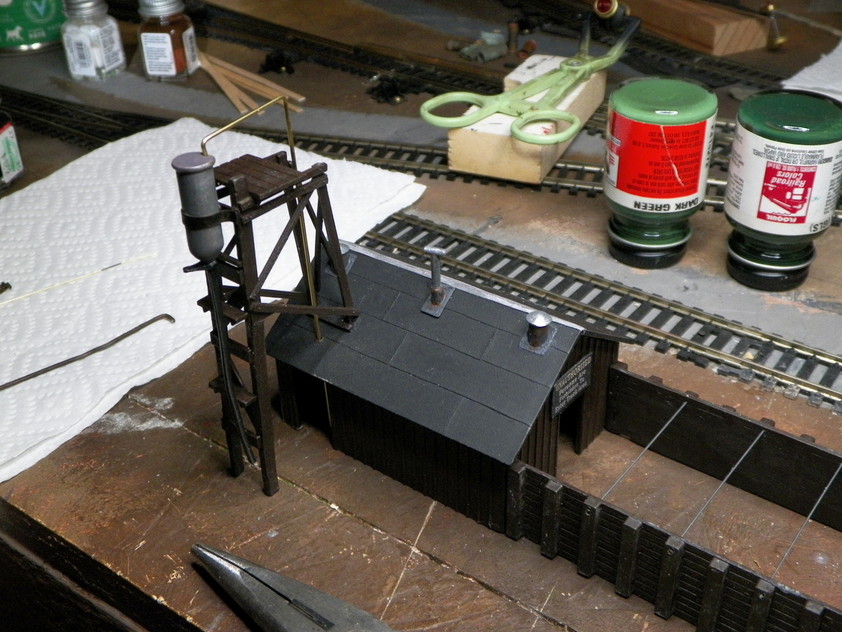

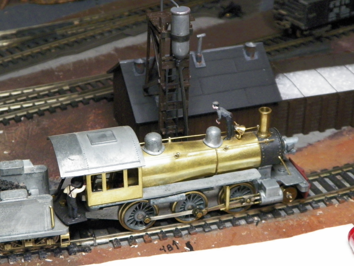

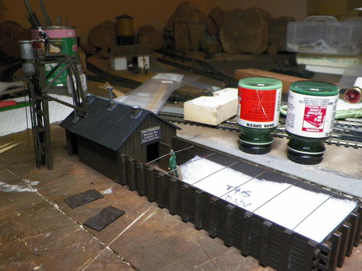

Playin' around with some things. The rusty staple that was going to be my sand pipe wouldn't tolerate bending; thus the brass wire. Guess I'm gonna go with the bullet for the time.
 Posted - October 20 2015 :  2:30:51 PM Link directly to this reply  Show Profile  Add Barry to Buddylist

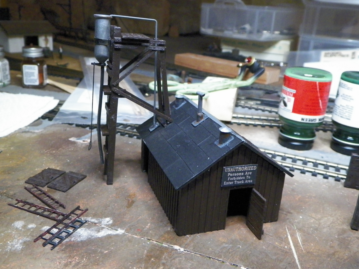

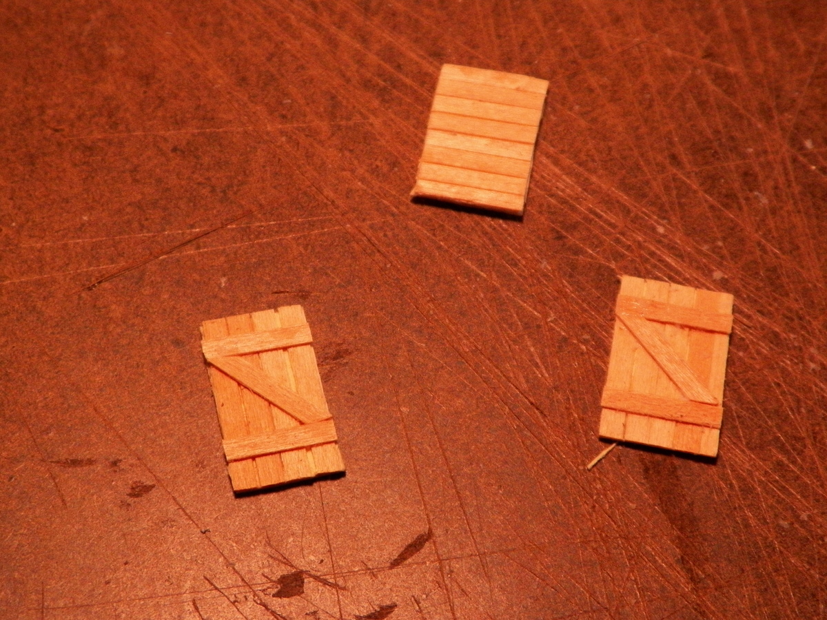

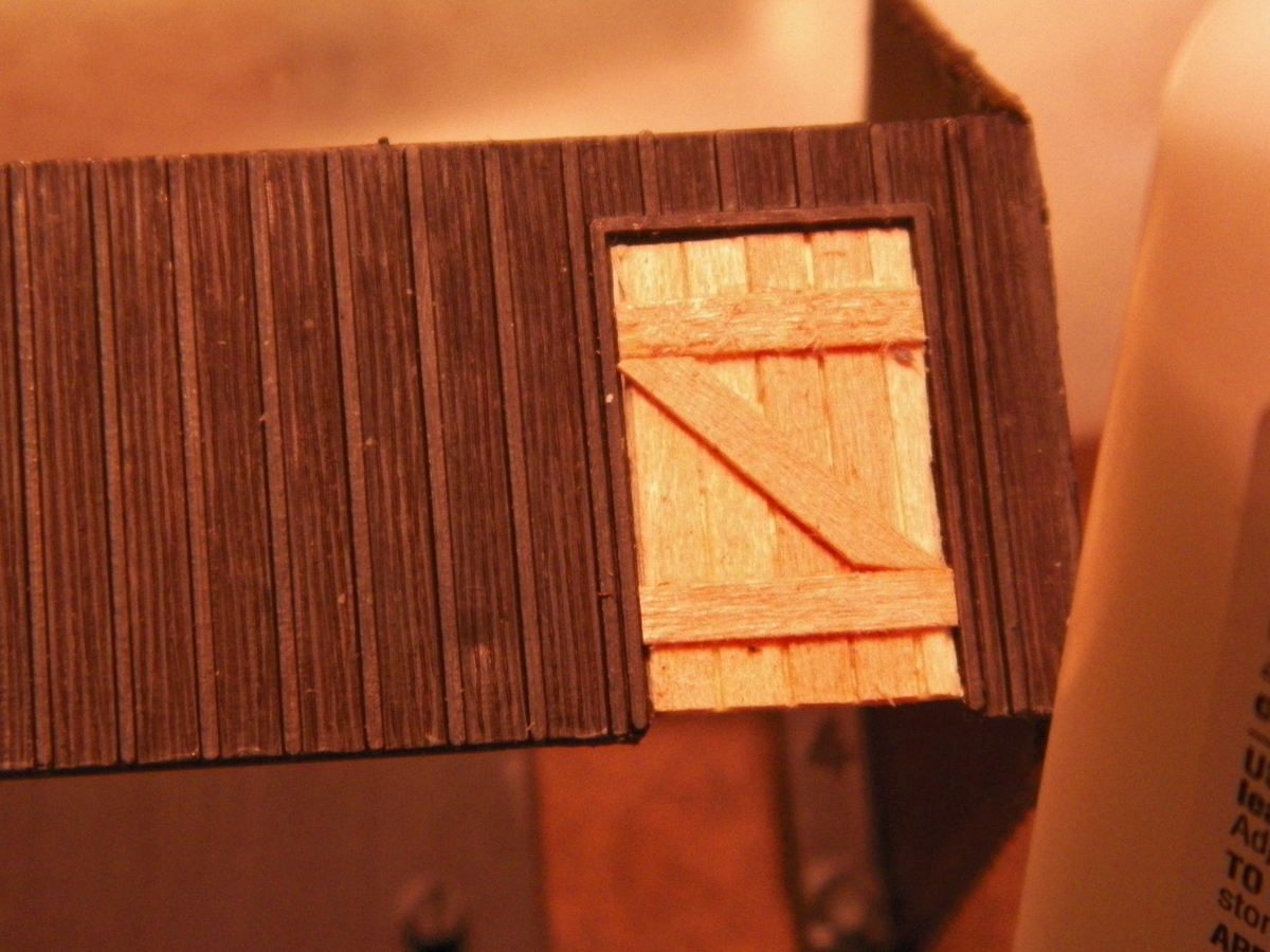

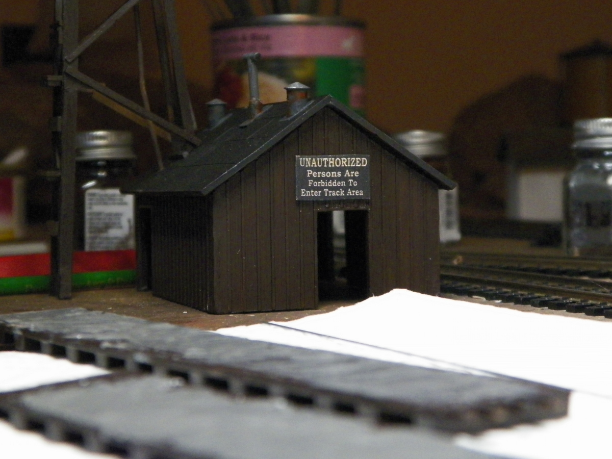

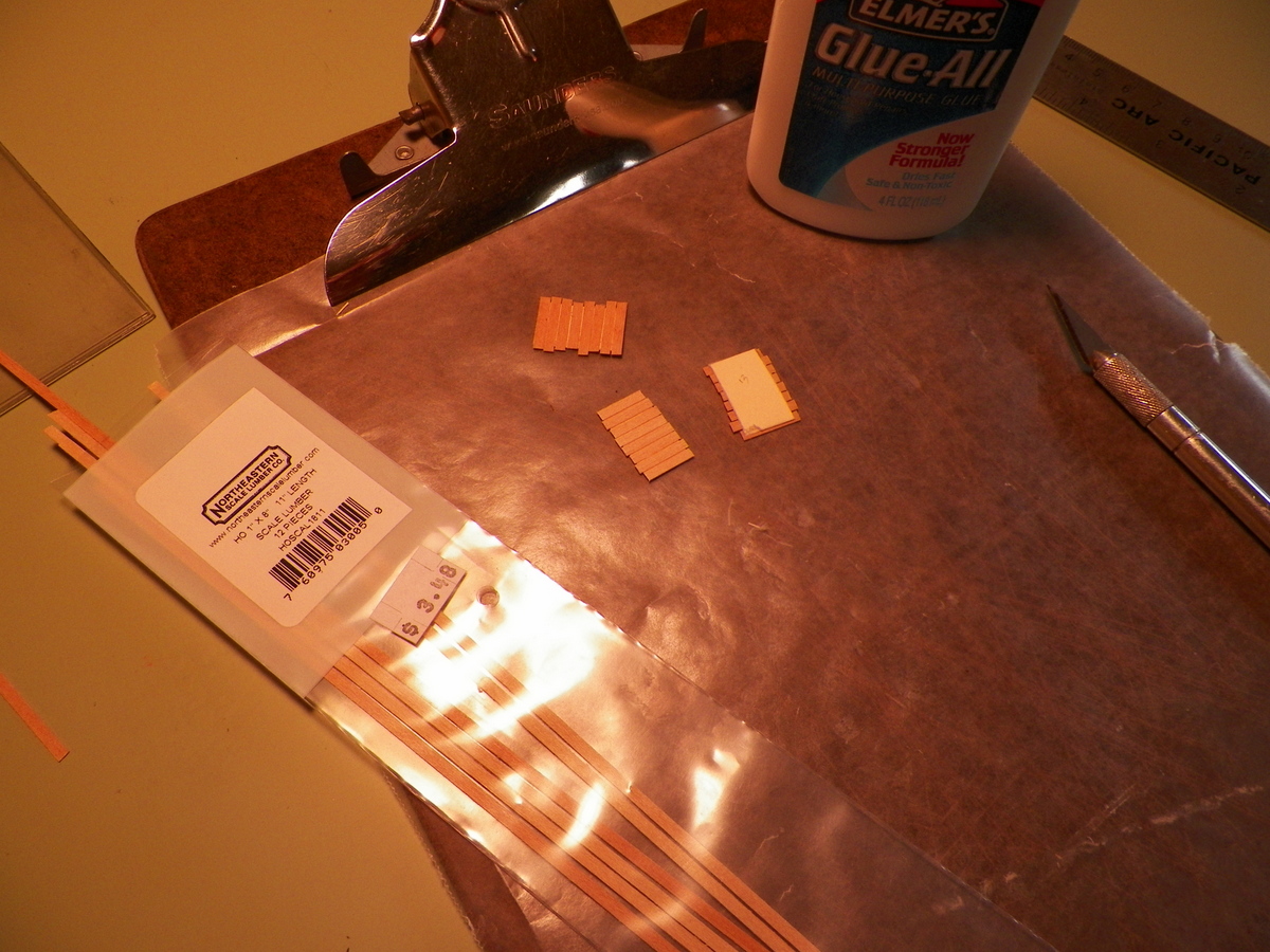

This pre-built didn't come with any doors. I've had the opportunity in the past couple weeks to visit a circa 1900 sand house that was used by a local railroad (Colorado Midland) and now sits as a garage a couple doors down from my son-in-law. I got to meet the owner and some history and a look inside a few days back. One remarkable thing I noted was the way the interior was built real tight with horizontal boards (still pretty tight to this day; after a 100 years); outside was vertical board and batten. So, that's the deal with these crude models of mine.
I'm not sure what that little guy is up to . . . maybe just standing there to help me get a sense of scale
 Posted - October 20 2015 :  3:24:08 PM Link directly to this reply  Show Profile  Add scsshaggy to Buddylist
I think you're ending up with something a lot nicer than the kit, as designed.
As usual, your tinkering approach is bearing good fruit.

That's some really good restoration work!!
My biggest question - what caliber shell?? That turned out brilliant!

Thanks for the kind words. Carmine, I thought it might be a .38 (never measured it), but it is a rim fire. I had to do some digging for plumbing work this past summer and found a few of those. I'm still not sure what I think of it. I think the lip at the top seems a bit big, but the depression from the rim fire made a great spot to run the sand pipe in. Since I began this, I learned that the local (use to be) railroad used sand towers that were enclosed and had a metal spout instead of this hose operation. Alas, there will be a way for those little guys to get sand to the locomotive. [Now I've been thinking what wills be the manner that sand gets unloaded into the sand yard . . . bucket loader from a gondola? Conveyor? ? ? ]

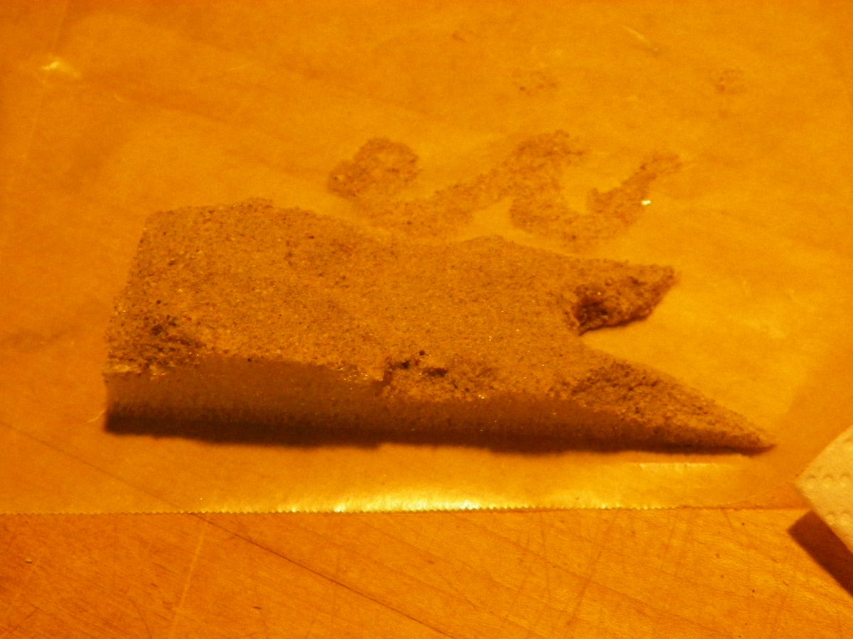

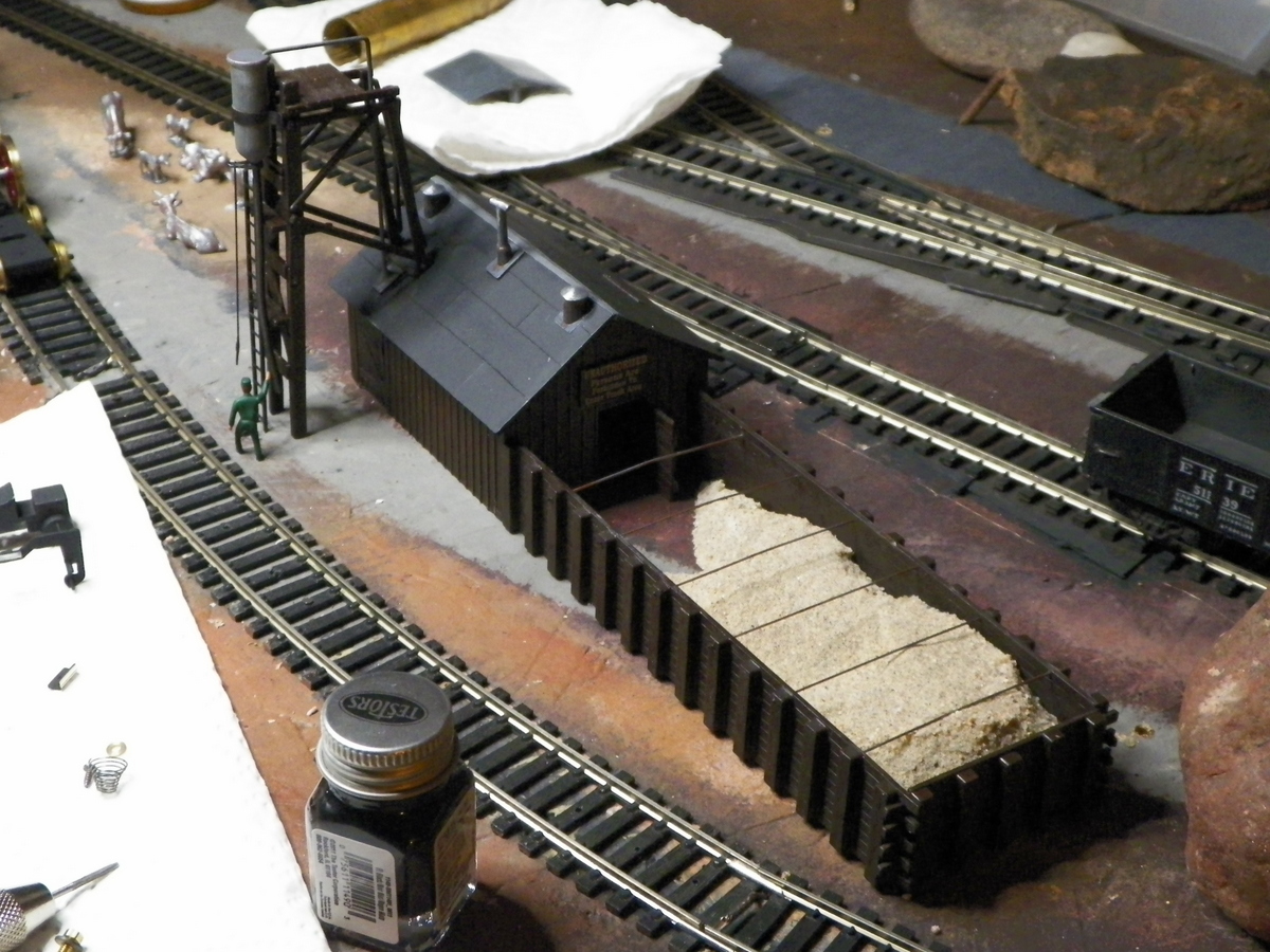

Playin' with things some more; how to carve the sand pile(s) . . . maybe depends on how it was dumped in there.

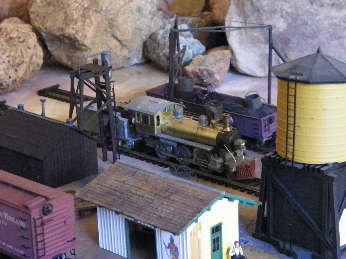

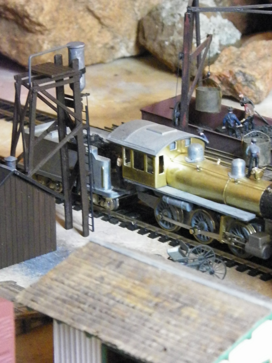

In my sand house scene, I use some fine, white beach sand. To scale, it's huge but to the eye it looks like sand rather than rock. That's fairly easy to scrounge here in Illinois. I'm not far from Lake Michigan, and not far from the St. Peter's silica sandstone formation. In your case, I'm not sure how available fine sand is in the front range.
I like your pictures of the engine at the sand tower with the guy working around the sand dome. John Allen began his model railroading hobby as a way to create and photograph vignettes that way.
Also, that shot of the coke coming in a box car was fascinating. It was interesting to see the way the door was boarded to hold the coke and the huge scoopful of coke and the great big wheelbarrow for moving it. Coke, as I've seen it, is not very dense so you can handle big volumes of it in a reasonable weight.

 Posted - October 23 2015 :  9:23:39 PM Link directly to this reply  Show Profile  Add Barry to Buddylist

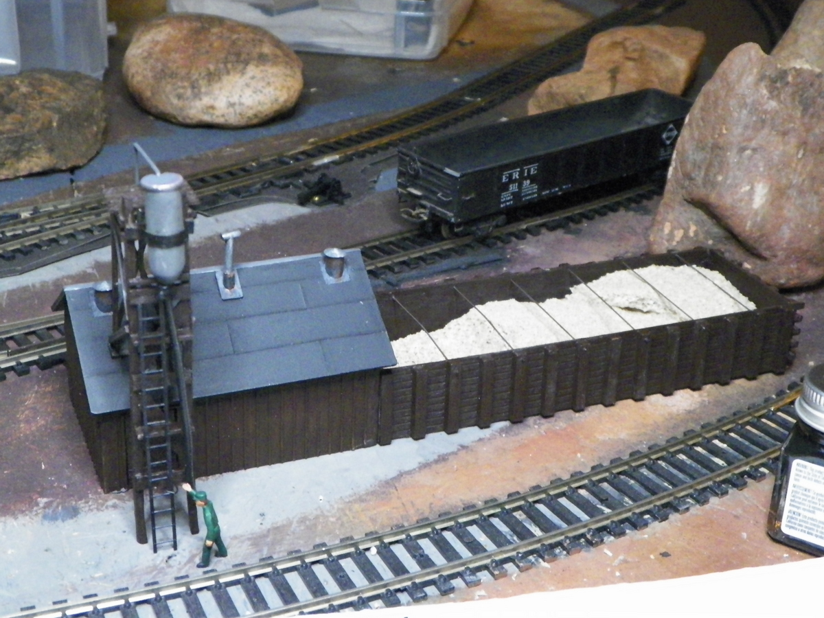

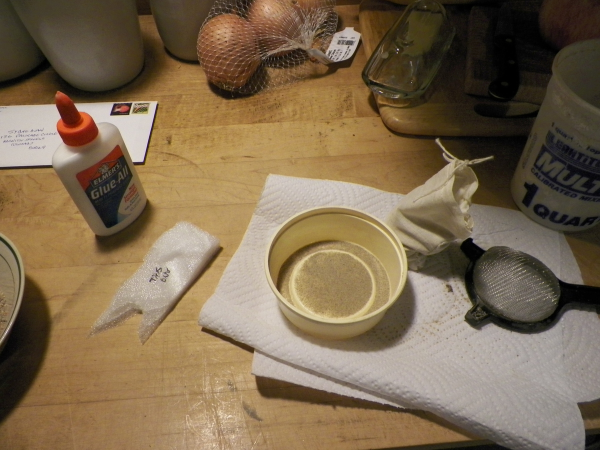

Had some masonry sand and filtered it down some . . . Elmer's glue to that piece of spongy packing foam . . .
 Posted - October 23 2015 :  11:11:56 PM Link directly to this reply  Show Profile  Add scsshaggy to Buddylist
The masonry sand looks good. I like the tower with the ladder added, too.

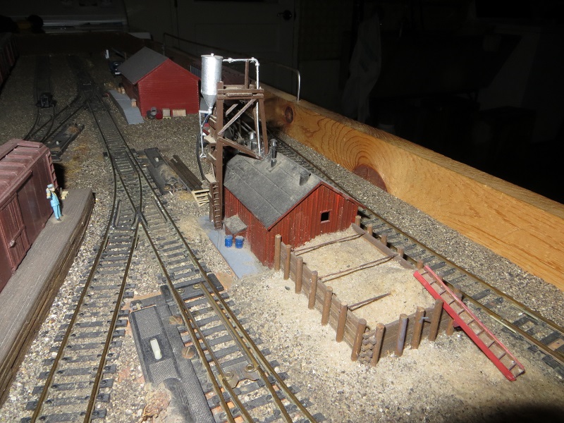

 Posted - October 24 2015 :  2:56:51 PM Link directly to this reply  Show Profile  Add Barry to Buddylist

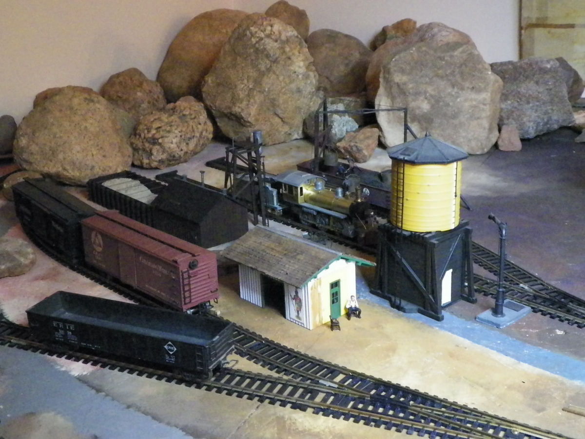

A spray of dull coat and "temporary (year or two?)" placement. Guess I'm done messin' with this for now. People should live so long as to be able to finish a model train.
 Posted - October 25 2015 :  11:13:57 PM Link directly to this reply  Show Profile  Add scsshaggy to Buddylist
That's a nice looking overall scene. I like the way the sand tower and water tower frame the engine and the coal bucket loader. It looks like a busy, railroady place.
 Posted - October 26 2015 :  12:45:37 PM Link directly to this reply  Show Profile  Add Barry to Buddylist
Thanks Don. If I thought this was going to be a permanent placement, it would be fun to do a little landscaping and get those structures to blend in a bit better. I also look at the water tower and the freight building and see things that could make them a bit more believable. One thing at a time, hey? I'm wanting to replace my layout board though. This ones made of several pieces that are not aligned well and so the track needs shims in several places. Not that that is terrible, but I'm wanting to start fresh and maybe change the size . . . surprisingly even go smaller. I ultimately would like to have a layout that could be squeezed down the rather tiny stairway without having to cut in half. Unless I somehow magically find a big empty room in our house. We'll see how that works out.

 Posted - January 02 2016 :  12:31:37 AM Link directly to this reply  Show Profile  Add walt to Buddylist
I really like Barry's Sand House. Always liked the kit but never bought it due to I don't run steamers... Great Job, Barry!
