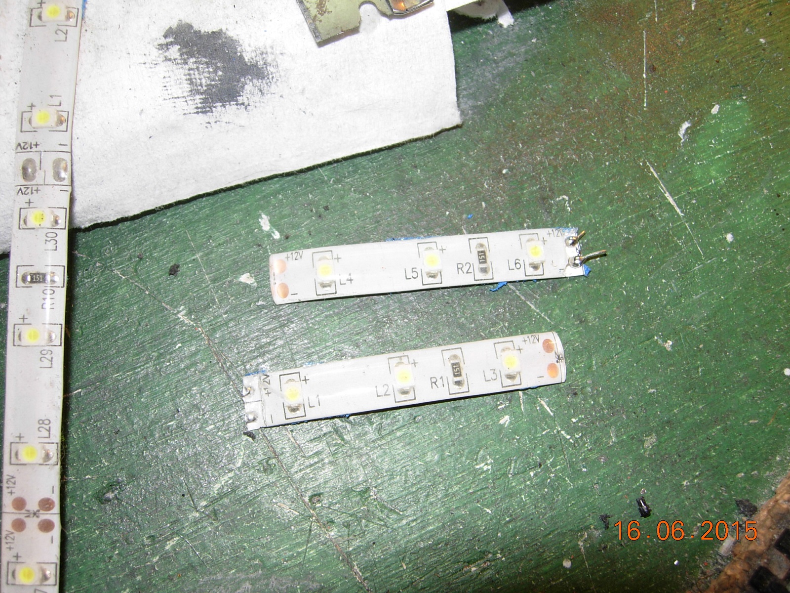

I've found that running cars with incandescent lighting eventually overloads my power supply.
You probably have, too.
I just found this cool thing last week at a thrift store. Half price Sunday, again.
22 sections of 3 elements in this strip.

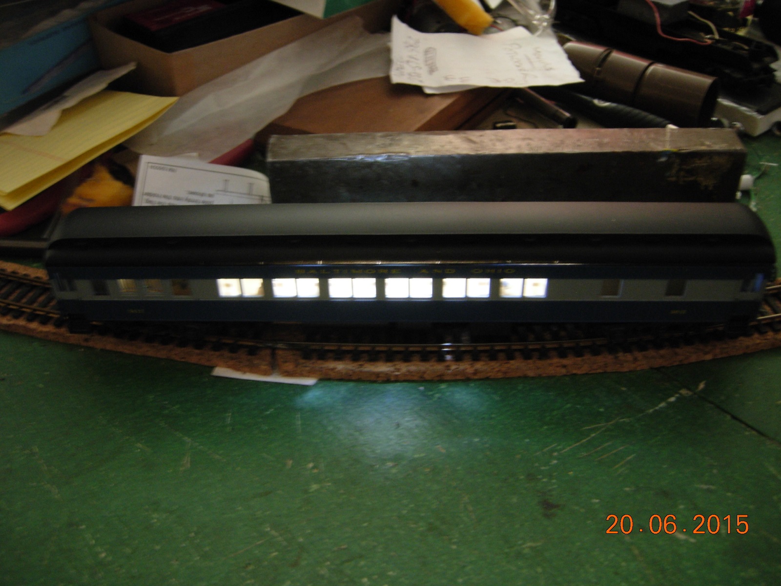

After a ton of work removing and separating them, I put one in my B&O heavyweight coach.
Works great.
My question is, what colour filter would you use to make the lighting correct for this era of car?
As it is, it looks more like a modern subway car.
Opinions, please.

That looks pretty good Evan, other than something that would maybe dim it a bit . . . or maybe the camera just picked up more light. So what do you do? Just cut off a piece and wire it to a battery? I'm ignorant on this.

These new LED strips come in long sections, and they have copper pads spaced every so often along the strip, so you can cut them into lengths of multiples of 3 LEDs usually, then just solder the wiring to those pads. Pretty neat, so you can customize the lengths you need. I've seen a big role of different color LED lights like this at Micro Centre stores, you get like 100 LEDs in a strip for $70. Seems like a lot, but that's less than $1 per LED. Not bad, really.
Far as color? Get some tinted cylophane sheets, put over those strips, and you can tint that bluish white light to whatever color you want.

That's what I'm after.
Would the lighting in these cars be more yellow-ish?
1920's-30's incandescents.
I guess I'll have to buy some bulk candies and experiment with the wrappers.

I've made axle wipers from brass shimstock and mounted them on the trucks.
The lights run off track power.
You have to watch the polarity on the strips. The juice only flows one way.
I have the right front wheels connected to the positive pad on the right end,
and the left rear to the neg. pad on the left end.
So you have to have a front marked on your car bottom, or a backwards car won't light up
(unless you go in reverse).
Maybe I should post a picture when I get home.
Evan

That faint blue tint would look good for fluorescent tubes, but I don't really know when those came out. When the clerestory roofed passenger cars were state of the art, I believe the lighting would have been incandescent and therefore would have a bit of a yellowish tint. Perhaps the bulk candies should be butterscotch with yellow wrappers.

Ok PG, here is an answer. Leds come in a variety of white colors. The colors are:
Bright White, Cool White and Warm White. The warm white leds offer a light that
is closer to the incandescent light for that period. Since you have the bright white
leds, you might try putting a larger value of resistor in the supply line to limit the
amount of voltage going to the led. If you don't know how to do that, then get
some clear orange type of paint (the kind used in sun catcher kits). The kits and
paints can be bought at most craft stores. Put a small dab of paint on the top of
each led and let it dry. You will have to hit and miss as to how many layers you'll
need to get the color you are looking for.

Thanks, Oldtimer.
I know the stuff you're talking about.
I hadn't thought of a clear paint-on coating.
Hopefully it will stick to the silicone covering.
Update to follow.
Evan

You're welcome. If the paint doesn't stick, use a very fine sanding stick to lightly
roughen up the led surface. That should cure that problem.
