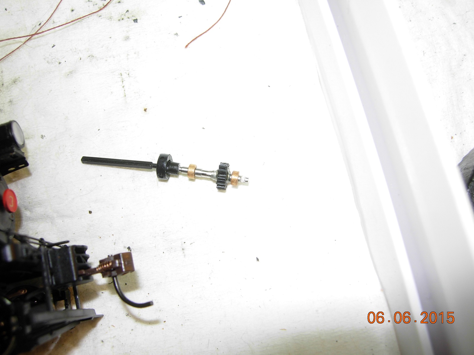

A friend asked me to try to fix this for him a few months ago.
I know, I should have been done with it already.
I suffer from inertia, OK?
Anyway, it's the dreaded split gear syndrome again.
This time, it's a Climax.
So he bought some NWSL replacement gears, hoping these would do.
I never got that far, as the shaft from the gear box was spinning free.
You can see in the first pic, the gear I hopefully fixed with epoxy.

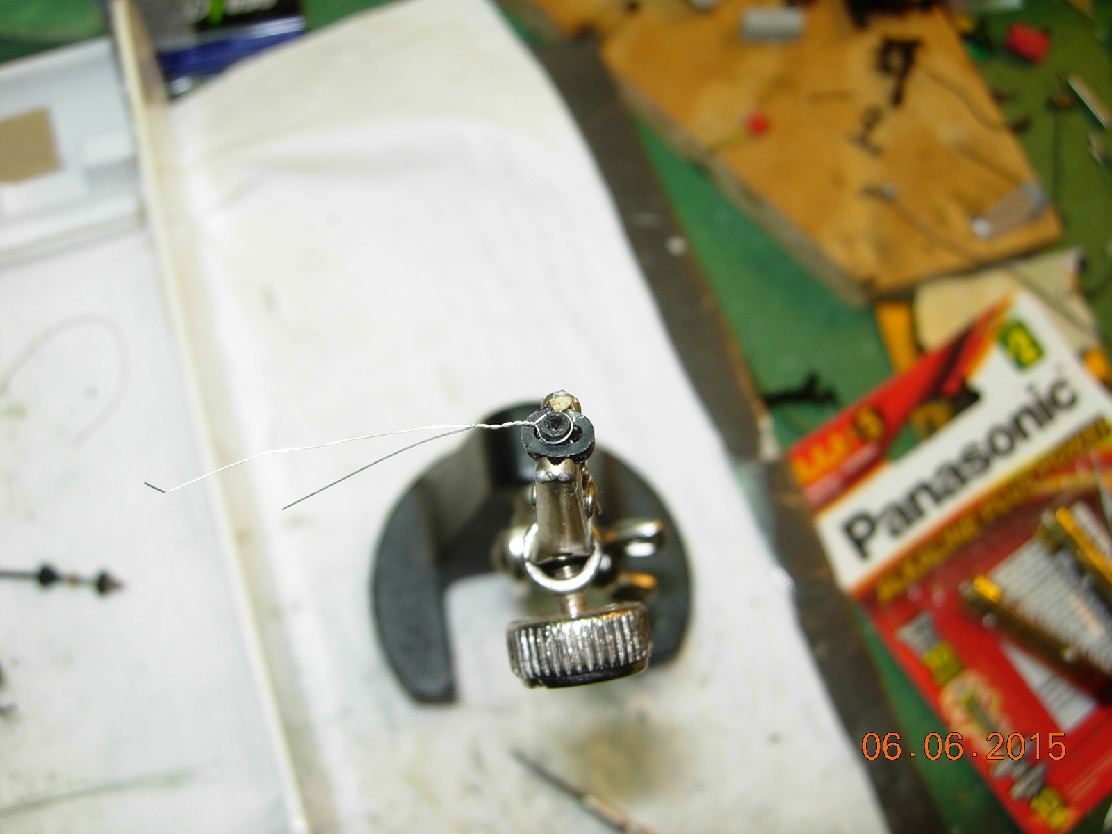

That seemed OK, then I found the gimballed joint was split too! AARGH!
Epoxy won't work on it, as it's Delrin.
So today I tried wrapping a twisted wire around it to squeeze it closed.
No luck, as both electrical wire and brass are too brittle to take much of a twisting.
Any suggestions, or should I throw it in the ocean and tell him somebody stole it?
Evan
 Posted - June 06 2015 :  4:48:10 PM Link directly to this reply  Show Profile  Add shaygetz to Buddylist
Press a brass sleeve over it, made from K&S Shapes brass tubing...

Try squeezing the shaft hard enough to square it off. It might give it more grip within the cracked joint.
If that fails, these couplings are pretty easy to make from scratch. All you need is a brass tube and a piece of wire. Flatten the middle of the wire (and ONLY the middle, maybe 3/16" worth), and bend it into a U shape, then bend the ends of the U shape out to become the pins for the joint. Solder the flattened middle to the end of a piece of brass tube, and paint the whole thing black. You now have a replacement coupling!
My Bachmann Shay had the split gear issue. A few gears from NWSL, and it's one amazing steam engine! Bachmann may not be at the top end with reliability, but there's a reason they're one of my favorite manufacturers. I'll recommend Bachmann's more reliable products any day.

 Posted - June 13 2015 :  11:10:54 PM Link directly to this reply  Show Profile  Add PGE33 to Buddylist
Thanks to both Shaygetz and Darth.
I'll try to make the replacement.
