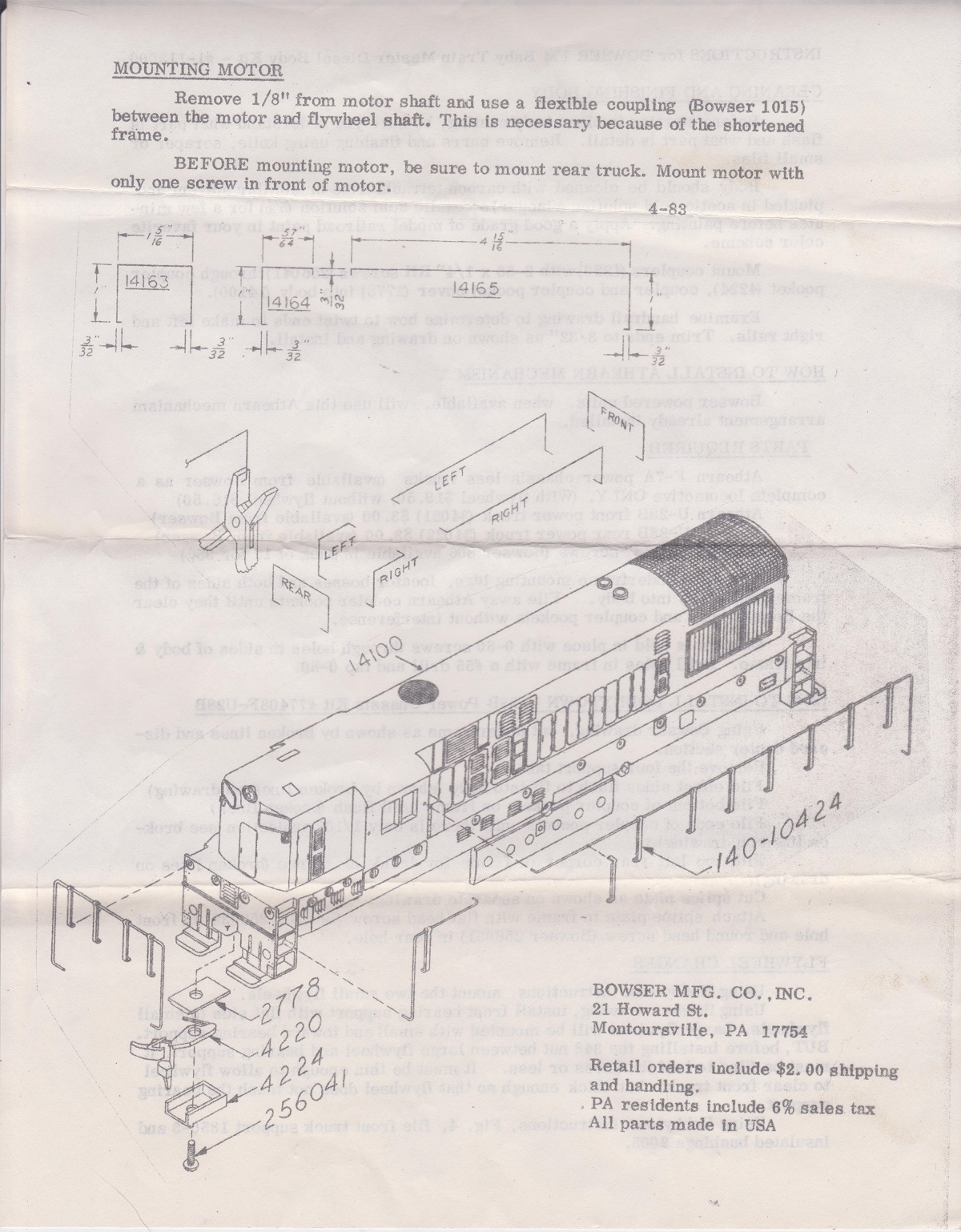

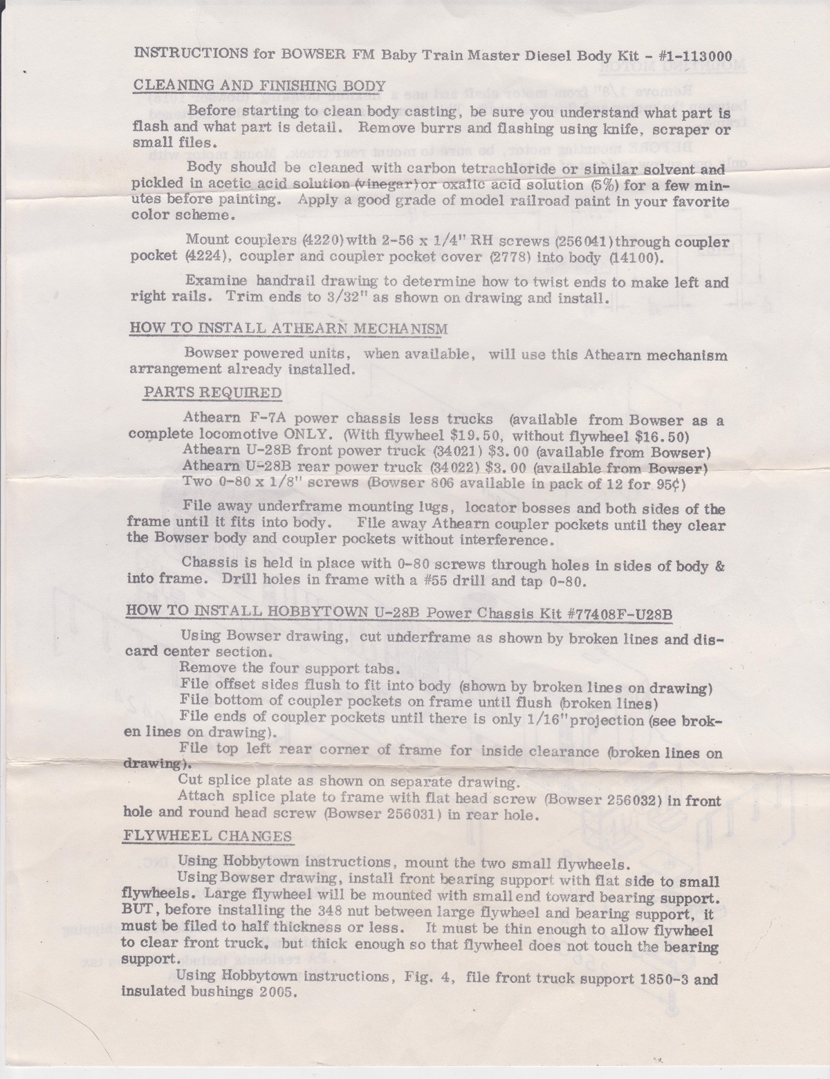

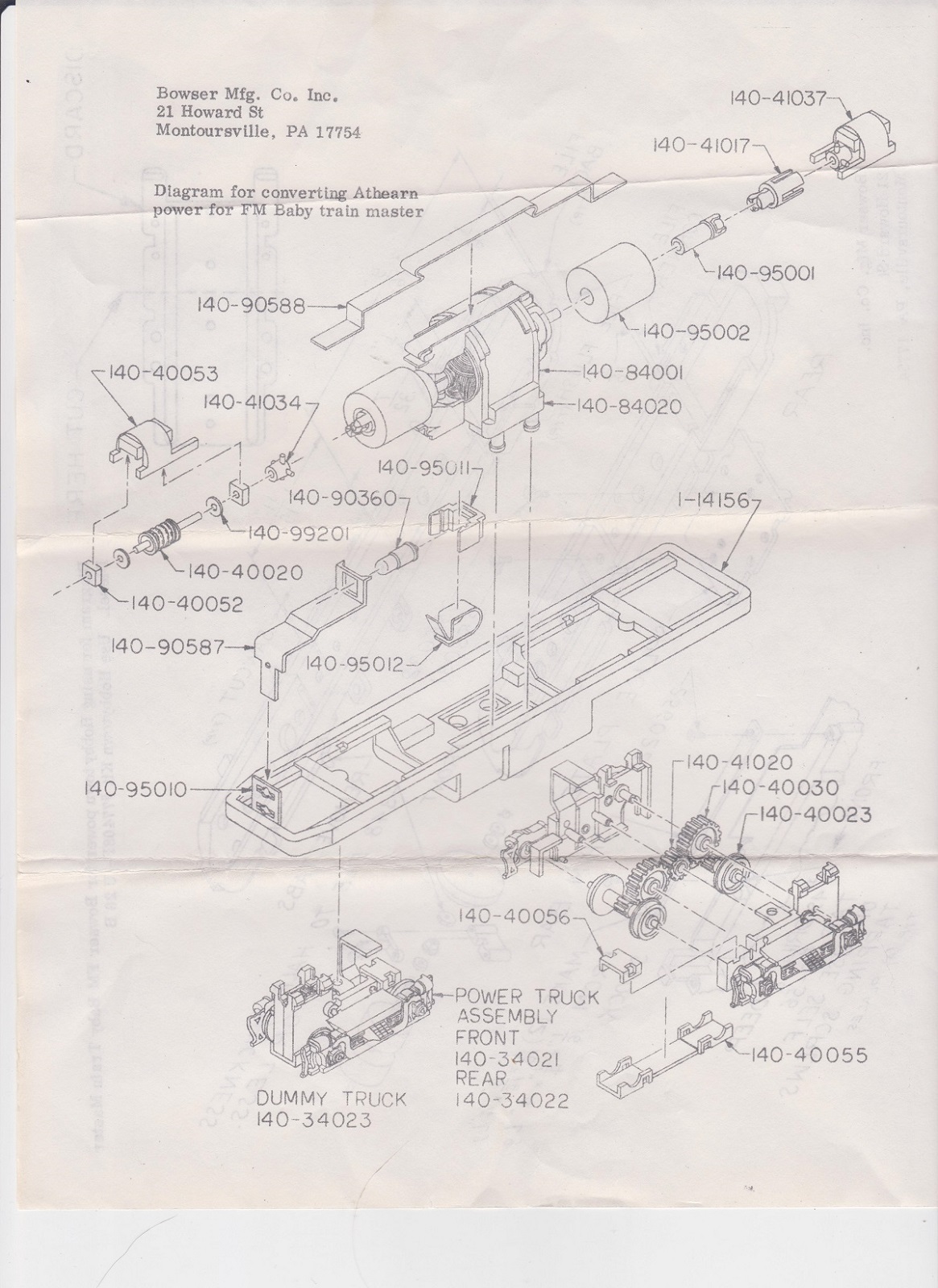

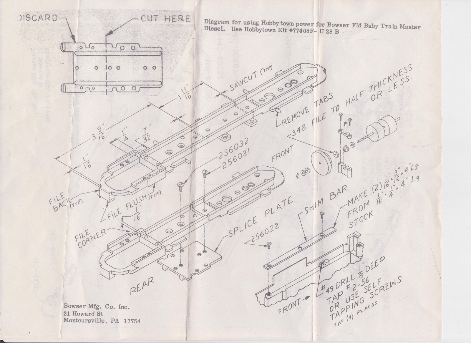

 Posted - May 31 2015 :  1:56:47 PM Link directly to this reply  Show Profile  Add PGE33 to Buddylist
Lots, on both Athearn and Hobbytown.
Here they are.
If you can find one, the MDC chassis is the easiest mod. to do..
Some good measurements and a grinding wheel will do the job.
Evan

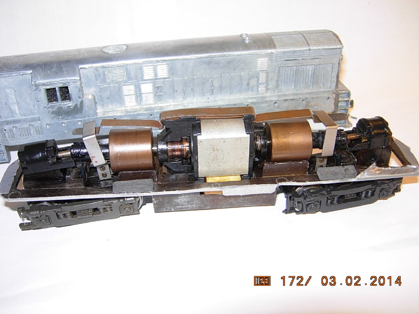

 Posted - May 31 2015 :  2:27:53 PM Link directly to this reply  Show Profile  Add PGE33 to Buddylist
This is the MDC RS-3 chassis.
As you can see, all I had to do was take off some material from the sides, plus the coupler mounts.
Trust me, use a grinding wheel.
