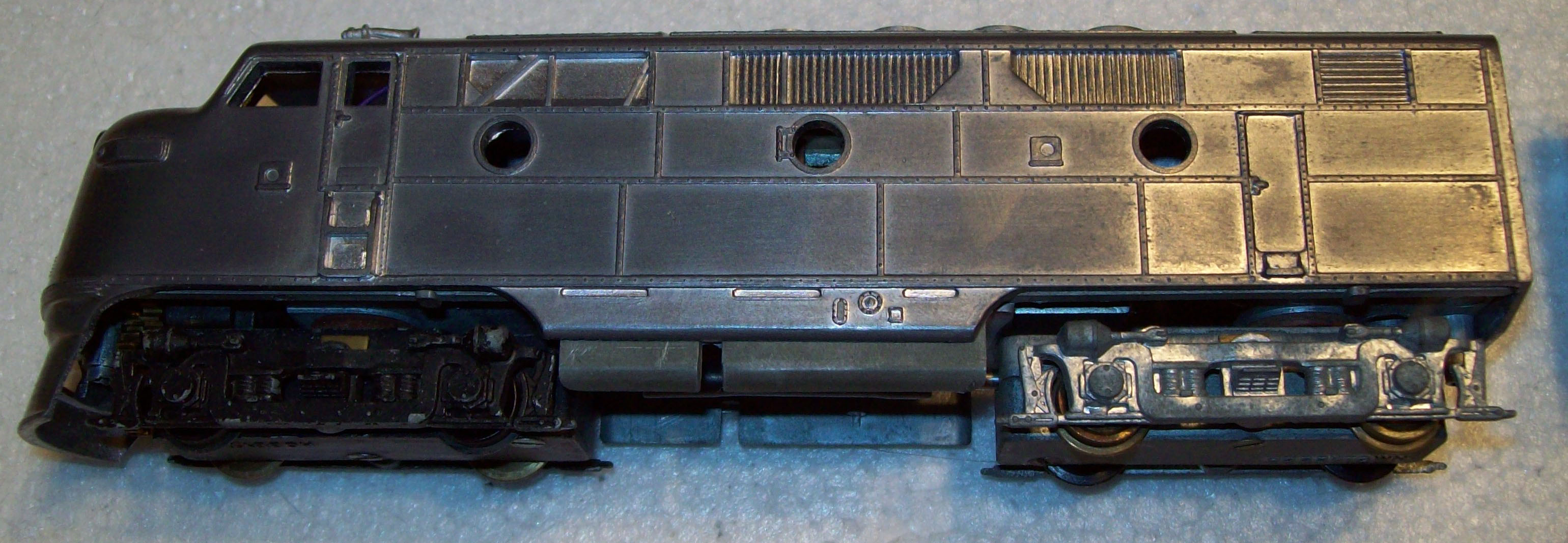

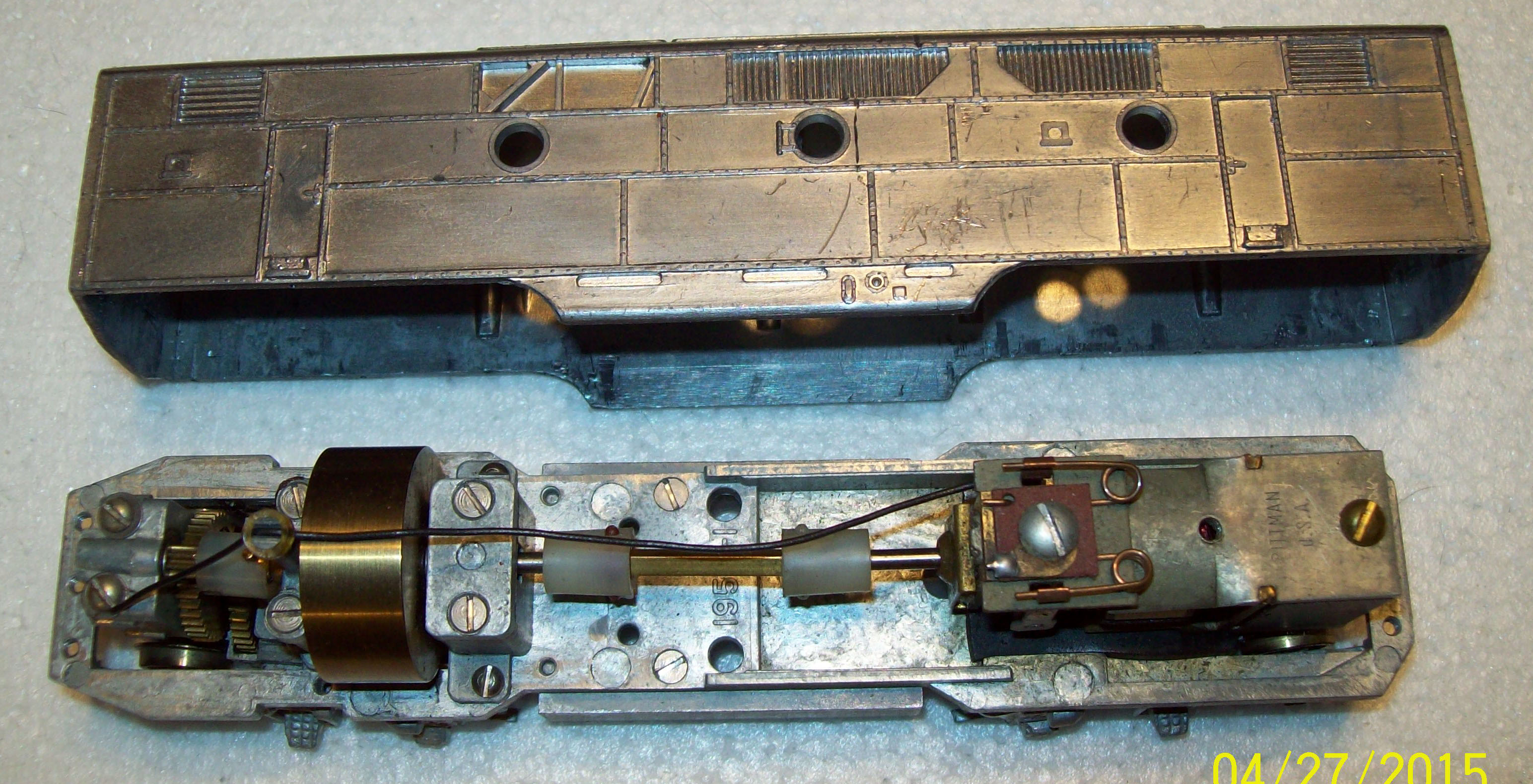

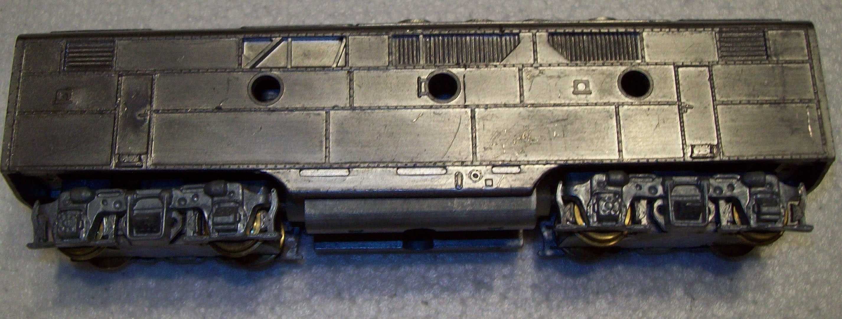

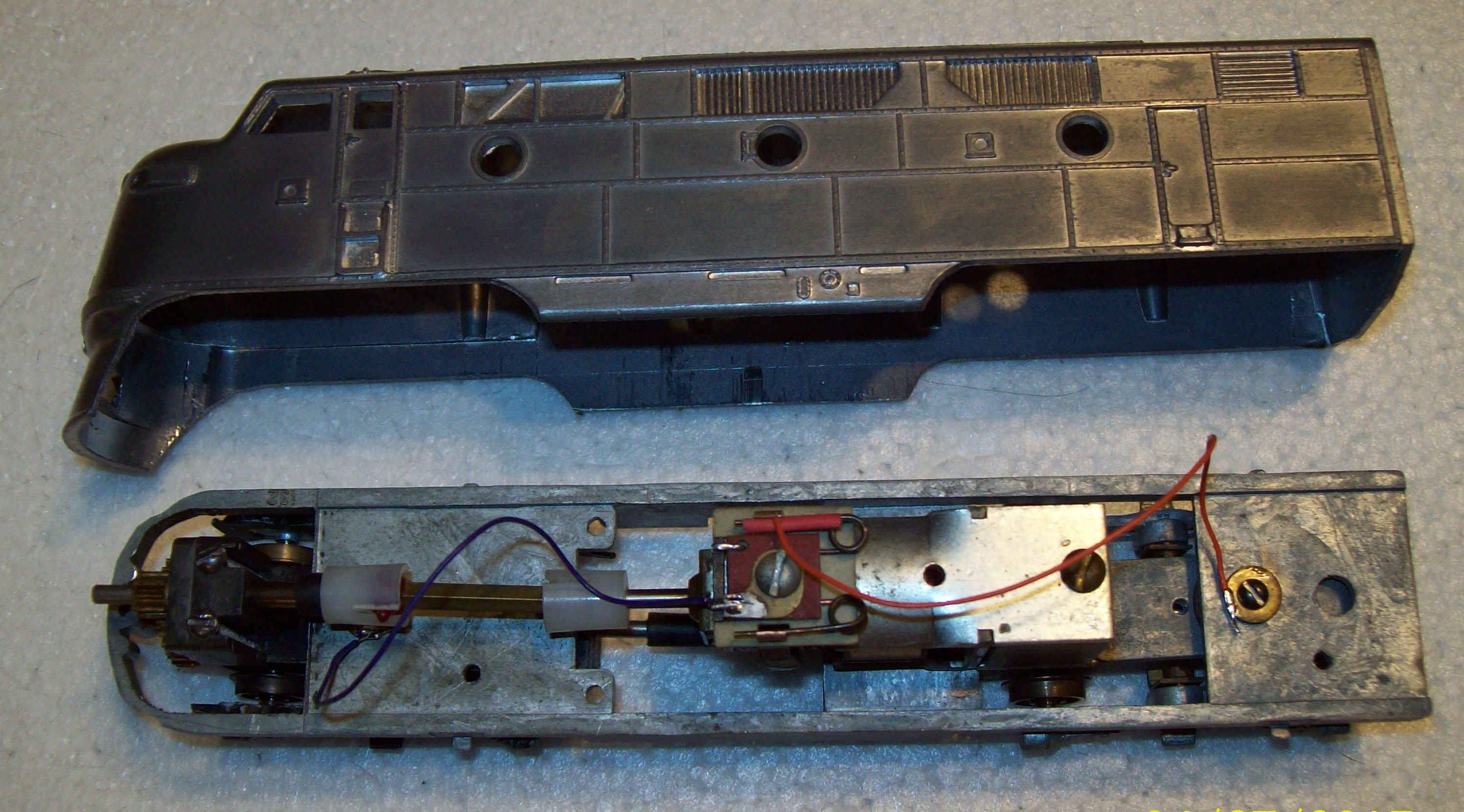

Ok, I got a couple of diesels (paperwork says they are Cary F3 bodies) but I found a LOT of
references, however, there appears to be a number of different phases for these diesels.
Need to know if they are EMD/EMC, which phase are they and are the trucks correct for them.
I know the old time steamers, but, am fairly stupid about the diesels.
A unit
B unit
These came with a set of E7 bodies I got for replacements.
 Posted - April 27 2015 :  6:47:02 PM Link directly to this reply  Show Profile  Add Redneck Justin to Buddylist
Looks to be phase 1 F3's by EMD. The F has the wrong side frames. Nice Hobbytown chassis!
 Posted - April 27 2015 :  7:04:09 PM Link directly to this reply  Show Profile  Add JNXT 7707 to Buddylist
George - the L&N had a F7 that looked like a F3. (A F7 was wrecked - they purchased a F3 from the ACL for body parts to repair it. So while it looked to the world like another F3 it was in fact an F7). This probably happened more times with more railroads than we know.

Thanks. Justin, are any of those side frames correct? If so, which one(s)?
ScaleCraft
 Posted - April 27 2015 :  9:15:56 PM Link directly to this reply  Show Profile  Add ScaleCraft to Buddylist
B unit are Blombergs. Can't see the front sideframes on the A unit (too dark), but they ain't right.
 Posted - April 27 2015 :  10:14:42 PM Link directly to this reply  Show Profile  Add scsshaggy to Buddylist
The trucks on the A unit look like something from an Alco. I have seen an EMD engine sitting on Alco trucks, once. It was on the Illinois Central which used to do that kind of thing when they rebuilt engines in their Paducah shops.
ScaleCraft
 Posted - April 27 2015 :  10:41:07 PM Link directly to this reply  Show Profile  Add ScaleCraft to Buddylist
Originally posted by scsshaggy - April 27 2015 :  10:14:42 PM
And, there were railroads that traded in old units...and the contract for new stipulated the trucks from the trade-ins were to be used...but in all these decade and decades, I do not ever recall seeing an F unit with other than Blombergs. I've seen road switchers...but not F units.
The A units look like AAR Type B trucks, similar if not the same as used on Alcos.
Somebody either got the wrong kit, or swapped parts around before you got them (like the flywheel in the B and not the A....if under an RS unit, no room).
Dave
oldtimer52
0ldtime
 Posted - April 28 2015 :  03:02:17 AM Link directly to this reply  Show Profile  Add oldtimer52 to Buddylist
Then I can take it that the trucks on the B unit should also be on the A unit? If this is
the case, then I will need to find a set for it. These were in a couple of boxes I presumed
were in the larger box to help fill out some empty space. Discovered that the E7 bodies
also included the frames as well. Either I misread the description, or someone screwed
up when they packed the box for shipment. Oh well, only cost me $45 for the entire
lot, so I really can't complain much.
 Posted - April 28 2015 :  08:11:26 AM Link directly to this reply  Show Profile  Add scsshaggy to Buddylist
Originally posted by ScaleCraft - April 27 2015 :  10:41:07 PM
True to what you say, the IC unit that I saw was not an F.
lvrr325
 Posted - April 29 2015 :  11:29:22 AM Link directly to this reply  Show Profile  Add lvrr325 to Buddylist
The only instance of cab units on odd trucks I know of are some Rock Island Alco FAs that were rebuilt and got trucks from EMD FT units being traded in.
