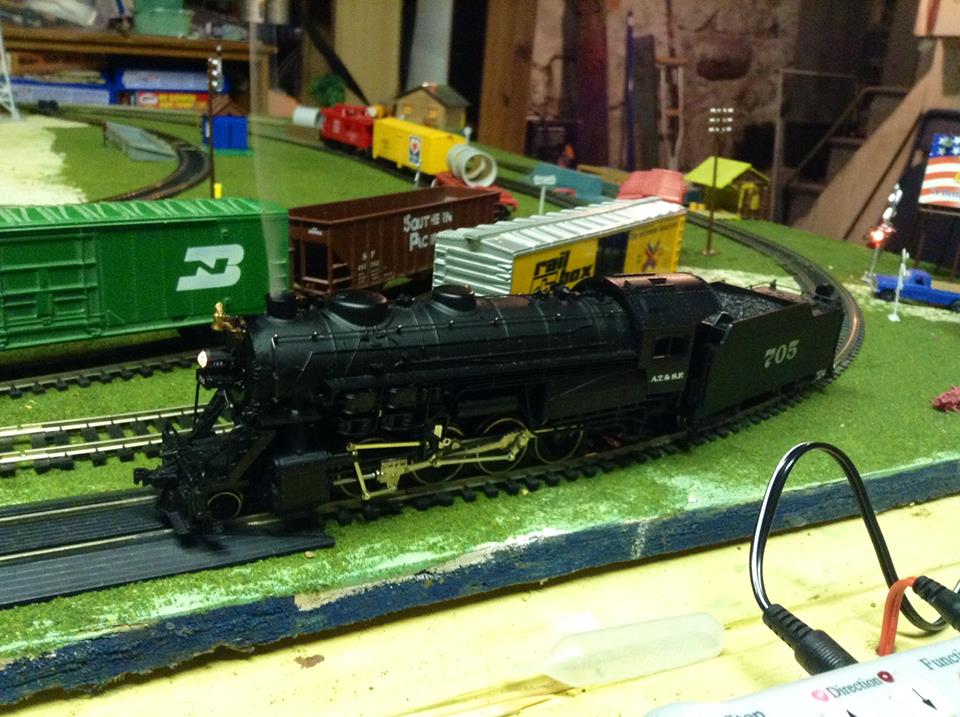

 Posted - April 10 2015 :  10:11:43 AM Link directly to this reply  Show Profile  Add wiley209 to Buddylist
I have the Bachmann Plus 2-8-0; basically their 70s-80s Consolidation but with an improved can motor, worm gear flywheel, and all-wheel drive. The tender even had metal wheels replacing the plastic ones, and a body-mounted coupler (still X2F though...)
Pretty good runner, but I removed the smoke unit among learning that the smoke would've been bad for the tracks...
