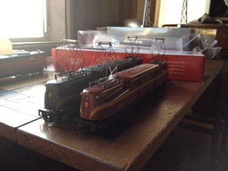

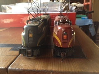

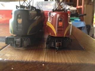

I paid 170 at trainworld for a dcc sound value unit. I've seen dcc ready versions for as low as 100 on line. For 70 bucks more, the sound unit offers a great value. The unit is heavy and sturdy, offers nice detail and looks fantastic. In dcc, it takes off convincingly as soon as you hit notch one. It offers a start up sequence and you can hear a nice woosh sound as it makes it's way around the track. It can pull nice consist with no problems and the horns and bell are adequate. With sound off, it's a nice quiet runner. How foes it compare to the IHC model? Well let's look at some pics. The Bachmann is in Tuscan Red:
They look great together despite the obvious differences. The bachmann detail is on no way better than the IHC. That said its a better smoother runner, heavier and quieter. For the price, it's a great model with sound. I love it and hope to run both together for a long time.

The main difference in terms of looks (right off the bat) is that the IHC is a bit bigger than the Bachmann. Can't really blame IHC too much though, because they took it from Pemco which made it more than 10 years before IHC did, and is kind of a knockoff of the AHM version that was made for quite a few years prior.
