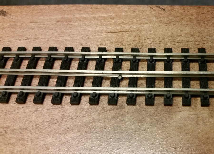

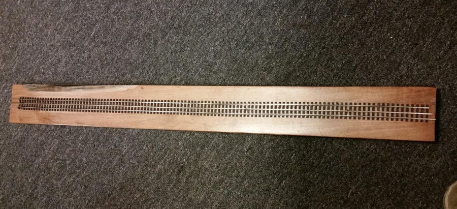

Been getting some Marklin engines it for repair at my train shop job, I had to make a temporary track to test them as the boss didn't have any Marklin HO track. Today, I took some Flex-track, a loose rail, and a piece of wood from a dumpster, and brought them to my "real" job to try spiking and hand-laying some rail.
Turned out OK, it's a bit wavy, but nothing that will cause the center pick-up shoe to derail, I don't think. Overall, I got a nice 30" section of one-piece 3-rail test track to use now. I had the mini spikes bought from an estate at auction, only question was would the wood be too hard to penetrate? Luckily, this 2nd piece of wood I tried was soft enough to accept the spikes, although I ended up bending 30% of them trying to nail them down anyway. Hazard with scale spiking, I guess. :) Somewhere I think I have the correct tool to do it, but it's whereabouts at home are unknown at the moment.
Here's a couple of pictures of my effort.
I just spiked the center-rail down every 5 inches or so, and not through the ties, either. Overall, I think it'll work OK for now. Better than electrical tape holding it at least! I may add more spikes later if necessary.
