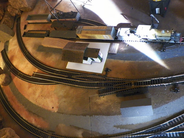

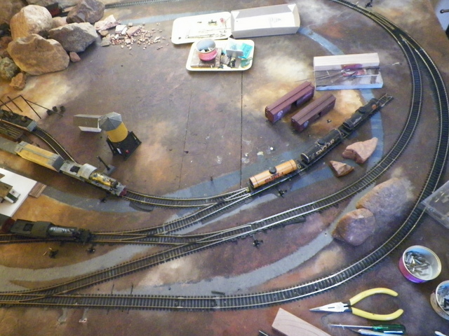

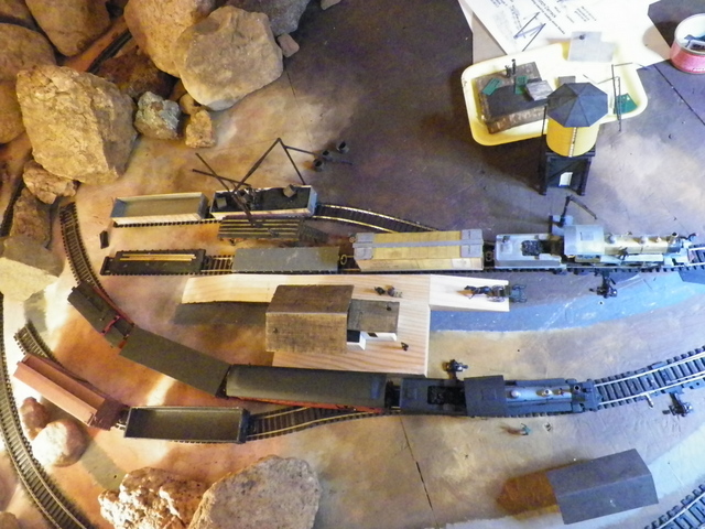

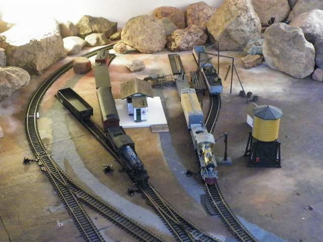

This is what I've been messin' with the past several days. Trying to figure out what might work best in the small and rather congested yards of this railway. I want to keep it sparce, so that's why I'm checkin' this out for a spell before I commit . . . and then, what the heck; it can always be torn up. The deal is that this is pretty much just a locomotive service stop, though there is the occasional passenger service
Right now, I'm pondering how to handle the elevated area and ramps that the station sits upon. I'm thinking of scribing the sides to look like horizontal boards and then gluing on some uprights along the side and then scribing planks in the top. I know that is shaky; takes a pretty steady hand and eye to make that scribing look decent.
The yards probably ultimately hold maybe an excursion car on the short curved one (where a gondola and box car sit now); the excursion car storage area may ultimately have a shed to cover the car [dream on baby!]. The middle, longest yard, is for a passenger consist to back in to, or maybe a short freight consist to be parked a short time. The coal yards should be mostly reserved for a gondola or two of coal and a locomotive being fueled.
Why all the ramps? Well, I'm thinking that there might be some occasional limited locomotive or car repair and that stuff could be heavy. Maybe some local rancher might bring some things to market. Maybe I should downscale and just have the station sit on a typical foundation and then just use 2 x ramps to load up the box cars?
I'm thinkin' now "keep it simple stupid".
Anyway, a couple of photos . . .

** I like the use of all the old 1950 cars and locomotives. The track work I'd change a little.

It just shows what you can do with older stuff like this.And honestly, I think the track is just fine besides needing a bit of dirt on it or something.

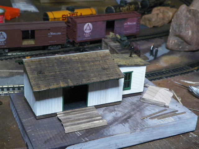

I think once you get some detailing done on the base it will look good. The solid wood block amongst the wooden structures and freight cars is throwing me off, but the concept is solid. Just my two cents. I'm looking forward to seeing where you take this.
 Posted - February 26 2015 :  11:19:11 AM Link directly to this reply  Show Profile  Add Barry to Buddylist
Yeah, Eric, that solid wood block thing may not work out. I scribed boards on it yesterday and the lines came out fine, but the grain of the wood still really showed through even when color applied (soft bands between hard bands, if you know what I mean). So I covered it all in wood filler to sand and try again, but now I'm realizing that it would probably be just as economical to build it out of scale wood, by the time you do all the messing around. I guess it's one big experiment. I'm going to play with that block of wood a little longer, though, just to see what can be done with it (crazy). I would like to know what Frank's thoughts on the yard layout really are. Ah well . . . a work in progress . . . forever.

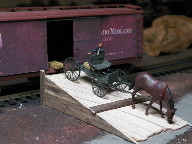

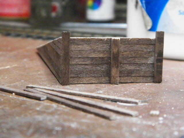

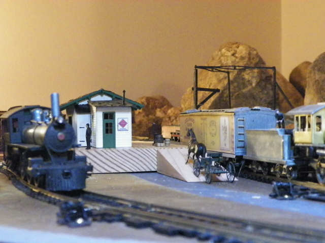

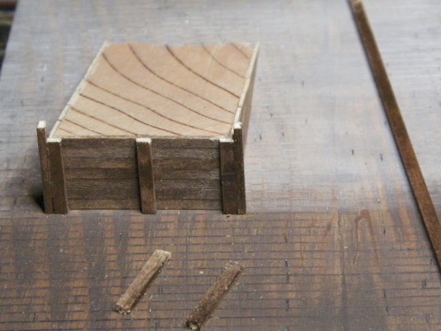

 Posted - February 27 2015 :  8:17:35 PM Link directly to this reply  Show Profile  Add Barry to Buddylist

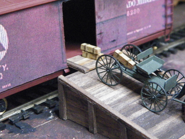

Hey Frank. Thanks for the insight. I do have 54" width and I do have a passing track.
Jerry . . . so true . . . I think I could have played with that block of wood for hours and probably still not achieved an effect as good as styrene; or even drawing on cardboard, for that matter. I decided there was no reason to save the scale lumber I had (just means I need to go buy some more to finish the project) and that I probably had enough to do a stand alone loading ramp.
Here's some photos. If anyone needs to know, you should stain the wood before gluing (glue stains wont except stain very well). The photo of the ramp next to the box car is to check scale and the way the camera shows the detail, looks like there's a bunch of work to make that look believable. I do plan on making dock boards, the "bridge" to go between any ramp and the car being unloaded.
Happy Saturday!
The second photo below shows the under construction ramp on a block that I had tried to scribe (should be embarrassed to even show that).

 Posted - February 27 2015 :  9:06:52 PM Link directly to this reply  Show Profile  Add RDC1 to Buddylist
It's turning out nicely. That is one sweet layout.

 Posted - February 28 2015 :  2:35:43 PM Link directly to this reply  Show Profile  Click to see DaCheez's MSN Messenger address  Add DaCheez to Buddylist
That's looking much more realistic, Barry! I love the wood grain effect you were able to achieve.

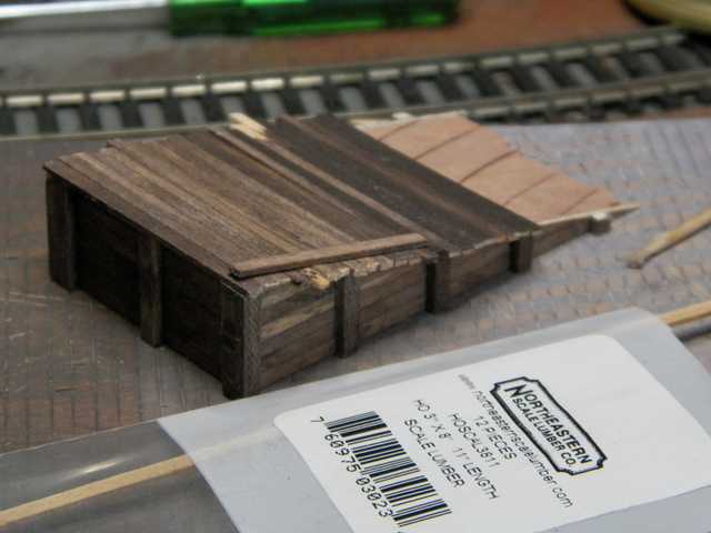

 Posted - February 28 2015 :  4:12:03 PM Link directly to this reply  Show Profile  Add Barry to Buddylist

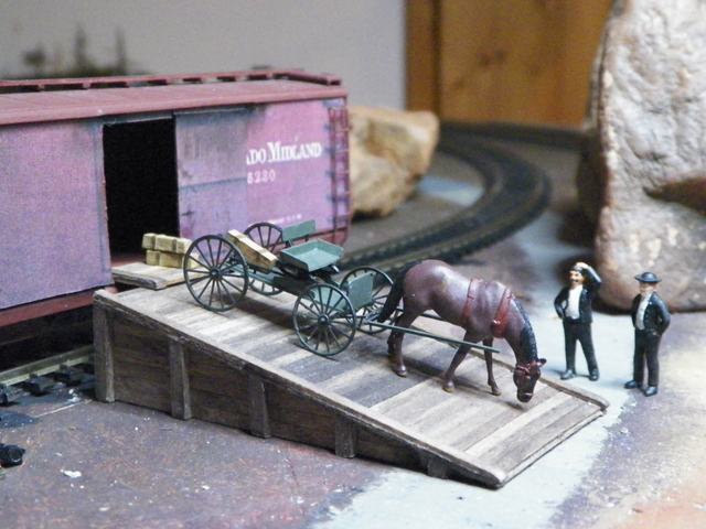

Eric, there wasn't really any work to that "wood grain effect"; I used Northeastern 3 X 8 scale lumber and stained it with thinned Testers Rubber (it's a dark brown) and sort of haphazardly washed it on with a brush. Then cut it and used it after it was dry. Glued with Elmers. So the wood grain effect is just inherent in using the separate pieces that each accept the stain a bit differently. It looks like it's going to take about 1 package (12 pieces 11 inches long) of the 3 X 8 and less than a piece of 6 X 12 for the "supporting" uprights; probably $4 in materials.

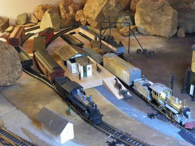

This is where it's at right now . . . have to go the "lumber yard" for more material.
 Posted - March 01 2015 :  12:29:27 AM Link directly to this reply  Show Profile  Click to see DaCheez's MSN Messenger address  Add DaCheez to Buddylist
Originally posted by Barry - February 28 2015 :  4:12:03 PM
Nothing wrong with simplicity. It still looks great! I'm going to have to file this away in my head for future projects.
 Posted - March 01 2015 :  1:39:55 PM Link directly to this reply  Show Profile  Add toptrain to Buddylist

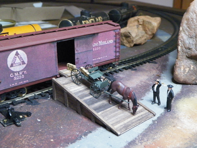

Now that is a nice ramp. Look like it was built by little HO people.
 Posted - March 01 2015 :  5:11:25 PM Link directly to this reply  Show Profile  Add Barry to Buddylist
Well Frank, they got back to work and finished the ramp and a dock board. Now we have to figure out where they're taking a break and get 'em to come back and unload the freight.

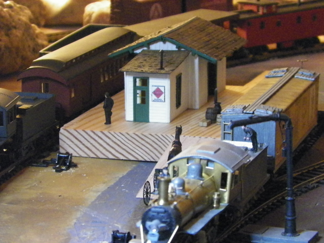

 Posted - March 02 2015 :  6:55:31 PM Link directly to this reply  Show Profile  Add Barry to Buddylist

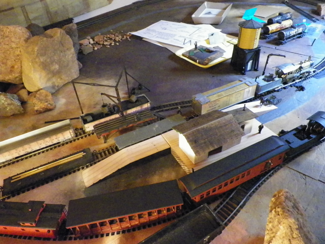

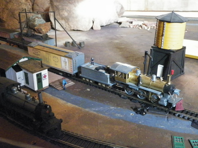

I guess this is all still experimentation. I started on some ramps into the warehouse section of the station and then when I set it up between the yard tracks, it seems to me that the traffic flow is really poor. I'm thinking now of an area of the yard where the station sits that is totally decked between the tracks. My "local hobby shop" guy tells me it is near impossible to get scale lumber as I purchase the last package of 1 X 8 and the last package of 2 X 8 wondering if I'm going to be able to pull off gluing them together to make 3 X 8. Well the gluing together worked OK. Now it will be a search for wood or see how good I am with a razor saw/knife.
It may be that I need to redo the yard layout and I'm giving that some thought for sure. I need to keep in mind that this is also my workbench. What the heck, working on the railroad is fun.
 Posted - March 02 2015 :  8:41:19 PM Link directly to this reply  Show Profile  Add JNXT 7707 to Buddylist
Barry the platform in the top picture that the building is sitting on looks amazing. Looks very realistic.

 Posted - March 02 2015 :  9:58:47 PM Link directly to this reply  Show Profile  Add burlington77 to Buddylist
That is a beautiful layout.
 Posted - March 02 2015 :  10:03:21 PM Link directly to this reply  Show Profile  Add scsshaggy to Buddylist
Barry, I like the looks of your ramps and freight station platform.
If scale lumber gets hard to find, you can probably cut planks out of sheet balsa. I've had pretty decent results with that.
If planks are going to be painted rather than stained, scribing file folder cardboard and gluing it to a wood or heavy cardboard backing works reasonably well.

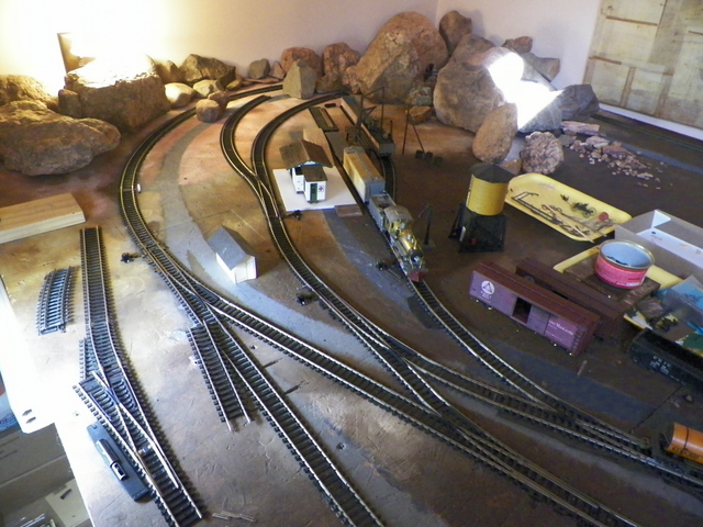

 Posted - March 05 2015 :  7:12:55 PM Link directly to this reply  Show Profile  Add Barry to Buddylist

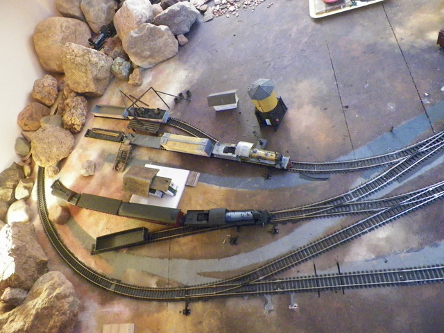

So I'm playin' around with how the station should set between the yard tracks and how the imaginary traffic flow should occur and all that, and the more I look at the yards, the less I'm liking the curve that cuts so close to the other yard track; a great deal because it looks like the track was just laid there so it would fit the small layout (and I imagine that's why prototype yards can be so screwy . . . so they fit?). So I messed around with the track layout some. I'm thinking that short section where the gondola is parked in the "after pictures" could be a spot for a yard engine to park? ? ? Anyway, just for grins, here's a couple photos . . .
Yard before change . . .
Yard after change . . .
. . . and if you can imagine the next 2 photos as being the whole layout, you can see how the "local" line (or passing track), allows the train to back into the yards. An engine with one car at a time, can move a gondola in and out of the coal loading yard, or a freight car into the freight unloading yard. Some freight could also be unloaded on the "passenger" side of the station. If that makes any sense.
I have too many cars on the layout now. Since this is my workbench, it's usually a mess.
 Posted - April 04 2015 :  7:35:32 PM Link directly to this reply  Show Profile  Add Chops124 to Buddylist
I recollect not so long ago this was a simple oval.
"Oh, what tangled webs we weave..." I looked
rather hard, but did not find any 1950's autos,
but the 1890's delivery wagon was astonishing.
A rarely modeled venue. The large rocks
very well replicate granite dells.
