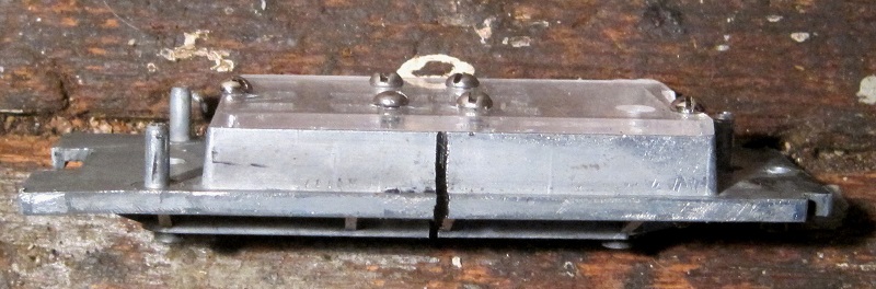

I like to modify my Mantua steam engines to pick up electricity on all the drive wheels. Since the engine is then picking up from both rails, it makes sense to change the tender to do the same.
One way to do this is to cut the frame and electrically isolate the two halves and then turn one truck around to pick up from the opposite rail. Step one, then, is to cut the frame and reassemble it with the two halves insulated from each other:

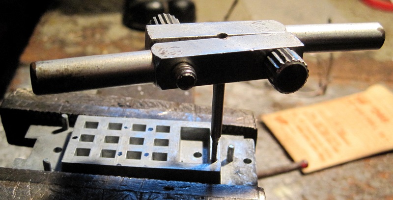

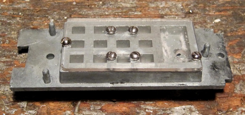

1) The frame is drilled with a #50 bit to put three screw holes in each half. Here's the frame with the holes drilled:
A plastic splint has been drilled with the same pattern of holes.

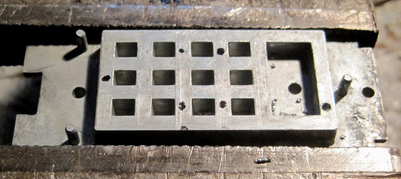

2) Now, the holes are tapped for 2-56 screws:
3) The plastic splint is test fitted:

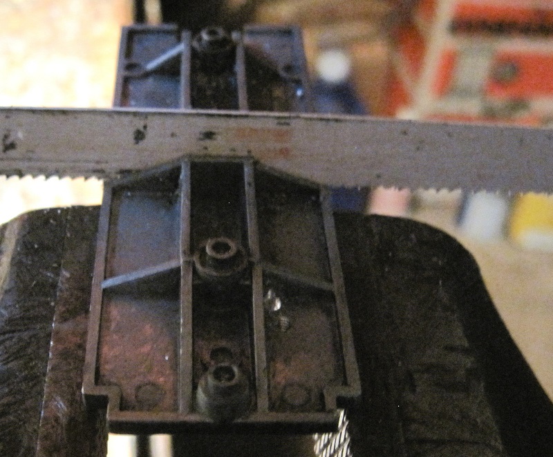

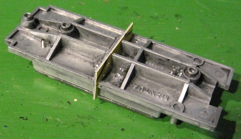

4) With the splint removed, the frame is hacksawed in half, just inboard of one of the center cross braces:
I used to use a razor saw to keep the kerf to a minimum, but that wasn't necessary and would wear out razor saws too quickly.
5) The plastic splint is now put back on to restore the frame to its original alignment:
The splint should be stiff but not terribly brittle. The screws on the ends are 2-56 x 5/8". The four toward the center are 2-56 x 3/8".
6) A piece of plastic about as thick as the saw kerf is epoxied into the gap. This one was from a used-up Subway gift card that I roughed up with sand paper to give the epoxy something to grip besides slippery smooth plastic:
The epoxy is slow setting, so the project is now on hold at least until tomorrow while the glues sets. More to come, in the days to come.

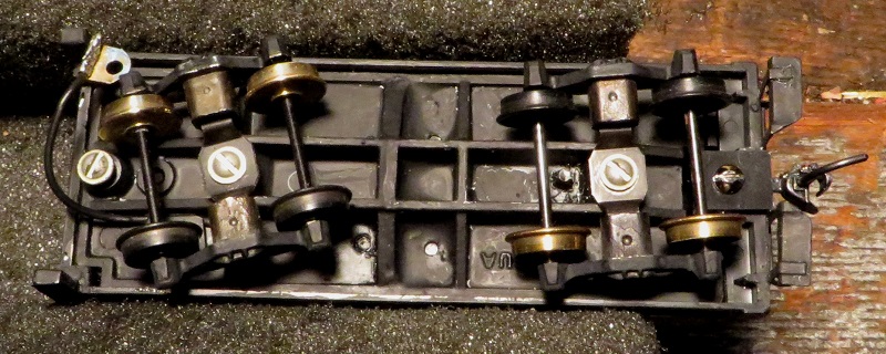

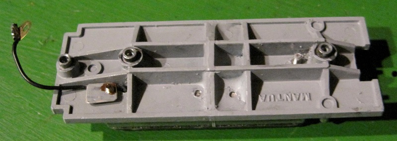

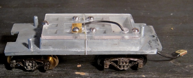

Here's the next installment. The glue has set up and the plastic that fills the saw kerf has been trimmed flush with the frame. A wire has been added that will run from the back half of the tender to the screw that holds the drawbar on the engine. The truck is turned on the back half to contact the rail to which the engine frame is grounded.
Here's the underside.

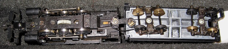

The aforementioned wire is attached to the engine frame. The usual wire back from the engine attaches to the screw that holds the drawbar on the tender. The truck on the front half of the frame contacts the left rail electrically. In the engine's internal wiring, this connects to the left motor brush and to the pickup wipers on the left drivers.

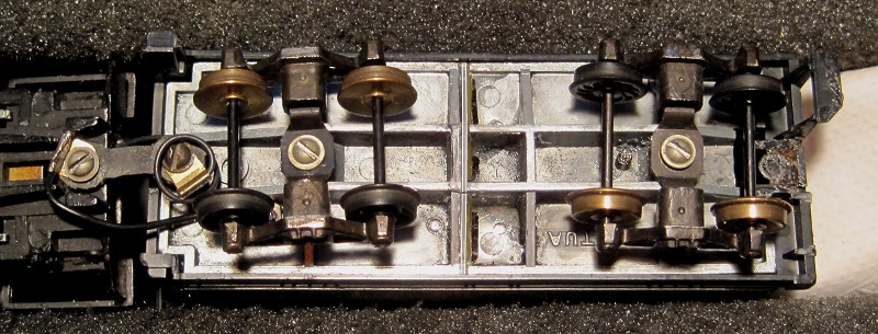

Here's a more general view of the underside of the tender and the engine. The two are connected for testing. In the shot, you can also see that the tender needs some body work. It's missing the engineer's side ladder and a pilot step is broken off of the rear end beam.
Here, the tender frame sports a coat of primer. That'll be a day or two drying thoroughly. Note two of the screws used to hold the plastic splint on the frame were longer than usual. The one on the front half holds a piece of brass in place that keeps the wire to the engine from sagging and fouling the front truck. The one in back sticks down just ahead of the truck mounting bolster. These are good places to attach alligator clips for test running the engine upside down.

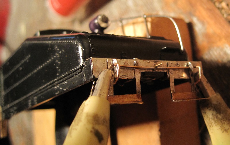

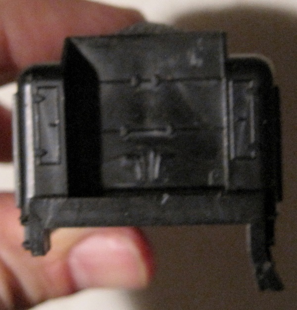

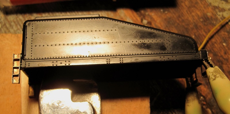

Today was spent making replacement parts for the broken parts on the tender shell.
1) One ladder is broken on the front.
2) One step is broken off of the end beam.

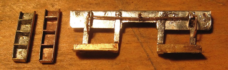

I made two ladders for the front. I didn't think I could replicate the good one very faithfully on the broken side, so I'll just replace both. The new ones are just boxed in ladder rungs. I made them by folding up thin brass into a box shape so the end is the bottom step. Then I added 3 more steps in the middle. The first time, I soldered in separate steps (a painful process). The second time, I cut a strip of thin copper as wide as the ladder steps and folded it so the steps stuck out, then soldered in the three steps as one unit. That's the redder ladder in the photo.
Also in the photo is a new set of end beam steps. These are on a copper cover that'll be glued over the molded on end beam. Also included is an uncoupling lever made of .020" wire. The steps are made of brass.
Neither the ladders nor the end steps are perfectly square and even, but by the time they're painted black, they should look okay by the 3-foot rule. Next comes installing the new parts, adding a coupler and priming the new parts.

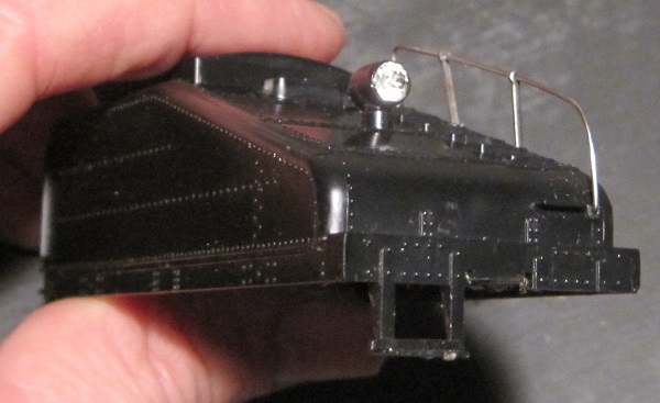

The new parts are now epoxied onto the tender shell:
Those parts that need to be are clamped or braced in place while the epoxy sets up.

The coupler pocket was missing and the hole for the small screw that holds it was stripped, so I drilled the hole and tapped it for a 2-56 screw and screwed on a Kadee coupler. The coupler and drawbar work best with the frame sitting just a little higher, so I added thin washers (home made from brass) between the frame and the trucks.
Here's the same view with both trucks mounted. Note that they pick up from opposite rails:

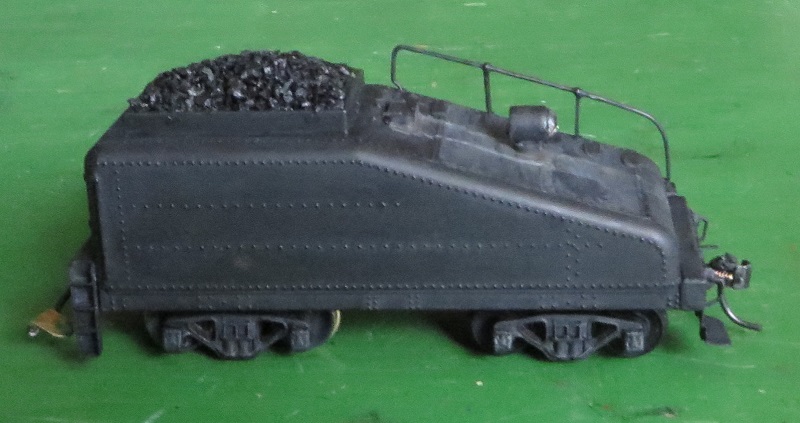

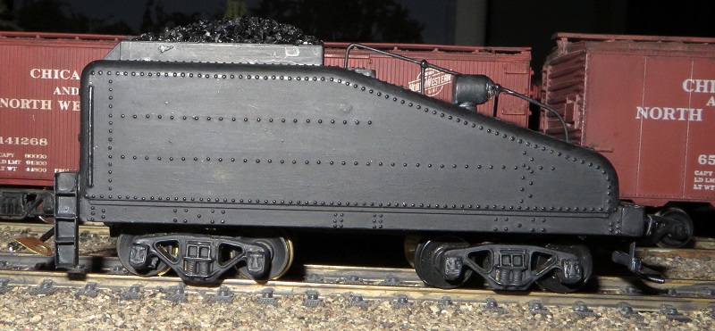

The trucks, wheels, body and frame are all painted black:
The coal pile has real coal. First I glued a layer to the plastic coal with Duco cement. When that was dry, I spread on some coal dust and some lumps and glued them down with diluted carpenter's glue. Also, the rear slope has been weathered some and water streaked below the manhole cover:
That about completes the project. The tender will be numbered when it is mated to an engine, which won't be right away. Meanwhile it'll be easier to store than a bunch of parts.
