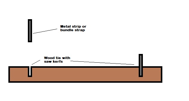

A thing people used to do, 80 years ago, to get low-cost track, was to make the rails from metal strips, set on edge in saw-kerfs cut partway through the wooden ties. This was also the type of track sold in early commercial sets by Carlisle & Finch and others.
What worked in the 1930s Depression era could work just as well in the 2010s Depression era, why not? If you know of a place that ships or receives items on pallets, you can use steel bundle strap for the rail. Switches will need a little ingenuity, but I think I would try to make the Tru-Scale closing frog style.

How would the expansion and contraction of wood affect the gauge of the track?
Autobus Prime
 Posted - January 26 2015 :  10:51:07 AM Link directly to this reply  Show Profile  Add Autobus Prime to Buddylist
Originally posted by tkruger - January 26 2015 :  08:50:09 AM
No worse than any track laid on wood ties.
