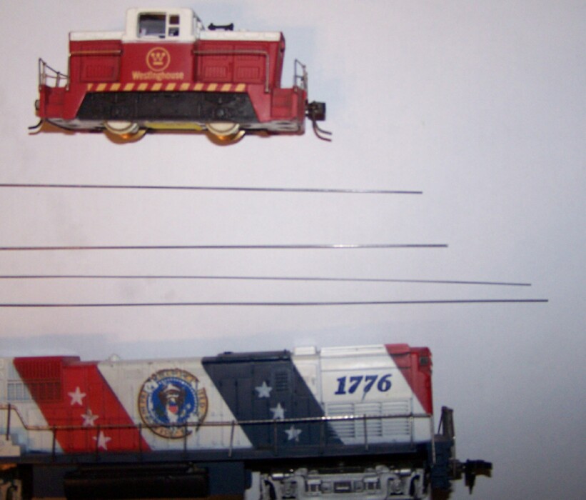

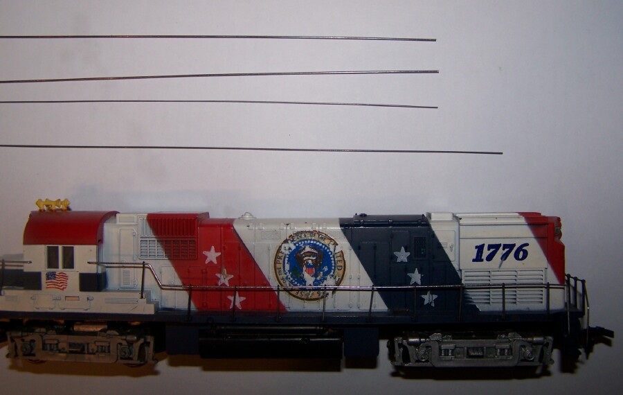

I was at a local hobby shop today, picking up a Pro-Line AMC Javelin vac-formed R/C body I'd ordered, and thought about looking at some piano wire to make Tyco handrails. That store didn't have much small size in stock, but I got 0.032 " there. I hit an R/C car/airplane store later after work, they had 0.015, 0.020, and 0.025, which seemed in the right range.
After I got home, I pulled out some Tyco engines , a 630 Bicentennial, and a 2-axle switcher. Both have the same handrail wire size. Unfortunately it is an in-between size, which I think is 0.018 inch. The 0.015 is a bit small, and the 0.020 won't go in the hole.
On the up side, I searched on Piano wire on Google, and it pulled up Grainger as carrying even these small sizes, including the 0.018. There is one about 10 miles from me. I may call tomorrow to see if they have it in stock. about 1,000 feet for $18. I paid 49 cents for about 3 feet. The Tyco stuff looks like it's chrome plated, or maybe stainless? I can't say I've seen it rust, so not sure regular piano wire , which is carbon steel, is the best choice. Anyone have any idea what Tyco actually used for the wire?
Here's a couple pics of my wire selection and locos.

My guess is the wire is nickel steel, same as some HO track. Doesn't look like stainless to me.
For handrails, I buy whatever type of metal K&S has at the hobby shop. I think it's carbon steel, spring steel, don't really know.
I have used plastic styrene rod. But, for that authentic tyco look, you need some shiny wire.
 Posted - January 19 2015 :  8:34:00 PM Link directly to this reply  Show Profile  Send AMC_Gremlin_GT an AOL message  Send AMC_Gremlin_GT a Yahoo! Message  Add AMC_Gremlin_GT to Buddylist
No, guitar strings are usually wound (the larger sizes, which I'd need, not the tiny size), for flexing, the piano wire is a single extruded piece, and it is stiff.
So far, I've found carbon steel and stainless steel piano wire listed, but no nickel at the vendors I've checked so far, although a Google search does say there are nickel and nickel plated versions of piano wire available. Stainless is a bit expensive, so if I can get a nickel or plated version, I may go with that.
