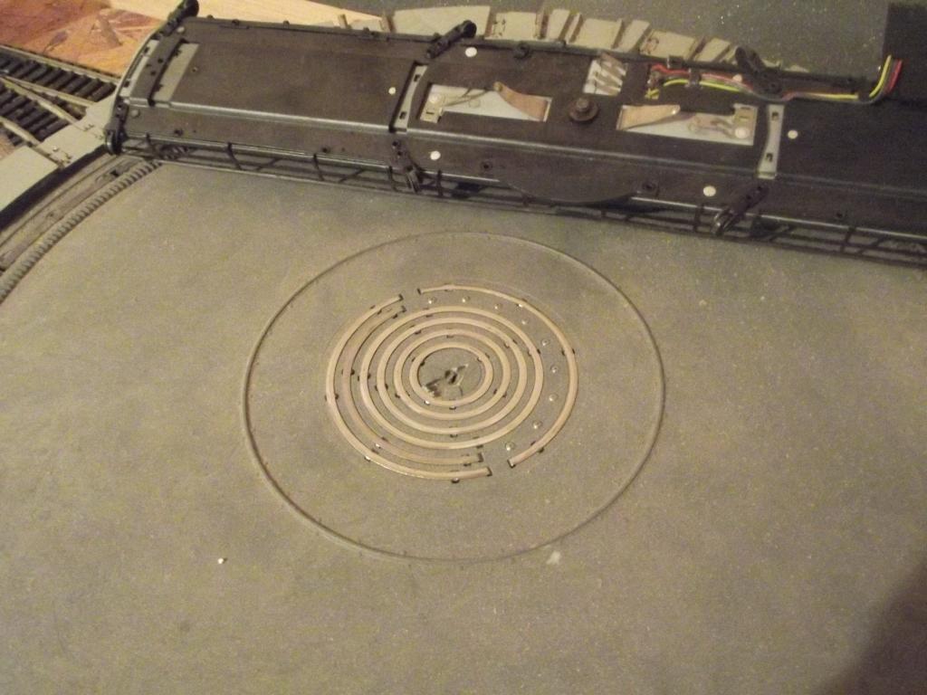

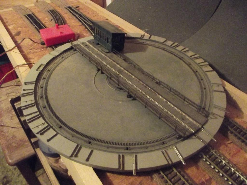

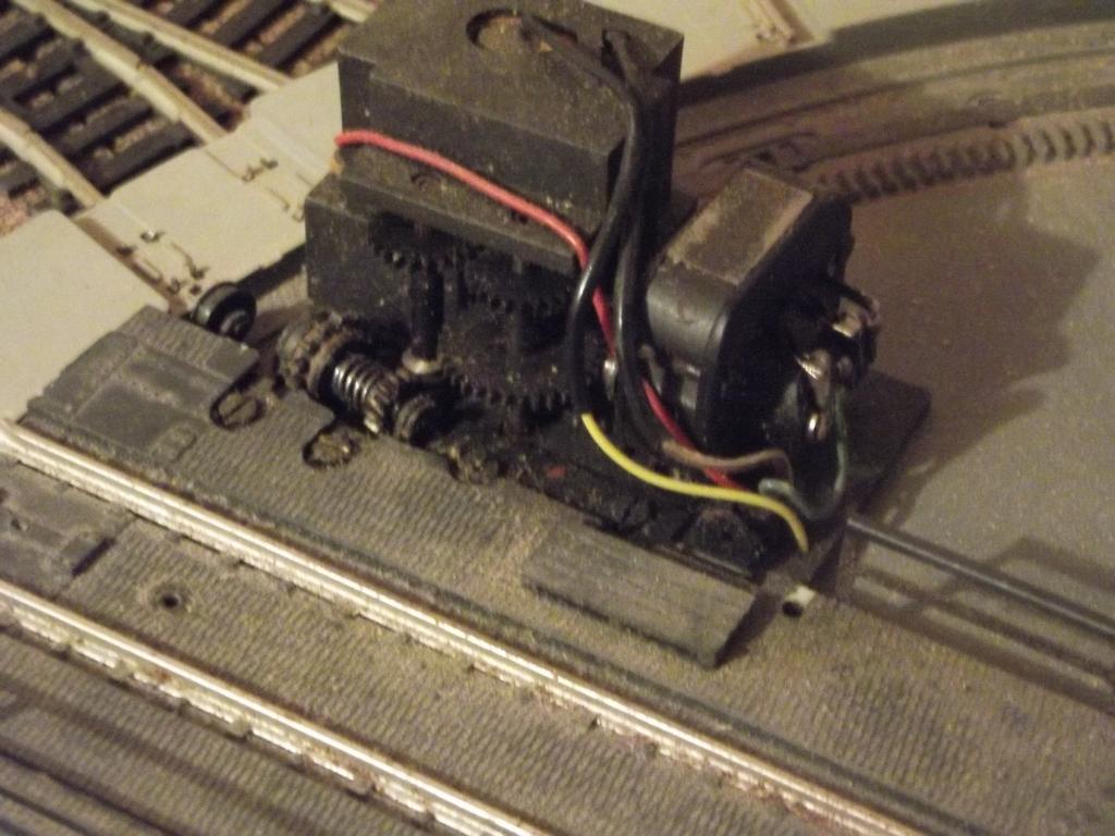

Anyway here are pictures of the complete table
The motor
The bridge and connector fingers

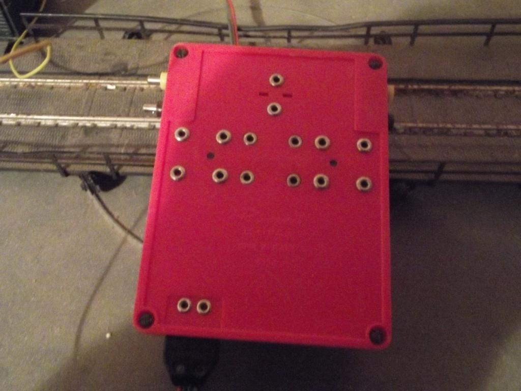

The control box
The box has 2 connectors at each side on the top and a 4 wire plug on the bottom.

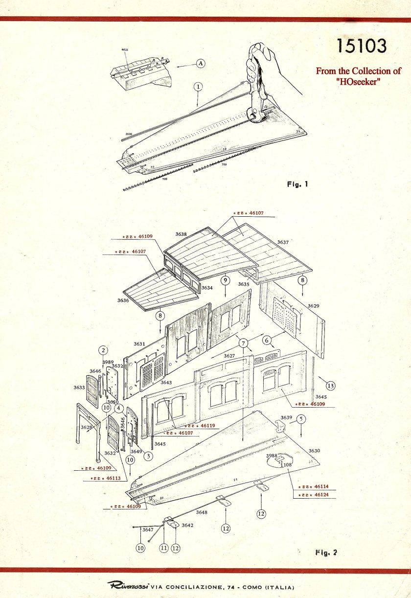

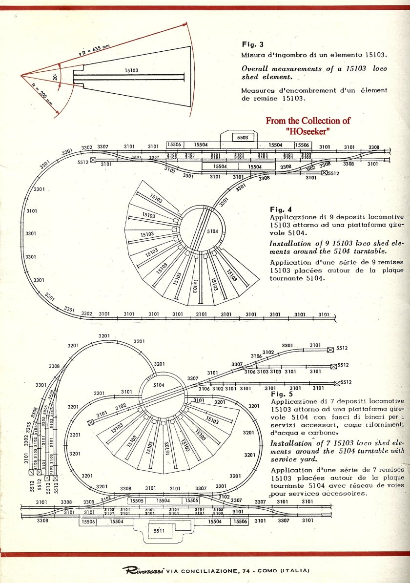

I was prowling around and found that there are 9 pages:
http://www.hoseeker.net/AHMRivarossiassembly/rivarossi15103roadhousepg1.jpg
http://www.hoseeker.net/AHMRivarossiassembly/rivarossi15103roadhousepg2.jpg
http://www.hoseeker.net/AHMRivarossiassembly/rivarossi15103roadhousepg3.jpg
http://www.hoseeker.net/AHMRivarossiassembly/rivarossi15103roadhousepg4.jpg
http://www.hoseeker.net/AHMRivarossiassembly/rivarossi15103roadhousepg5.jpg
http://www.hoseeker.net/AHMRivarossiassembly/rivarossi15103roadhousepg6.jpg
http://www.hoseeker.net/AHMRivarossiassembly/rivarossi15103roadhousepg7.jpg
http://www.hoseeker.net/AHMRivarossiassembly/rivarossi15103roadhousepg8.jpg
http://www.hoseeker.net/AHMRivarossiassembly/rivarossi15103roadhousepg9.jpg
Some of the illustrations have English captions (among other languages) and you may be able to fight your way through the text based on similarities between the Italian words and familiar English words. I didn't see anything that seemed really explicit about the wiring, though.

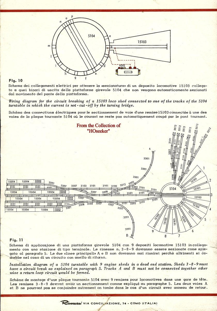

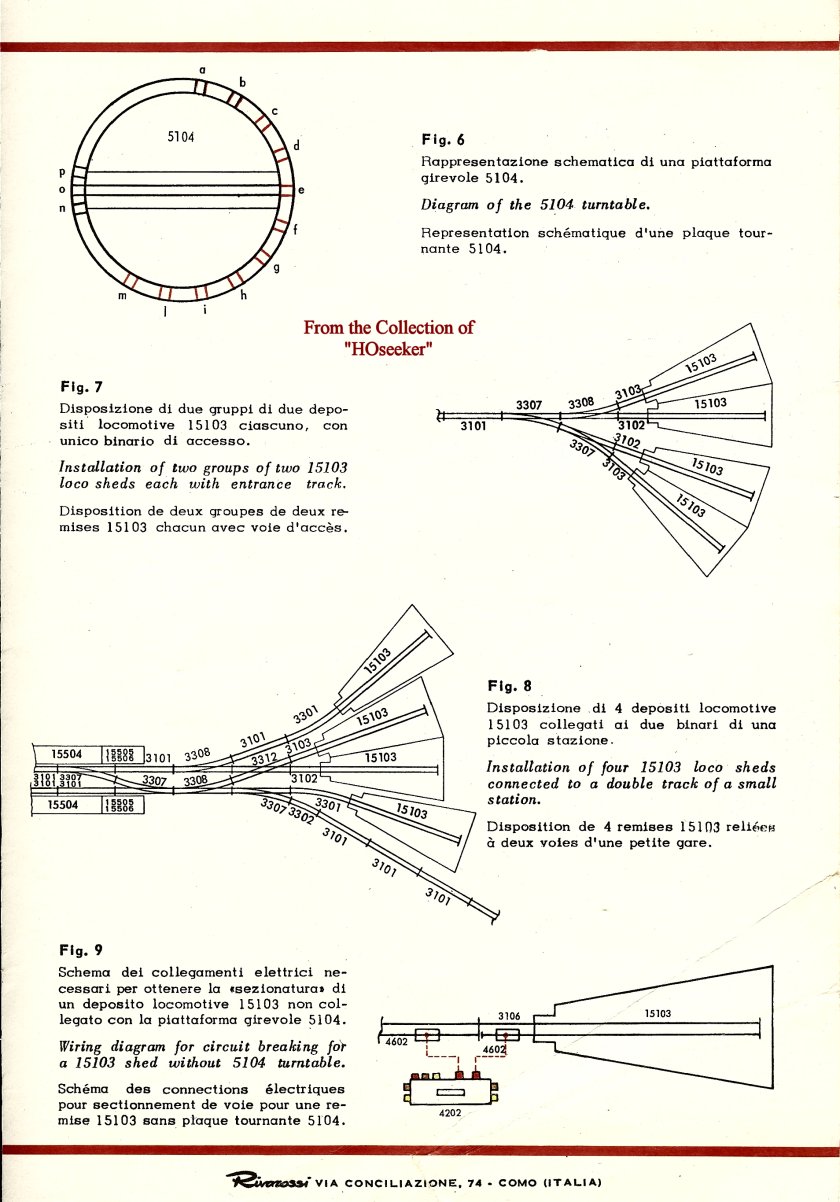

Originally posted by scsshaggy - January 08 2015 :  9:39:19 PM
I have waded through all of that, the reference to the 5104 is just to give the setback distances from the table to the engine house(s).
Thanks anyway.

PGE33 thanks for the article. Not exactly what I was hoping for. Oh well, back to the drawing board, multi-meter and test leads and see what I can blow up.

I have 2. I operate mine with a center off double pole , double throw togel switch and a N.O. ( nominally open) push button switch.
Retired Alex
CanadianPacificBeaverAvatar
 Posted - January 09 2015 :  1:11:37 PM Link directly to this reply  Show Profile  Add Retired Alex to Buddylist
Great, then let me ask, does this operate off fixed AC or fixed DC from the power pack? I would assume DC but want to make sure.
 Posted - January 09 2015 :  4:45:39 PM Link directly to this reply  Show Profile  Add toptrain to Buddylist
Originally posted by Retired Alex - January 09 2015 :  1:11:37 PM
You assume correctly.
