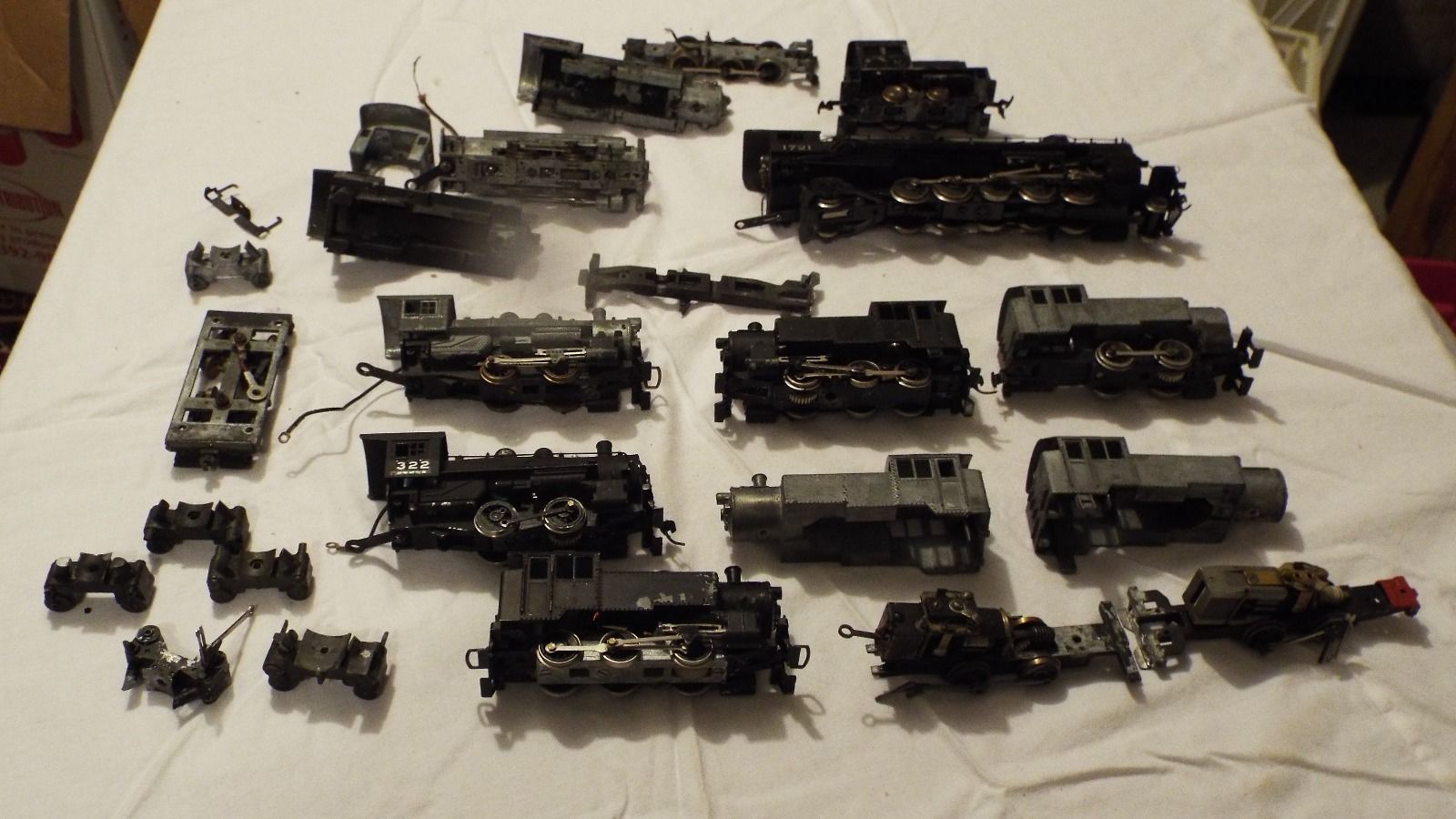

My JOTW offering:
tkruger
 Posted - January 05 2015 :  09:54:51 AM Link directly to this reply  Show Profile  Add tkruger to Buddylist
My JOTW offering:
Originally posted by Mustangs_n_Trains - January 05 2015 :  07:05:59 AM
That's not junk, it potential. I see several projects in there.
 Posted - January 05 2015 :  7:01:42 PM Link directly to this reply  Show Profile  Add kovacste000 to Buddylist
My JOTW offering:
Originally posted by tkruger - January 05 2015 :  09:54:51 AM
Me too.

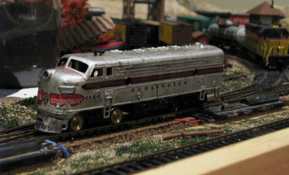

Found this in my junk box this week. I got it running fairly well but it gets hot and stops. I let it cool off for a couple of minutes and it runs great again. How can I fix that?
 Posted - January 05 2015 :  9:30:18 PM Link directly to this reply  Show Profile  Add Mustangs_n_Trains to Buddylist
Originally posted by thetramp - January 05 2015 :  7:32:58 PM
That's a sign of a weak magnet. Those magnets are fairly easy to replace in this locomotive. Use the "rare earth" neoprene magnets and you will below than pleased with their performance at all speeds, especially slow speeds.

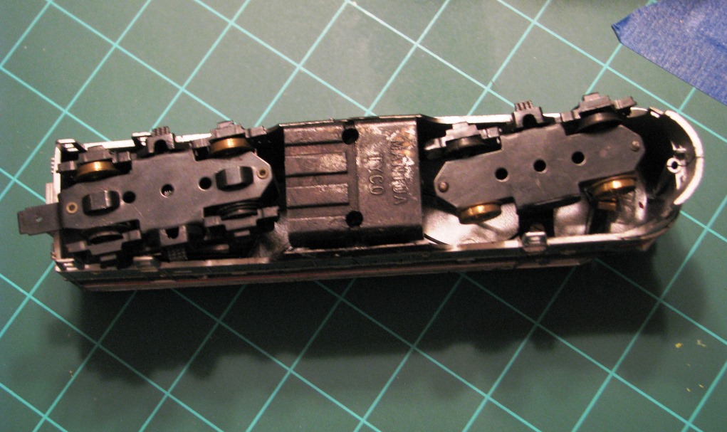

Looking at the underside of this engine, the bottom plate is riveted on. How would I grease the gears?
 Posted - January 05 2015 :  11:50:36 PM Link directly to this reply  Show Profile  Add scsshaggy to Buddylist
Originally posted by thetramp - January 05 2015 :  10:31:47 PM
Can you get at the gears from the top of the truck? I don't recognize the make of this particular engine to know how it's assembled. The thing is, I have looked at old engines, before, in which the grease had gotten old and hard like wax.
 Posted - January 06 2015 :  02:42:15 AM Link directly to this reply  Show Profile  Add NickelPlate759 to Buddylist
It's in pretty rough shape, so you should also check the magnet for any steel screws, spikes , etc. that might be stuck across the magnet poles. You can blast it out with contact cleaner, which is pretty good at removing even hardened grease without drilling it out. Check the slots in the commutator for any packed in dirt, which can cause shorts and overheating. Remove the brushes and clean them, and clean the slots with the tip of an X-Acto blade if necessary.
Wait for it to dry out, then oil the bearings lightly through the holes in the underside and press a little light grease onto the axle gears from the side of those punched out gear covers, clean off any excess and let it run in.

The engine is a mantua/tyco. See the picture below.When I get back from work, I will try and pull the motor out of the shell. I greased it from the underside last night so today I will put it on the track and see if that helped. Thanks
thetramp
tramp
 Posted - January 06 2015 :  6:55:41 PM Link directly to this reply  Show Profile  Add thetramp to Buddylist
Ok, I pulled the motor out and the magnet seems strong. Then I greased it and it is running pretty good. I ran it for about 20 minutes and the motor still gets warm but does not stop running. If you look at the rear of the engine, it is missing the coupler clip. Can someone tell me what kind of a clip holds the coupler on? Where can I find one?
