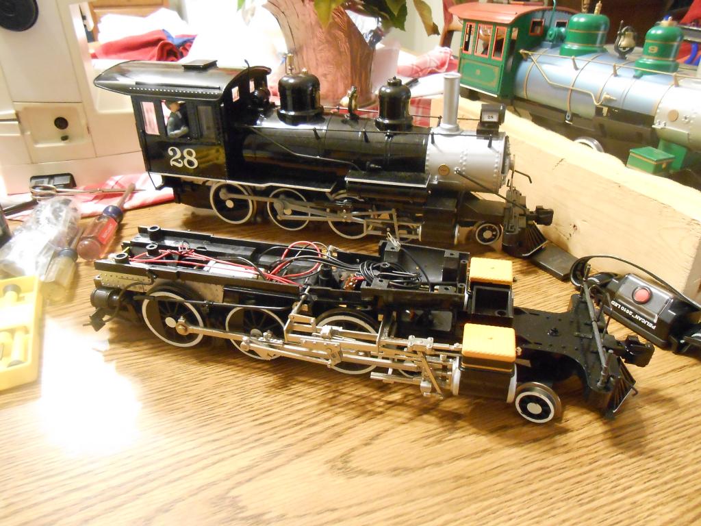

My new year project ... this week, the hot glue and weak factory motor mounts on my Colorado & Southern gave out causing a stripped drive gear. Since Bachmann's warranty charge of $55 is the same as purchasing an annie chassis plus a smoke unit, I've decided to do the swap myself and end up with some spare parts. Should be a fun swap!

The Colorado & Southern is back on the rails. Wasn't so hard to swap out and it's running nice & quiet again. In the spring during painting weather, the yellow steam chests have to go. I'll spray them gloss black like the originals.

It had a plastic cradle mount, but the screws were too far apart in the plastic frame to keep the worm gear in place. I have a feeling that Bachmann took a soaking on these engines with their warranty. Now the motors are in a steel frame, the way they should have been.
I'm going to attempt a repair on the old running gear if I can get a replacement drive gear from Bachmann. I'll post photos on what I come up with.
Those first gen engines were much more reliable that this design. I have two that have seen some rough duty. They hold up well as long as they're fed lube properly.
I also have an ex radio controlled engine. It's in the repair cradle in the photo above. That one is in the process of a re-chassis using a Barry's Big Trains setup. It's a long overdue project (I have too many long overdue projects!). All that's left to do is cast some lead weights, install them and put it back together.
