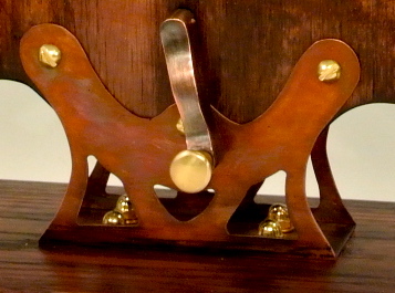

This is avery common technique used in metalsmithing referred to as a file and fold. You can use a jewelers file to make a v shaped cut at the bend line or a quick and dirty method is to use a Dremel cutoff wheel and then clean up the cut with the file. In metalsmithing we commonly silver solder the joint after it has been folded for a super clean and strong joint that can be filed down square. here is an example of a file and fold that I did recently. The entire bracket is made from a single piece of flat stock 18g copper and then folded to the shape you see. As you can see the soldered joint is virtually invisible.
Edited by - metalsmith1 on December 29 2014 10:30:08 PM
 Posted - December 29 2014 :  10:55:05 PM Link directly to this reply  Show Profile  Add Redneck Justin to Buddylist
Handsome job! I'm far away from grade A metal smith work!
