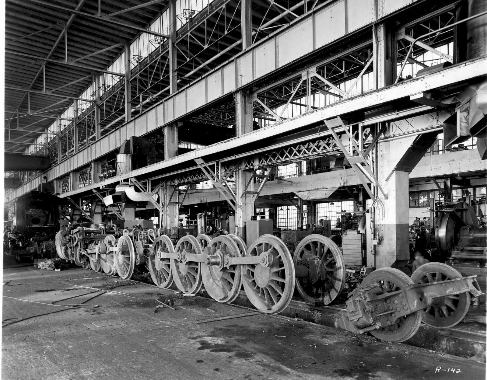

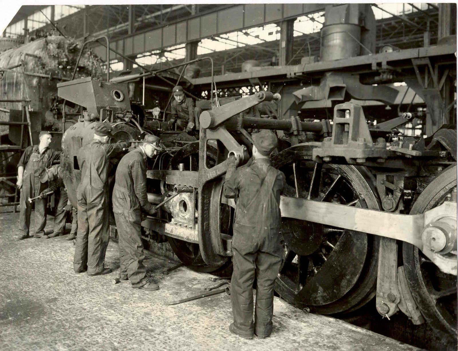

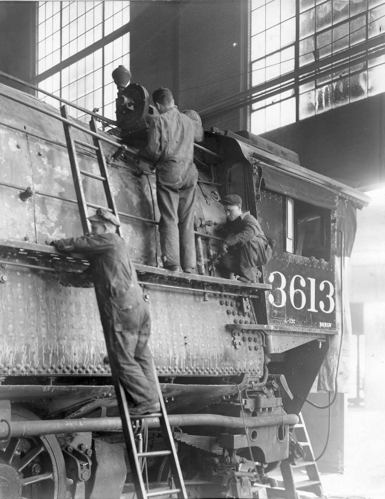

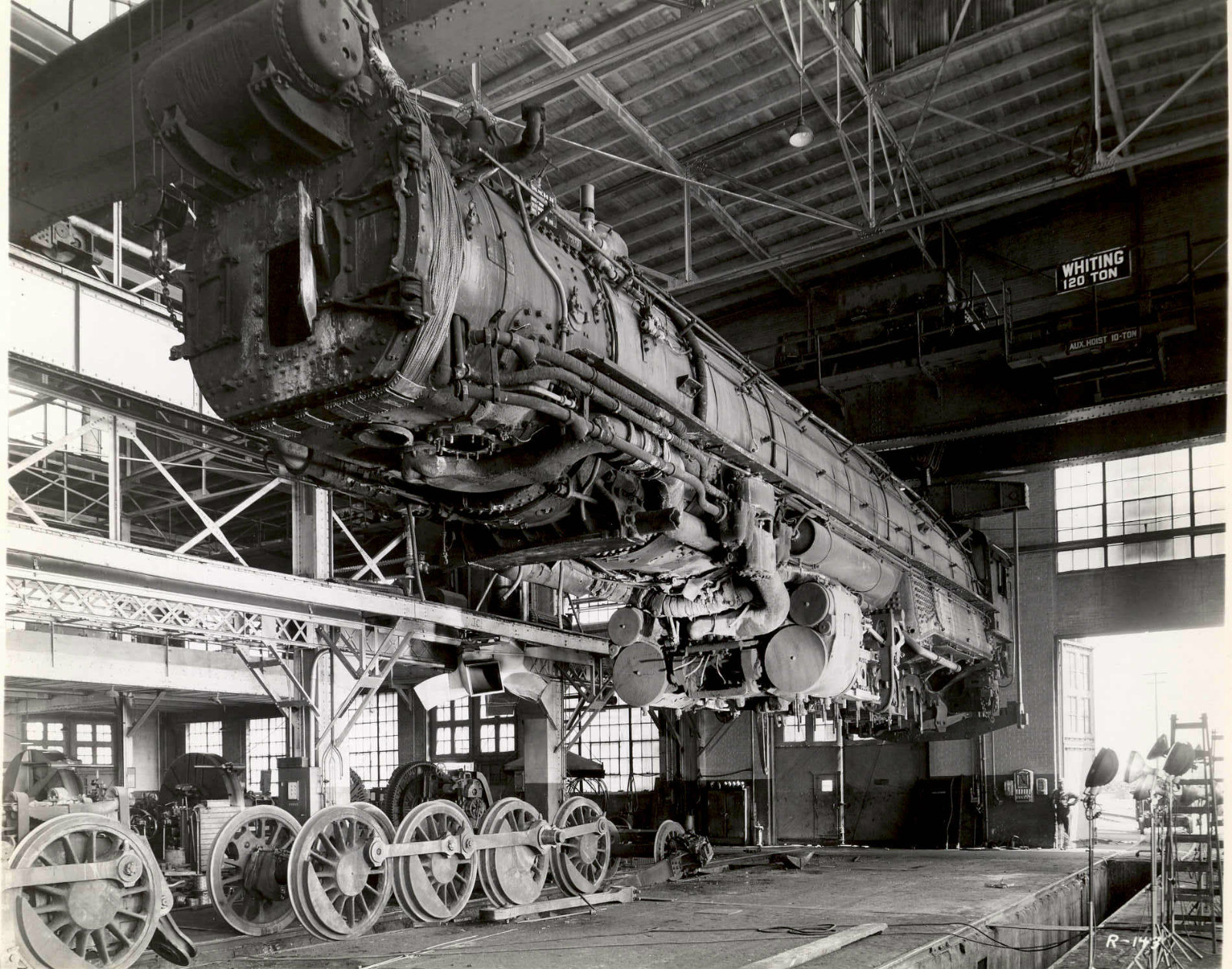

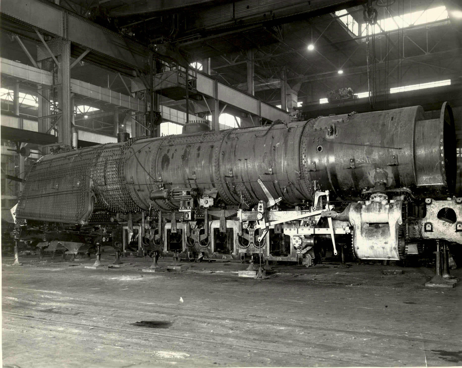

Frank, your project reminds me of some fine photos I came across . . . these are the Denver and Rio Grande shops . . .
Originally posted by Barry - December 26 2014 :  1:15:19 PM
Barry. You are way to new. !890 is the time for 4-4-0 2-6-0, 0-8-0 and 2-8-0 locomotives. Not that monster articulated beast. Also the time when CRR of NJ was making its own camelbacks in those wheel arrangements.

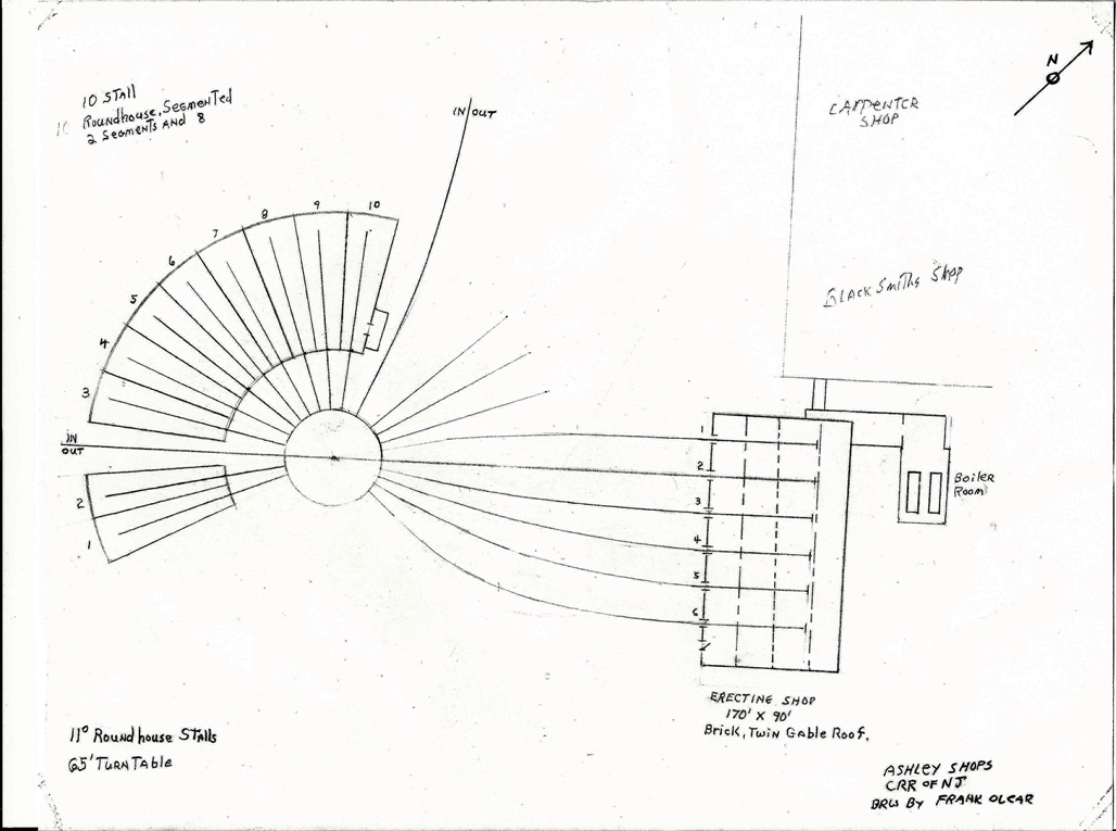

Well here is my building layout drawing showing scale size and location referencing it to north, and the turntable.
Edited by - toptrain on December 26 2014 4:43:56 PM

Thanks for straightening me out on that Frank. Though I still think it's neat to see the tools and the types of equipment they were working with. I'll have to keep my eye out for some earlier photos, so I can straighten myself out further.

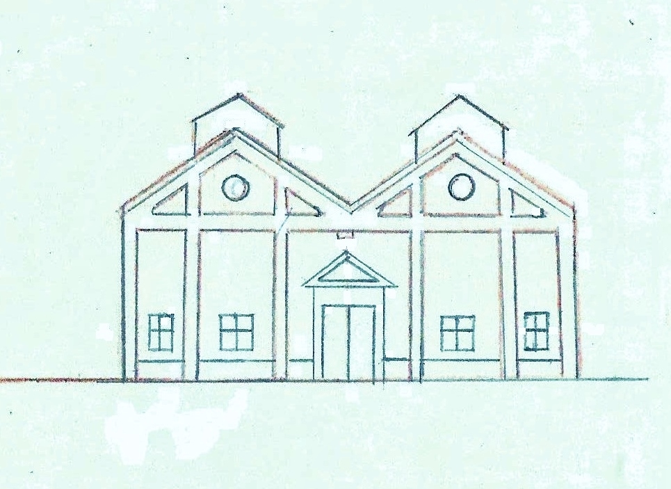

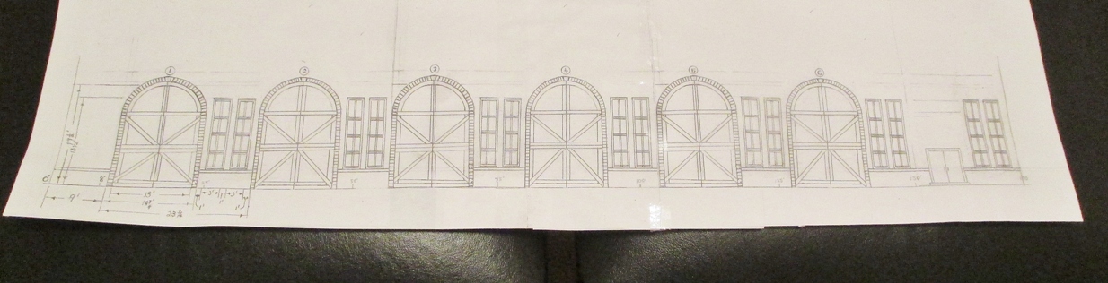

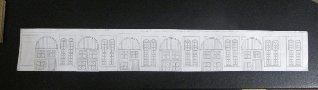

* Another drawing. This is just a not scale view of the South-east wall. It faces toward the Ashley station. The rectangular part is to high. With the distance across the bottom being 90 feet the height of the rectangle should be about 24 feet.
* The personnel door seen in the right side towards the center of the wall pictured below is just a thought I had of placing a door on this wall when the only photo I had showed some kind of door there. That was from a 1950's photo. It seemed that that part of the wall was reworked and a door was added. Now the postcard of the erecting shop I first seen around a month ago shows a engine door there. This engine door though the same in appearance, is built into the south-east wall in a different way then the 6 on the south-west wall.
Edited by - toptrain on February 25 2015 09:26:35 AM

Here is the opposite view to the last. It is the north-west wall. closest to the blacksmith shop . The center door is one I dreamed up. There is no photo or drawing showing this wall. There is a photo which includes the far right edge of the wall showing a window in a brick panel. Of the 2 sides to this wall each with its own gable section above it, each side has 3 panels. of the 6 total panels one must have a personnel door, or some other kind of door, in it at least. In my drawing I show a grand entrance filling the 2 center panels. As I said I just made this entrance up and may make it this way.
 Posted - December 26 2014 :  5:06:29 PM Link directly to this reply  Show Profile  Add toptrain to Buddylist
* This is what the south-west wall looks like with its engine doors and windows and a personnel door to the far right. Their is a photo showing this detail. So this one wall of the 4 on this building will be close to correct. The other 3, well who knows? Nobody is giving me the information.
edit 1-30-15. this wall drawing is incorrect in door style and the personnel door to the far right doesn't exist. Windows are there only. Information sent to me provided the new view. This came from a post card from the Luzern County Historical Society on line.
Edited by - toptrain on February 25 2015 09:31:17 AM
/tyco/forum/uploaded/toptrain/20141226134248_Ashley erecting shop and roundhouse 1890.jpg
Originally posted by toptrain - December 26 2014 :  1:43:01 PM
Very interesting! Move the in/out track to the left side and you've got the same basic arrangement as the A&GW backshop in Meadville, PA, later used by the Erie. These were from the same general era.
http://www.fcvrrhs.org/meadville_rr_history.htm
Have you checked HABS/HAER for info? They have some very detailed information on the Meadville buildings.
http://www.loc.gov/pictures/related/?&pk=pa0372.sheet.00004a&st=gallery&sb=call_number#focus
Interesting things to take away from the photos - the rather sad remnant of the shop complex was still seeing a lot of use in 1971, turning and servicing wheels and axles for the large and much newer carshop at the Meadville yards. The roundhouse is made of wood and sheathed in clapboards. I can't say I've ever seen a wooden roundhouse on a model railroad.

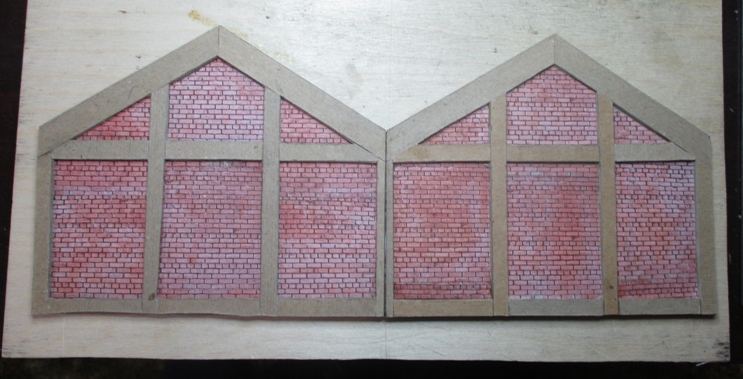

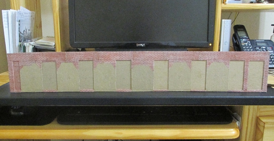

* Rolling along I have been working a few days on the two, 90' walls. South/east and north west. The S/E will be the most detailed unless I am gifted with patience from above. The top ones are S/E and the bottom pair are to be N/W.
* All will be cut out like those already done . All of what I am doing will be seen clearly in the future . To much for me to explain.

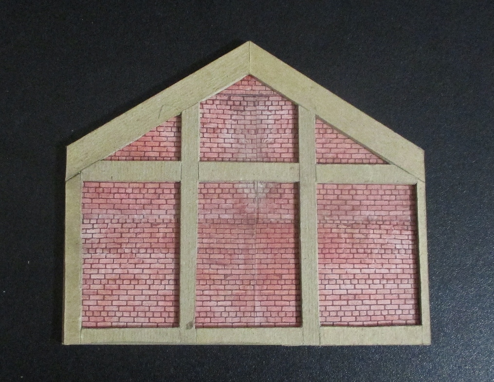

 Posted - January 06 2015 :  08:47:14 AM Link directly to this reply  Show Profile  Add toptrain to Buddylist

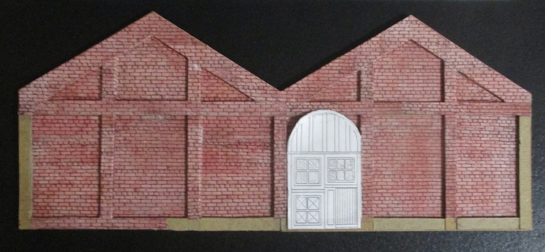

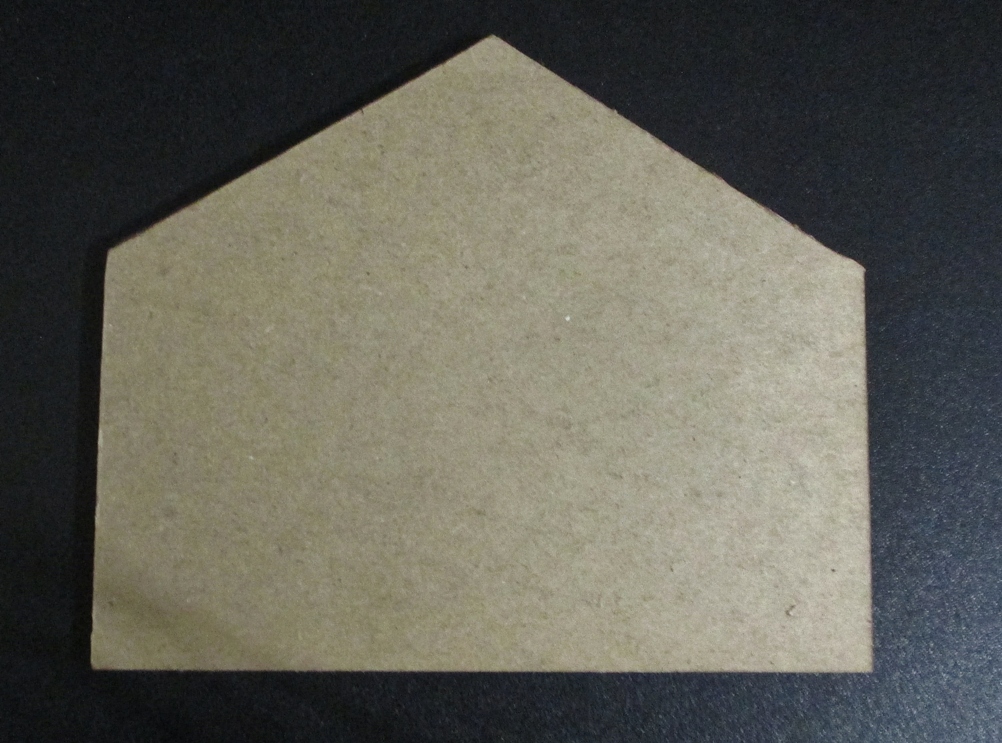

*** Here is what I meant 2 post ago when I described what I would do.
** First make the back panel.
** Next cover one side with bricks, and glue on the overlay of Pilasters, to create the recessed panels. S/E wall, left side.
Edited by - toptrain on January 06 2015 2:35:14 PM

** I work on the right side of the S/E wall and put the two together.
 Posted - January 07 2015 :  7:42:22 PM Link directly to this reply  Show Profile  Add toptrain to Buddylist
** The brick paper is almost done but for the bottom horizontal bottom part. I don't have windows or doors yet so I will move on when done to the opposite wall, the north-west wall.
 Posted - January 07 2015 :  7:55:23 PM Link directly to this reply  Show Profile  Add toptrain to Buddylist
** There are 6 recessed panels, three to each half. The one shown will have a engine door, like seen here. The other 5 will have windows. One in each recess. they are 4X4, doublehung, for a total of 32 lights.
* The windows on the long sides are 3' wide and are 3X4, doublehung, for a total of 24 lights each. There will be 2 evenly spaced windows in each 10' wide recess.There will be 48 lights in each recess.

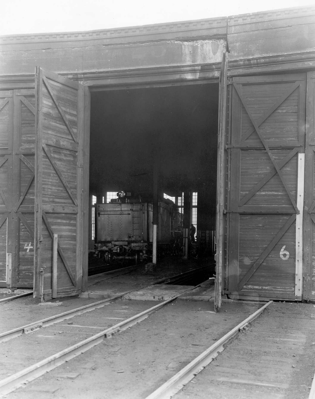

Photo info for erecting shop, south-east wall. looking at east corner of building to far right.
* The tender you see #479 is for one of the K1 class 4-8-0 camelback. It is the last of 51 K1's built from 1899 to 1901. This dates the photo after 1901
