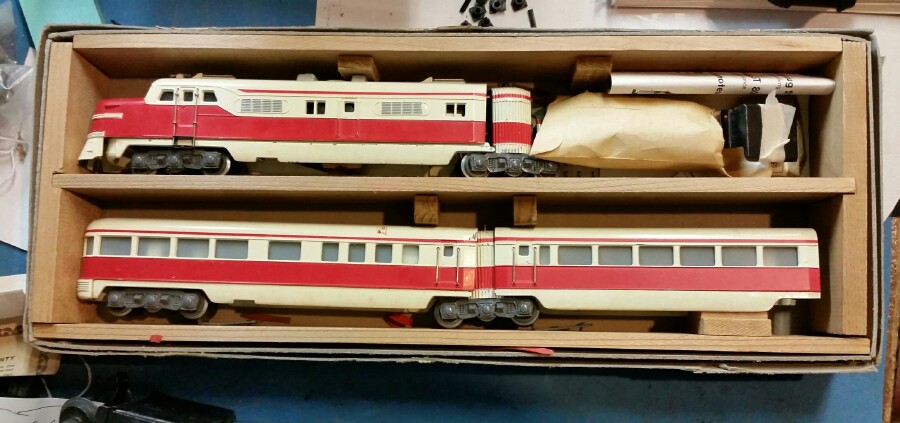

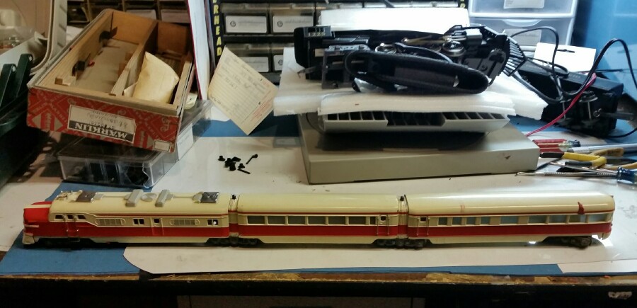

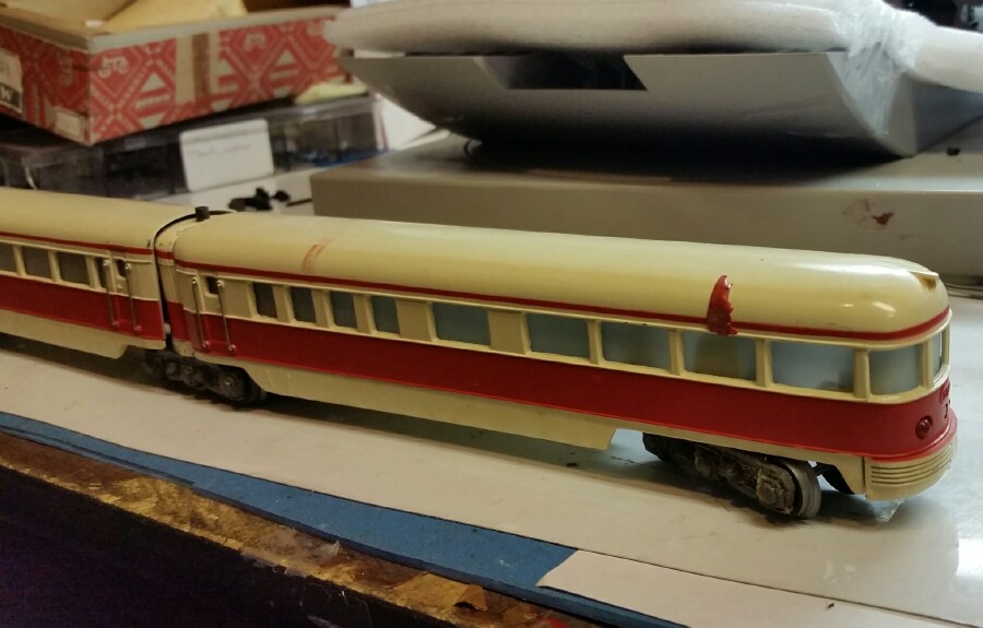

Boy, talk about a rare piece! A customer brought in this neat talgo-style locomotive train, and I got to work on it. Value at over $1,000, in the original box (which is a piece of custom craftwork, too), all papers, sweet! Thought I'd share it with you. AC driven, heavy diecast construction, and it was super-clean, I bet this was rarely taken out and run.

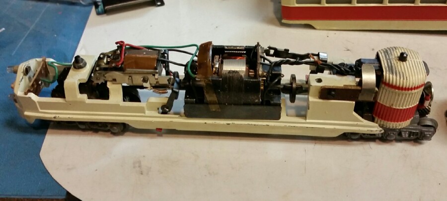

My first task was to check out the engine, then 3 Marklin transformers. The engine at first was a bit balky, but once I set it up on a piece of track, it seemed to run better. I did minimal work to it ; some oil on the bushings, grease on the internal gears ( of which there were many ), and that was about it. all lightbulbs still worked ! This is a 1939 era model train, very rare. Looked on Ebay tonight, and I found a few, from $1,500 up to 3,200 . Glad I got some pictures of it, I may never see another one of these again!
The Marklin transformers were a piece of cake, 2 of the 3 worked, the 3rd needed the plug rewired, the wires had worked loose inside, so I cut them off and retightened the connections, and it worked as well finally.

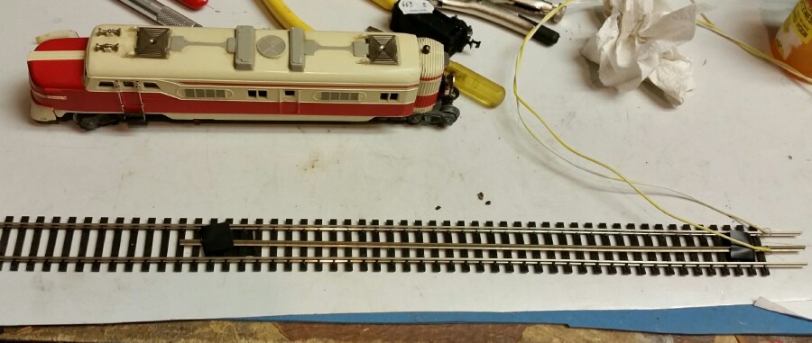

Overall, a fairly easy check-out, and since we didnt have any Marklin 3-rail track handy, I "made" one out of some Atlas flex-track, and taped a 3rd rail piece in the middle. Worked well enough to check power to the engine. Very cool piece of HO history I got to hold and feel. Here's some pictures of it on the bench.

Wow! What a neat machine. And look at the little reverser 'e-unit'. And notice the drive: central motor driving two trucks through two universal shafts and gear towers. Was Marklin actually the originator of the standard "Athearn style drive" for diesels?

idk what is on the front nose but it resembles the Santa Fe Warbonnet
What is the funny wing on the rear car?
Originally posted by microbusss - December 15 2014 :  11:22:33 AM
You mean that red thing? It's a piece of rubber padding that is stuck to the car roof. That's not a wing.

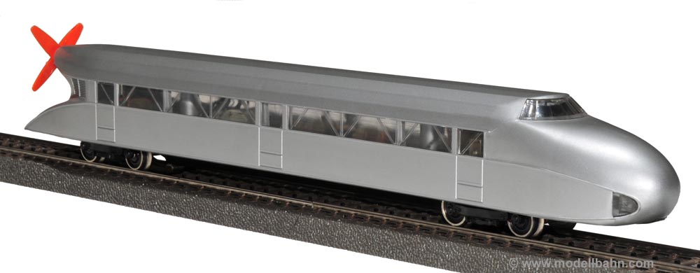

Perhaps you should introduce Ben's Aerotrain to this thing, they look similar enough that they might get along
--CRC

Originally posted by JNXT 7707 - December 16 2014 :  5:18:11 PM
Well, Marklin *did* make one:
--CRC

Yeah they might have one of those little propeller cars for a baby
Originally posted by PRR 4800 - December 16 2014 :  8:42:10 PM
They did a couple of times, actually. I.e. the O gauge version.
