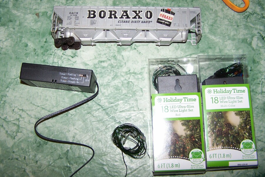

Earlier this week, I visited a Wal-mart, and found they had some neat battery powered LED lights, and the box controller offers 3 functions - On, Flash, and Fade. Now, finding a fader circuit has been one of my quests for awhile, I did buy a kit last year at the Micro Centre computer place, but that cost about $17. This set has 18 LEDs ( either multi-color, or red ), with the x3 AA battery power, and it has all the functions I could want for $4 ! I went to another Wal-mart tonight on the way home, and got 3 more of them. I need a fade circuit for my Halloween haunted train consist, and figured this was the cheapest way to get it done. I'll bet the fader could be usdd for a Mars light, too. The LEDs look like water beads on a windshield, not the typical dome-shaped type. I will probably cut them out to use green ones anyway, since they don't have a green version apparently. Anyway, for $4, I figured some of you guys might be interested, so I post this here. They come in a clear plastic box with green label, called Holiday Time. In a green cardboard tray on a shelf. Some wal-marts don't have these, though, I've been to 4, and 2 didn't have them ( the 2nd and 3rd wal-marts I went to didn't ). Just a heads-up if you're looking for a neat little item that could be very useful on a layout for some lighting tricks.

 Posted - December 12 2014 :  09:31:51 AM Link directly to this reply  Show Profile  Send AMC_Gremlin_GT an AOL message  Send AMC_Gremlin_GT a Yahoo! Message  Add AMC_Gremlin_GT to Buddylist
Jerry, do you have a photo or a link?
Originally posted by NickelPlate759 - December 11 2014 :  11:16:56 PM
I knew this would come up eventually. LOL ! Ok, here 'tis, both kinds , in and out of box, with a Tyco hopper for scale.
