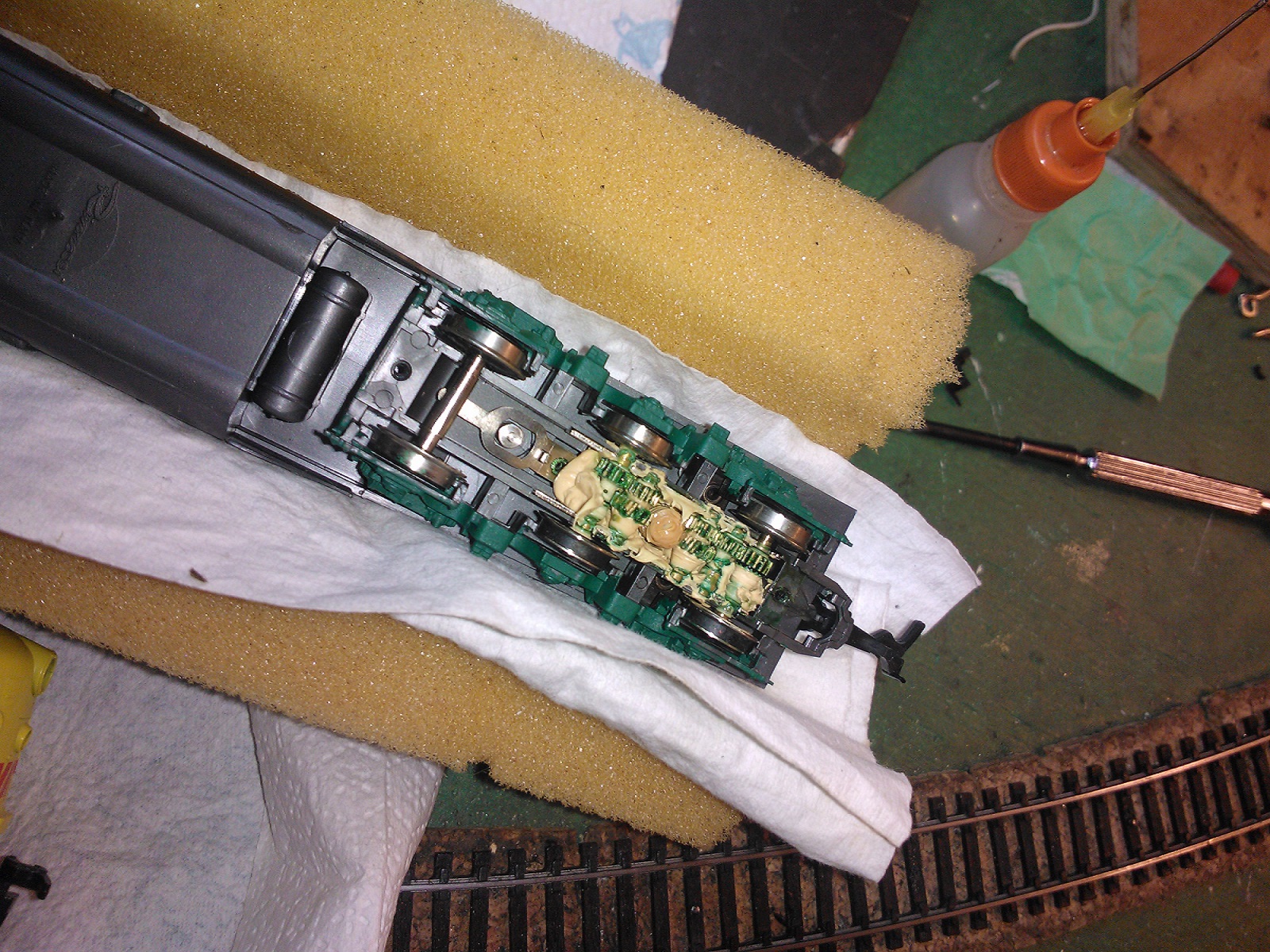

I noticed someone in another post said they used this stuff in their drive trucks.
Be aware that lithium grease does thicken over time, sometimes VERY thick.
Example:
This was in a Rivarossi E8 I was tidying up for my LHS pal.
It took many hours of digging and scrubbing to remove this goo.
It also got up the motor shaft, and only came out after many apps. of oil.
Of course, this guy put WAY too much in, but still, Yuck!!

 Posted - December 03 2014 :  11:52:15 AM Link directly to this reply  Show Profile  Add wildecoupe to Buddylist
The problem with that looks to be due to a frothing effect. If you just spray it on directly, there's lots of air bubbles in the grease which can just increase with gears meshing. I've taken the can of spray lithium and used the same trick that ppl use for transferring spray paint from the can to a jar and using a bent straw. Then I apply it with a brush. Lithium is very plastic friendly which is why I prefer it.

Regarding the green color in my photo, this was due to green paint getting in from the sideframes, which were also painted by the green paint guy.
I did manage to remove all of the grease, which was the consistency of chewing gum.
It left a very sticky residue, which took even longer to clean out.
Good old 99% alcohol and then Sunlight dish soap.

 Posted - December 04 2014 :  12:28:06 AM Link directly to this reply  Show Profile  Add NickelPlate759 to Buddylist
The paint job isn't that bad. The green didn't get anywhere near the dummy axle. I've seen it many times in old brass geared locos where the oil has leeched out of the grease and moisture has intruded. It's generally superficial and cleans right off.
