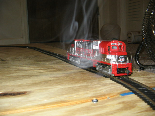

 MOTOR BURN OUT
Author Previous Topic: New and Old Topic Next Topic: Tyco Dielsel and loco brushes
 Posted - April 06 2007 :  7:00:35 PM Link directly to this topic  Show Profile  Add Brianstyco to Buddylist
This is why TYCO can be hated so much by us all AND ONE REASON THEY GOT SUCH A BAD WRAP-power torque failure-snapped this picture while test running loco and motor fried in it-notice the white smoke=TYCO OZONE

Ouch, hope the shell is ok, looks so nice I'd like to buy it. Hint, hint.

If you tear it down does the armature surface look as if it has brush sized spots and as if it has a more copper look to it. I've noticed this on one or two of mine, like the regular surface has vaporized or something. I have cleaned these and put them back together but they haven't run well. Don't give up!

I just got a GP20 that did that and it continued for 2-3 seconds and seemed to run OK afterwards. Yours was probably nib but would it run after it quit somking?
 Posted - July 30 2007 :  1:03:33 PM Link directly to this reply  Show Profile  Add shaygetz to Buddylist
A rather dramatic shot there, Brian, and such an otherwise pristine loco too.

It's just doing what all good ALCO's should do....throw up alot of smoke!
Actually....did the engine run afterwards or did it just die? Oil in the contacts maybe? In any rate...hope you get the Silver Streak running....it looks sharp!

Your Alco smokes better than my Chattanooga! [:D]
Ah, the smell of frying insulation and the fiberglass pc board they printed the commutator on. Mmmmm....... [^]

Buy a junker loco on eBay to replace yours if it's burned out. Have you cleaned the brushes and commutator?
 Posted - February 28 2008 :  10:00:03 AM Link directly to this reply  Show Profile  Add Alco Fan to Buddylist
I haven't run enough early Power Torques like what was in the early 70s Mantua Tycos to know but do you think that those early PTs were more dependable than those put in later Tycos like the Alco, GP20, and SD24 etc? Were they or are they more stout?
Also most of us have operated PT Tycos that were used and abused by improper break-ins, done by us as kids or kids like we were, or maybe NOS that had been in the box for how long? How many of us have actually had new Tycos, as in just manufactured and properly broken-in , that have taken up smoking and failed? I'm thinking that if we had they might be more dependable.
Originally posted by Alco Fan - February 28 2008 :  09:00:03 AM
This is a good point.
I have come across a few PT locos that looked like they have never been on the rails. After a quick lube they ran great.
All it takes is a little carpet fuzz to put enough drag on the motor to overheat it.
As for smoking armatures, most likely caused by the armature being locked up at one point and power applied, the result, burned insulation and shorting of the armature windings. frying the commutator or overheating the brush springs which makes them loose tension.
Weak brush springs and/or over oiling will cause arcing from the brush to the commutator toasting the commutator in a hurry.
We should also realize they were only designed to pull the cars that come with the set. 2 or 3 extra cars will cause the armature to start overheating slightly, burning off the oil in the bearings, which causes friction that generates more heat.
Once the armature shaft starts to heat up, the heat is transfered to the pinion gear which being a different material that expands faster than the steel shaft starts to slip on the shaft. Once it starts slipping it wears to the point it will not stay on the shaft.
So it is possible that with proper care the PT would be a good drive, but the slightest abuse or neglect will send them spiraling downward.

Originally posted by Ray Marinaccio - February 29 2008 : 5:54:53 PM
However, this description is in my Chattanooga instructions:
"Tyco's exclusive 'PowerTorque' Drive now combines unprecedented power and traction with the smoothest starts and stops ever! 'PowerTorque' has more pulling power, climbs and descends grades easier, and helps keep your cars on the tracks better (huh!?)---AND---it uses 20% less current than conventional motors."
[:O]
This paragraph of unbelievable marketing BS makes it sound like they had developed a better drive than Atlas, and it certainly doesn't make it out to be a cheap toy train drive requiring kid glove treatment. Besides, a toy drive should be more rugged, not less, but in the 70's most toys weren't as sturdy as they are today.

Has anyone had a 630 Alco go POOF? I have a Golden Eagle and a SF that I run alot, one for over a year and it is a super performer, the one in the avatar, and the GE is stout also. Maybe the extra axle allows for more consistent power pick-up and is better for the PT electrically, and makes it last longer, than spotty pick-up of power with 2 axles. Adams, good idea about adding the extra axle.
Originally posted by Alco Fan - March 01 2008 : 12:32:55 PM
Any Powertorque armature is at risk of burning out, no matter how many wheels are picking up power. I've only had a few, but I never had one burn - I had bearing and gear problems. My guess is that those that do burn have poor insulation on the windings, or the commutator printing burns thru.

"Any Powertorque armature is at risk of burning out, no matter how many wheels are picking up power. I've only had a few, but I never had one burn - I had bearing and gear problems. My guess is that those that do burn have poor insulation on the windings, or the commutator printing burns thru." Originally posted by NickelPlate759
NP759,
Based on my experience the big Alcos perform better than 4 axled versions and there is some reason for this. They run more smoothly at slower speeds and get better traction. Some guys add extra axles to their 430s to improve it's performance.
Originally posted by Alco Fan - March 08 2008 : 12:02:30 AM
The extra pickup can''t hurt, in fact I put extra wheels in an old PT Shark that I also double-motored years ago. Eventually it succumbed to bearing an gear issues tho, and I threw it in the trash. [:o]

IIRC I gave it six axles before I added the 2nd power truck, but we're going back over 25 years. In my experience two PT trucks are bad news, because one is always faster and they fight each other. I think that's why the pinions ultimately gave out. In the beginning one truck was definitely a bit faster, so I slowed it down with two diodes in parallel, which worked fine until the fast truck started to slow down.
Speed variations are inevitable because the bearings are too small to hold much oil, and the commutator is too close so it ends up slinging onto the brushes. That will slow down any motor, but it's especially bad with NoTorques. I cleaned the brushes and commutator countless times, but it was inevitable that it would happen again no matter how sparingly I oiled them, and it was critical because they needed to be in sync. When the pinions gave out I stripped it for parts and tossed it.
Edit: I forgot to add that it pulled like a freaking beast, so I may have overloaded it as well, but the pinions started going when the trucks began fighting against each other.
