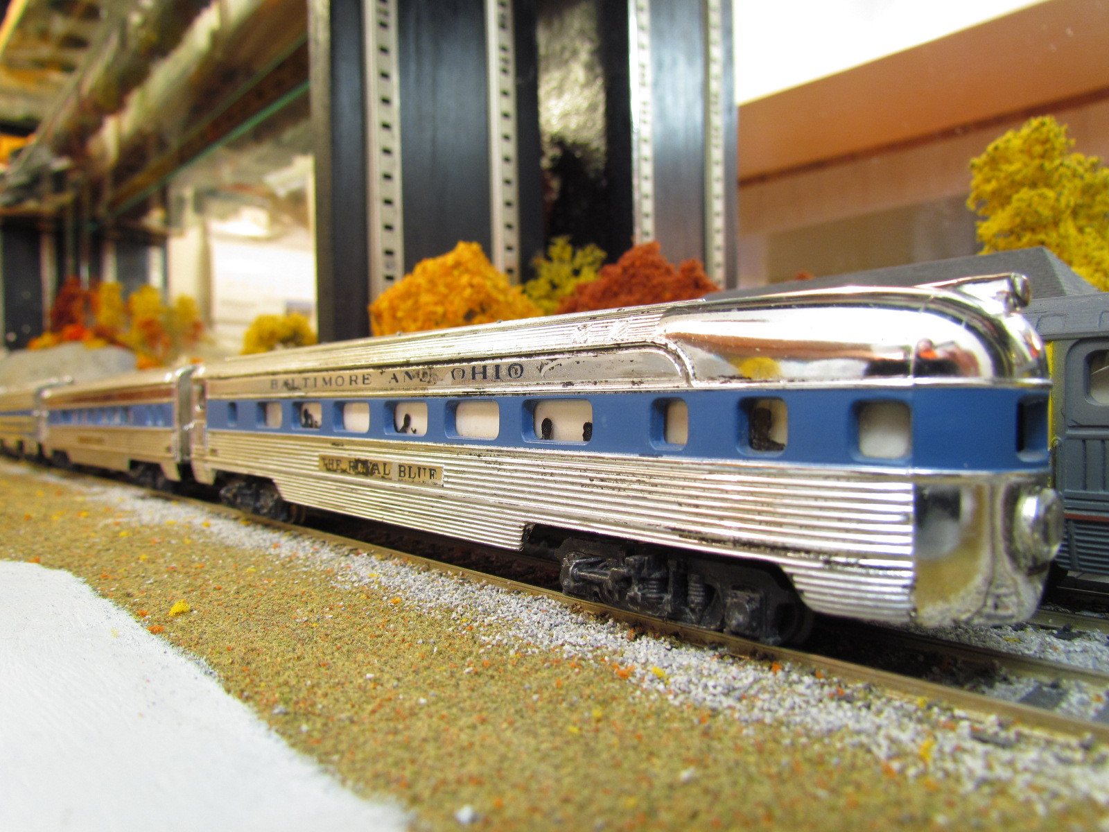

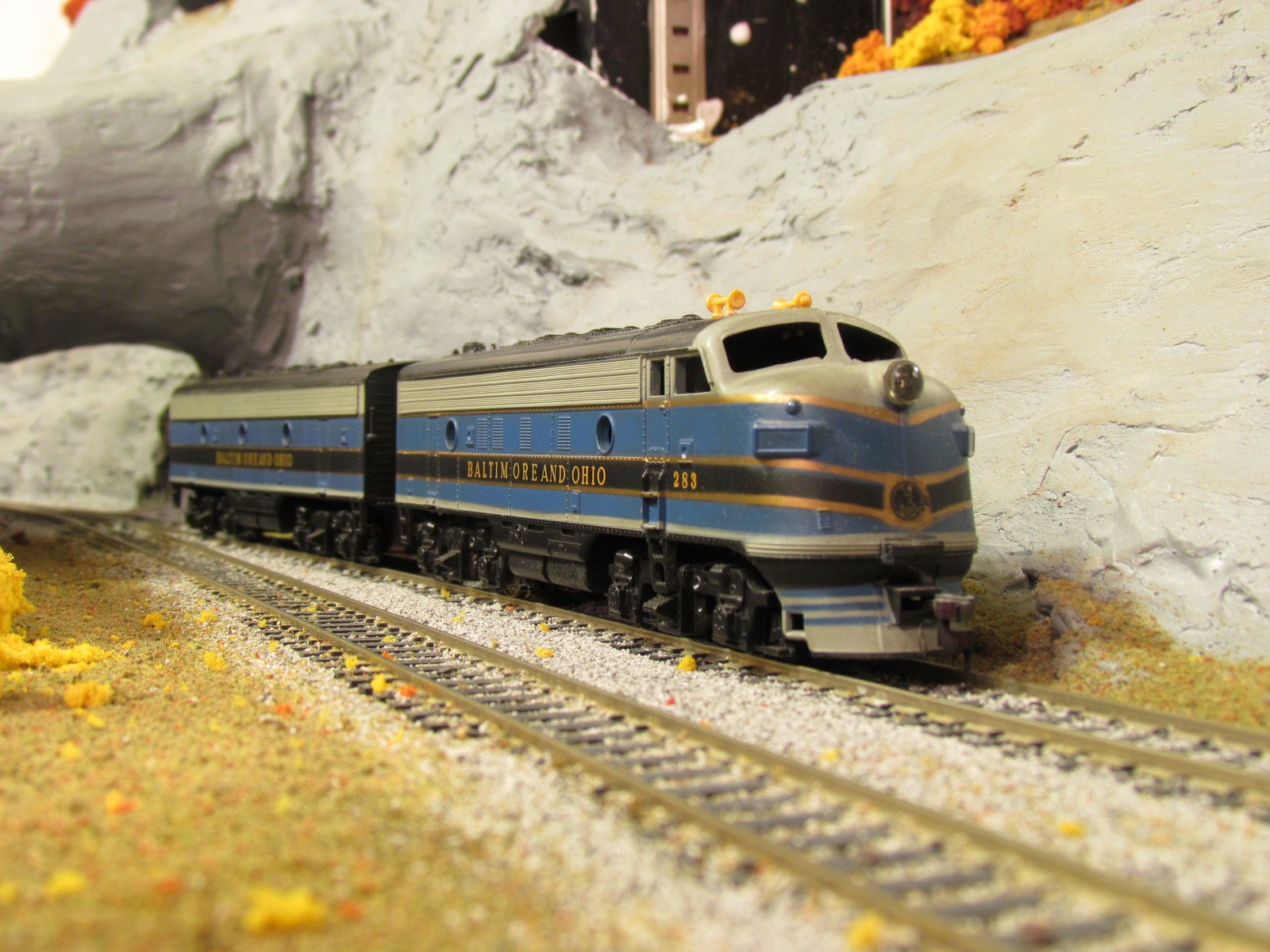

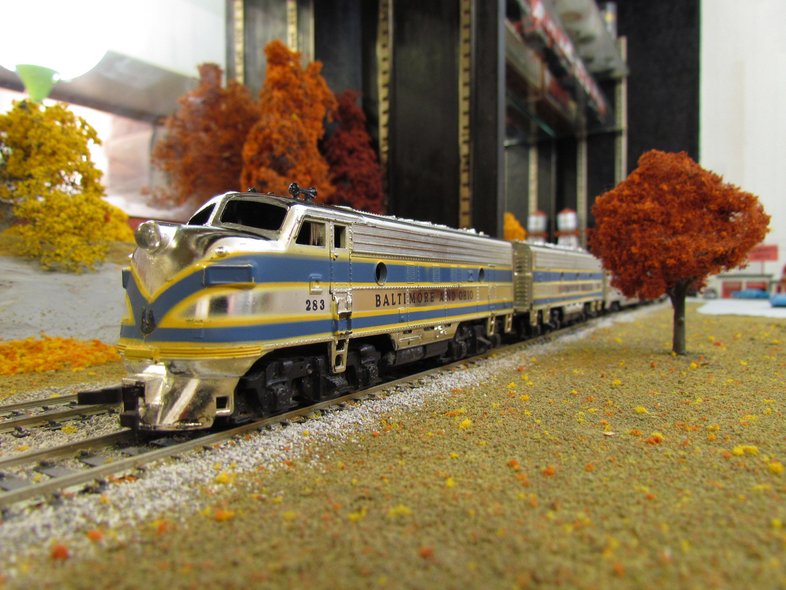

Tyco made various versions of the Royal Blue throughout the Red Box era. Some of these sets included chrome or flat painted Tyco streamliners, the Gilbert/Tyco hybrid streamliners, an F7 A+B pair (in chrome or flat paint), and a Pacific loco as shown above.
Standard F-unit pair:
Chrome F-unit pair:
Chrome Tyco Streamliners:
Gilbert/Tyco Hybrids:
Standard Tyco Streamliners:

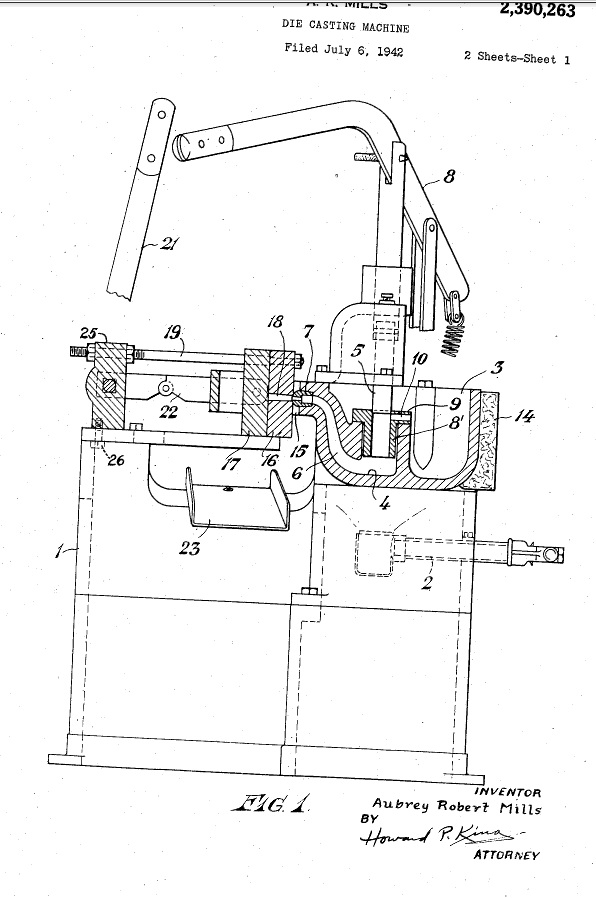

AMC: To add to my wall o' text up there, here are some images.
This is a patent image of a late-20s die casting machine, which shows what would typically be involved in a small machine of the early 30s. As you can see, there's a lot of mechanism and motion here:
/tyco/forum/uploaded/Autobus Prime/20141212121632_early-die-caster.jpg
All this complexity exists for good reasons, many of which wouldn't come into play with a small, modest volume toy/model manufacturer. Now this is the patent drawing of the hand-operated DCMT machine:
Simplicity itself. And this is no postmodern-style, deliberately vague and schematic patent drawing, this was drawn after Aubrey Mills had already built his first machine to this design, in a garage under an auto repair shop. There really wasn't much more to it than that!

3. Metalcasting is an art, and experienced foundrymen trust their judgment, often with good reason. But this means that the lessons published in a technical paper may take a long time to get to every shop floor. There will therefore be problems when a new process is adopted.
I can't say for sure which of these caused the problems with the Lionel locos, or the Varney castings, or the New One locos. The only way to know for sure would be to find someone who worked at the factory.
 Posted - December 13 2014 :  01:48:52 AM Link directly to this reply  Show Profile  Add NickelPlate759 to Buddylist
Thanks for such a comprehensive explanation. That's the best I've heard. I had heard anecdotal tales, like one from a member of the A.C. Gilbert Historical Society about shop floor sweepings being dumped or even cigarette butts flicked into the metal vats by shop workers, but it makes more sense knowing that something as ubiquitous as tin or lead is zamac kryptonite.
It also raises the spectre that it could happen again. I assume the technology and manufacturing standards have improved, but it's well known that manufacturers in all industries have problems getting Chinese factories to comply with their QC. Some current high dollar locos like BLI could potentially see their frames disintegrate in a few decades.

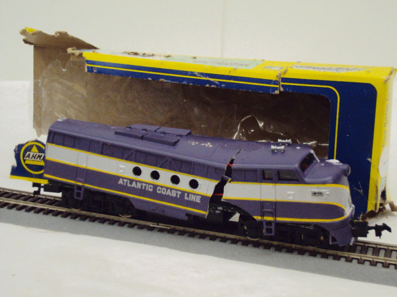

This is an auction photo of an FT that they made for AHM, and the all wheel drive chassis -- which was common to their F9 -- has exploded and taken the shell with it.
They made the 0-6-0 as a saddle tanker for their own line (retooled about 35 years later for their Spectrum version), and a side tanker for AHM. (Some can be nice runners if lubed & tweaked.) Many had the bottom cover disintegrate, tho the Bachmann versions had a 100% failure rate of the examples I've seen, and I've had to replace them with AHM badged covers. Oddly enough, I've never seen the Zamac boiler weight fail in any of them. Again, it's batch related.
Some 70's Rivarossi have had casting failures, the fuel tanks on the U25C being the most common. Tony Cook even posted an example of a rotted 70's Tyco PT truck.
