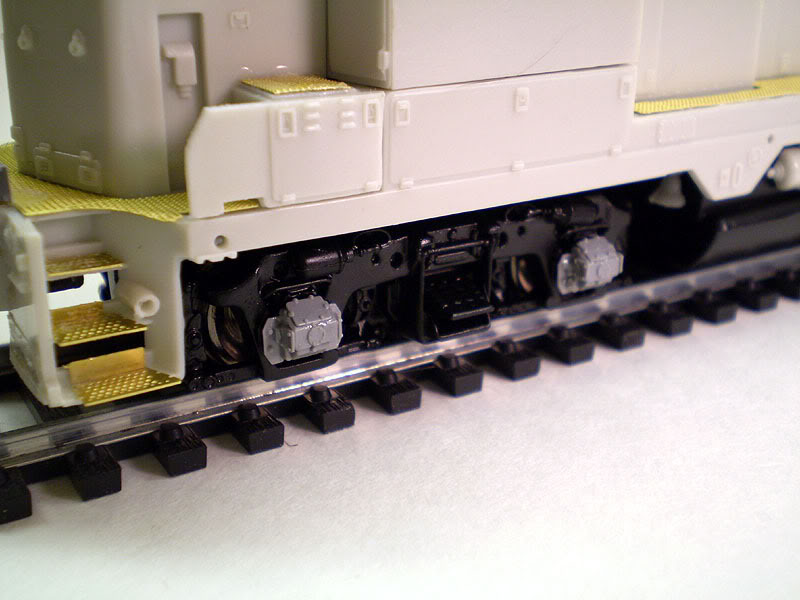

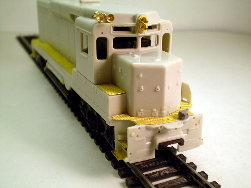

Been working on a Bachmann EZ-DCC GP-30 and thought I'd share some pics...
This is the Undecorated EZ-DCC GP-30 with a number of details added...
Cannon & Company treadwalk made a nice addition. It's very thin brass strips and though they don't make one for the GP-30, I did get the one for the Athearn GP-38-2/GP-40-2 to work with some modifications.
I added the MU receptical on the front pilot; a bell mounted in front of the fuel tank on the underframe; a new 3-chime horn; a new headlight bracket; journal boxes on the trucks.
Still have a speed recorder to add to the front truck and windshield wipers.
I sanded off the dynamic brake louvers on the sides and dremeled out the dynamic brake fan put a styrene plate over it on the roof.
Have a couple more parts coming in this week and then it will ready for primer and paint.
